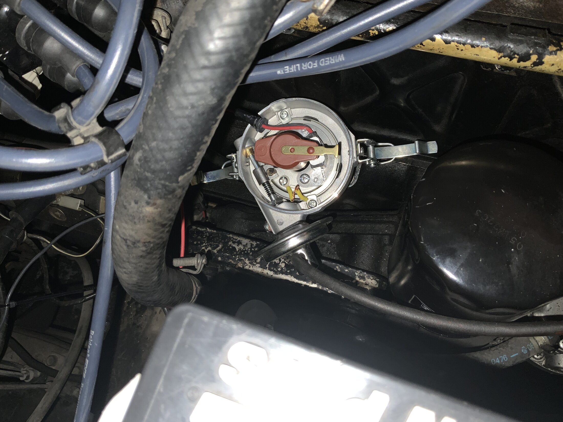

Pig head is correct. Your distribution looks like it in the position my Affordable Fuel Injection distributor was in when I removed it and put the city racer distributor in. So that makes sense.

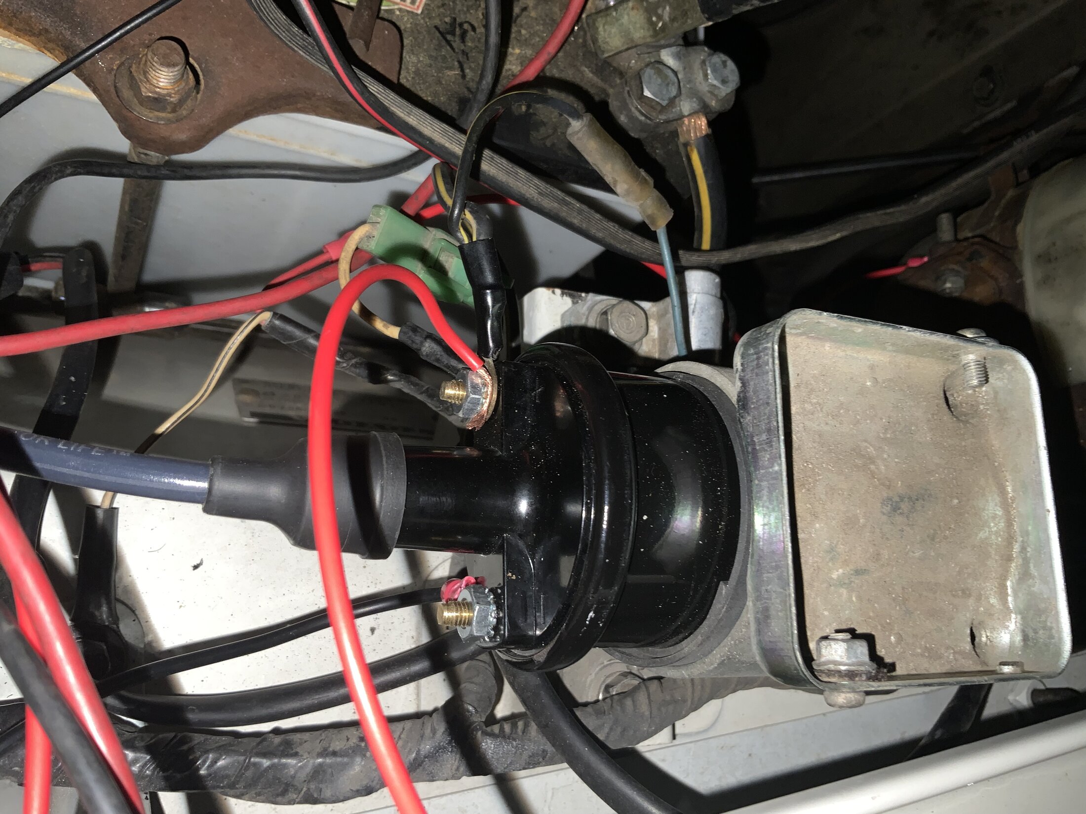

This is amazing and so thankful for the responses. I have the red wire the ignition and what I believe is the fuel cutoff (green connector) on the positive side of the coil. I removed the resistor when I went to the flame thrower 3ohm coil. I assumed that resistance was in the wire and the ignition circuit but maybe that’s too much. The poor method of attachment of the red wire is temp. As I abandoned the original red wire and ran on direct for testing.
I'm counting five or maybe seven wires running off of the coil-positive; I hope I'm reading the photo wrong.

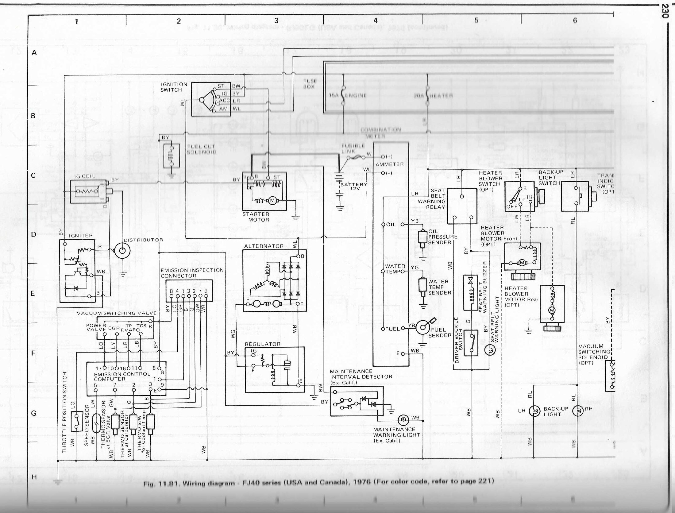

The '76 ignition-hot shouldn't go to the carb; the carb cut-off solenoid is routed thru the 'engine' fuse.

Yeah looks like a mess right now. I have 4 wires connected to the pos side. The others are an illusion and they are ground wires. Red is wire to distributor. Yellow and black is the switched ignition wire and a wire going to what I think is a capacitor. The white or yellow wire I assumed was the fuel cut off as it was attached to the pos resisted side of the old system.
Where does the negative side of the coil go? What color is it?
I don't see any yellow/black wires. I do see two black wires with a yellow stripe (one is switched-ignition, the other is from the starter solenoid).
I also see a white wire with a black stripe - I think that was likely the old ground from the igniter. However, the photo depicts it wired to the coil-positive, then to the fender/ground.

Sorry black with yellow stripe. The white with black stripe is not connected to the coil I promise it’s an illusion. The white wire with the green connector is and it goes to a capacitor that ties to ground. I have disconnected this to see if it is effecting the circuit and get no change.

From the photo, one of the black/yellow wires appears to be going to a factory bullet connector (not green). Then it appears to be connecting to something with a blueish wire lead. You are saying that it goes to the carburetor's fuel-cut solenoid? It looks like it goes to the capacitor, but, you said that the green spade connector goes to the capacitor?

Sorry I was incorrect when I said the white wire with black stripe goes to the capacitor. The small black wire with the yellow stripe goes to the capacitor. I am not sure where the white wire with the black stripe goes but it was connected to the pos side of the original coil and igniter system.

1. Your yellow wire that I think your using for a ground, isn't needed and maybe interfering with your vacuum advance.
2. Your Distributor appears to be extremely over advanced; we have the same distributor - but, it looks to me like your off one full cylinder

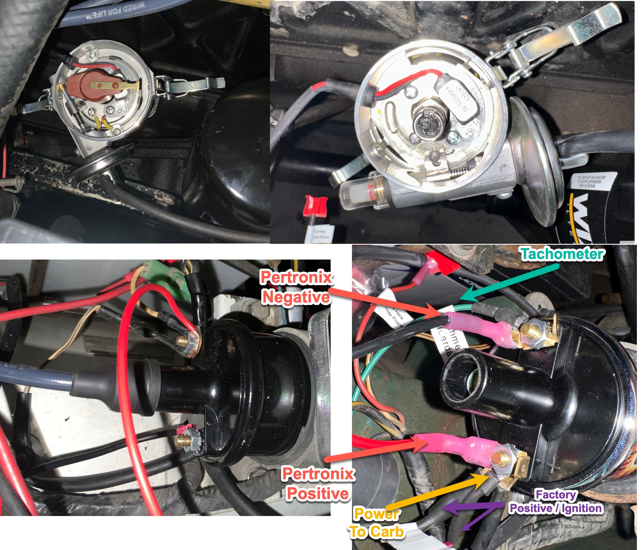

3. On the Negative terminal, do you just have the negative side of the Pertronix ... or is there another wire attached to that side of the coil?
4. is the coil your using a 3 ohm coil?
On my setup,
I have a tachometer and the negative side of the Pertonix attached to the negative side of the coil.
On the positive side of the coil, I have the factory positive from the ignition ( and, I have the positive side of the starter solenoid - which really isn't needed) and, I am supplying the carburetor from the positive side of the coil ... because the previous owner removed some of the electrical near the carb.

without loosening the distributor ... can you turn the distributor by hand? - as my current guess is that distributor is misaligned.
I have looked over these pictures and compared and they are basically the same with exception of the tach wire. I don’t currently have a tach. Other than that they are the same as long as the white or yellow wire with the green connector is in fact the carb wire. I really don’t know what that wire is but it was connected to the pos of the coil in the old system. I can work to figure out what that wire is.

With the battery disconnected on both terminals, using continuity / resistance on the multimeter, figure out which black/yellow is turned on by the ignition switch. (From the disconnected battery positive terminal to one of the disconnected black/yellow leads, which wire is turned on with the key in the 'ON'-position?)
Just three wires at the coil, two go to the distributor - https://cdn.shopify.com/s/files/1/0247/6913/4628/files/1662LS.pdf
The other black/yellow should be from the starter, but, because there is no ballast resistor, it probably isn't needed, and can / should be capped-off.
In the original harness, the 'engine' fuse is energized by the ignition switch, which energizes the black/yellow wire to the carb solenoid. It shouldn't be wired off of the coil. It can be wired off of the coil, but, then it bypasses the fuse block. Perhaps you can find the lead from the middle top of the firewall to the carburetor. If the mice ate your carb solenoid wire, like they did on mine ('75 USA-FJ40), you might try to run it from the coil-positive, just to see if the ignition is working, with an inline fuse for testing purposes. Otherwise, a fuse-tap might be a solution for the carb, if the original harness wire has been cut and properly capped-off.

The engine fuse is used in that coil circuit, but it’s the only non factory wire attached to that post (besides the Pertronix attachment).

No, the coil is not on the 'engine' fuse. There is a branch in the harness, just after the ignition switch. One branch goes to the 'engine' fuse, the other branch goes to the coil. Were you thinking of the fusible link, at the battery-positive?
