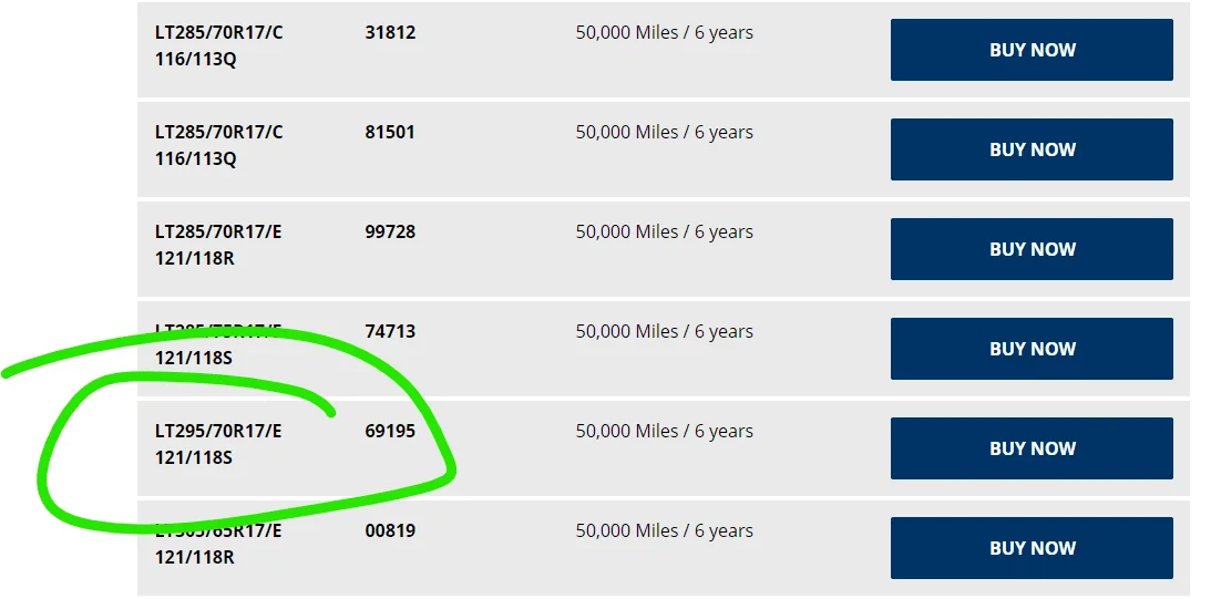

That's my ideal size!
Now the question is KO2 or Ridge Grappler?
*edit, didn't see the weight question. I think 28 lbs per wheel. They're heavy. Built for strength, not weight savings, haha.
I don't believe BFG makes a KO2 in that size.
I didn't either, but as of yesterday their site shows it as a size. I was leaning Ridge Grappler, largely because I wanted that size and I didn't think the KO2 did that. Now it looks like they do!

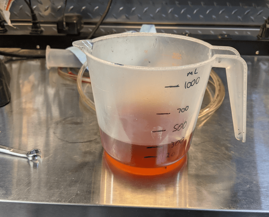

1. Flushed out another 2 liters of AHC fluid. 1 from the height control accumulator (~270mL at a time) and another 1 liter from a mix of all 5 bleed points. 5 liters total now. I plan to do another 3 liters or so once my shipment from McGeorge arrives with more fluid (only $17 each!) and new bleeders and caps. The fluid is better, but still not totally fresh. AHC flushes are sort of tough because so much of the fluid seems to mix when you cycle heights. Unlike brake bleeds where the fluid is relatively static in the system aside from your bleed strokes.

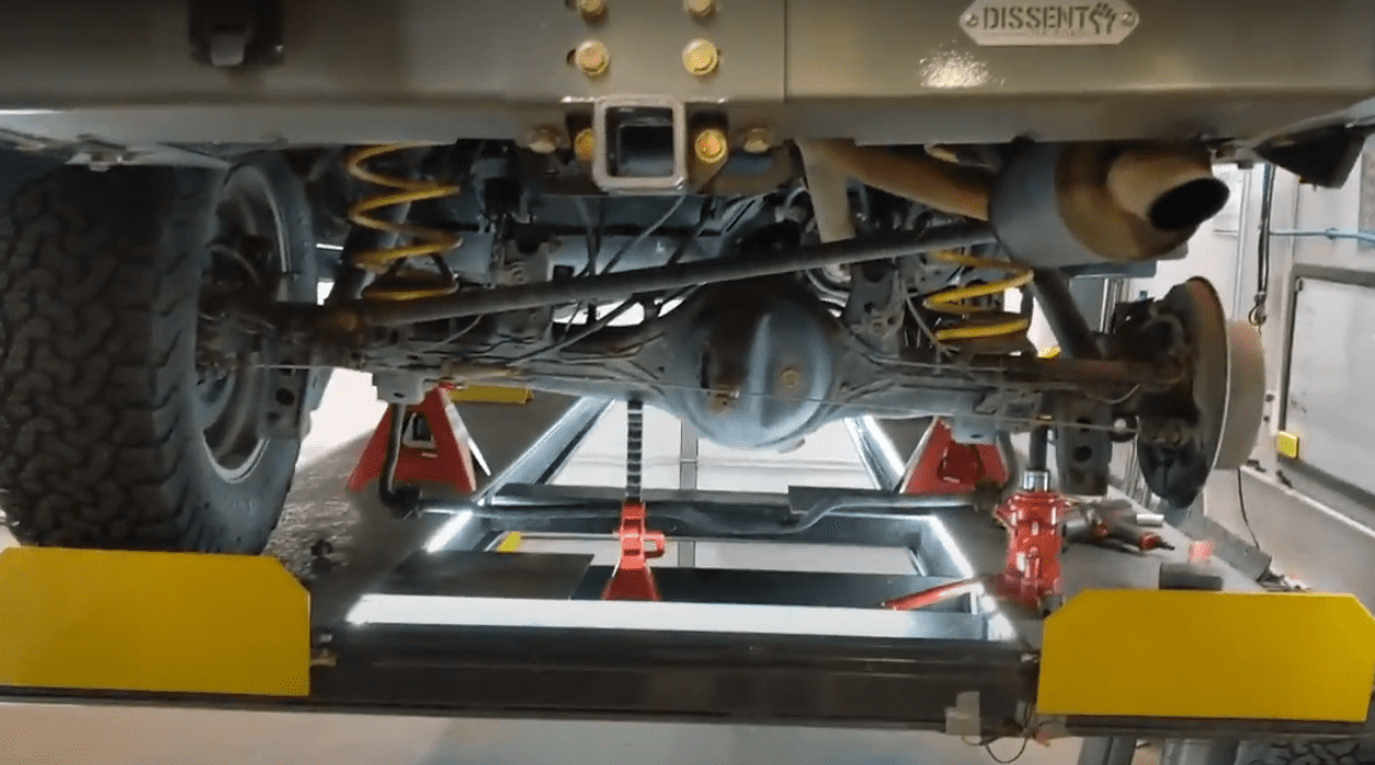

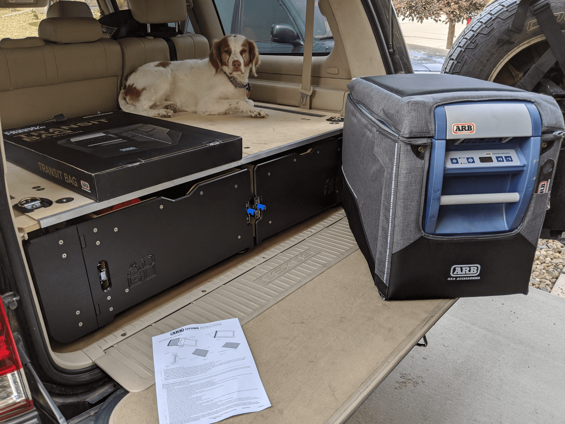

2. I installed 30mm rear Spring Spacers from Slee. AHC pressures in the rear went from 7 down to 5.7, but I also removed a drawer from the SS1 and the ARB fridge. Spec is 5.6-6.7 so I'm in great shape. I'll add back a new ARB hydraulic Jack and the Dissent door on the second swing arm so some of that weight change will be undone.
Front pressures are down to 6.2 or so. I can undo a turn or two on the torsion bars and be in good shape up front.

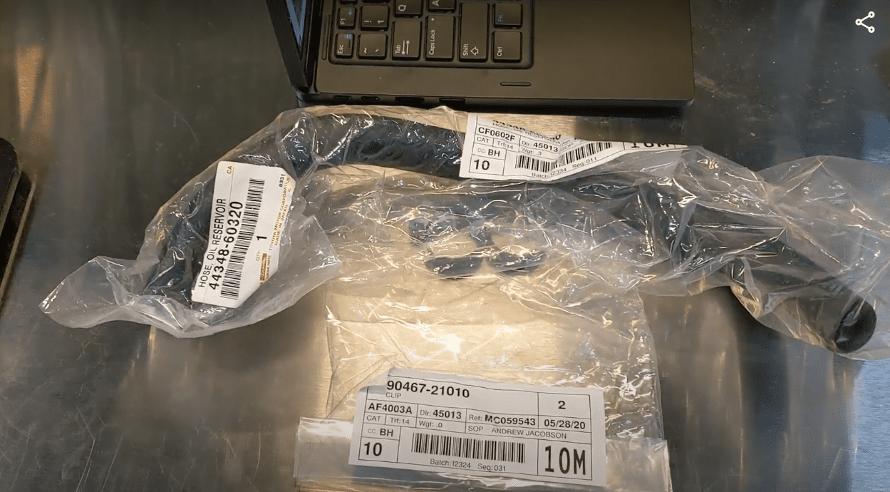

3. Also changed out the larger diameter power steering reservoir hose.
4. Discovered my rear pass axle seal is leaking. Oil residue on the backside of the brake shield. Looks like that's a big job that requires a press. I just sold my 12 ton, but looks like I'll be buying a new 20 ton (with pnuematic assist I hope) sooner than I thought.

Hey there, what sort of change in ride did you notice after installing the spacers? Like you may have seen in the other thread, my rear pressures are sitting around 8 despite having replaced the springs with brand new oem ahc springs and I’m wondering if getting the rear pressures in spec would change the ride much? Also, what prompted your most recent fluid flush?
King springs brought my pressures into range initially, then as I added stuff I drifted back out. Spacers plus king now have me a little low, 5.2 if I remember right, and the ride is similar. Maybe a little worse.
My rig has never felt uncomfortable, even with 7.9 Mpa pressure, so I'm not sure when ride harshness is affected by over spec pressure.
Fluid flush was done because it had been about 40k since it was done. I would aim for 30k between changes max.
