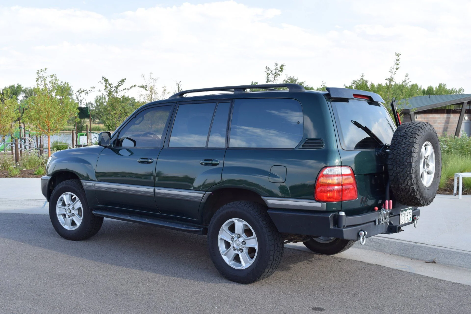

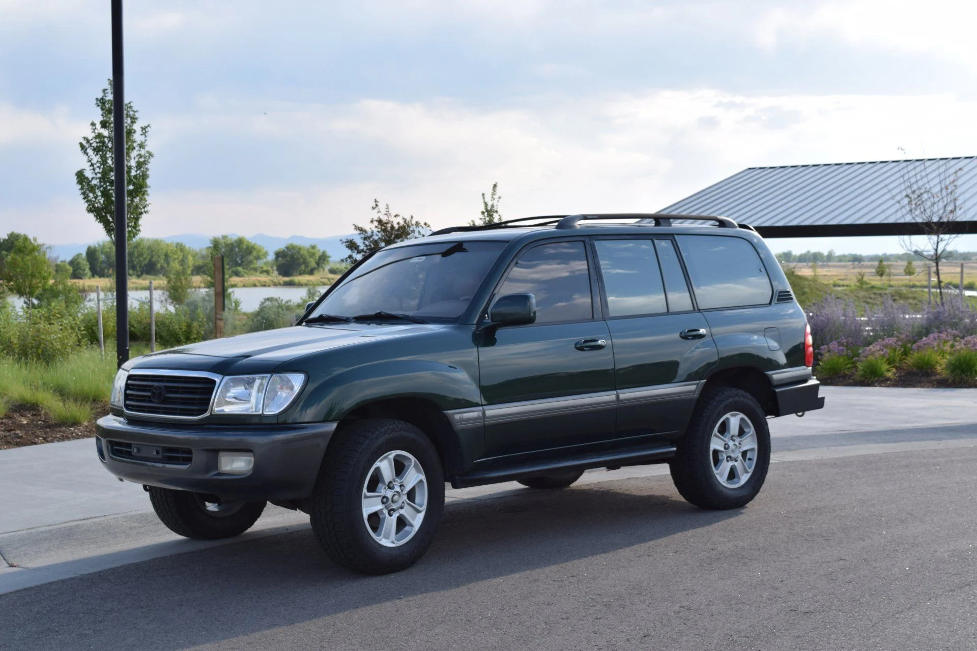

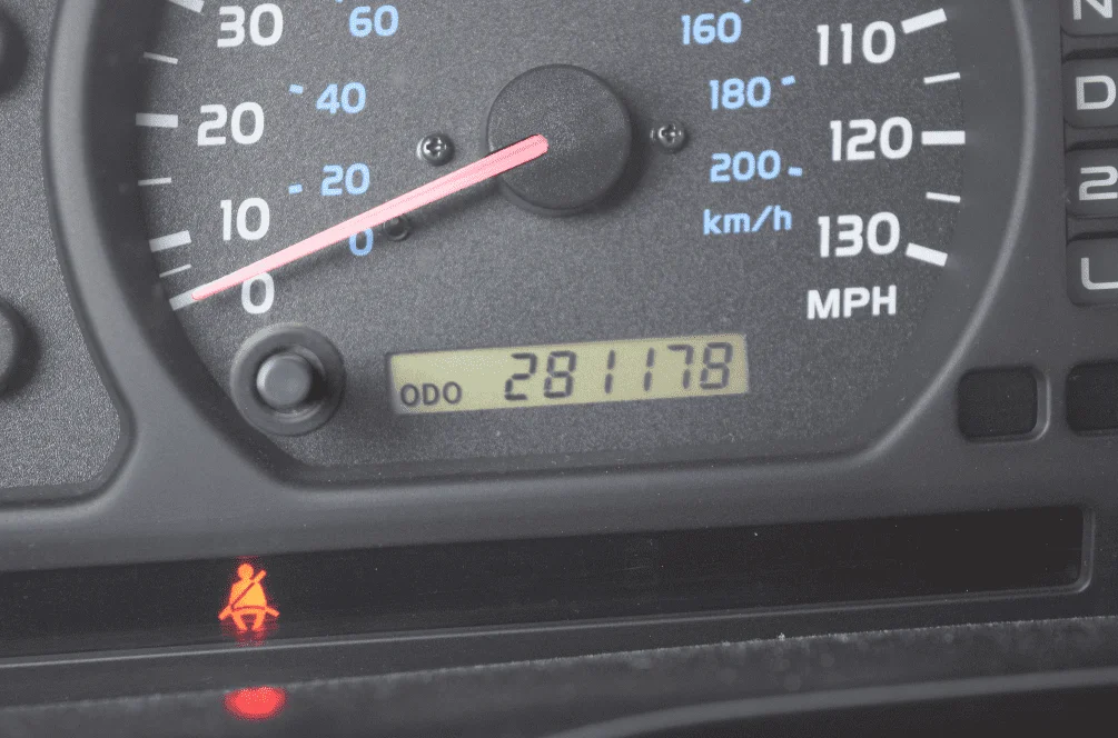

Well, lots of sanding on the roof of the LX happening today, but nothing exciting to share via pictures yet. Meanwhile, here's the old 99 all cleaned up and ready for sale at 281k.

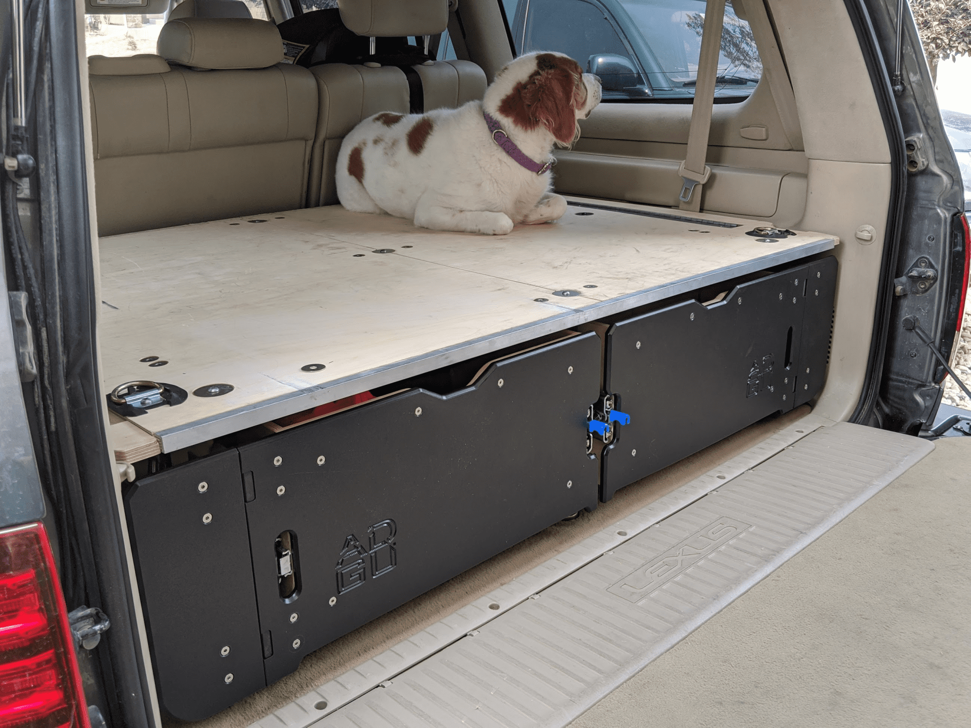

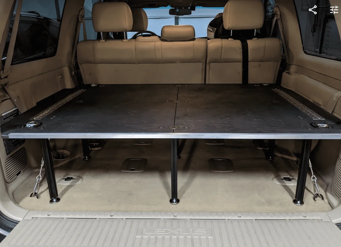

Lots of updates to chronicle, but here's some eye-candy on the new Air Down Gear Up SS1 Beauty Panels and drawer dividers.

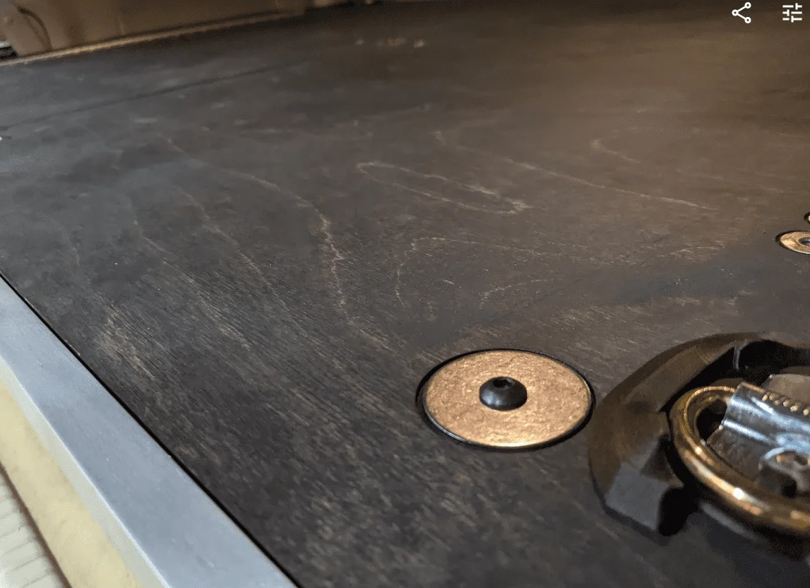

Working on setting this up now. This is a new finish option from Air Down Gear Up on the SS1. Charcoal Ash. Beautiful finish that adds protection and highlights the wood's natural grain.

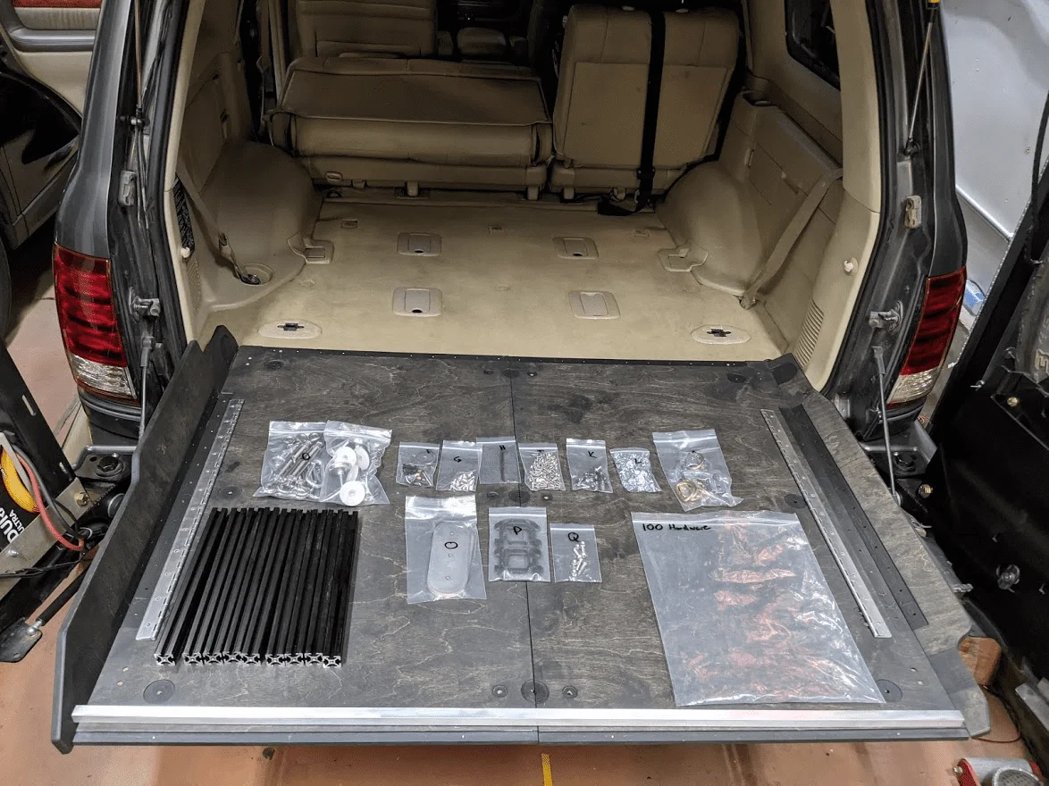

I'm thinking this time around I'll do a single drawer and a drawer fridge. The 50 qt ARB is awesome, but it's just huge. Losing a little bit of drawer space, but being able to have a compact fridge in there all the time might be worth the sacrifice.
that Charcoal Ash finish looks great. Big improvement over the bare material.
Thanks, very much agreed. Looks nicer than the furniture in my house, haha.
A few more teasers. Realizing now I didn't get a pic of the drawer back installed.

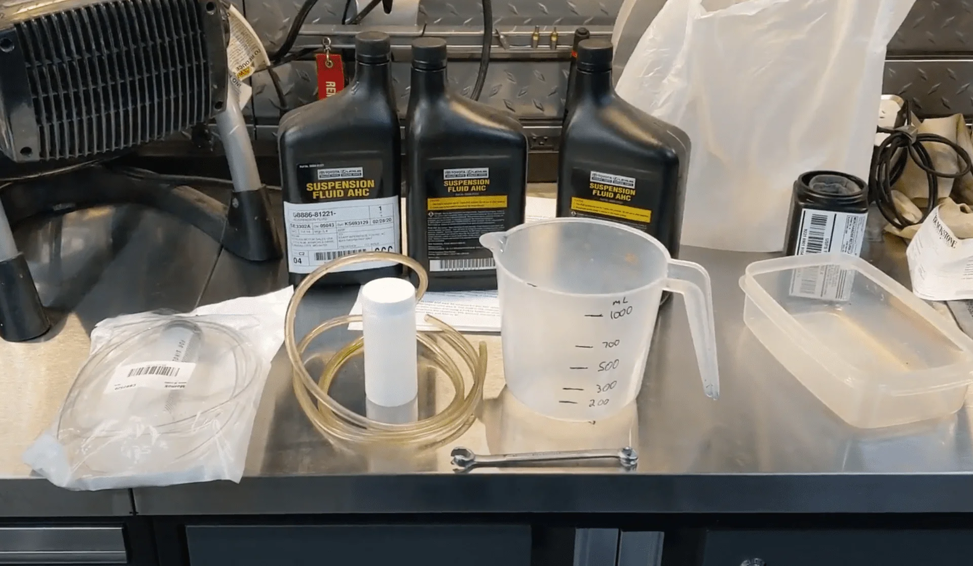

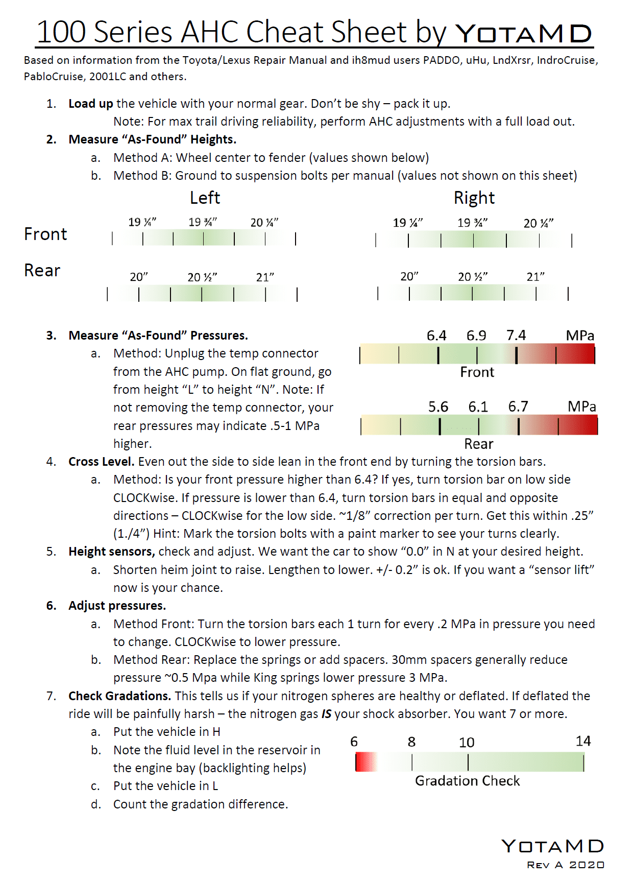

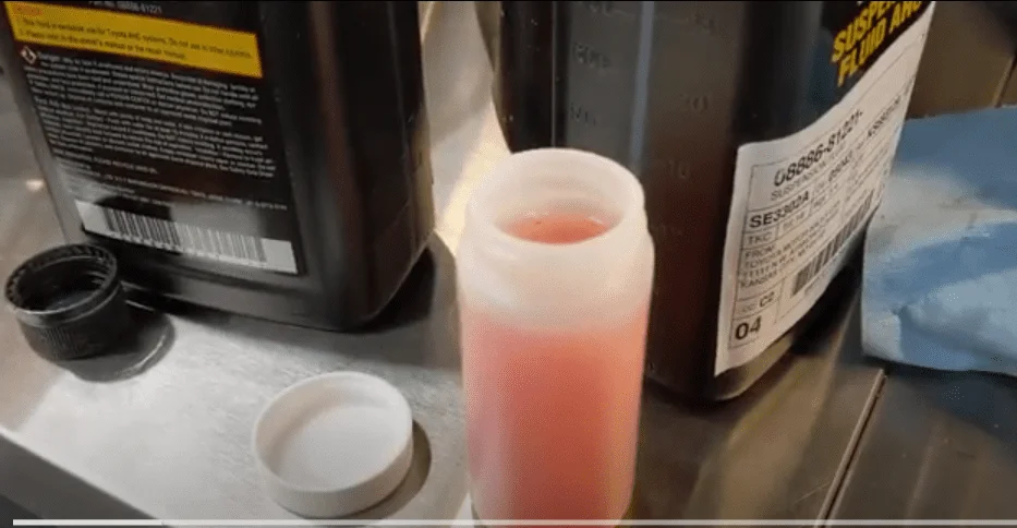

Flushed AHC fluid yesterday. Followed the @PADDO method and got it done in 60-90 minutes. Lots of that time was pulling nearly 2 liters out of the reservoir with my syringe/tube. Probably would have been 20 minutes faster using a normal baster.
It took me a while to get the accumulator to bleed any significant fluid. I had the temp sensor disconnected initially and that seems to have prevented the accumulator from filling. Either that or I just didn't wait long enough. After hooking up techstream and the temp sensor, I watched the accumulator fill then it bled about 250mL of fluid.
Also of note, my front dampers bled very little fluid. Rears bled maybe 500ml each, front only 100 or so.
Gradation test shows ~11-12 gradations. Globes are 43k miles and 6 years old.
Old AHC fluid will be sent out to Blackstone to see if they see anything of concern.
Syringe used to pull fluid very effectively (albeit slowly) from reservoir:

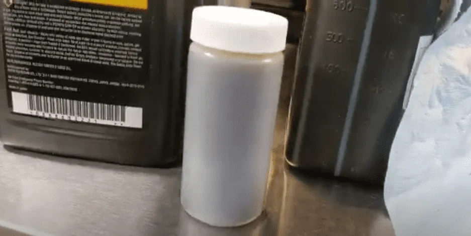

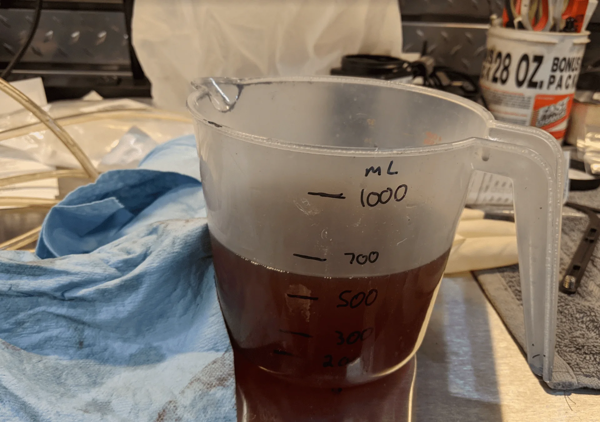

Old fluid:
New fluid:
Fluid when I stopped bleeding (slightly cleaner than when I started and a tint of red). I plan to bleed again and install new bleeders and caps and I hope that'll get the fluid closer to "fresh":
