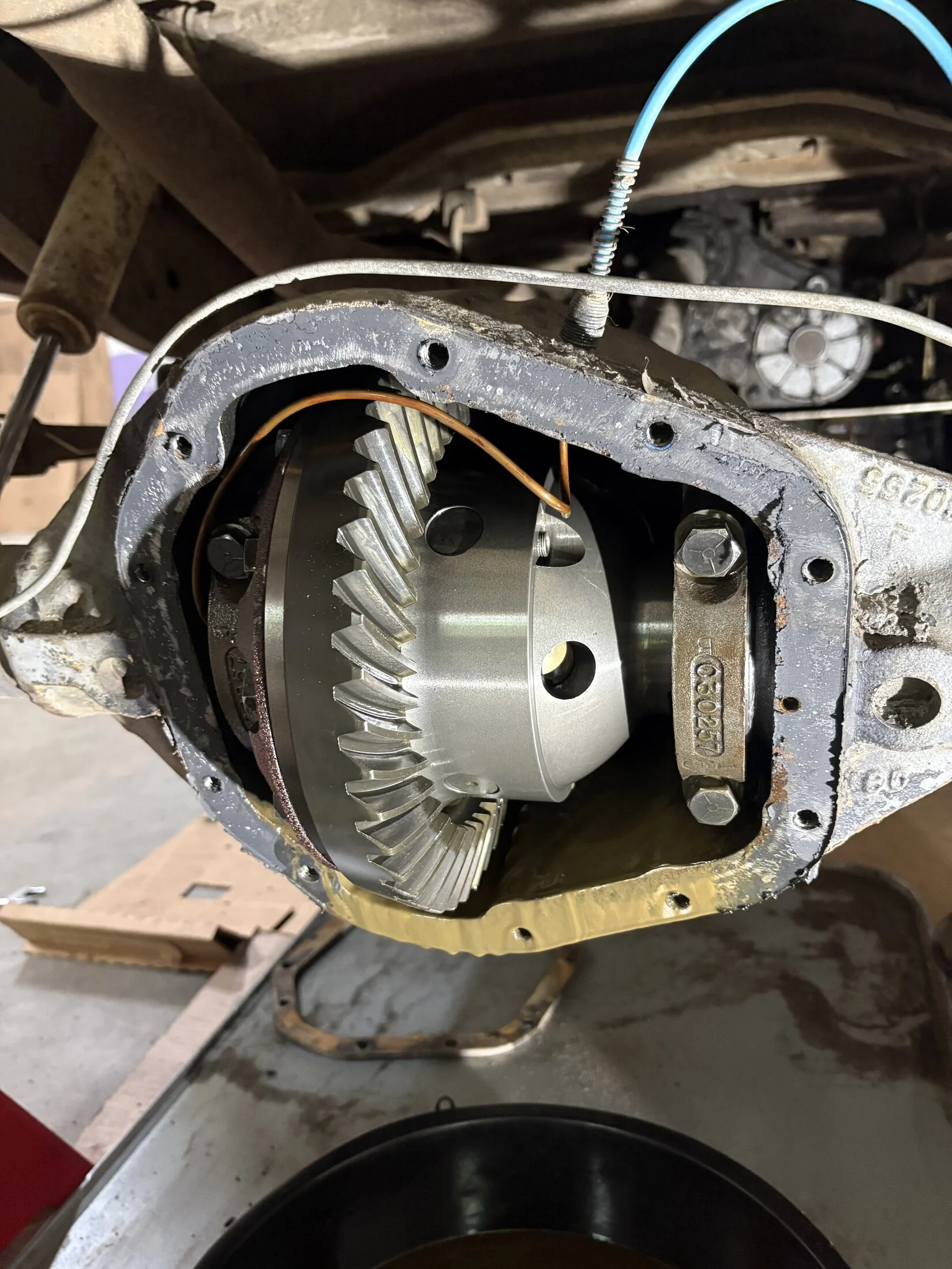

While researching Dana 60 housings I have also come to the realization that you can't get 5.29 gears for a D60, 5.38 is the closest axle ratio. I wouldn't be able to tell the difference with the pinion rotation test, but I bet the tcase can tell a difference. What a mess this is turning into.
Time to pull the cover and count teeth.
If the diffs are mismatched, you will 100% tell in 5 seconds in 4wd. It will chirp.
You really should just put an FZJ80 rear in that thing and be done. It will fix all your problems.

You are spot on, the Dana is centered and the 80 offset. Matt and I were just discussing this via text, he did say that the 80 is 4" less offset than the 60 housing so that is a help. I have done some more internet research and found out that a lot of mini truck guys run a Dana 44 in the front with the 5.38, 5.29 combo and get away with it. sofj45 is right though, this rig has been together for a while. I can't confirm when the gears and ARB's were installed, it may have been the most recent PO. I might just try to run it and see what happens.
Not like you have to jump on a decision right away, but considering the rest of the drivetrain, I’d look into just getting a Dana 60 and building it right, and installing that at some point down the road. Not much point in reverting back to something Toyota that ‘might’ work or work OK.
