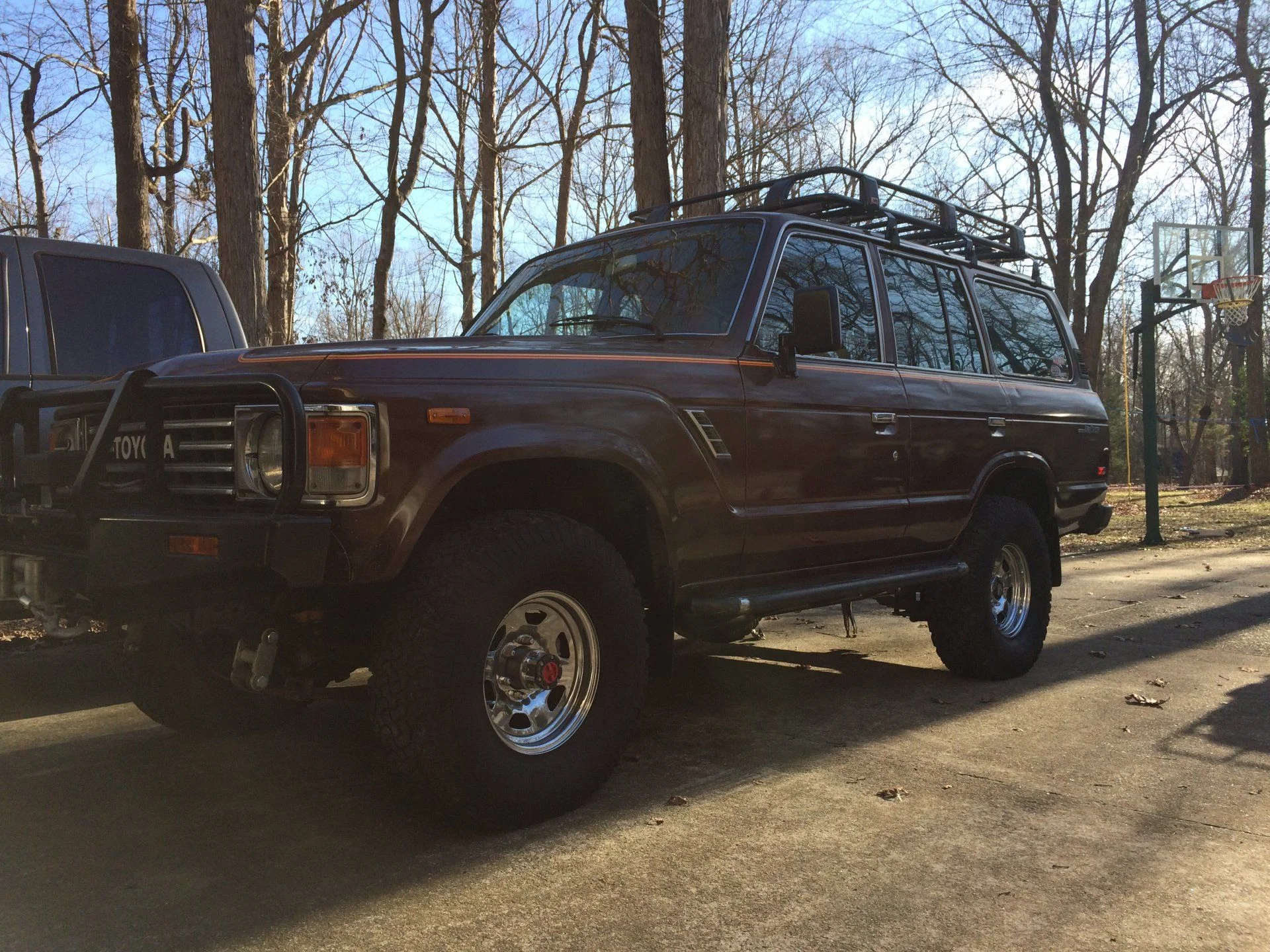

I found a set of ARB side steps on Craigslist for a decent price. They are the NLA homely ones with the front fender protection bars that connect to the old style ARB front bumper. I have the new style bumper so I knew these would not work without modifications. I'm not a fan of the ugly fender piece anyway so I hacked them up and welded some tubing to make these steps into light / medium duty step sliders.
Test fit. Next will be priming, painting and final install. I plan to fab up a third mount point in the center to connect to the frame. I've got a little over $200 in these and my hope is that they will offer some protection as well as provide a step for the kids to get in and out more easily. Heck, having a step just might help me save what's left of the upholstery on the side of my driver's seat. Guess we'll see.
