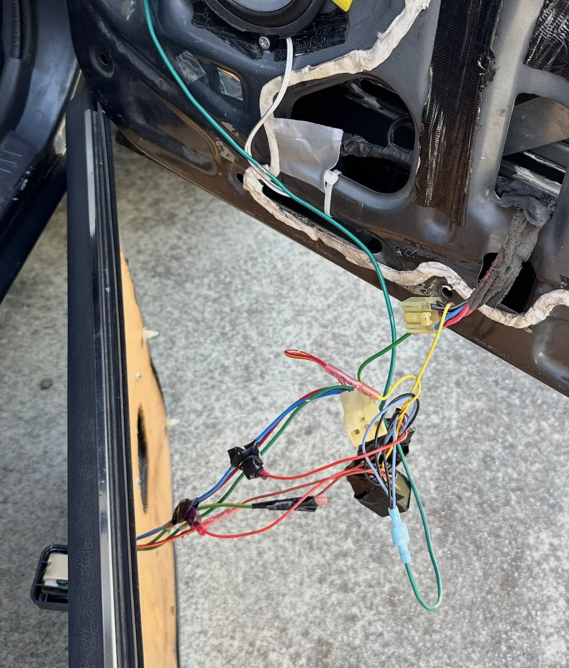

Discovered this mess today - relays installed to make the switch last longer so that the full motor current doesn't have to pass through the switch contacts. One for up, one for down. I'm an electrical engineer by trade so I'm going to design & fab a small PCB that replaces this rats nest. It will be functional for any Land Cruiser with power windows - both 12V and 24V systems. I should have a design done tonight and will order prototypes in the next week from the assembly house.

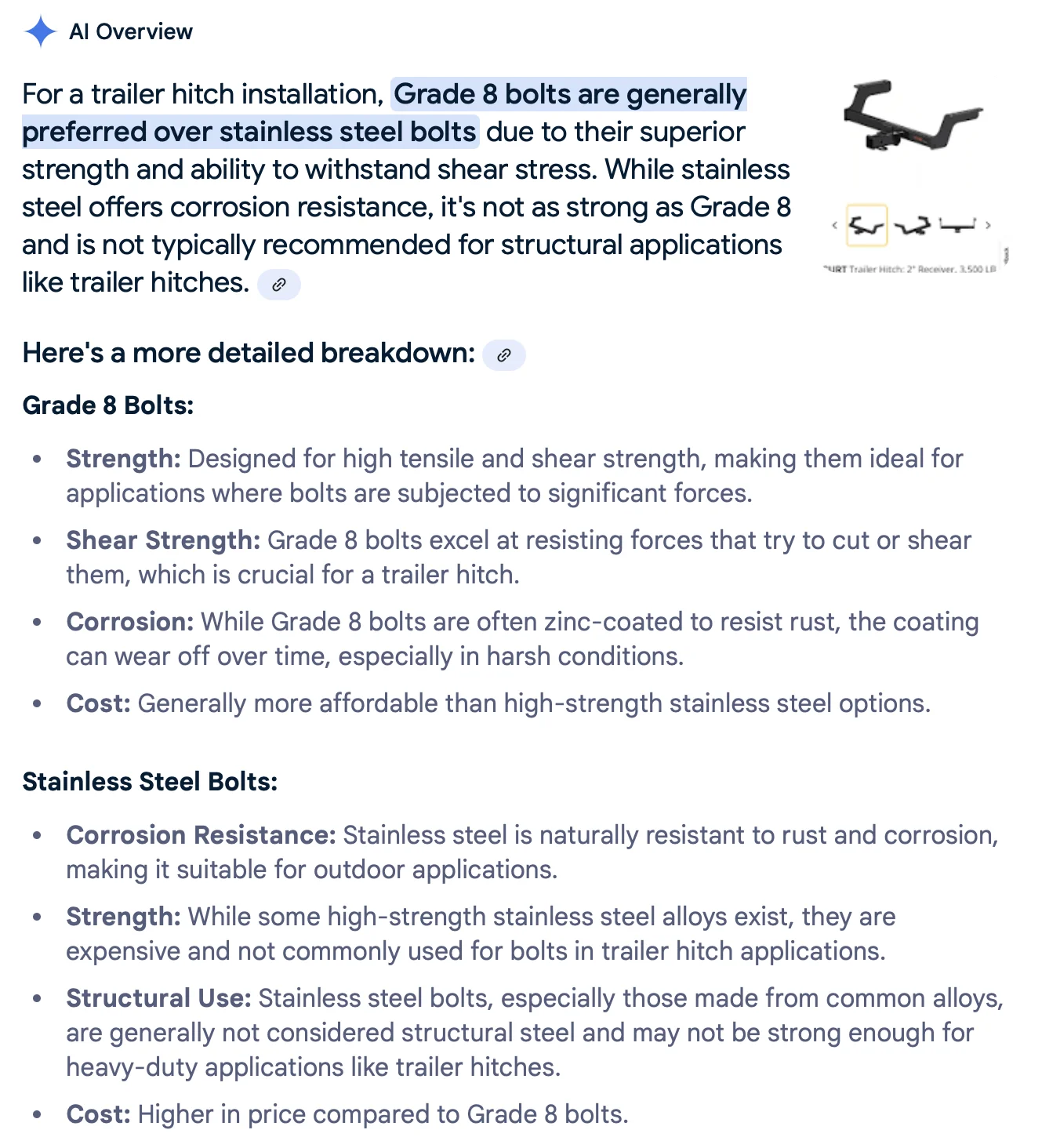

You might want to swap out the stainless for Grade 8 bolts. Or at least do some research. I think stainless is fairly soft and may no be the best choice for this application. Otherwise, it looks great.
EDIT: From a quick Google search, with the AI generated response, for what it's worth:
Good call! I’ll do that. I don’t intend to tow anything - just use it for a bike rack. But I’ll get all the hardware to swap to grade 8 in the next couple weeks.

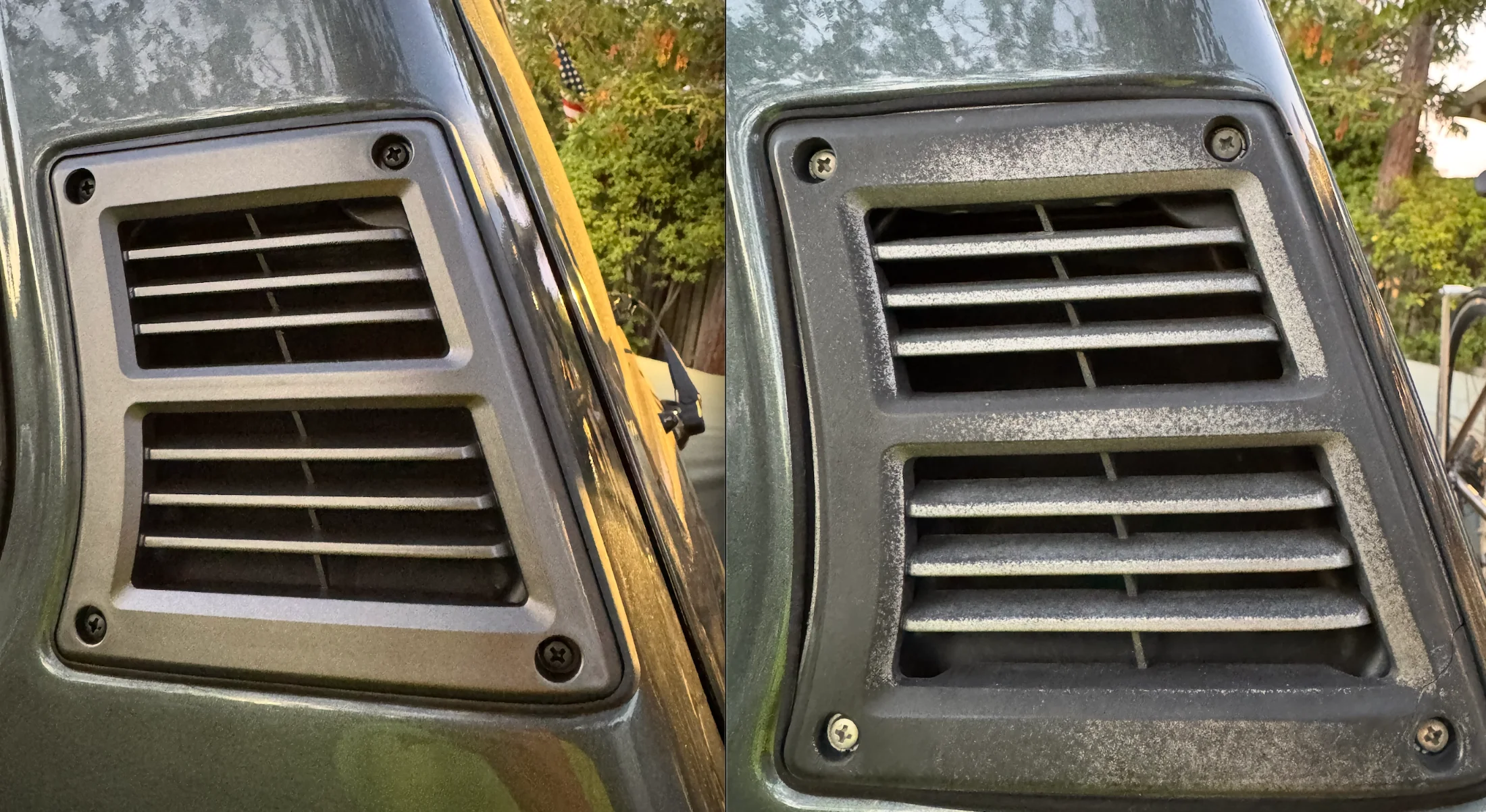

Replaced the faded & cracked D pillar vents with the repro kit from the rust farmers. Before is right, after is left. Looks great! My original vents' gasket was completely hard from aging in the sun.
