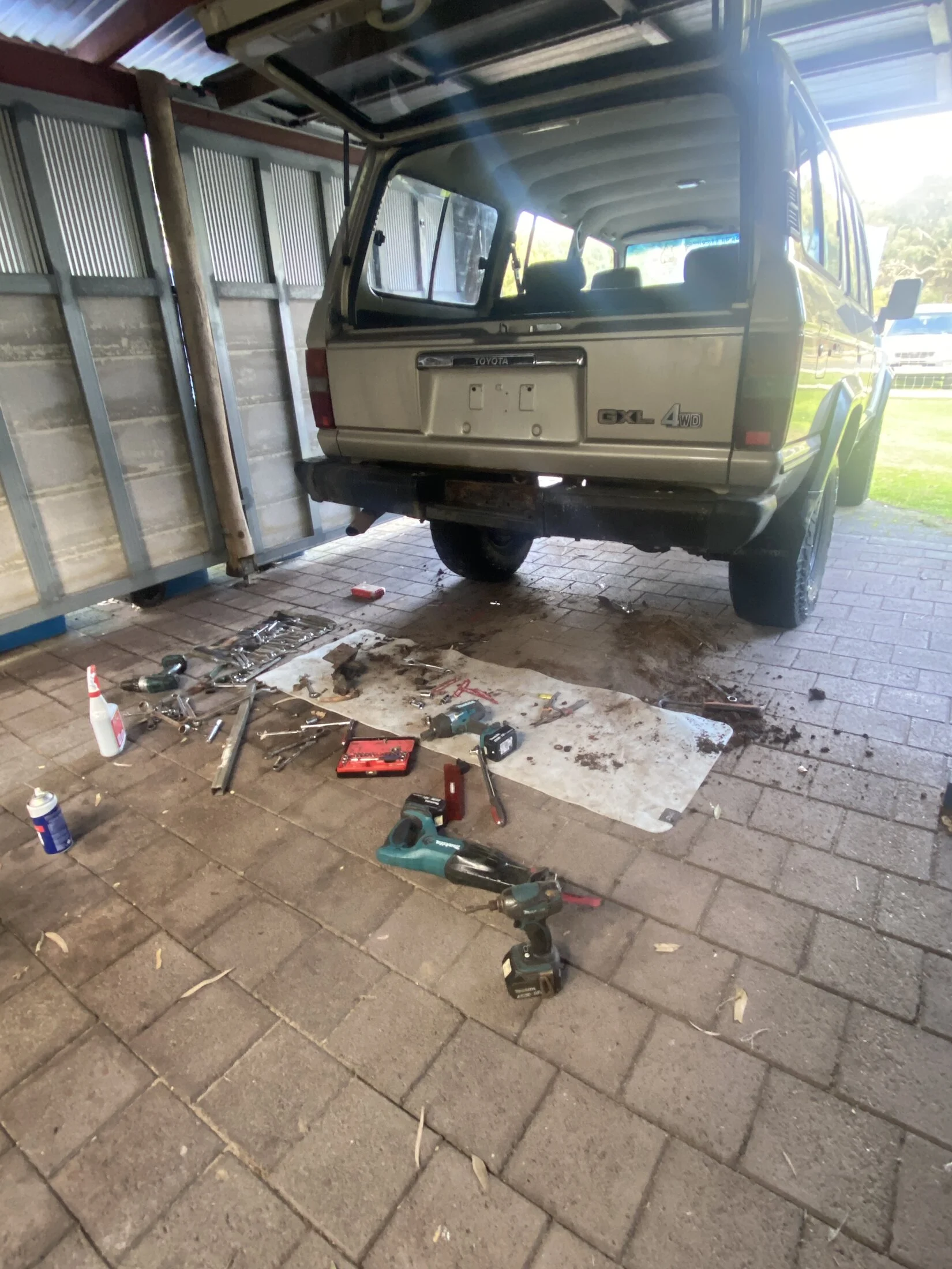

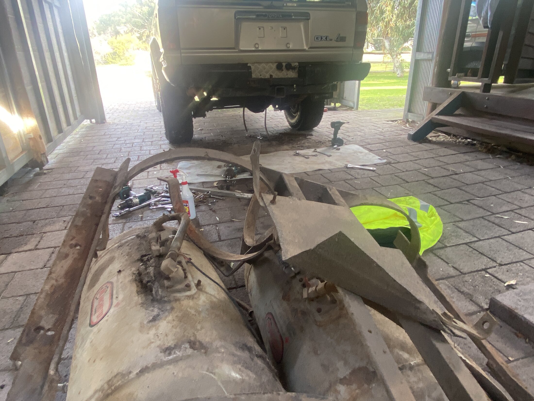

I have been on work holidays for the past 2 weeks - but haven’t achieved a whole lot! Been frustrated with seized bolts, so spent a fair bit on a impact wrench which helpless me to remove the gas system and old tow bar..

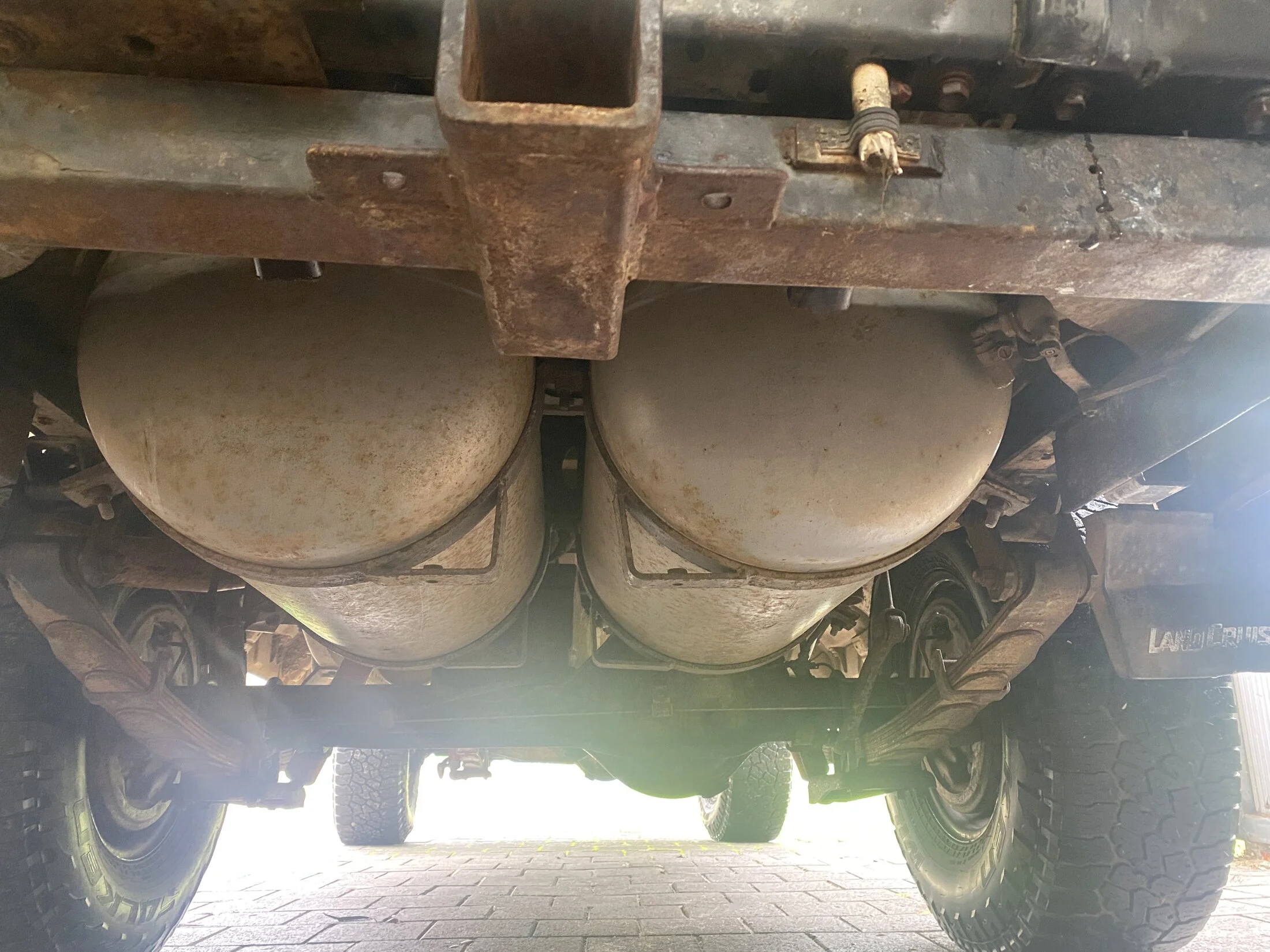

What is going on there??? Is it running on propane or something??

Yep - back in the late 90’s or early 2000’s the Aus government would give you cash back to install lpg I to your car (petrol or diesel - I had gas injection installed into my 1hz 80 series)… nowadays it isn’t worth it (I believe) due to the lower mpg / less power / complexity of the system / wear on everything / availability of lpg etc…. This fj62 is going back to as standard as I can get it…

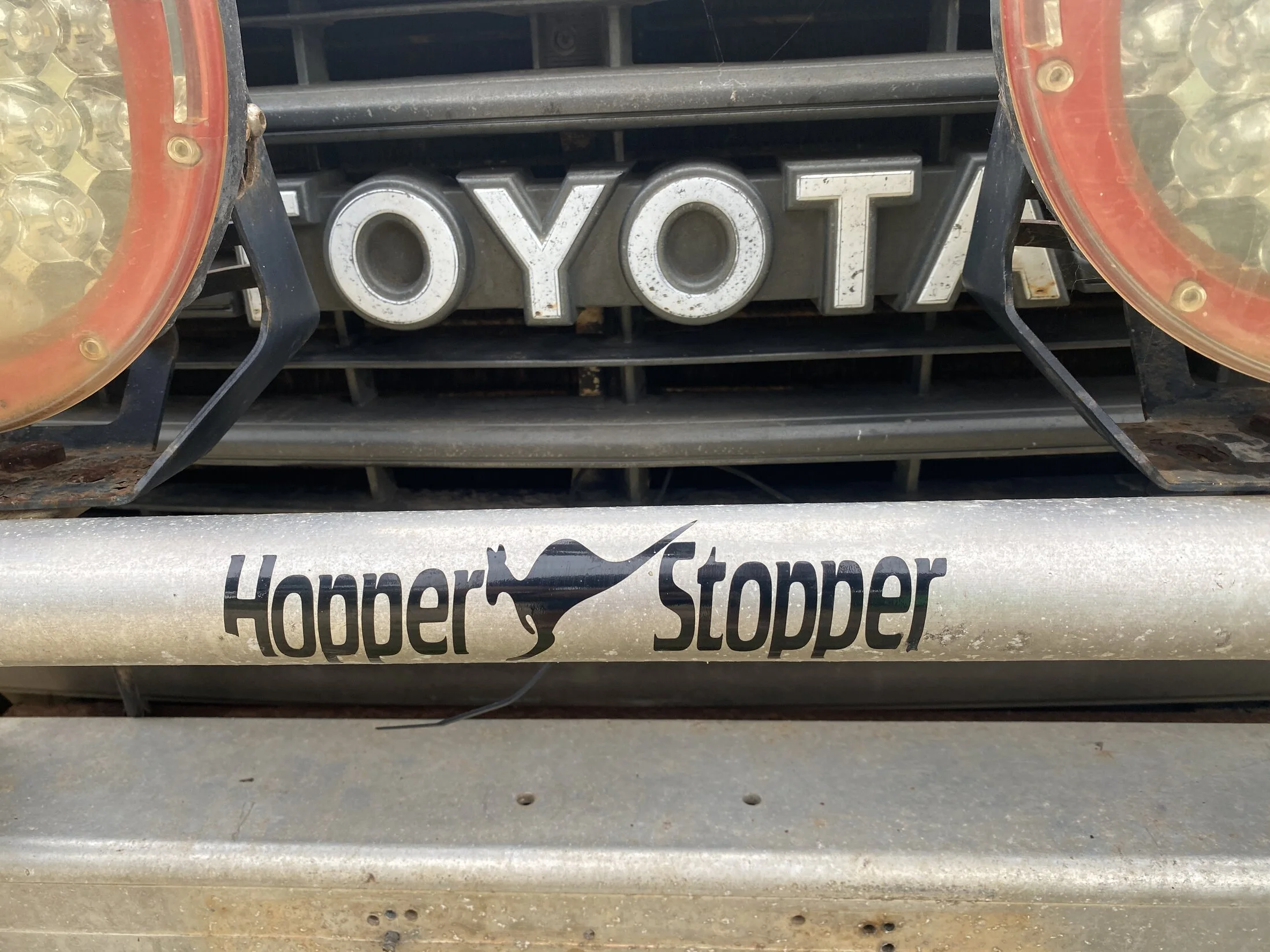

Haven’t had much of a chance to work on the Hopper Stopper over the last couple of months, but this weekend I decided to take the bullbar off to continue to get it back to all as standard as I can. The nice, lightweight bullbar had a surprise tucked I. Behind it!!! About 75kg (165lb) of mild steel flat bar was mounted between the chassis rails, tucked into the bull bar!! Glad I removed it!!

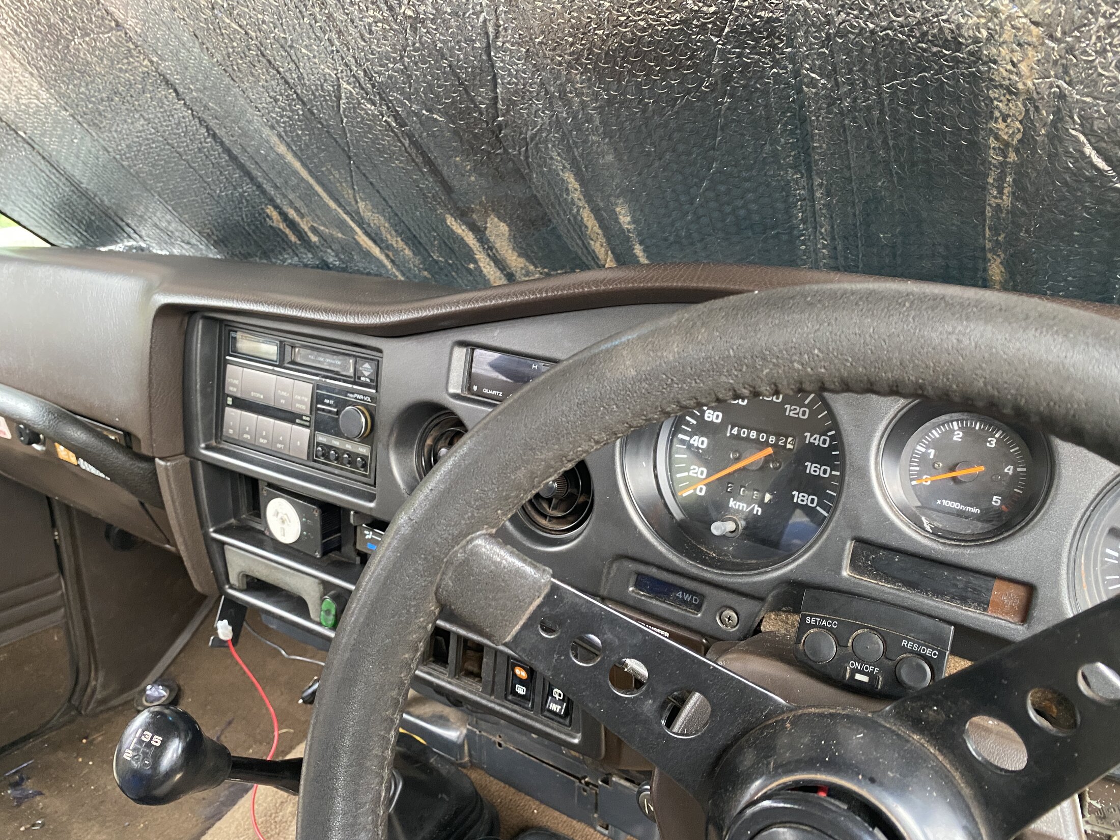

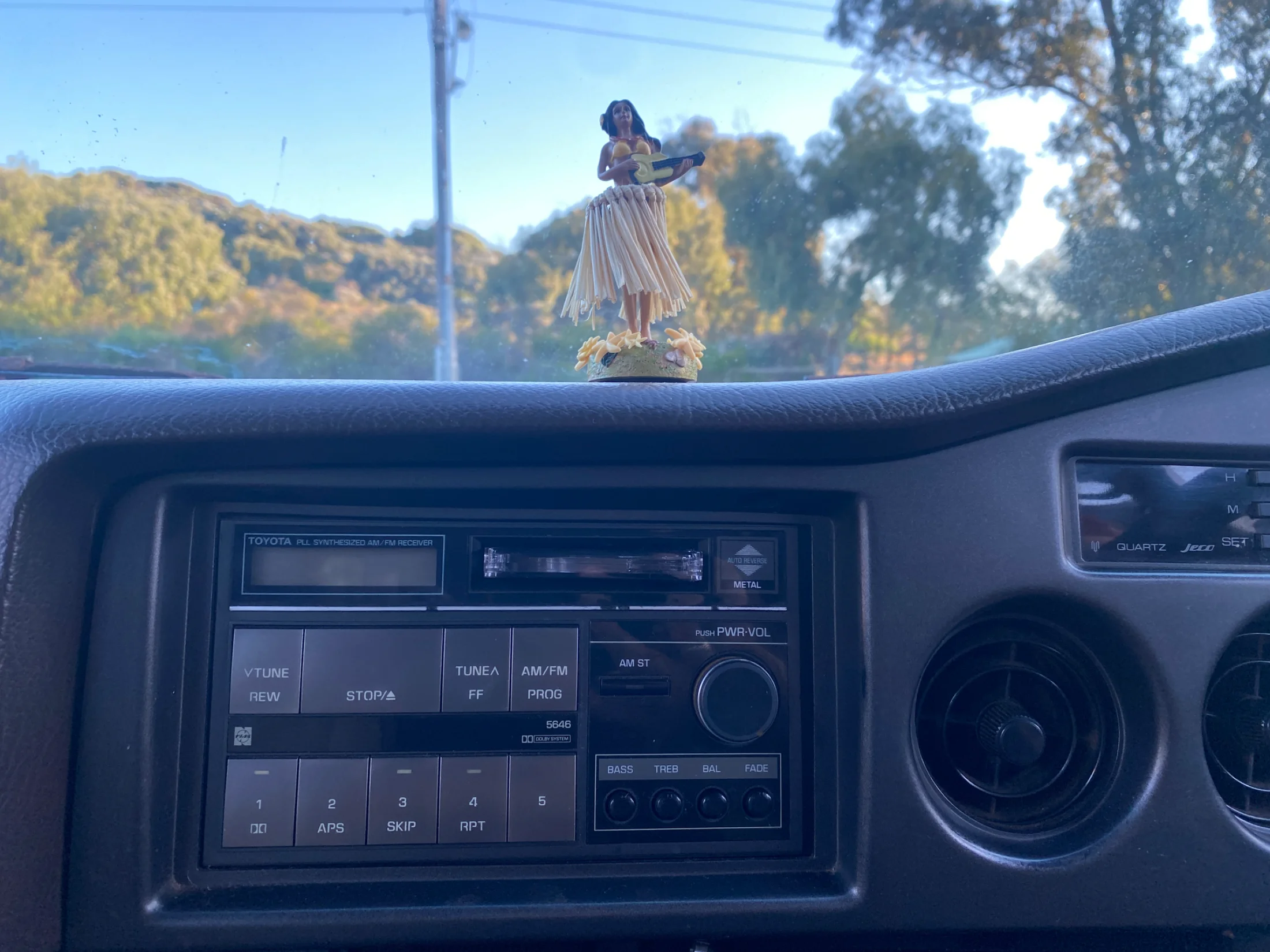

From the photo above - also worked out the factory double-din cassette player works (
Managed to get a John Farnham cassette from my wife’s parents to try it!!)
The 1989 factory speakers suck though!!
