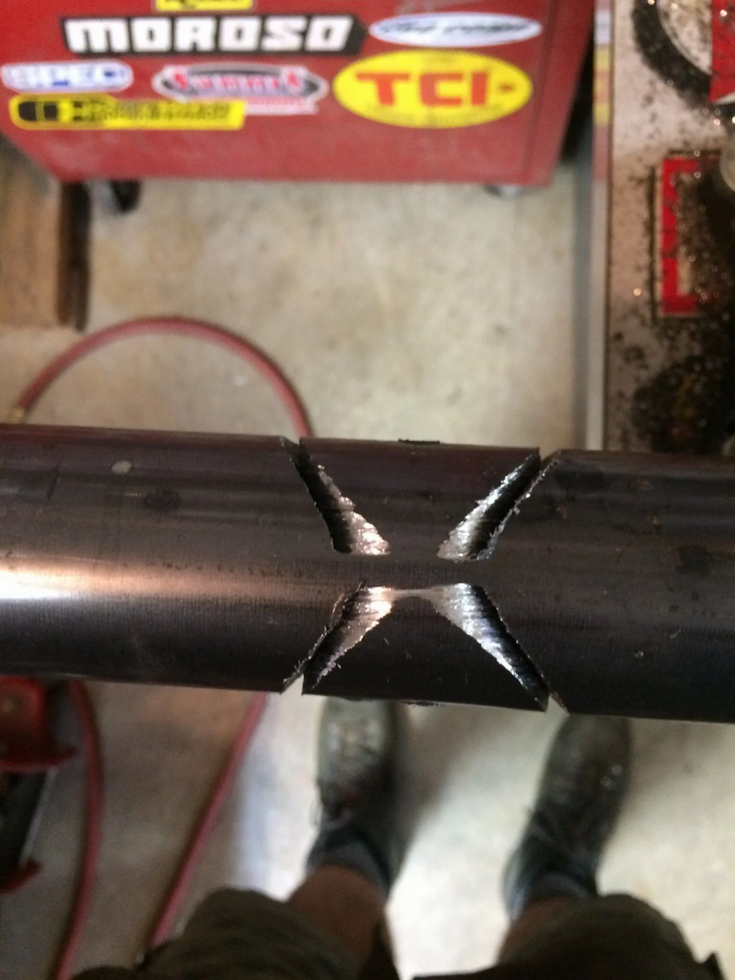

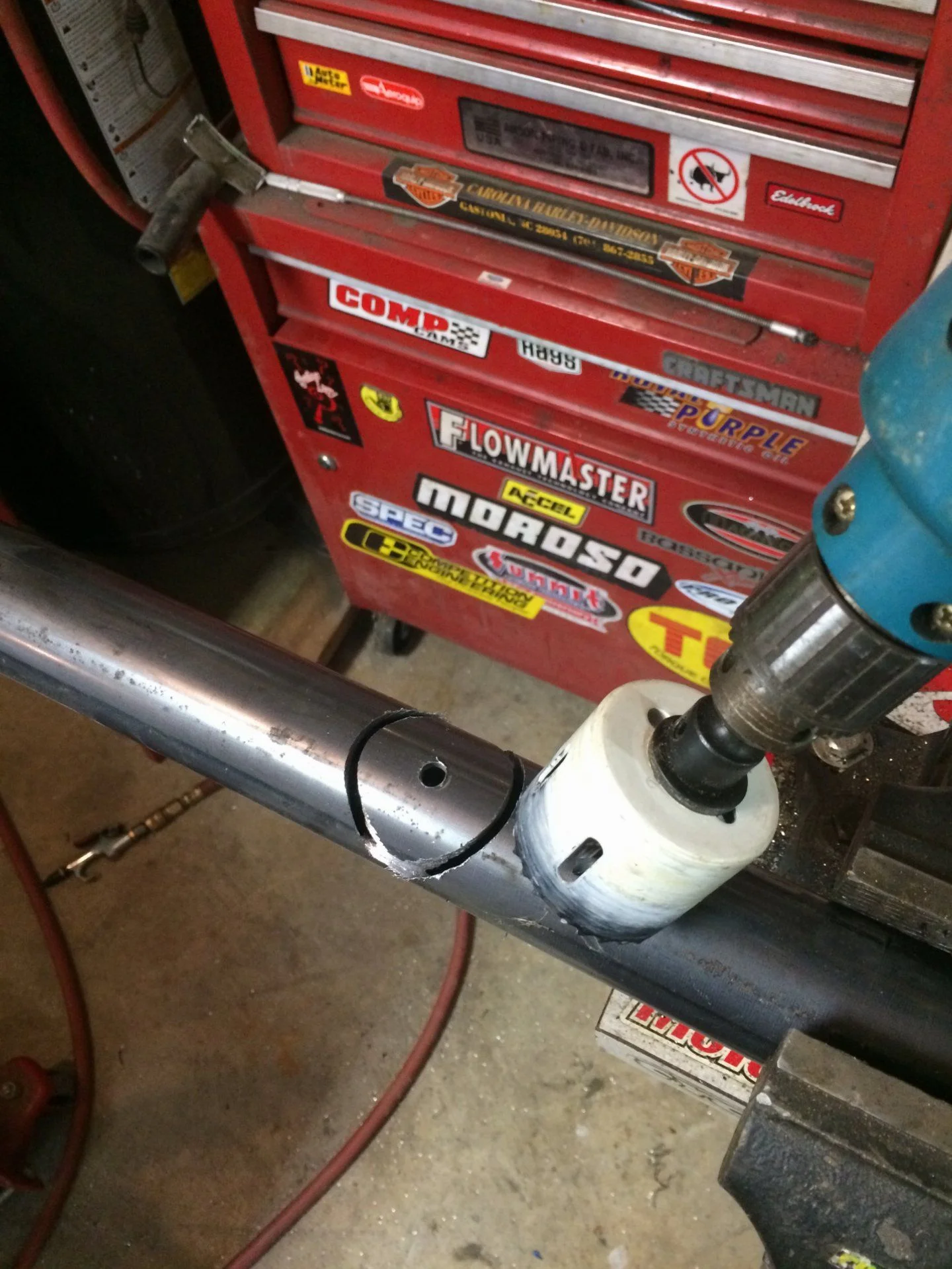

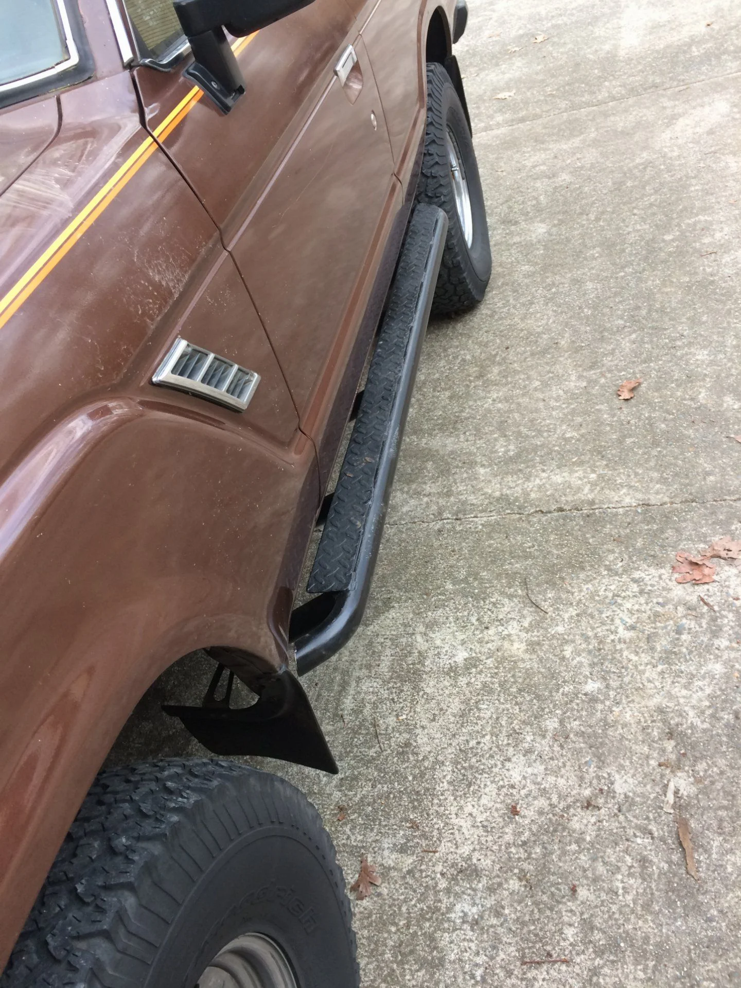

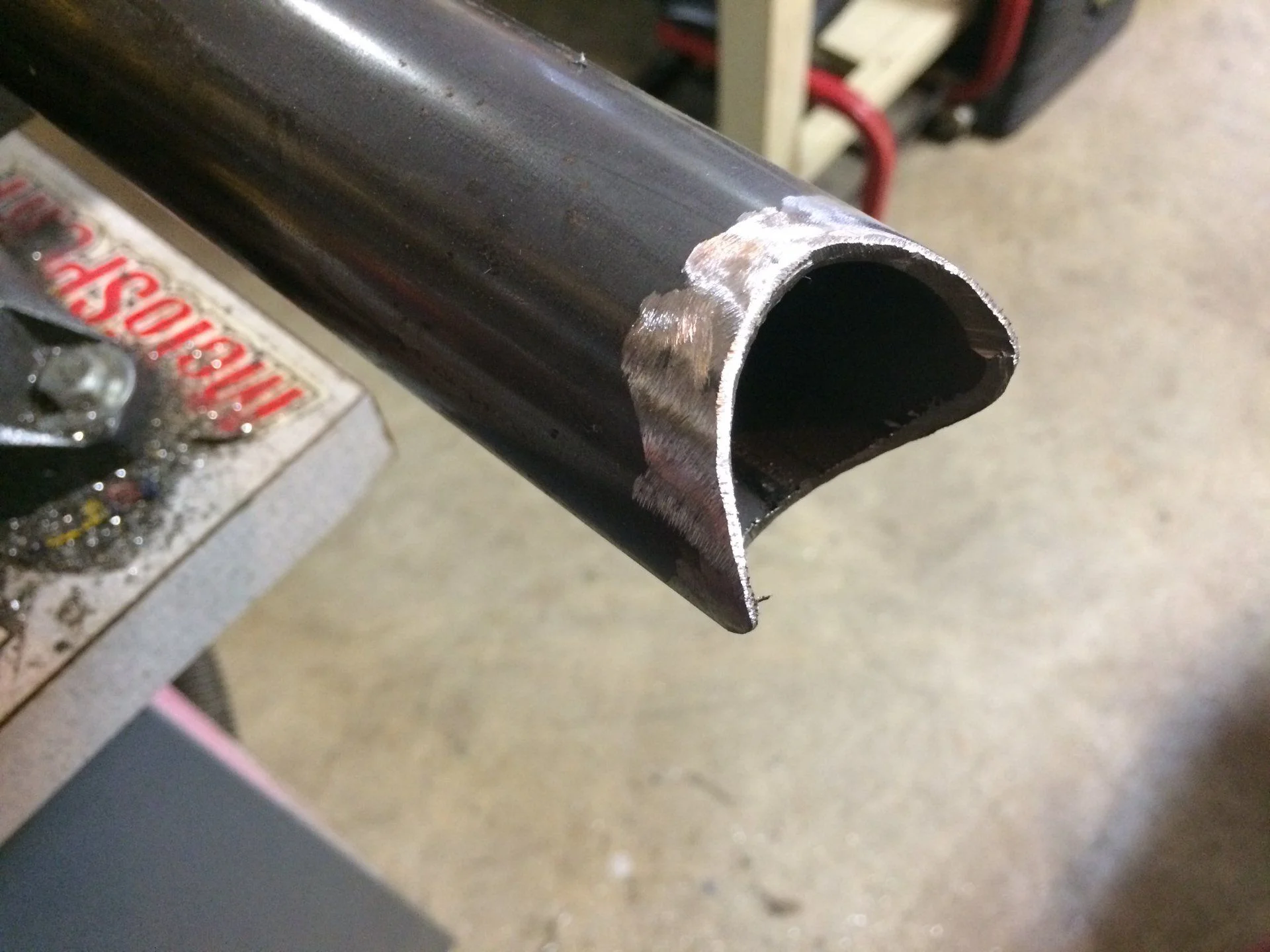

I did some more work on the side step/sliders. I decided that they stuck out too far so I chopped off the frame mounts, removed 1.5" of tube and re-welded the mounts. I like the way they fit now. I'll do some before and after pics later. For now, here's some more pics of how I modified the ARB steps and made them into sliders.

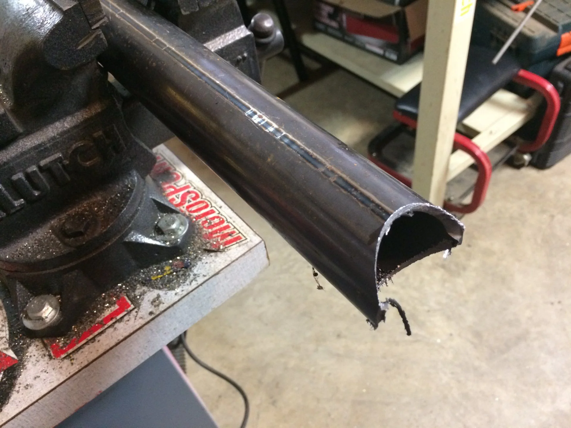

D,
I've always used a notcher or a chopsaw to make my cuts. How did the freehand holesaw treat you? Any binding/catching?
Just for future reference if you ever want to try the chopsaw method.
J
Jason, I don't have a chop saw or a notcher. I am just a shade tree hack. I used what I had on hand: Sawzall, 4.5" angle grinder and a drill. I did several notches with only the angle grinder but I wasn't real happy with how they turned out vs. the time spent on them. I looked around and found that old hole saw that I had used many times for cutting door knob holes in doors. It was a Lennox brand marked as okay for metal and wood so I chucked it in the old Makita corded drill. It worked a lot better than just notching with an angle grinder. It was slow though. There was some binding and catching but it wasn't terrible. If I were to do many more of these I would have to go out and buy a chop saw.
My goal with everything I do related to 'Cruisers is to have the best possible end result using the least amount of money humanly possible. That's why I do things like adapt a 100 series rack to fit on a 60, or recurve my own distributor with MSD springs, cut up an old pair of seats to graft in the headrests to my rear bench, or drill, tap, bolt and weld a busted harmonic balancer. Heck, I painted my FJ40 with rattle can Rustoleum!
The things that I do are not for everyone. One could argue that some of the things I do are halfassed. I don't think that is necessarily true. In my mind there is a fine line between doing something halfassed and doing it on the cheap. I shoot for cheap and not halfassed. The same idea goes for hacking up these old ARB steps. They were dirt cheap used from the local Craigslist. My hope is that I can make them look better, perform better and have fun doing it all for about $200. Can't beat that! Hopefully they won't look too halfassed when I'm done. I guess we'll see...

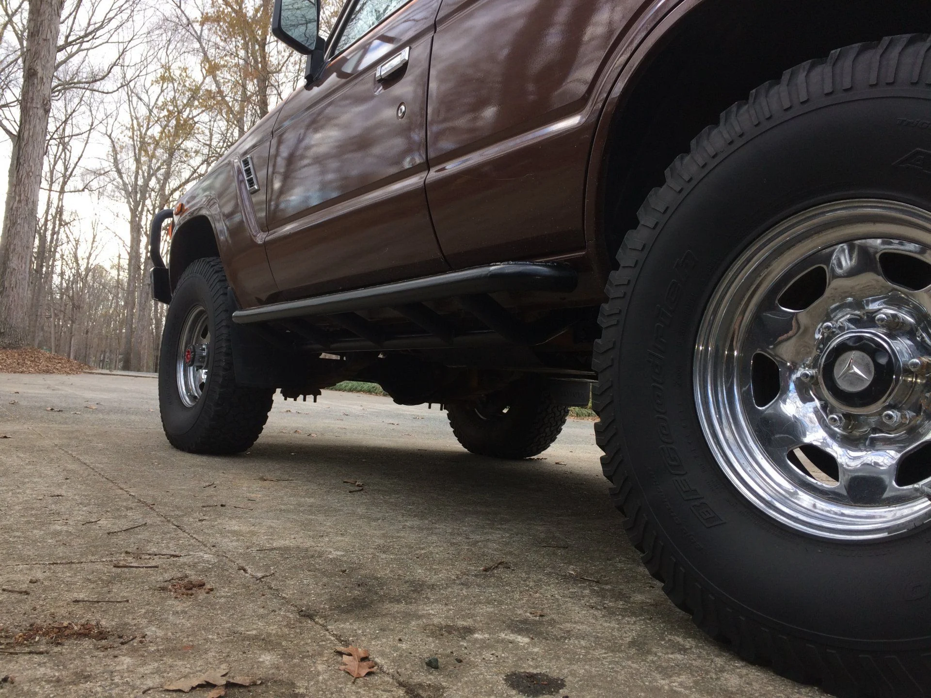

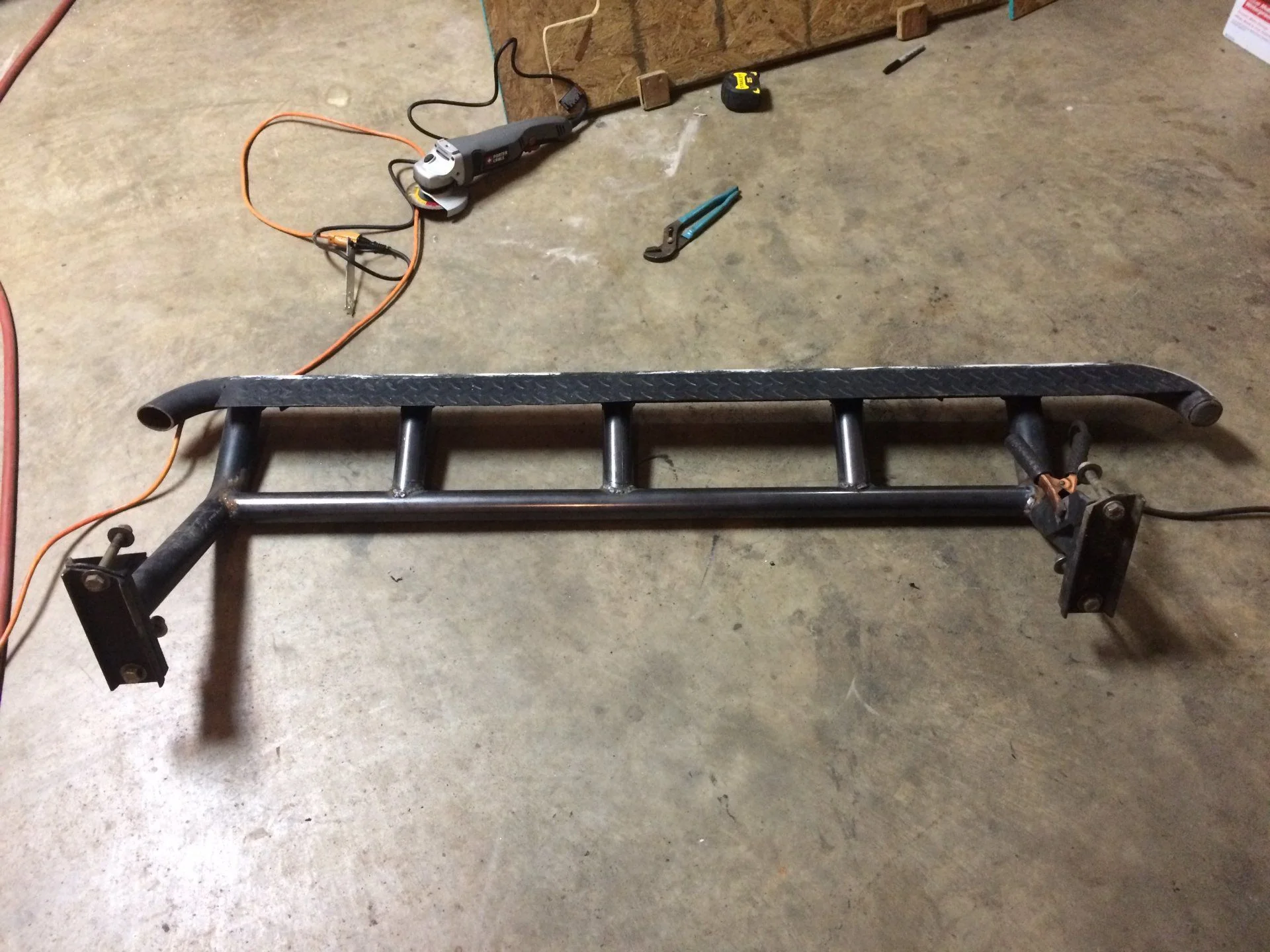

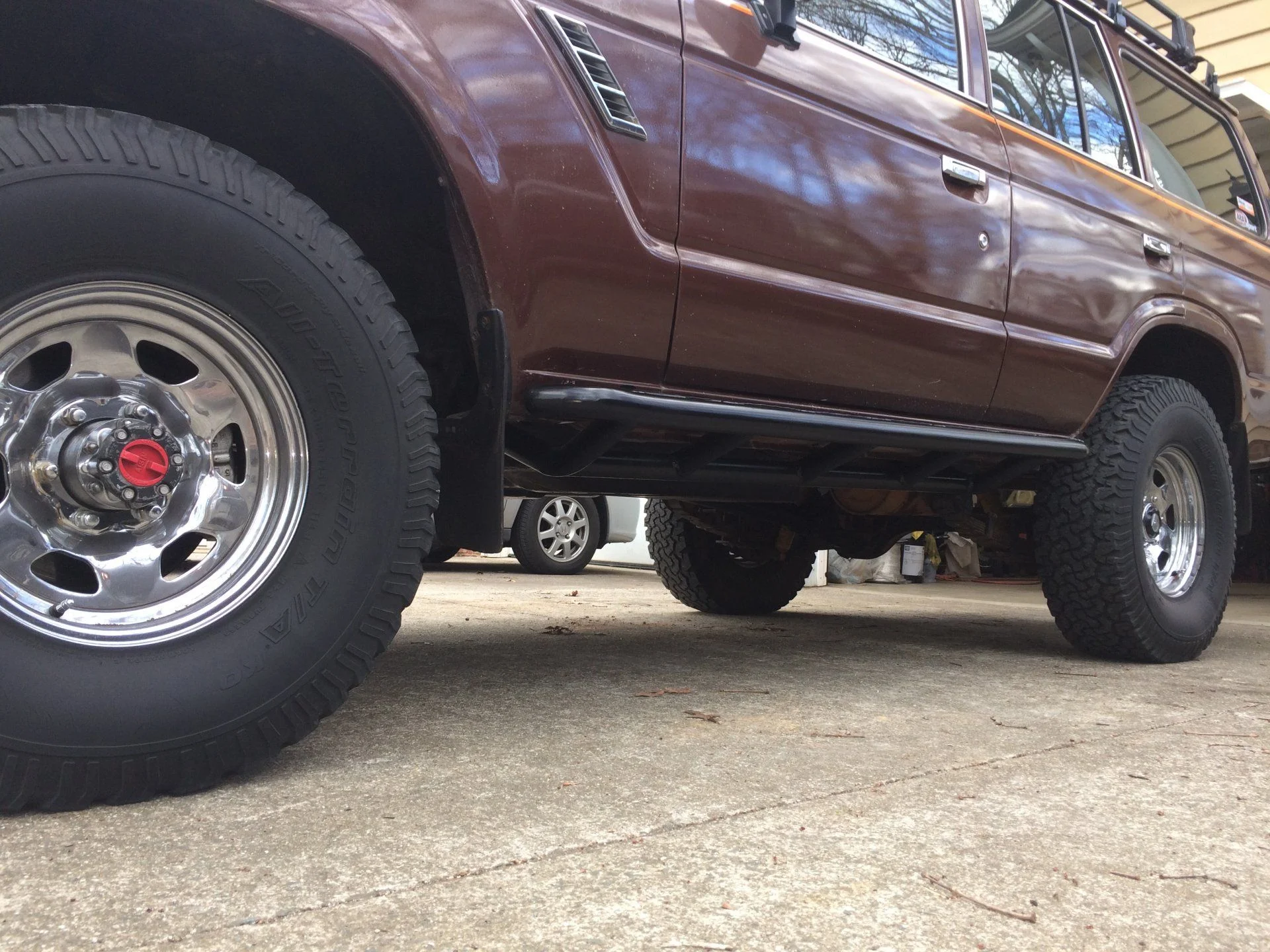

Here's a pic of the ARB step/sliders before I removed material to snug them up to the body.
...and after
The finished product:
Those look right nice. :clap:

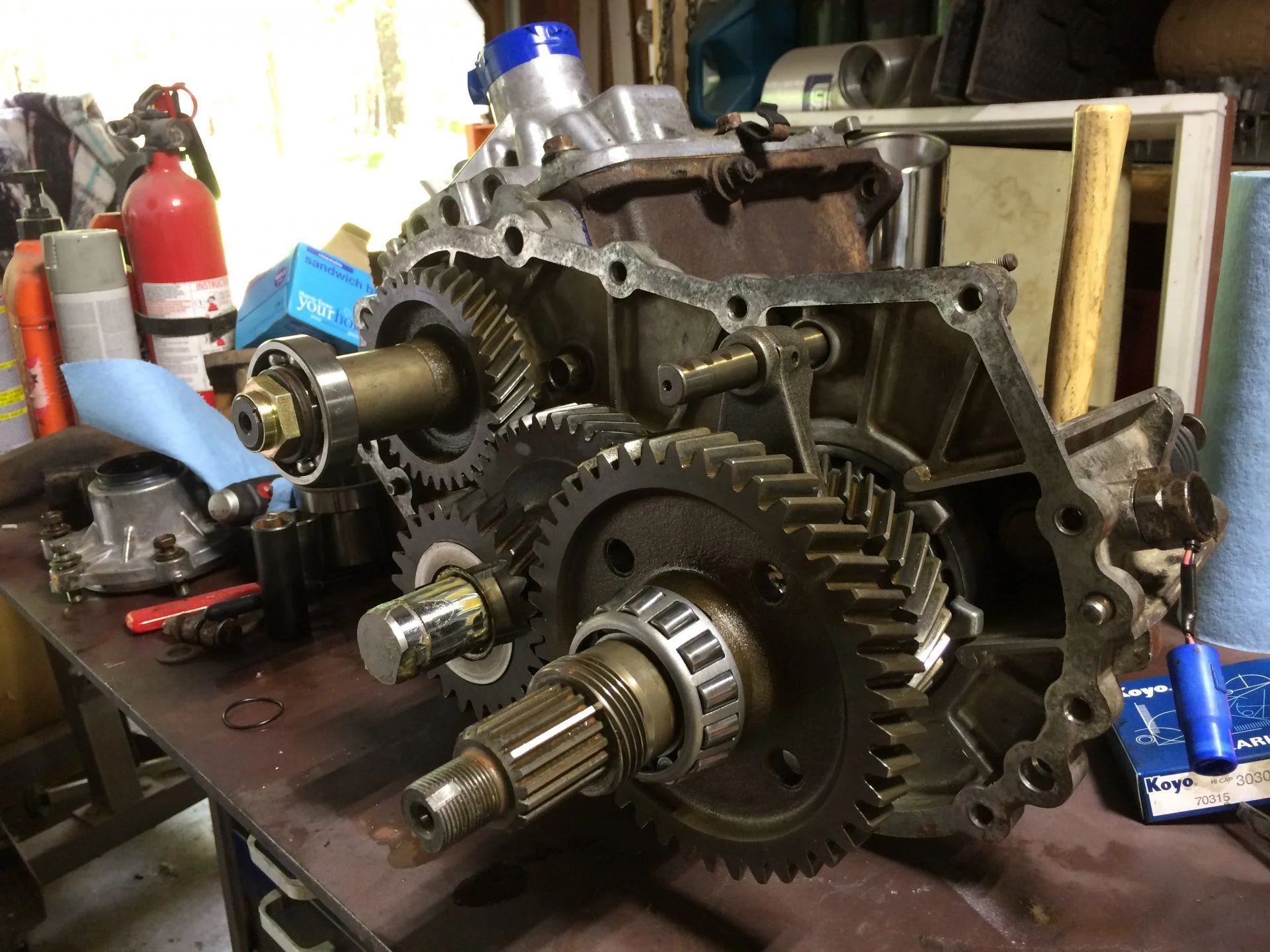

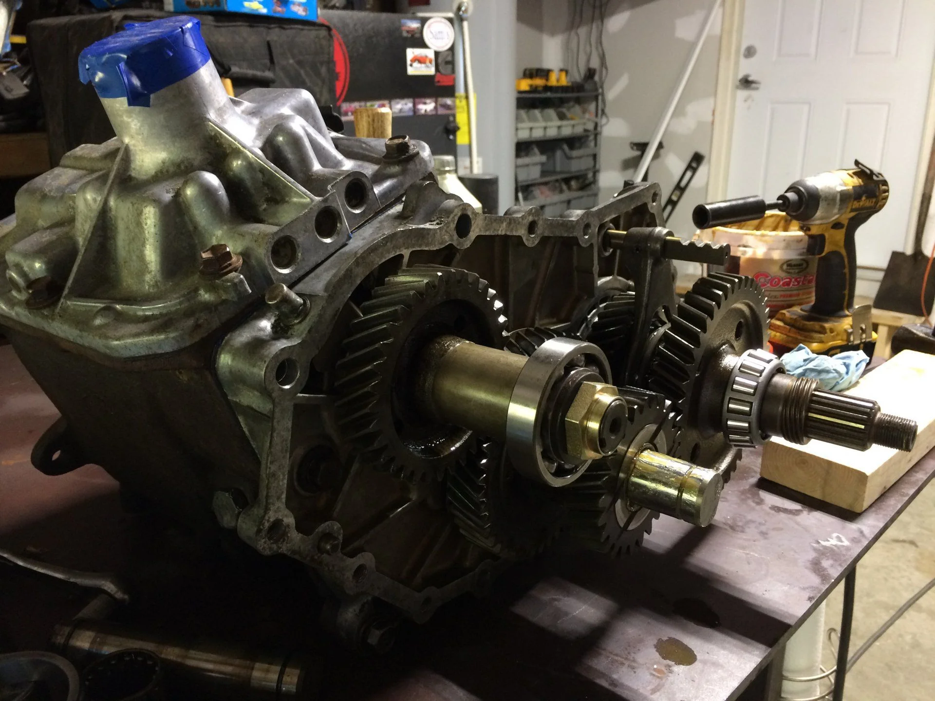

On Sunday I took my spare trans and transfer case up to @GLTHFJ60 's house and we rebuilt the split case. We got 99 percent finished but we ended up needing a smaller shim than the one that was in the case. Of course the Terrain Tamer rebuild kit did not have shims, so I'll have to source a set from Mr. T. Thanks for your expertise and for the use of your shop and tools, Johnny. I really do appreciate it.

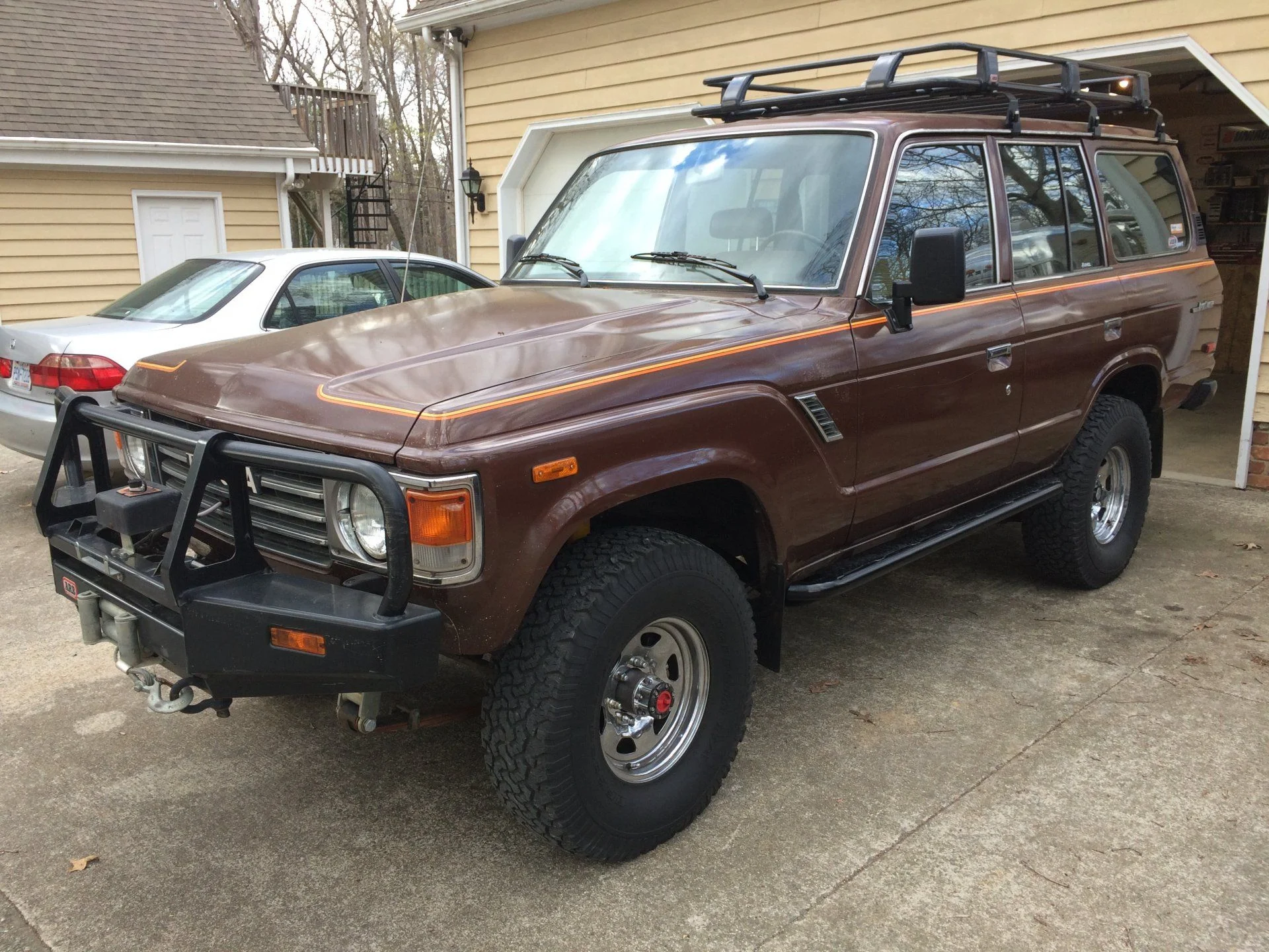

Turdle is ready to go fishin'!
