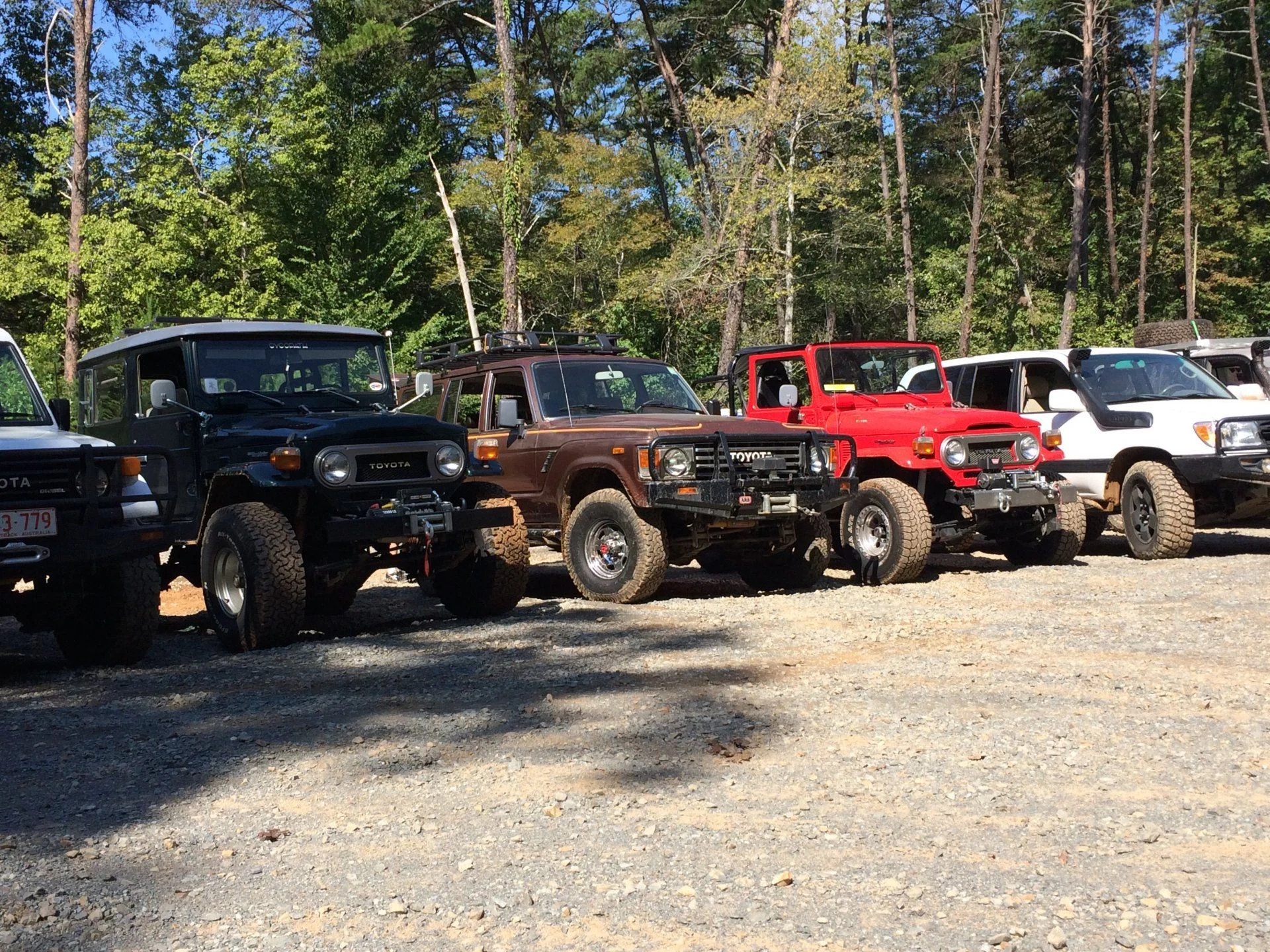

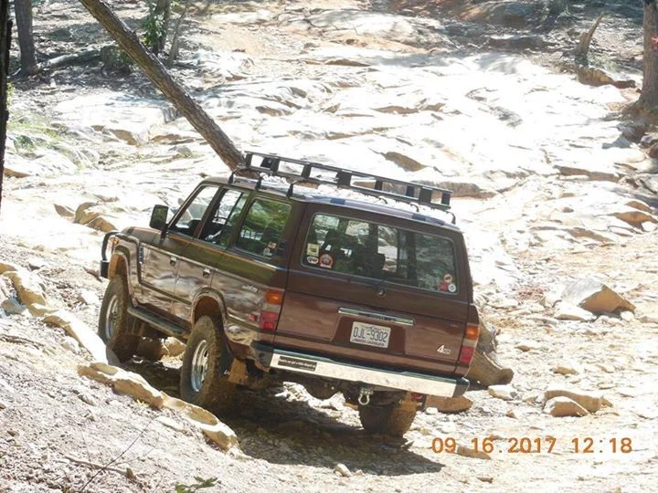

My son, Nathan and I took the Turdle to ONSC's Logan's Run 2017 this past weekend (9/15-17/2017) for camping and 'wheeling at Uwharrie National Forest. The old Turd ran great and did everything I asked it to do on the trails. It was a fun event, as always.
Dave, thank you for letting me oogle all over your truck at Logans Run this past weekend. I am digging the subtle mods you have done and the rig is in great shape. I look forward to lining Buster Brown up with the pack at the next Relic Run. Package will be inbound over the weekend.:D

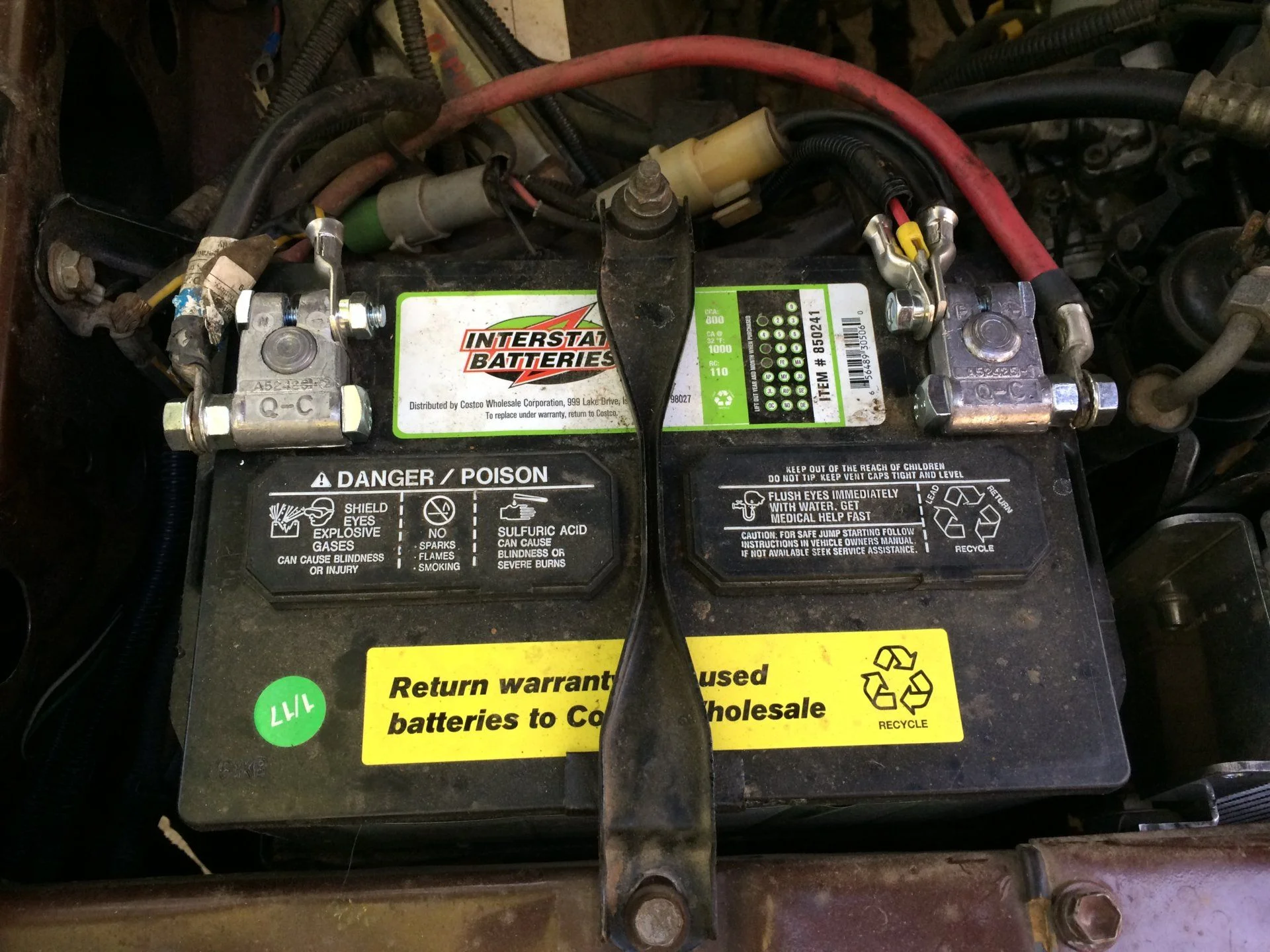

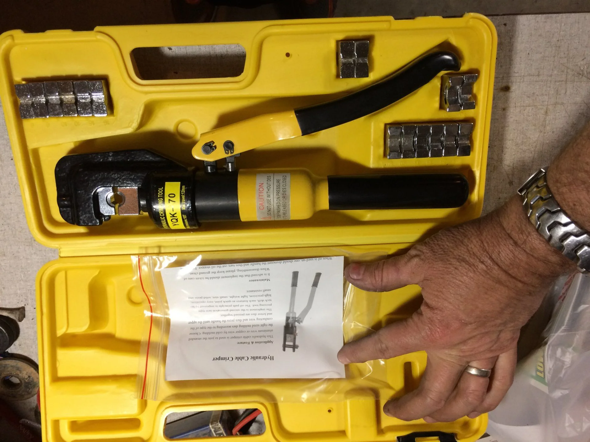

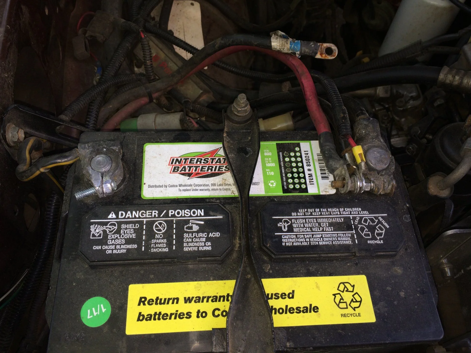

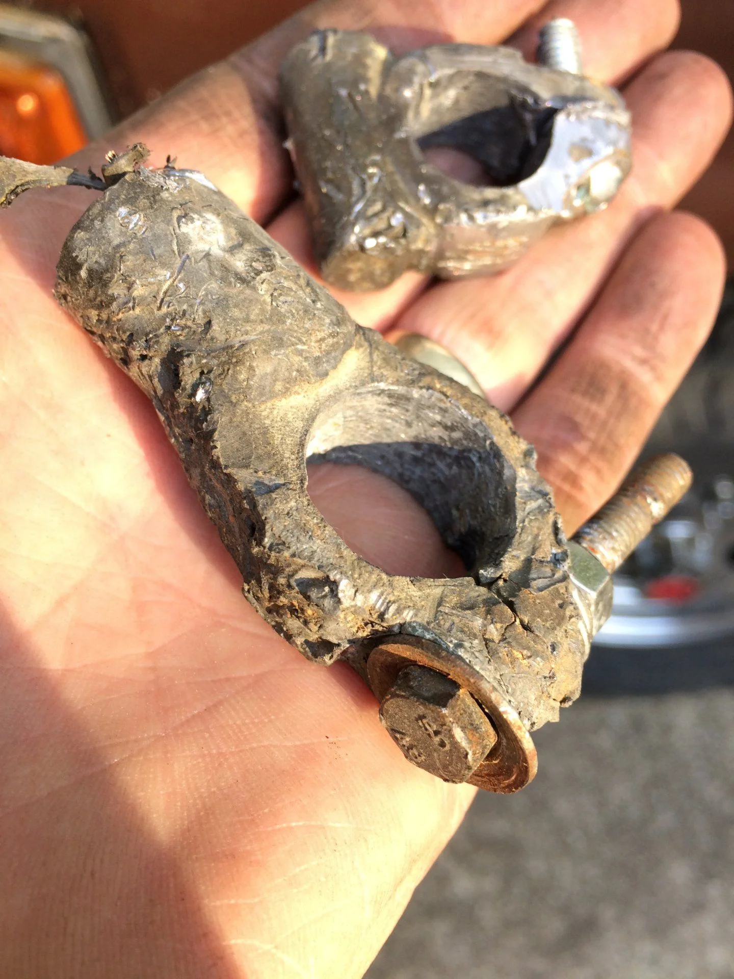

Chopped off the old original battery terminal ends, stripped ends and re-crimped ring ends onto the cables. Swapped on MIL SPEC terminals to clean up and tighten up all the connections. This swap is a must do for adding a winch. The Turdle has been half-assed for way too long with loose terminals and sloppy wires.
Before:
After:
Old over-stretched terminal ends.

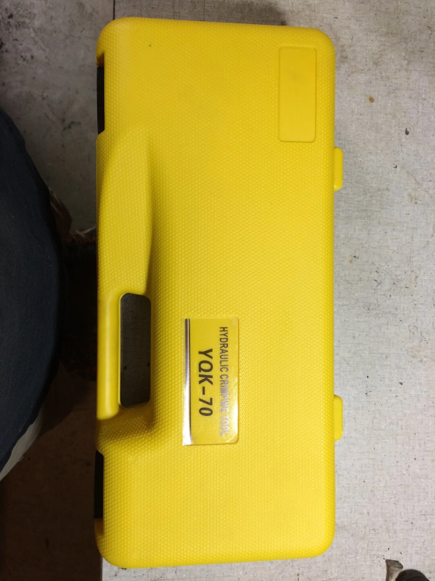

I borrowed this hydraulic crimper from a buddy. It's the cat's meow!

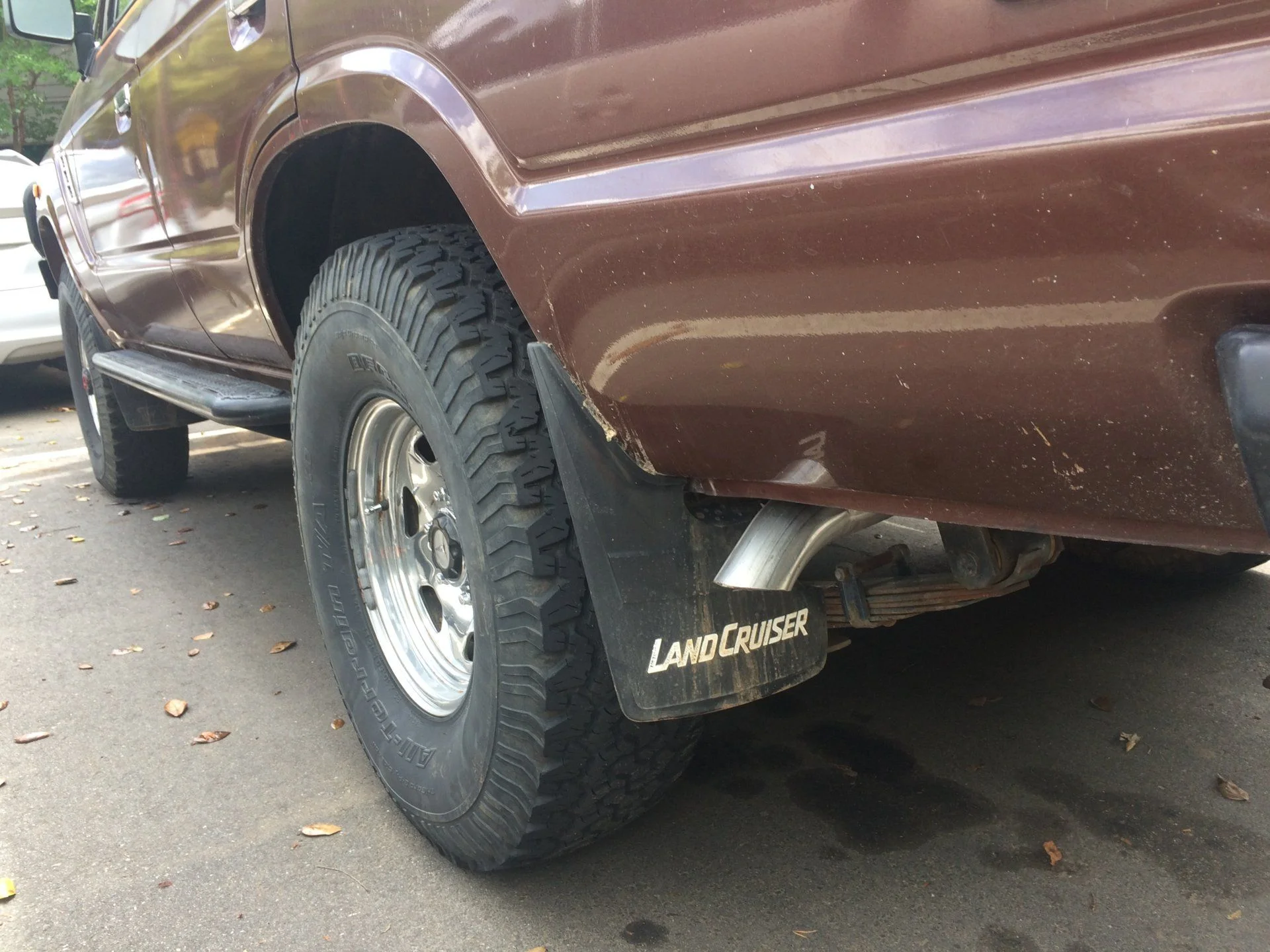

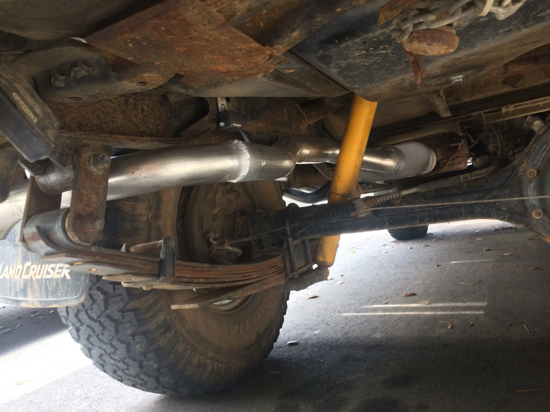

I got a safety inspection notice in the mail from NCDMV the other day so I knew there would be one item on the Turd that I would need to attend to before I took it in. The 1984 factory tailpipe had finally started to get some rust holes. Rather than take it in for inspection and pray that the inspector didn't see them, I decided to do new exhaust from the cat back. I retained the factory catalytic converter but bumped up the exhaust diameter from 2" to 2.5" aft of the cat. In place of the factory muffler, I put in a Flowmaster knock-off muffler. Rather than go straight out the back under the bumper, I opted to do a turn and dump just behind the driver side rear tire. I like the look. It's barely any louder than the roached out factory muffler and piping. It may be a tad throatier. The cat kills a ton of noise. If I ever take that off, it will be a different ball game for sure. I like the cat though, and not smelling like gas on the trail. As for a horsepower increase with this mod...there may be one but my butt dyno does not have a fine enough setting to feel it.
I had the exhaust done at Boulevard Muffler at 5933 Wilkinson Blvd in Gastonia (technically, Cramerton). The shop owner's name is Buck. Great guy. He did the work while I stood and watched him. I think he did a phenomenal job for a price that could not be beat. I tipped him well. Old school exhaust guys are getting hard to find. Buck is a good one.
