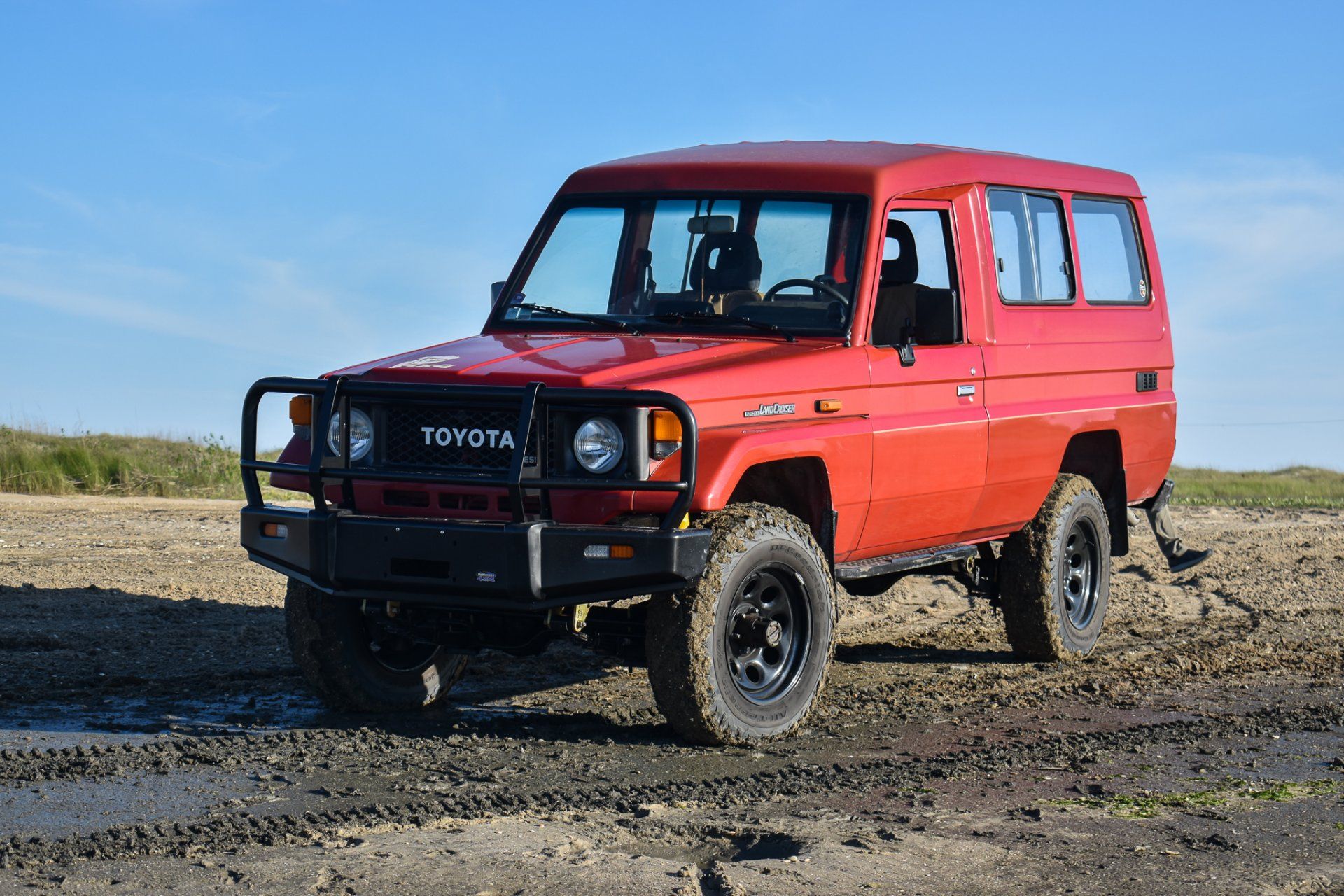

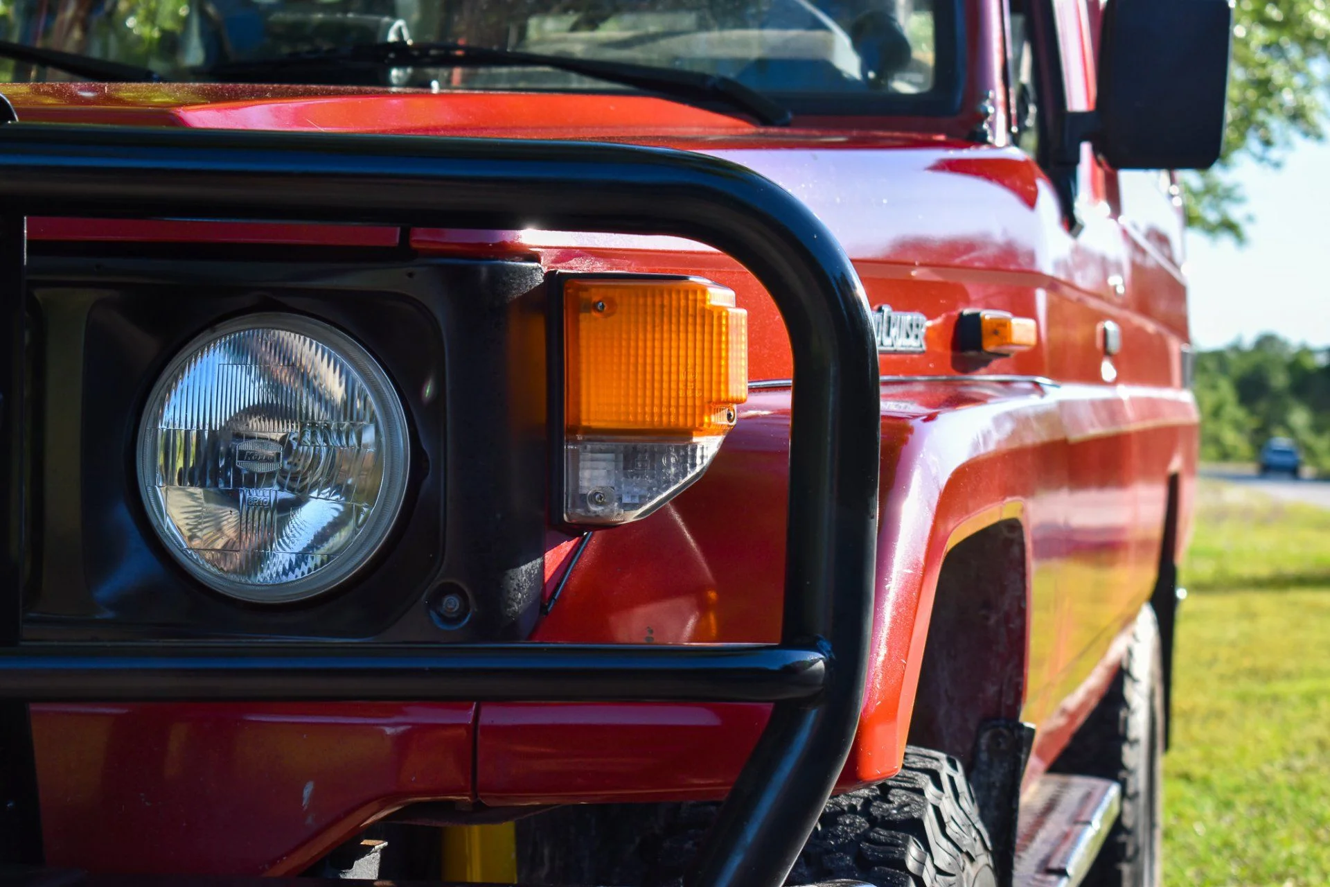

Just some more eye candy I've taken recently. Met a guy at a stoplight who said he drove one of these around in Costa Rica as a "Gun For Hire" back in his 20's, and seeing the Troopy brought him back to some of the best times of his life. The light turned green before I could ask him any more but I thought that was pretty wild. As for the Red Rocket, everything is running perfectly.
It's been about a month since I've last been on mud (guess that's a good thing cause I didn't have any problems with the Cruisers). Anyways since then, I've taken it out on the beach a couple more times. My dad and I have put seats in, having to fabricate the mounts and all, just got seatbelts in yesterday so we will have to rig something up for those. It's really a great vehicle other than the whole 40ish second 0-60 time, but you don't buy these to go fast. My friends and I plan on going on a road trip eventually ending up in Boulder, Colorado sometime in July, and the only vehicle that has enough space for 8 people and some cargo would be the Troopy. Sooo if anyone has any advice or first-hand experiences with the 3B at altitude +1500lbs I'll greatly take it. Thank you all and stay safe!

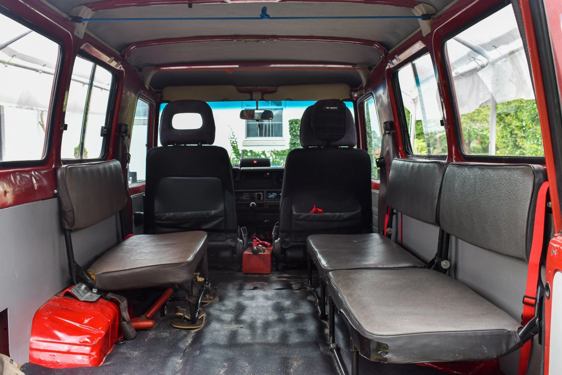

Love it. So much character. Any interior pics of the seats you put together?
Thank you!! I also absolutely adore it. As for the seats here it is. I have the 4th seat but just haven't put it in yet because it takes half a day to bend and drill the metal to get everything to work together. The red box between the front seats is just a handmade wooden cupholder. (Bungees up top are for surfboards cause I don't have a roof-rack... yet)

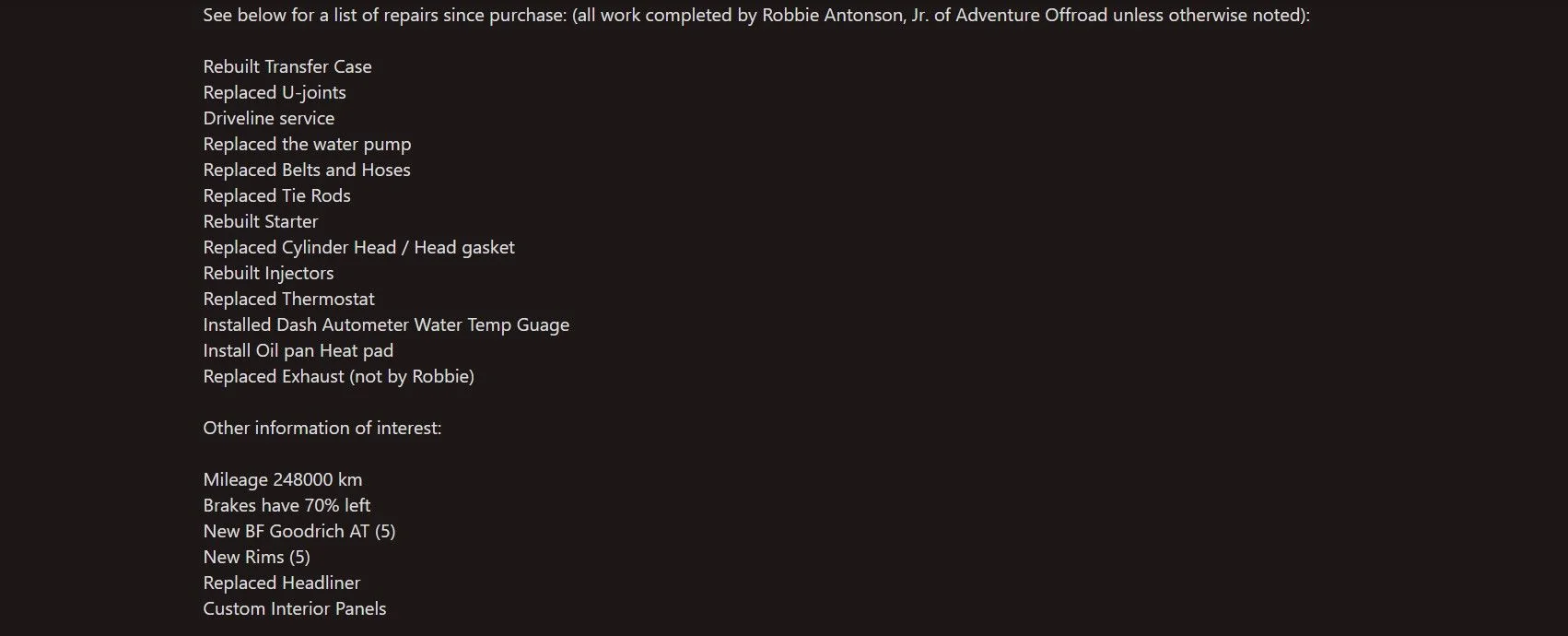

Well, I guess I'm extremely lucky cause the PO had work done on about everything you just mentioned as shown in the picture below! But definitely a great idea for all the stuff you mentioned. I really appreciate it.

Oh Robbie worked on it? You are golden! Adventure away!
Do you think I would need to install an EGT Gauge before the trip?
Do you need to? No. But it's never bad to know more about your engine's condition. Up to you if you want to go to the trouble. Didn't Jamie/Robbie put in an aftermarket temp gauge already? EGT will give you a quicker response to temperature rise, as coolant (and thus stock gauge) heats up relatively slowly, even as head temps can spike. FWIW, I don't have one.

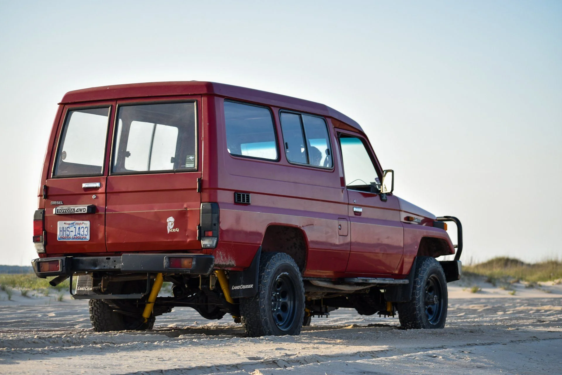

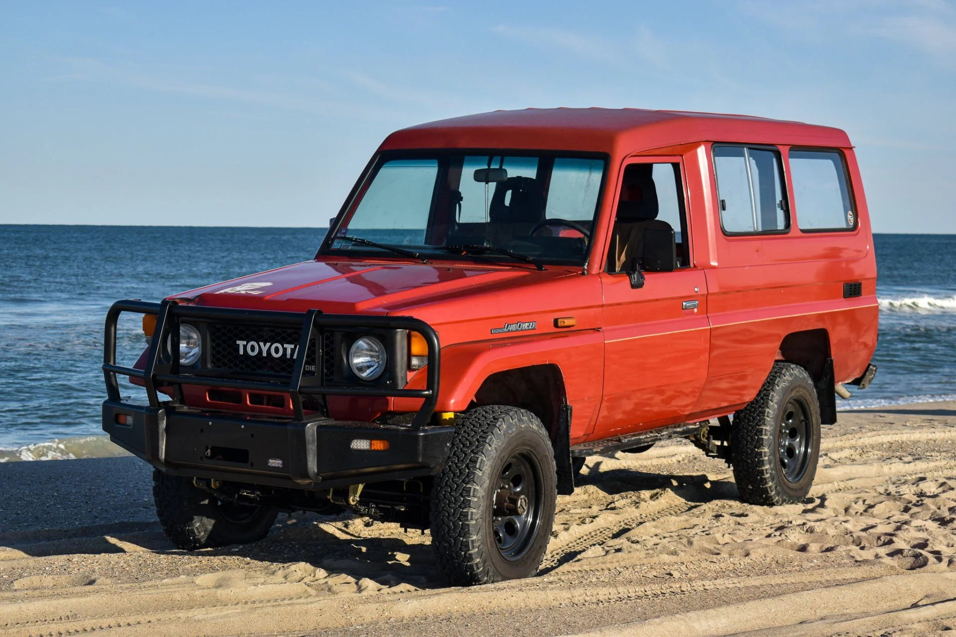

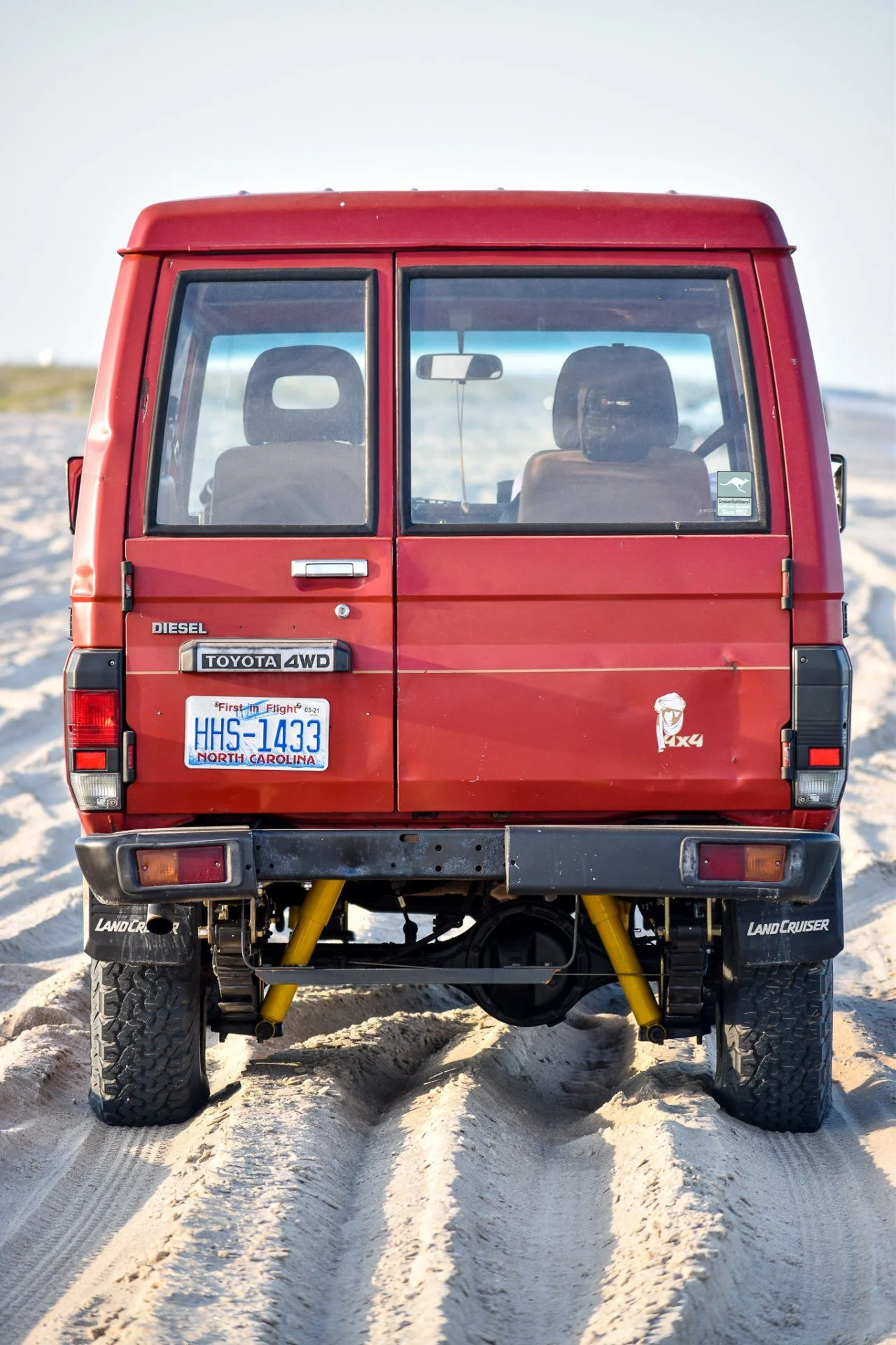

And, dude, your front bumper looks sweet! But your saggy-ass rear bumper? C'mon!

As for the saggy rear bumper... I knowww it's so wimpy compared to the front, a 17-year-old only has so much money! haha
We all feel your pain. We were all 17 at one time.
