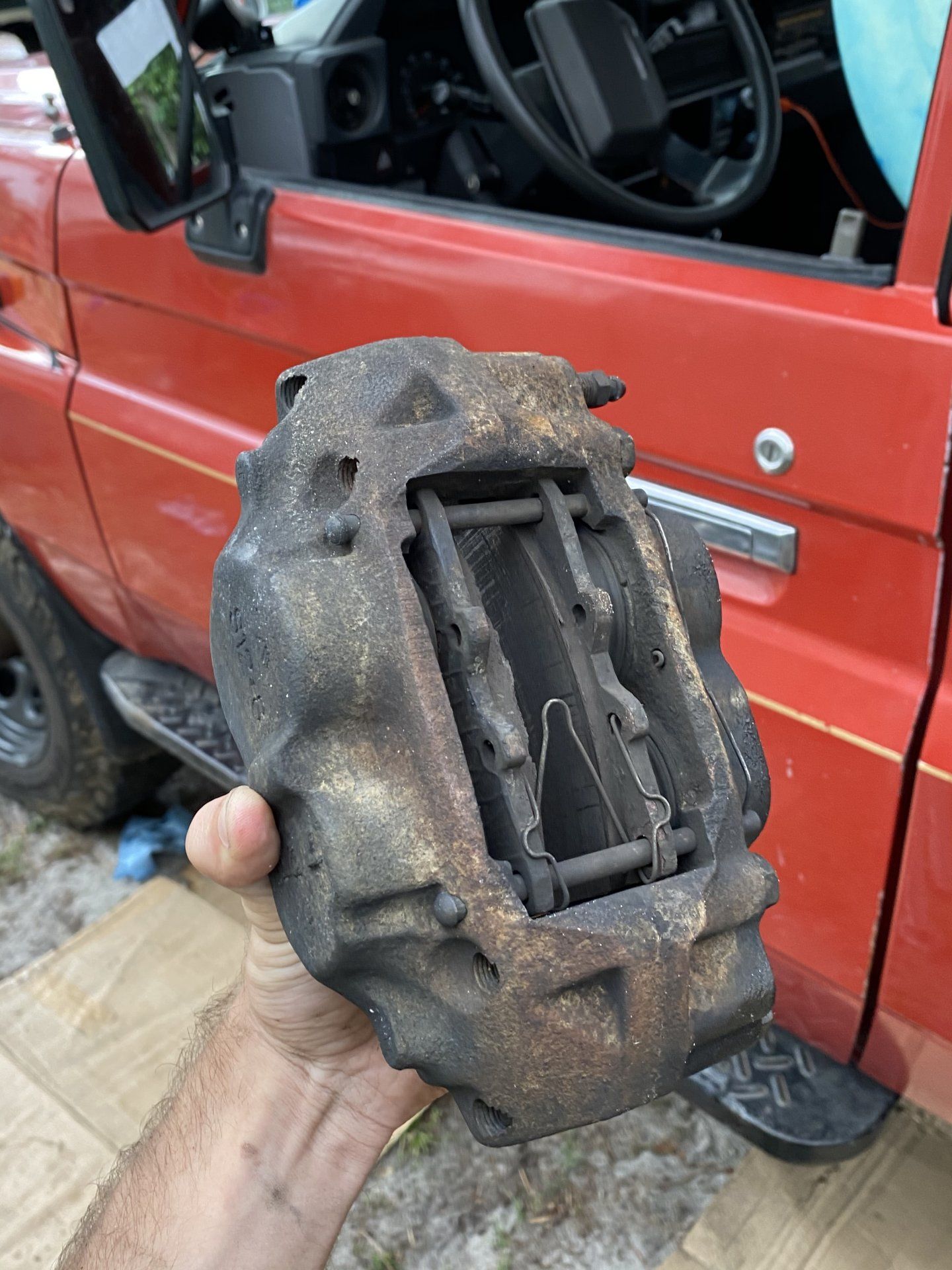

Got new caliper and pads for preparation of the cross country trip. Swapped them out, bled the brakes afterwards, bled them again, and again, and one more time... absolutely no air is coming out of the lines but my brake pedal has no pressure whatsoever like it’s totally full with air. No clue what’s happening and we replaced the master cylinder about a month ago so I’m really clueless. If anyone has any advice it’s appreciated!

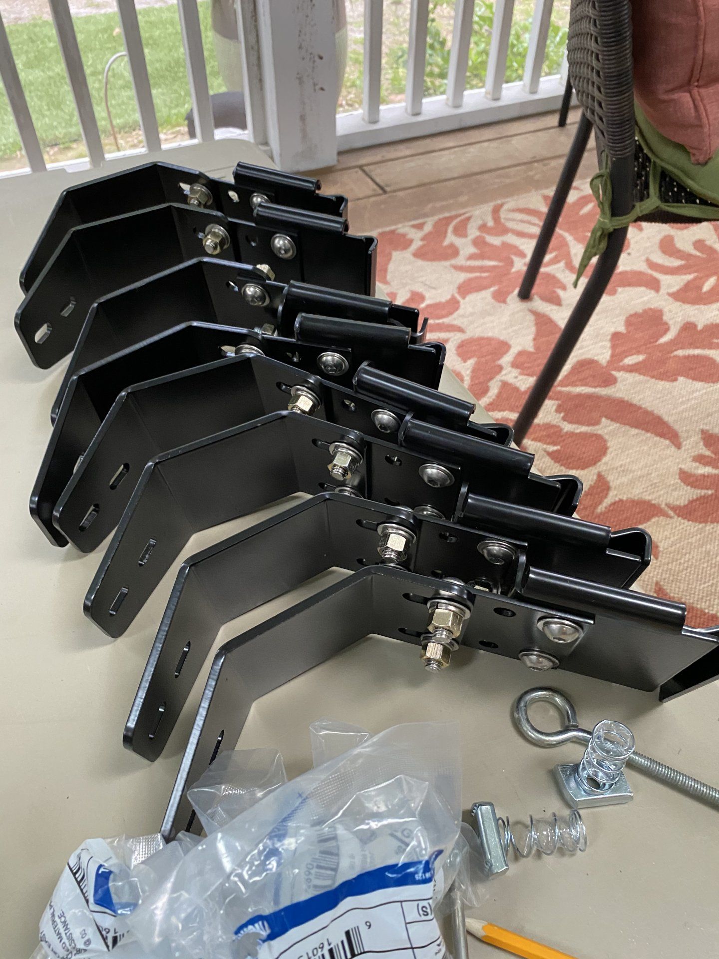

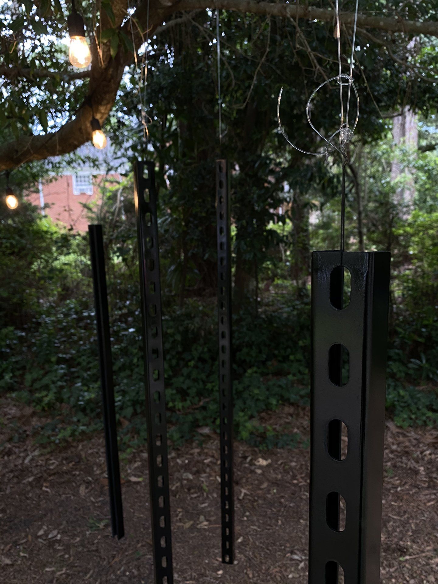

Also got fittings, brackets, and metal rails for a roof rack that we were gonna put together today but the brake pressure issue decided otherwise... oh well there’s always tomorrow.
Consider starting the bleeding process from scratch as if you are installing a new system. I would bench bleed master, then follow bleeding from the furthest out to the nearest wheel to the master. I would lift the rear to bleed the rear. Tap the brake lines to free trapped bubbles so the travel uphill to the rear wheel cylinders and out. No need to lift the front as bubbles will travel up to the master/ reservoir. Use a Mittyvac tool to bleed so that you don’t have to pump. Do you have 2 reservoir master or single?

Awesome! Thank you for the advice, however, the problem was we had flipped what brake caliper was supposed to be on each side without realizing, so the bleed screw was at the bottom instead of the top 😑. After finding that out, the brake pedal miraculously gained pressure again! Who would have thought

That would do it too. Hard for bubbles to flow downhill.
Glad you figured out the brake thing--I couldn't figure what it could be. Wouldn't have ever guessed it was what you discovered.

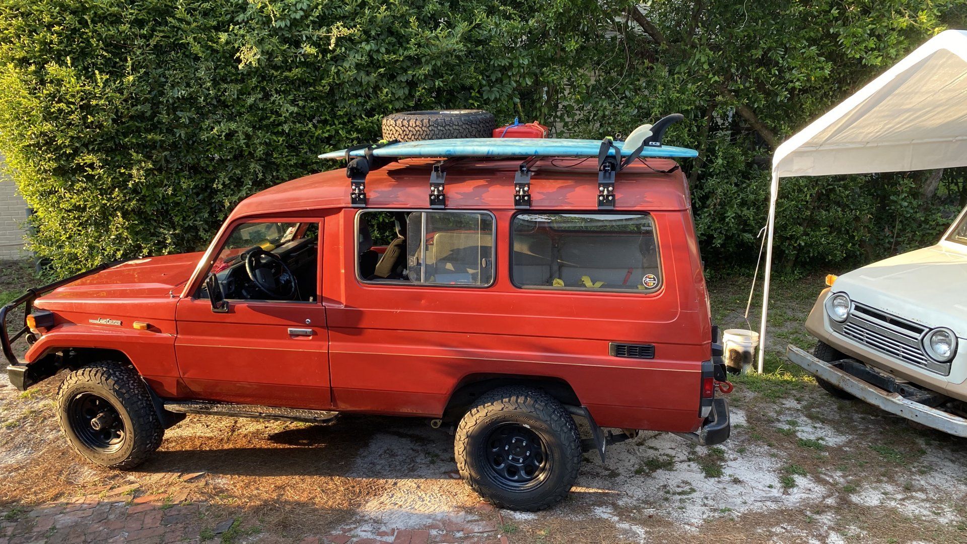

Got the spare tire, a Jerry can, and then surfboard all up on the roof rack now. Soooo here’s some pics. Expect more after the 4th of July haha

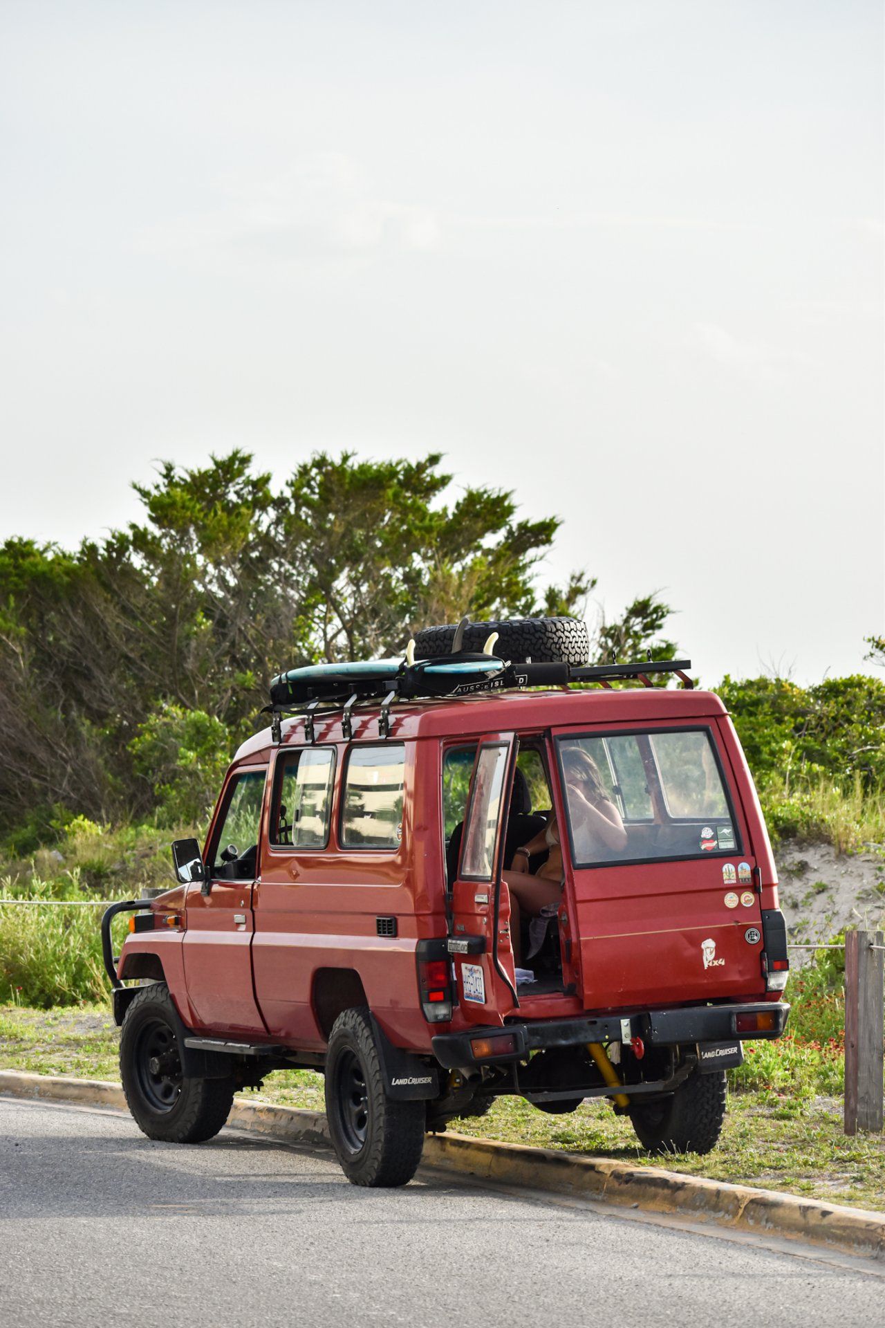

Took the Troopy out with a bunch of my friends for the 4th, so naturally, I took some photos. Even with 9 people, a grill, table, coolers, etc, and some pretty soft sand the 3B didn't let me down and pulled right through everything. Absolute beast. My friend and I are gonna drive up to the Outer Banks so hopefully, I'll get some great scenic photos with the Troopy. Also found out my 0-60 time, a blazing 1 minute 22 seconds.
