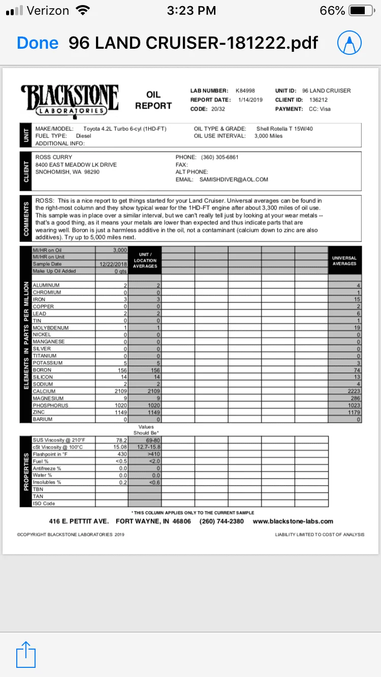

Well, got a Blackstone analysis back today. Looks like everything in the FT is in fine shape. I’m really leaning towards these motors just being inherently smoky. Thanks for the update @CycloSteve

Yeah, it’s a bit frustrating. I don’t know about your motor but mine is very obviously diesel smoke and not burnt oil. It doesn’t consume any oil between changes which would rule out valve stem seals. At least in my case

@Rock40 Sounds identical in every respect down to the good blackstone report. Compression is in spec and the same across the board. Definitely slobbers oil through the breather, but oil consumption is negligible. But the smoke smells of diesel and stings the eyes. Anyway not trying to turn this in to a smoke thread. I'll keep you posted on what the mechanic says, in case it gives you any insight to the problem.
