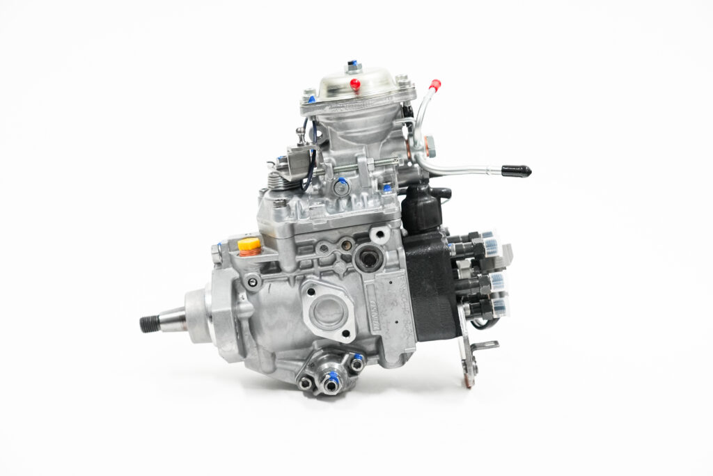

From what I've seen so far maintainance parts and auxillaries are still widely available from both OEM and aftermarket. What is a bit concerning is the availability of FT exclusive engine parts. I don't think I've ever seen even one FT injector pump online anywhere and performance shops sell modified ones only with core exchange. Spare engines are also very rare even over here. I guess in the unlikely event of catastrophic engine failures there's always the option of going towards FTE or some hybrid version in between.

ADS has them... but they are higher flow ones which I would want anyway.
$1500 core charge.

Yep but the question was where to get one. I don't know what the cost to rebuild an IP is these days but I'd rather have ADS rebuilt one than anyone else doing it, they're proven.
The point was/is new not being available.
Cheers
No you are right, I didn't think about it that way. Even with the core charge ~4k AUD wouldn't be too bad for a fresh replacement pump, although I'm sure their supply is very limited as well.
Well, the point I have been trying to make in my posts about FTs is that there are NLA parts. Most of these you won’t need unless building an engine from scratch or say converting an FTE. There is the rare chance though that you will need an injection pump at some point. I have seen cracked housings and lots of internal damage from water. Ofer just experienced a mechanic not doing some work correctly which destroyed his outer timing cover, a part that is NLA. He had to source a used one.
