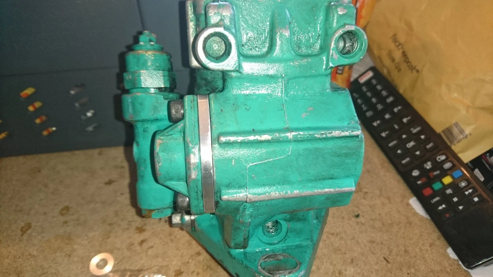

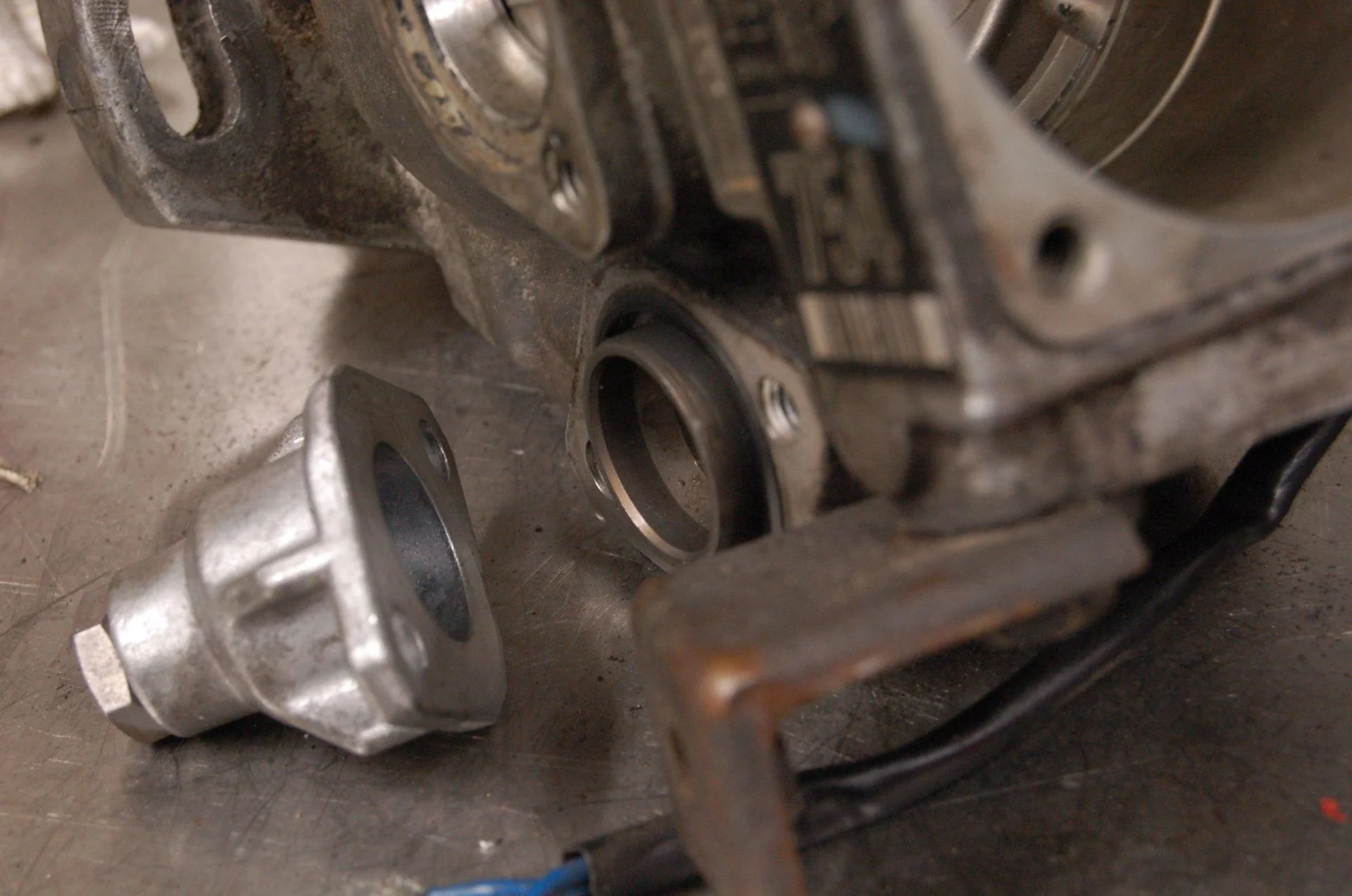

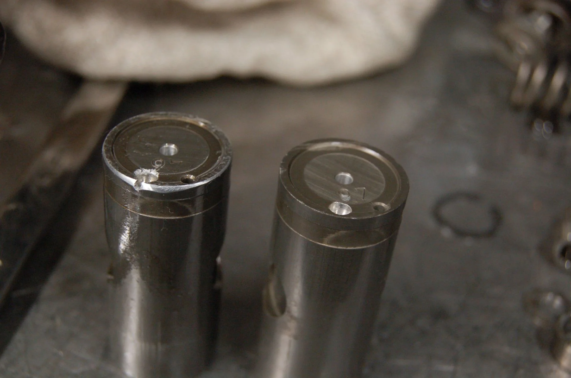

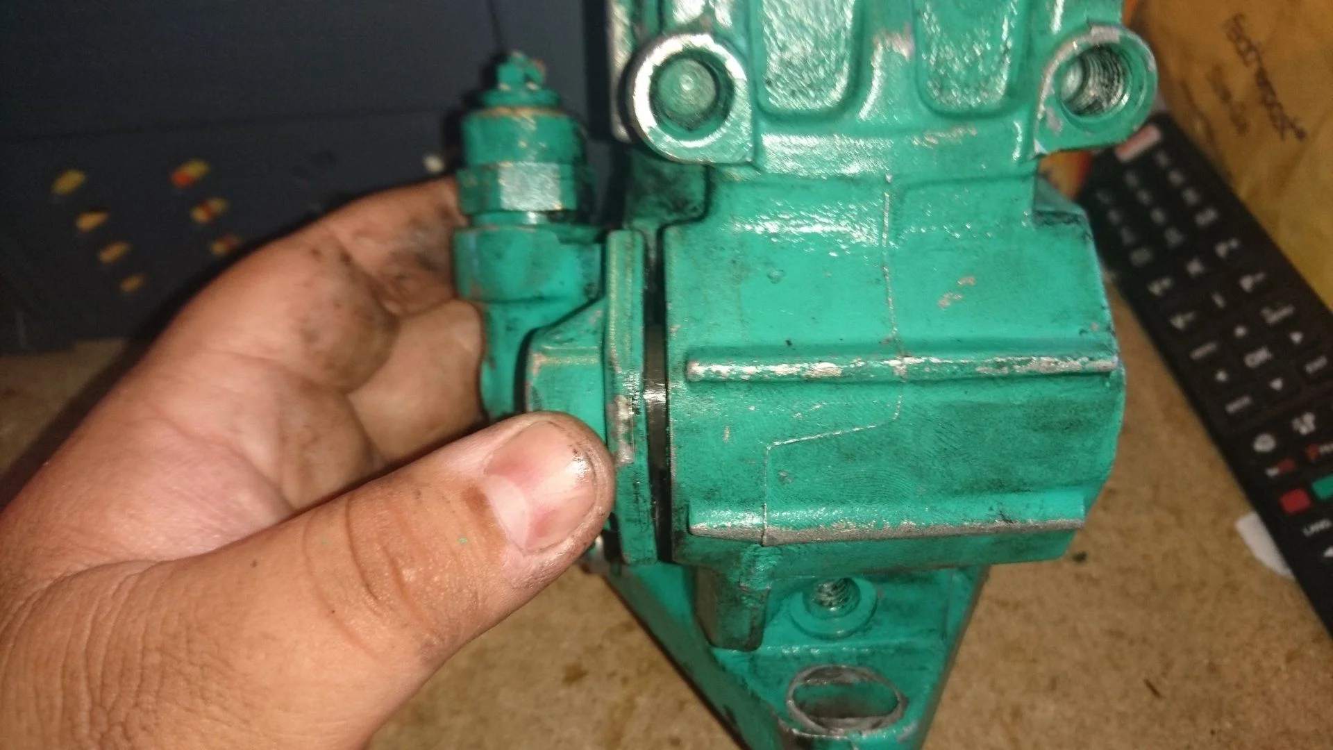

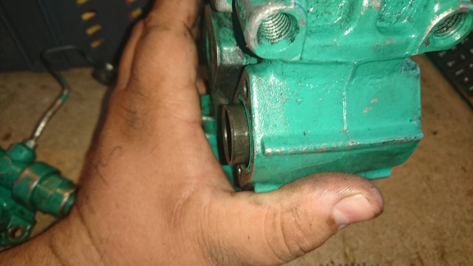

Took some pictures for you about the timing piston. I guess there is some room left, so the spacer might work IF the case pressure can overcome the spring pressure to take advance of the spacer. I dont know this and have to install a spacer to test it with the timing tool.
Anyway it is not limited by the rotating assy itself, the pin or neither by the ASCD.

On this particular pump there wasnt almost any movement of the timing piston. You can clearly see the damage of a weared piston. Fuel will slip past the housing so there isnt any pressure against the piston. I dont know if this is a common Toyota injecton pump problem. I have put another much more simpeler piston style in my own pump to avoid this. Seems that only Toyota uses this kind of piston.

Brilliant info there Remy!
The piston and cap are a different style to the Bosch ones but the piston protrusion at max travel looks very similar to the Bosch shown below.
This is what it looks like with the cap held in place on max travel:
And then finally here is the Bosch pump with one of my prototype spacers in:
Do you have any pictures of the inside of the cap on the Cruiser pump Remy?
I would be interested if the shim we use could be installed or whether that would prevent the spring locating properly?
May be able to install the shim inside the piston instead and keep the cap end as Toyota intended.

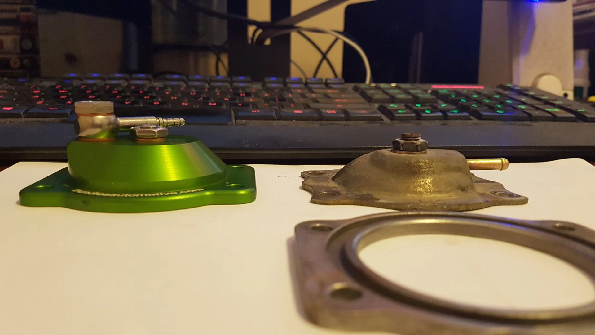

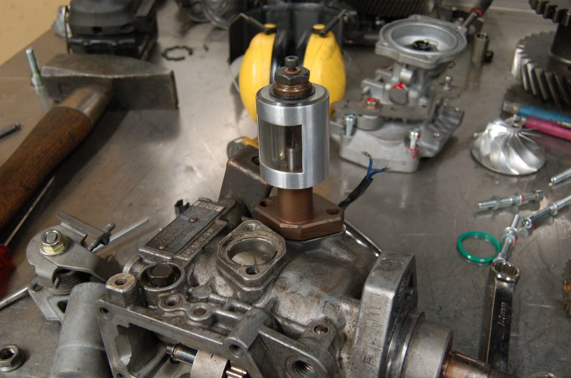

I've had an idea for a while now of developing an electronic controlled fuel pin for these VE pumps. Tuning the mechanical pin is just such a PITA. What do you guys think?
Basically an electronic actuator that fits in the same spot as the Boost comp cover/diaphram/pin/spring etc. It would be a 'bolt-in' solution. The actuator would have fine electronic control with feedback and ability to react quickly. It would have an electronic controller in the cab that could control all the same aspects of the pin that you are doing now with the starwheel, spring and cam. Basically, with some small knobs, you could adjust the start fueling (position of pin out of boost), adjust the fuel curve, and adjust the fuel cut limit. It would give complete control of tuning right from the drivers seat. Could even do like other tuners and get fancy with a few different maps for different applications (economy, power, towing etc.). What do you guys think? I design electronics for a living, and a good friend of mine designs mechanical for a living (machinist). He has an HDJ81, and we've been thinking about doing a prototype for his truck for quite a while.
It would be an interesting project but for the effort i would try and make a VE44 and VP37 hybrid so you have a 12mm 6cyl VP37 EDC pump

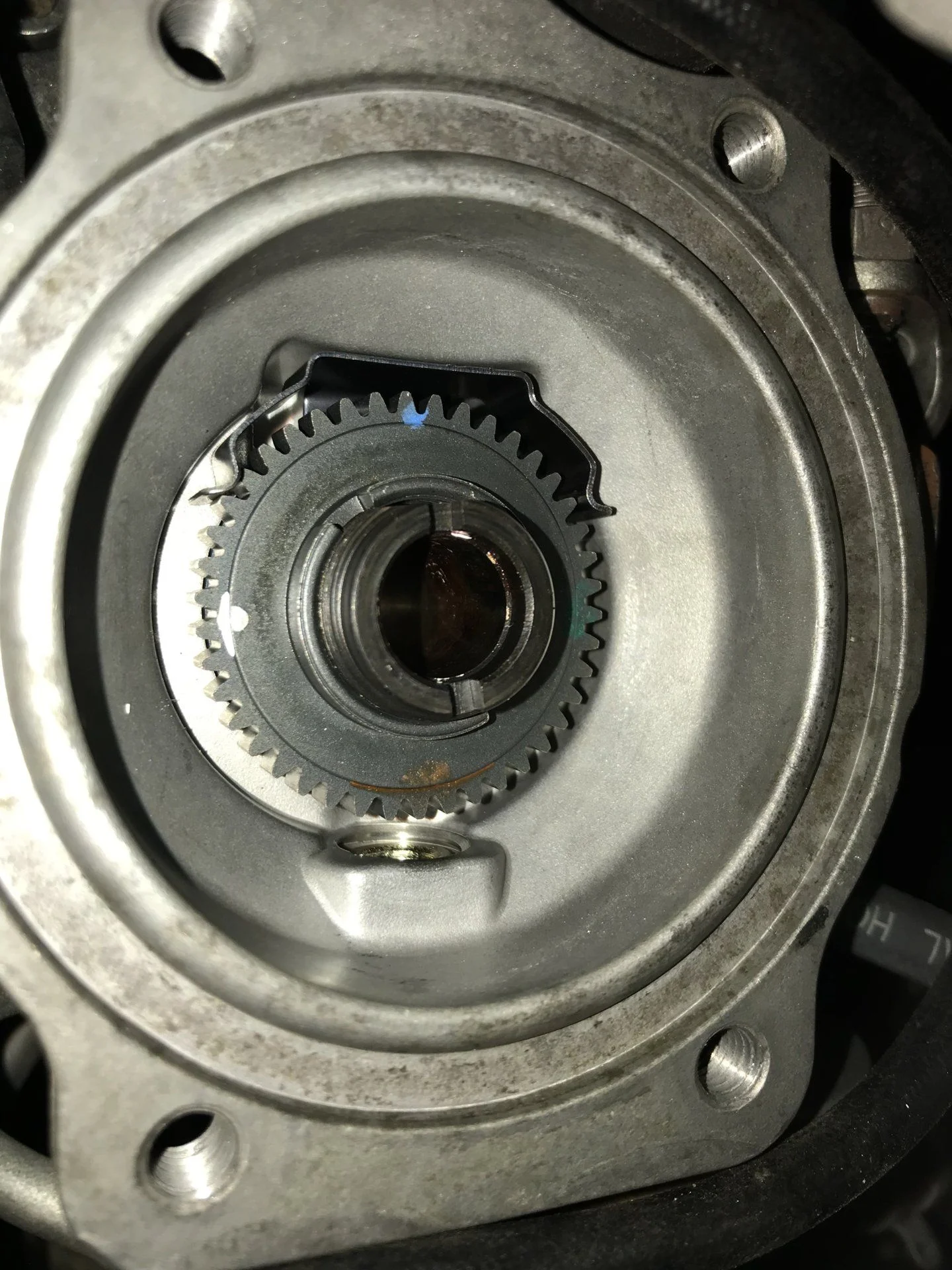

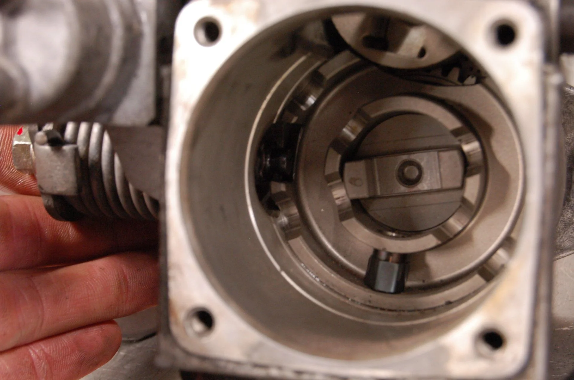

Thanks to all who have lent their knowledge here, there's a ton of great information if you can wade through it all. I recently had my pump done but I hadn't attempted to tune it yet. What a PAIN to get access to the comp cover on the FT motor, damn. I ended up loosening everything including all the injection pump lines just to get the comp cover off. Without doing that, I had zero chance of even getting to the top plate screws.
Here's a few things that worked for me, I marked the star wheel with 4 different colors of paint pen to help me keep track of it's orientation. Each mark is approximately 90 degrees from the other.

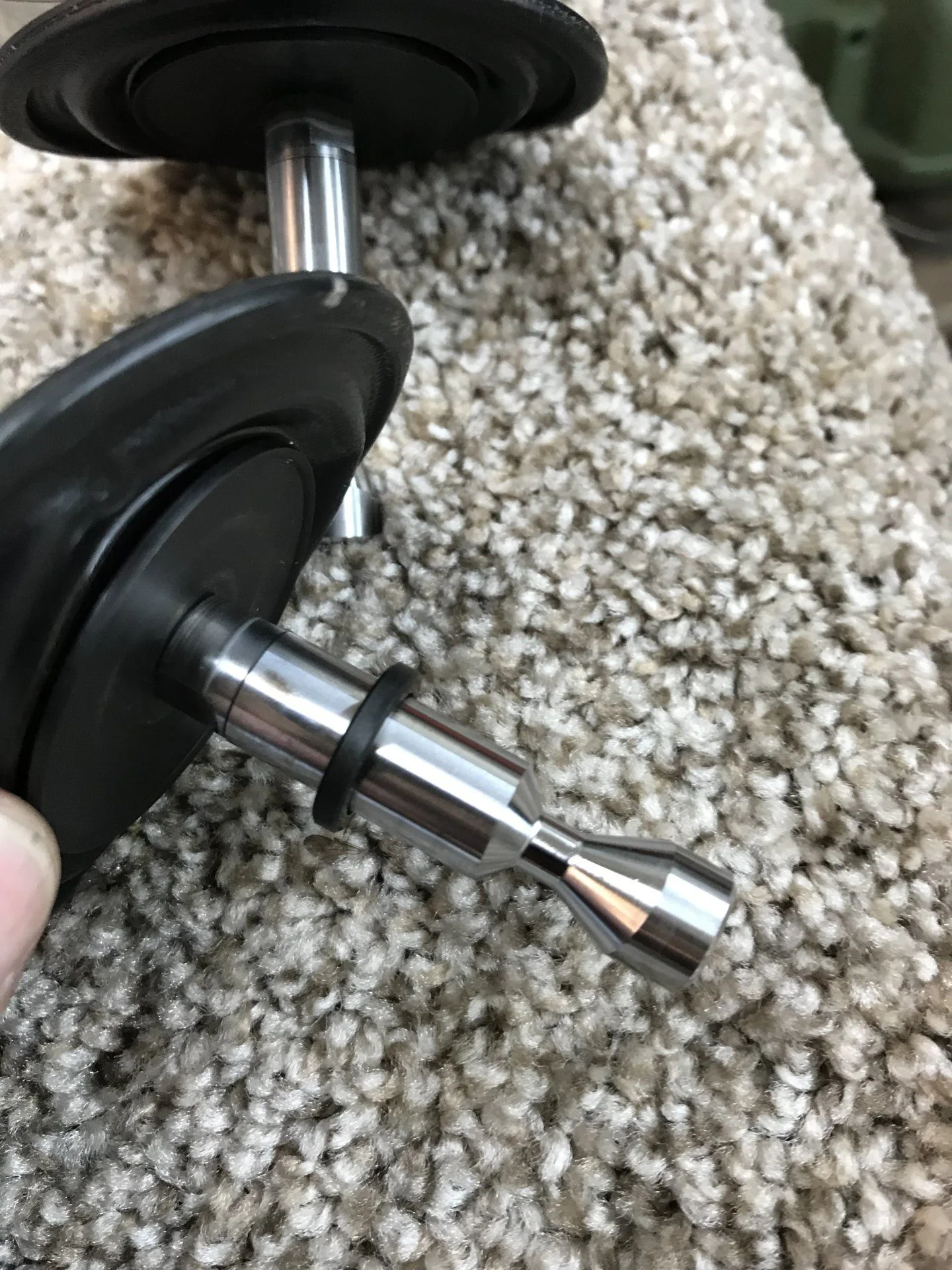

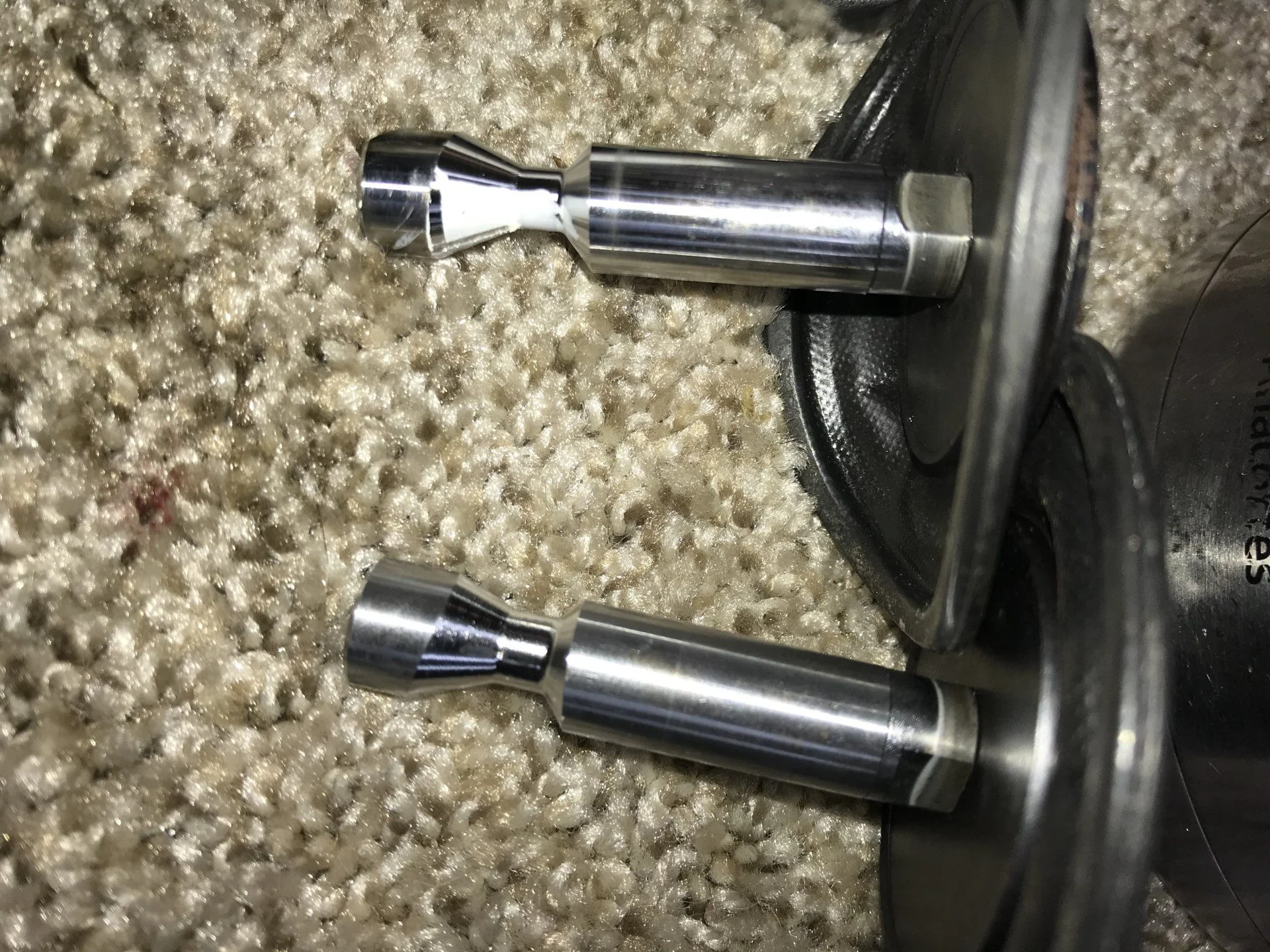

I also compared aneroid pins between a HD-T and the FT. The FT has a significantly more aggressive fueling profile and is shown above with white paint.
The aneroid pin on my FT also had a single shim which I ended up leaving in place for now
Instead of a bike pump, I used a Snap-On radiator tester to manually add pressure to the compensator. It's VERY accurate up to 30 psi and worked great.
I backed the smoke screw all the way off and reduced the tension on the star wheel 1/2 turn (180 degrees). When it came apart, the aneroid pin was already at max fuel although the pin hadn't been ground yet for easy re-assembly. Testing it with paint revealed that it was just getting maximum fuel at 15 psi which is where my manual boost controller is currently set to. My hope is that the motor will be less smoky at cold idle then I'll start the tune.
Fiddled around with a bit of tuning today. I've no idea where the main fuel screw is on this pump but just about WOT on a fairly steep uphill (4th gear) and it has enough power to completely roast the stock Aisin clutch with only 30,000 miles on it. Boost spiked to almost 20psi on a stock CT26. Temps however, were very stable, 800-900 degress (F) max pushing it as hard as it would go. I couldn't see any smoke behind me.
For now, I'm hunting to try and eliminate the cold idle smoke. I turned the MBC down to compensate for the extra boost (idea is no more than 15psi max) and rotated the aneroid pin back a more conservative profile. My "hope" is that the pin (at idle) is resting on the widest part of the aneroid pin which has zero contour/grinding to it. If it's got less smoke at idle, I'll gradually turn the main fuel screw down and increase boost via the MBC.
