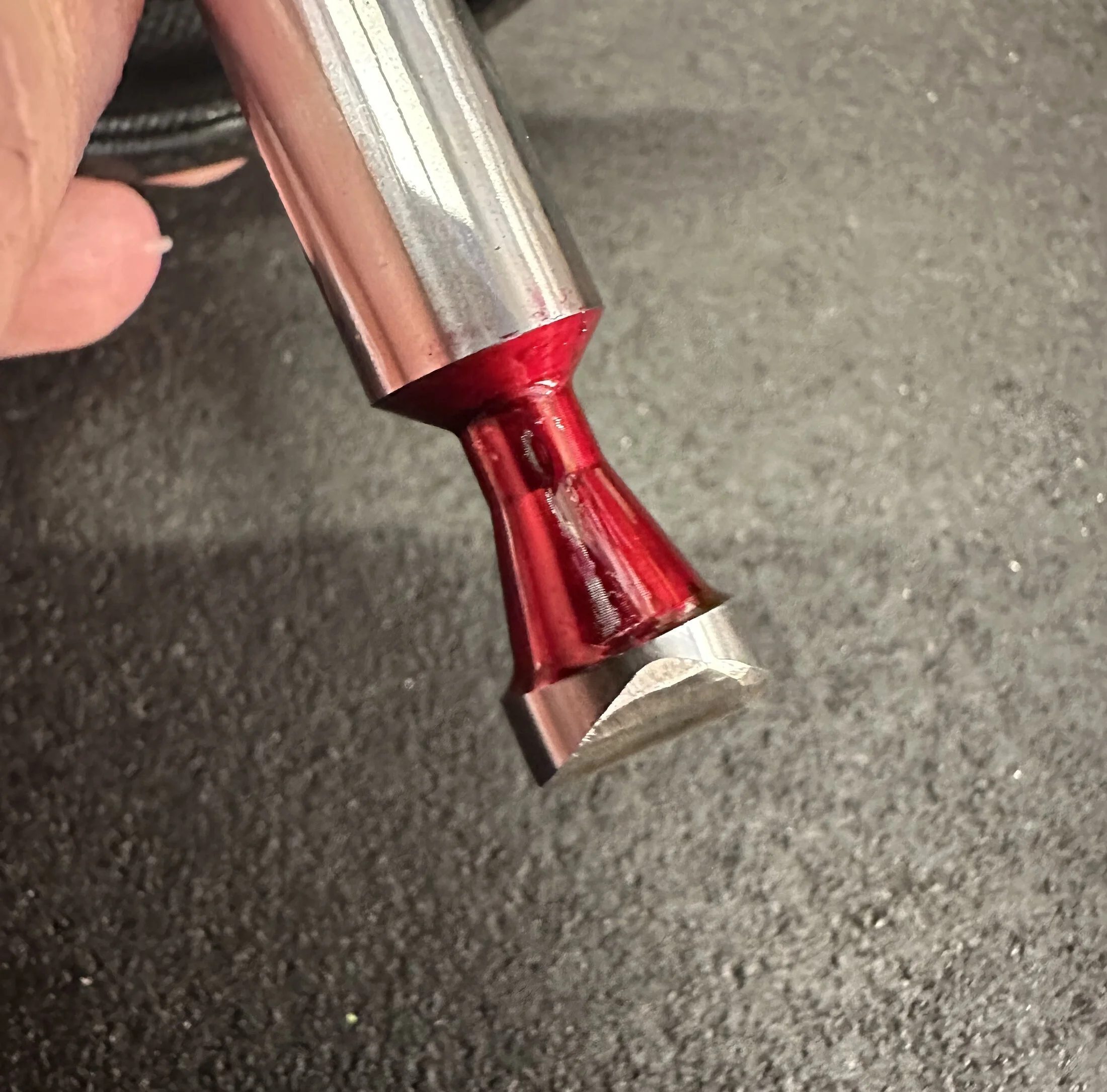

- the aneroid diaphragm hits the intake runner when pulling straight out, so i have to remove the diaphragm from the aneroid to get it out, in all the videos i've seen, i've never seen this or heard it mentioned. makes it a real pain to mark the diaphragm since it has to be re assembled everytime, so instead i've had to mark the actual aneroid rod head. (not a huge deal)
- i had two shims of the same size in there, looking at the aneroid, it was obvious where it had ridden for its entire life, on the lowest profile (least fuel). stopping just short of fuel cut. i ground down the entry to get it back on and sharpied the profile. all good.

Ok, i think i got the aneroid travel dialed in.

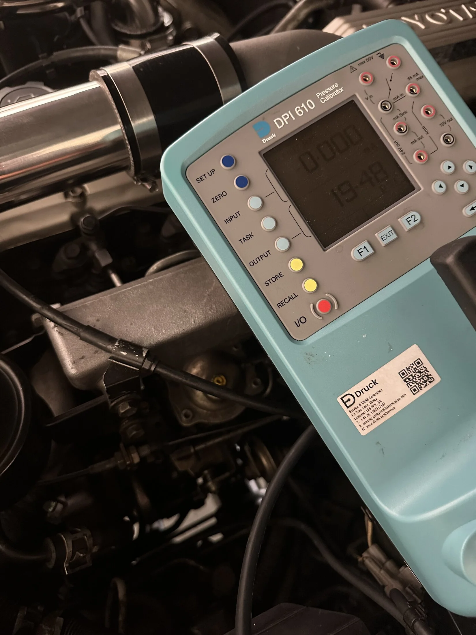

in my opinion and adventures into this, it seems like the best first step if you've increased boost pressure (20 PSI for me) . luckily we have a handy pressure calibrator at work i was able to use, otherwise im sure the bike pump trick works fine.
first test to 20 PSI. pretty deep into the fuel cut
after roughly 2 1/2 -3 counter clockwise turns on the star wheel, and the stop screw set to max travel (and only one shim not two like it had from factory)
set the aneroid clocking to the midway point between low and max on the counter clockwise side from lowest.
very light puffs of black smoke under full throttle briefly, drives good. need to have someone follow me or set up a camera in the rear, for me this is the hardest part is monitoring smoke, also living somewhere that's flat with no hills. EGT's stabilize around 500C which seems low, but when i rotated the aneroid more towards max fueling it was puffing black way more. want more fuel and power but don't want the smoke.
that's where i'm at now, i still think i can dial in more fuel at off-boost and a little up top. also sorry for blowing up this thread recently, just figured i would share my experience for future readers.
