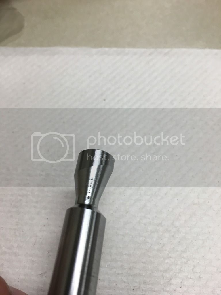

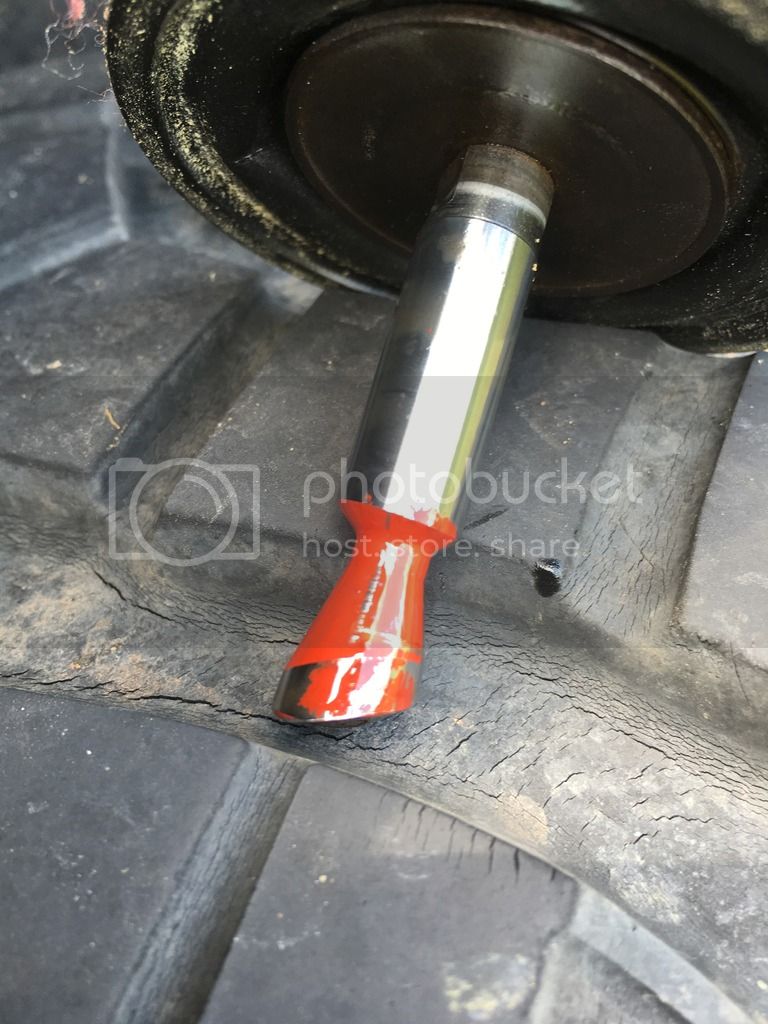

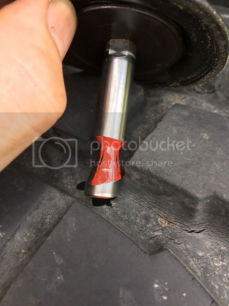

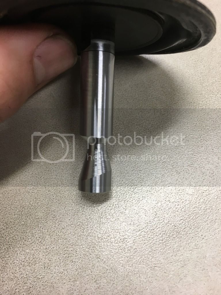

Ok, trying not to derail the turbo thread with tuning my truck. I was able to get the fuel rod out today and take a look. You can see where it pin had been riding for the last 25 years and it seems to be inbetween the most and least aggressive ramps. I'm not going to grind on it now because I don't have an intercooler and with some travel coming up soon I can't risk having my truck down waiting on parts or something. Moving the cam on top made a big difference in drivability. It doesn't appear that the pin used much travel. Thoughts on how to make it better? Turn to more aggressive ramp and add clicks to the star wheel? I'm going to paint it when it goes back in too and see how much boost cut is hitting.
What is the rest of your build?
@vwluv10338 It's tricky to tell from the pic, but the wear mark from the follower appears to start about 1/3 way down the grind, and ends short of fuel cut. Stock boost is 10psi, what are you running now? The extra boost will push the pin deeper into the pump body, and you may get into the fuel cut, you'll have to do the paint pen test to be sure, and "recalibrate" the boost compensator for the new boost level by adjusting the star wheel. From there you can rotate the pin towards the aggressive profile and see how it goes.
If you have an intercooler in your plans, I'd personally hold off on adding fuel via the main fuel screw until its in place.
If you could share the details of your setup (boost level, etc) that would be helpful, I can't remember the details from other threads.
For some reason my phone keeps crashing when I try to reply. My truck has a 3" exhaust and an MMP turbo. I had said set the wastegate for 18 psi but after adding a bit of fuel it seems like it's set at 20. Luke said my turbos best range was 18-24psi. For some reason my exhaust did not include a downpipe. I have a 3" downpipe and intercooler on their way. I just wanted to maximize my current setup because on 100% stock fuel the turbo was laggy. Now with the boost comp cam set to max down its pretty great. I ran the paint test and I'm definitely hitting fuel cut. The think is my EGTs will continue to rise and can't really go any higher. If I can use the star wheel to keep it out of fuel cut then maybe turn down the main fuel as long as I don't loose my off the line acceleration. Even without and intercooler I would have thought I would be able to add more fuel for the turbo. If I can't make any more adjustments until further mode are made I'm not sad as it drives pretty well right now. I turned it to a more aggressive ramp and took a quick drive and it actually seemed slightly laggier and with more smoke so that doesn't seem to help any. Obviously still hitting boost cut.
I'd start playing with the star wheel to tighten up the spring and keep the follower out of fuel cut at your target boost level, this will serve to reduce fueling at lower boost levels, and may even help with the high EGT's as you'll be adding fuel more slowly than your current tune, you'll have to report back with your results.
Once the pin travel is calibrated to your new target boost level, you'll essentially have to start your "tuning" from there (ramp angle, smoke screw, etc), if you're seeing high EGT's now then I'd leave the main fuel screw alone unless you find it needs to be turned down some to bring EGT's into line.
Also, you need new tires, lol.
