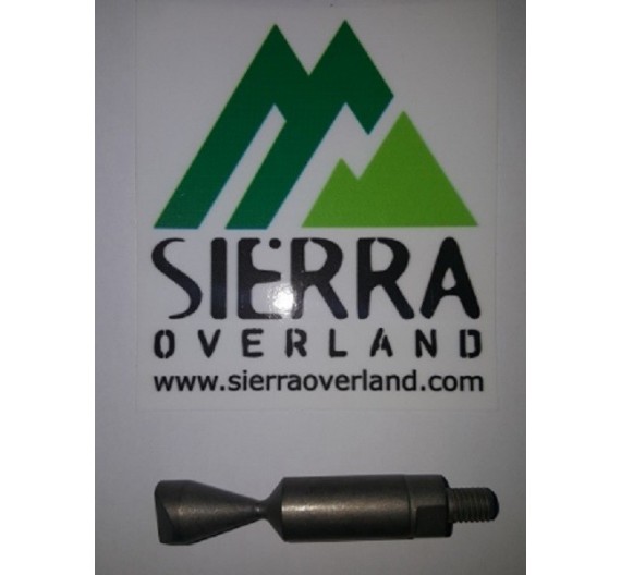

And here I was going wondering in the web when I found this
It's made by a Spanish store, I'm thinking about giving it a chance! By the looks of it what do you think of it? Just by the looks since there isn't much more info at this time.... :cool:
Cheers
Is it polished? Or chrome plated?
Might just be the photo, but that doesn't look polished
Every pin I've seen has a highly polished chrome plated surface, or case hardened and polished. These pins move up and down every time the turbo comes on and goes off boost, there's a lot of potential for wear and tear.
That's a good question! And I've seen some showing that kind of wear. I'll dig into it!
Cheers
