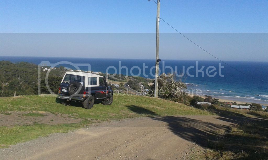

The real surprise for us was heading inland through the Otways. We thought we would head inland to save some strain on my diff which had become very loud (more on that later), little did we know there was mountains and rainforest! A very beautiful part of the country which I probably should have taken more photos of!

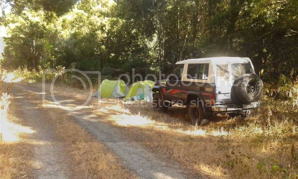

This was Christmas day. We had bought 2 $34 tents back in Melbourne, these were brilliant aside from having no mesh/airflow, ultra quick setup and about the size of a double swag but 1/10th the size when packed.
Continuing on there's some very pretty coastline, though W.A still has the beast beaches. I can't believe there's no beach driving in Victoria. What do Victorians do on Australia day?
A rather ballsy boat ramp.

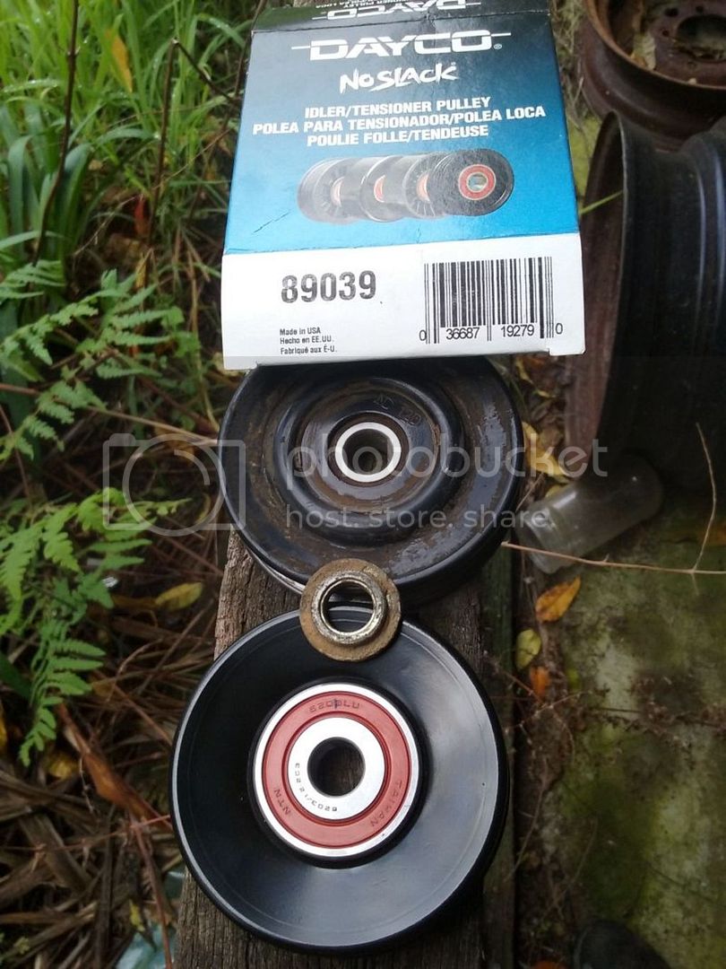

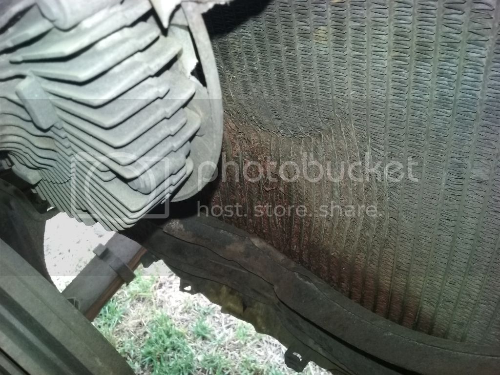

It was about here the trip got a lot more difficult, it started to overheat quite badly. Odd considering the temp gauge hardly moved before. Anyway, bubbles in the coolant so it's likely the head is cracked, bugger. Any sort of incline or going at 90+km/h would see the temp gauge soar, through the stock temp guage is slow to react and it's boiling by about 2/3rds. From here on we drove with the heater on, not pleasant in 30c+ temps, much less so for mum whos window didn't go down. Just to give me the occasional heart attack, the temp and fuel gauges randomly shoot to the top for a few seconds from time to time, despite the car not actually being hot.
So we slowly rolled into Mount Gambier, we lived here when I was little and it was good to see the place again. Mount Gambier is unusual in that it has several inactive volcanoes around it, mostly filled with water. The most famous one is blue lake, for obvious reasons. I forgot to take a photo so here's one I nabbed of the internet.
Umpherston sinkhole is not only home to lovely gardens, but also some incerdibly fat Possums. I fed one a whole banana then someone else fed it half an apple!

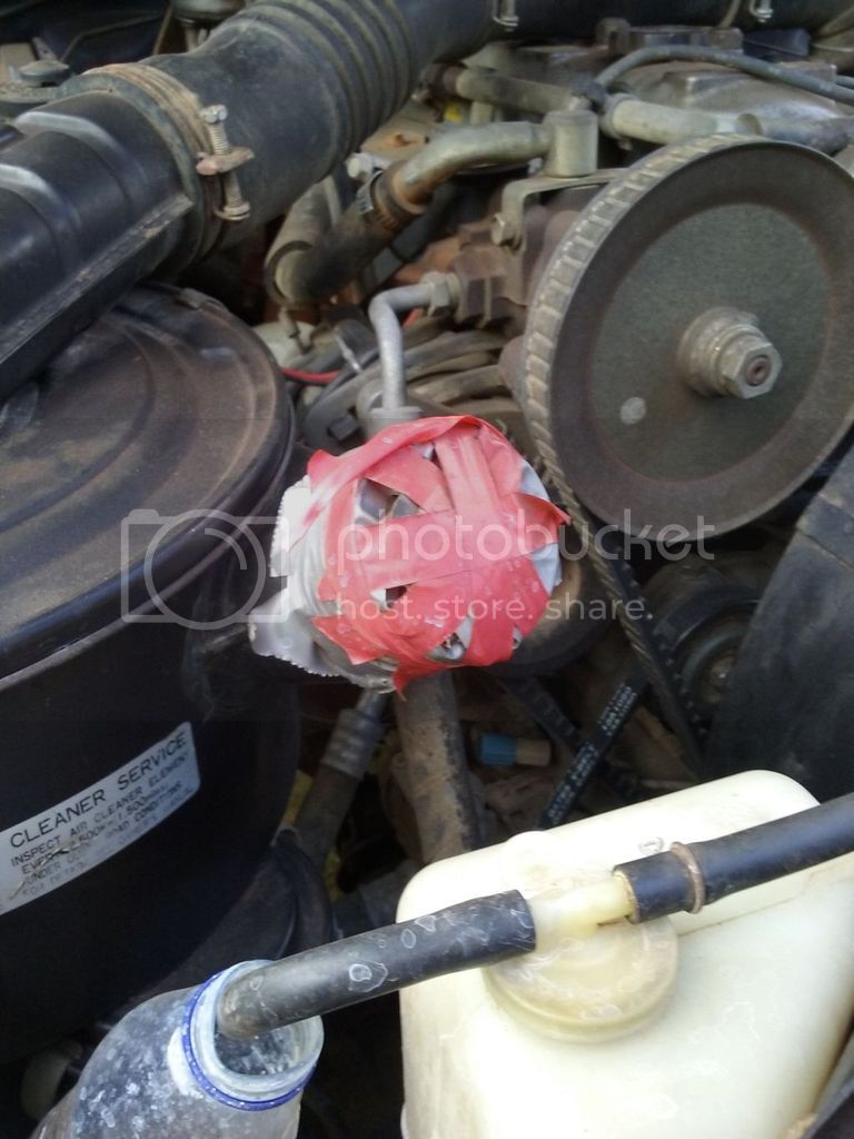

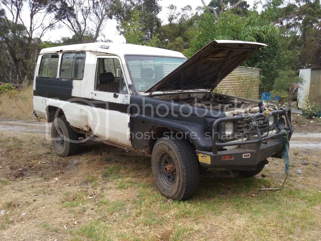

I bought a new radiator cap, thermostat, an aftermarket temperature gauge and a s***load of coolant. and set off. There's not a lot north of Mount Gambier, this little rock (Christmas rock) being the tallest thing for as far as you can see!

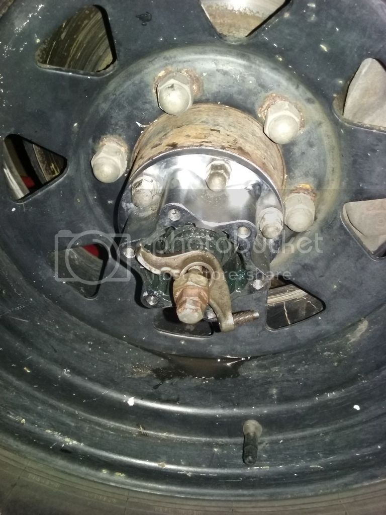

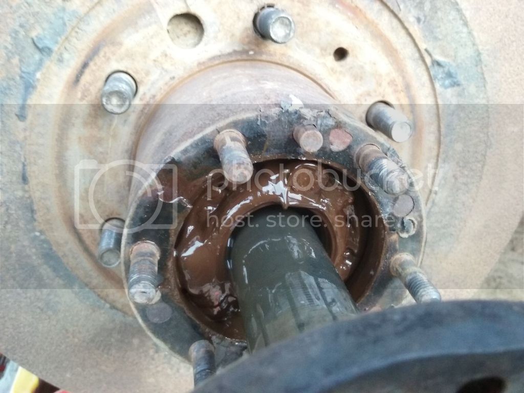

Aside from the overheating, the main mechanical issue was the rear diff. It had about 5mm of side to side/in and out play in the pinion. It was also pretty noisy and had coated everything from the pinion back in gear oil. Of course the previous owner "had no idea" about this issue. My plan was to simply tighten up the pinion nut to torque again and fit a new seal. Whilst I was certain this would make it louder it'd be much more likely to get me home. Much to my surprise it was almost dead quiet and stayed that way for the rest of the trip. 3000kms later it still has no play!
I dropped into Terrain Tamer and picked up the correct thermostat (a genuine Toyota one) and a few other bits. The terrain tamer stores, especially the Melbourne one are worth visiting just for the displays. They have a very impressive range of really broken Toyota bits, their bare metal FJ45v, cross sectioned gearboxes and motors, and displays showing the difference between their drivetrain parts and the factory ones.

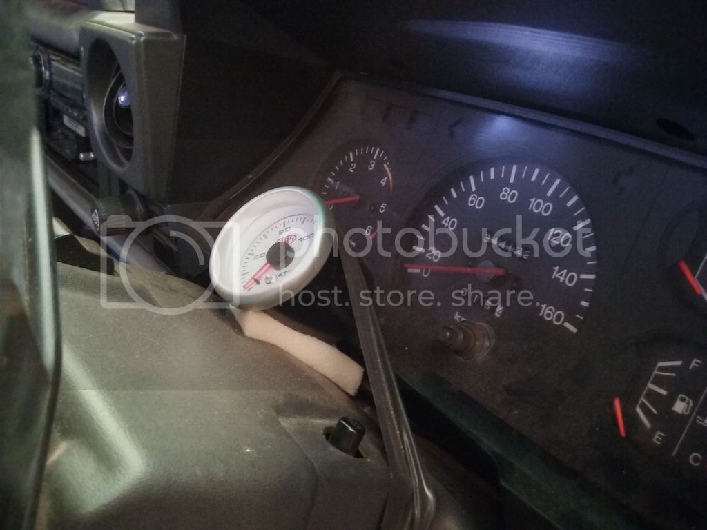

I also fitted my temp gauge, yes I know it looks hack but it's not permanent and I did it in a car park with basic tools. I'd like to install an auberins gauge with an alarm at a later date. This and the thermostat made the issue much more manageable and although you had to keep eagle eyes on the gauge and generally drive with the heater on, the car didn't overheat for the rest of the trip. 90* is vertical because that's where it boils over.

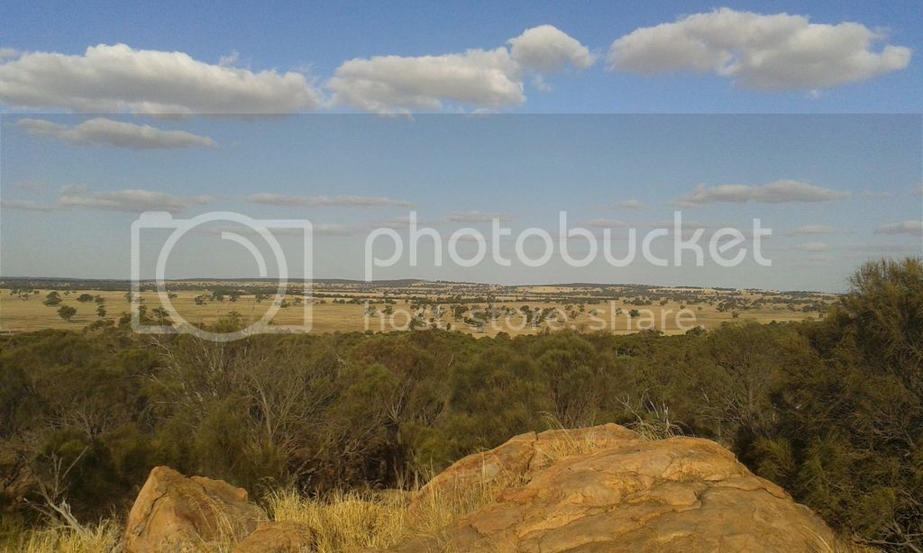

For new years we camped at Pildappa rock which is kind of like a mini Wave rock. I must say I never would have guessed I would spend new years camping with my mum!
About now it was 39 degrees (102F) and we had the heater blasting to stop it overheating. This wasn't very pleasant and actually killed both of our phones. I did some DIY heat proofing with some foil bubble wrap we got in Adelaide to wrap our esky in. I didn't really think it would do anything but this made a massive difference. You can see I've also done the heater pipe, mostly to block off the little vent that was burning a hole in my leg.

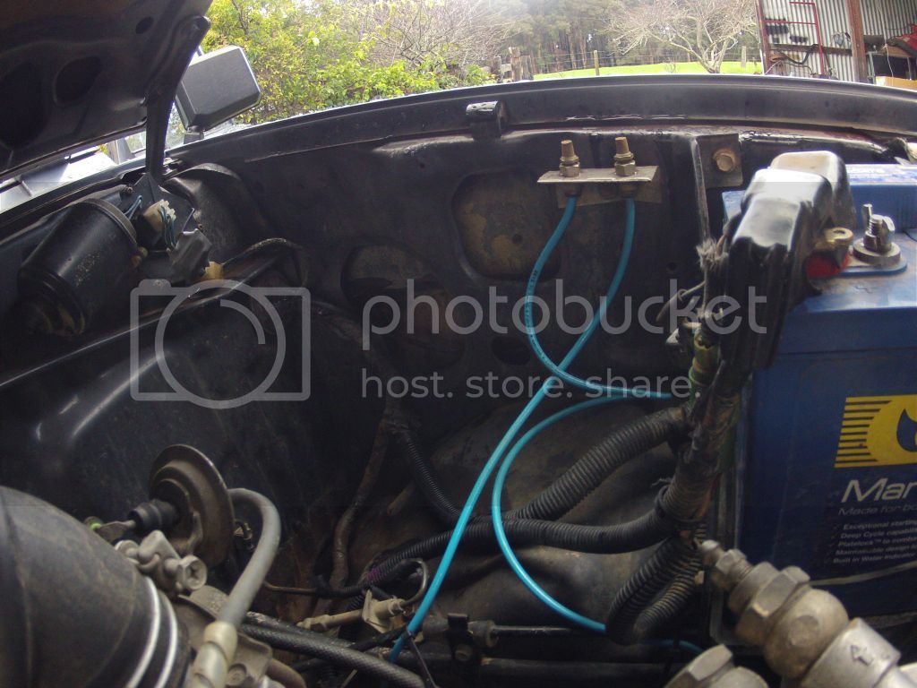

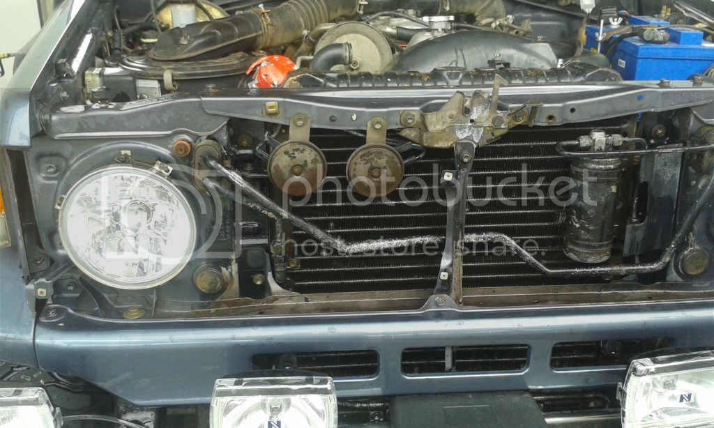

Mum got her McGyver on to direct the air from the heater somewhere else. For my side I cut the bottom out of a water bottle and lined its edge with tape so it'd sit snug in the vent.
I got a little desperate and removed one of the horns and relocated the other to improve flow into the radiator. I also removed 2 of the 6 spotlights (and it came with another new pair to put on too!). This of course made no measurable difference.

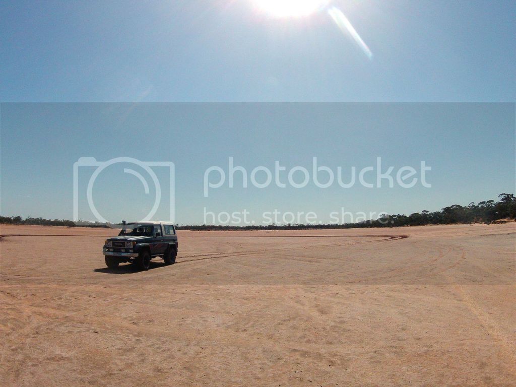

Somewhere near Norseman I found a clay pan. This the most bizzare surface I've ever driven on. I could hold slides for hundreds on metres, certainly the only time I've done a powerslide with a 3B!

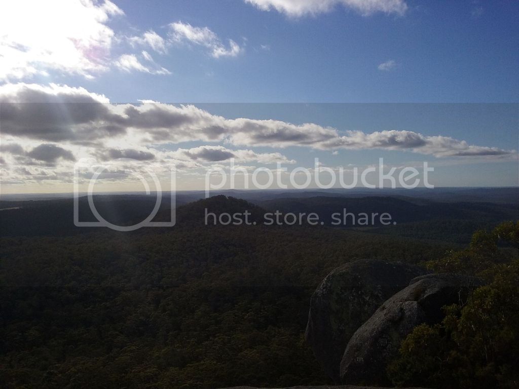

We went inland instead of following the coast so we could go through the Stirling Ranges. They're quite spectacular but there's no 4WDing and the people who manage it must own shares in a gate manufacturing company!

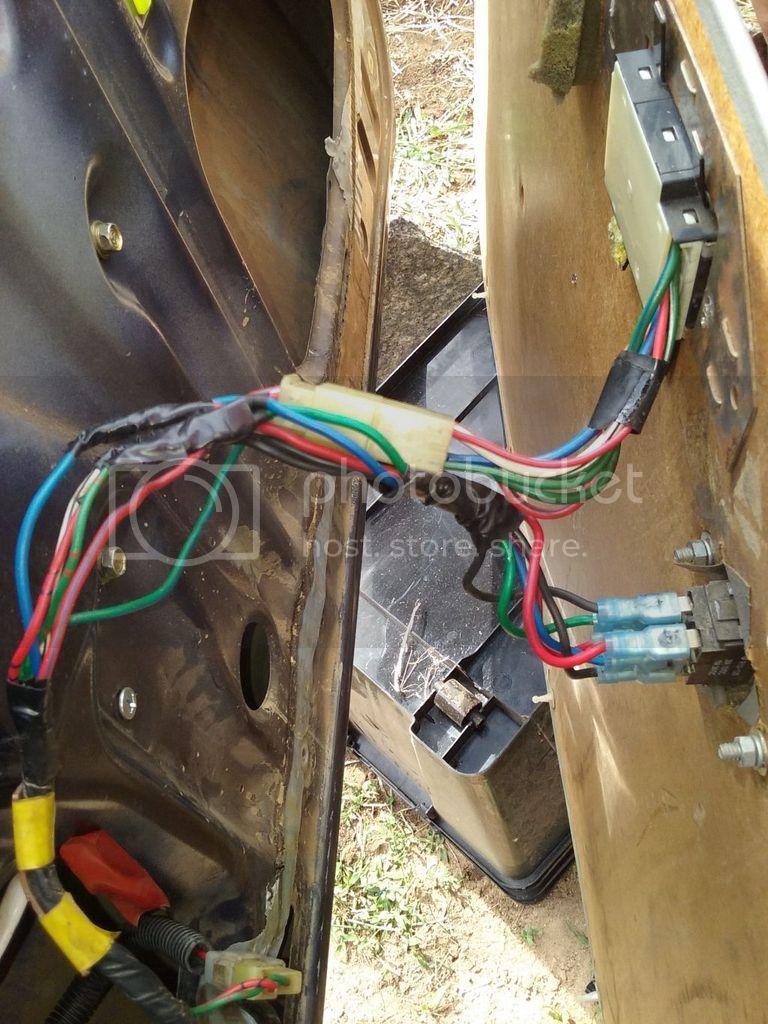

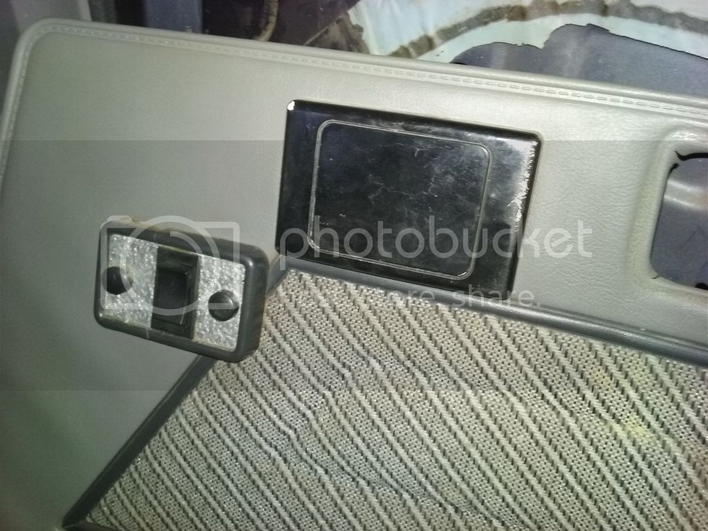

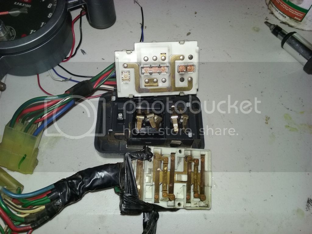

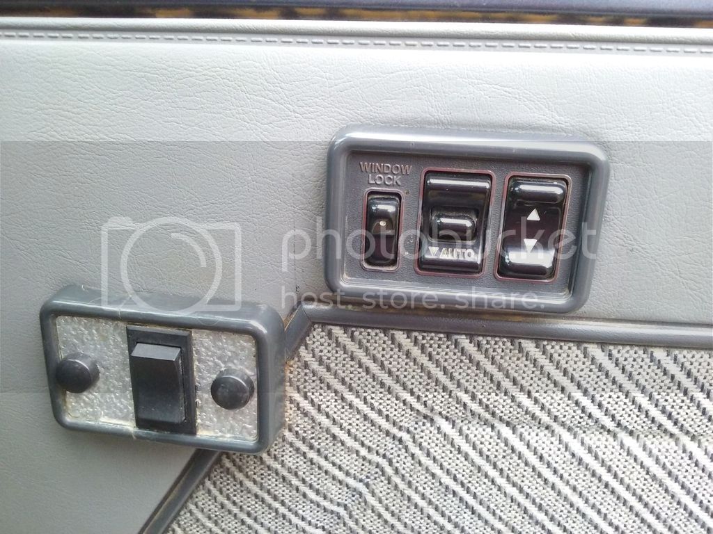

The first issue I tackled when I got home was the windows. The original drivers side switch had been bypassed and only 1 added so you could only control the drivers side.

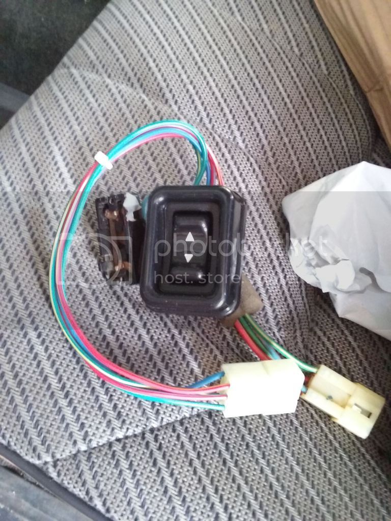

The passengers side switch was broken. I ordered a 1st gen 4runner switch from switchdoctor. This slipped/plugged right in and the window was working again! Problem was it was very slow and was making a horrible squealing noise so I pulled the regulator.

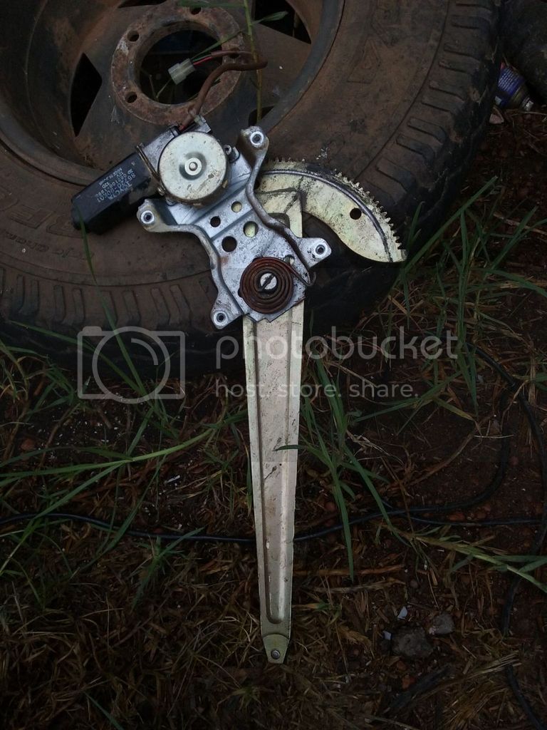

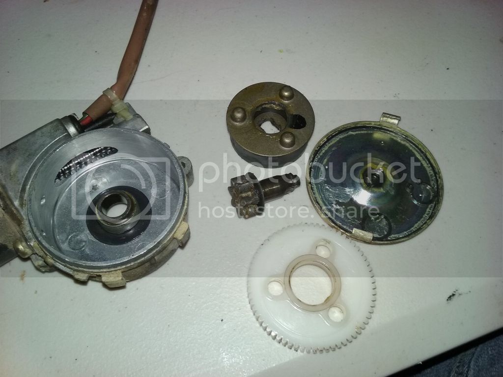

Here's a pic of the regulator, it might help someone in finding a replacement. I read somewhere 1st gen 4runner ones are the same. I had a 4runner manual regulator kicking about and it was different (both are 1/4 window models) but the gear profile was the same so you could weld that on to fix a LC one.
I pulled the regulator apart and it was all surprisingly high quality. I greased everything, amusingly using the grease that came with a Tamiya 1/32 MWB on the plastic gear. Back together and it was better but still a little noisy, I think there's a bolt or something rubbing somewhere. I've ordered some new bailey channel and weather strips so that's a job for another day.

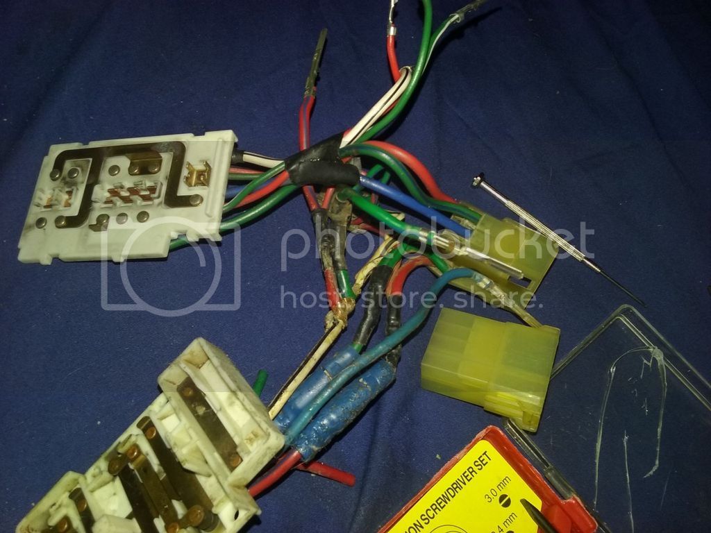

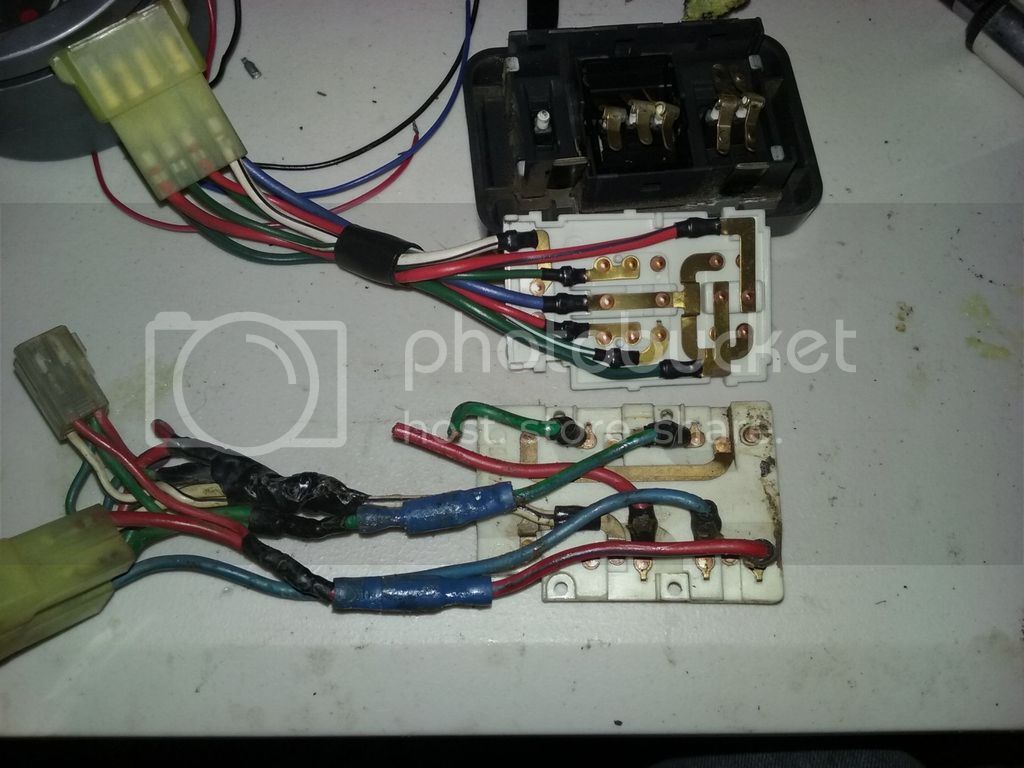

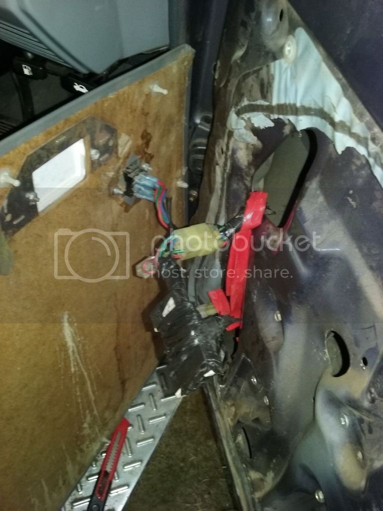

The drivers side actually still had the remains of the original electric window switch wrapped up in tape rattling around in the door. I got really lucky (or so I thought) and found a second hand one on eBay from an LJ70, with the auto down. At this stage I thought mine had auto down originally as it was in the manual but that wasn't the case. Upon receiving the switch it had a different plug and an extra wire.
So I thought I might be able to swap plastics from the new switch onto the old one. Nope, they work completely differently. Bugger.
As you can see, the original is a mess of tape, cut wires and crimps. Also note that the original has much larger wires.
Luckily the wire colours were the same, aside from the extra one for the auto down. I repinned the new switch into the old plug and rejoined the cut up mess in the door.
And all soldered/heatshrunk/taped in. This kind of worked. I could control the passengers window but not the drivers. I hooked up the aftermarket switch again and then the drivers worked too. I'll sort it out properly another time, I'd love to sort out the auto down. Maybe utilize the aftermarket switch as an auto up/down.
If I did it again I'd get a new 4Runner master switch. They have an extra spot for central locking but otherwise are probably closer mechanically to the early landcruiser switch. It's worth noting that AE86 electric window switches is at least externally identical to the landcruiser switch but were available with auto up and down in Japan. I believe some Celicas also had the same switch.

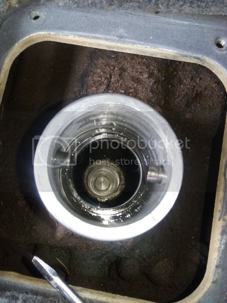

My gearbox was leaking quite a bit of oil from the shifter boot so I replaced that and put a hose clamp around it so it can't work loose again. It can still breathe through the stick. A few years back I had a Sierra(Samurai) transfer fill with mud from a lifted boot and I'm not keen to replicate that with a very expensive gearbox!
I replaced the shifter sheet and bushing. I had a hell of a time getting the little bushing out as there's a little lip at the top of the cup. I filed it a little with a grease loaded file and pulled the bushing out with some circlip pliers. The sheet had totally disintegrated leaving just the rubber base. It shifts much nicer now and has no rattle.

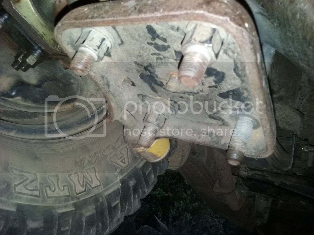

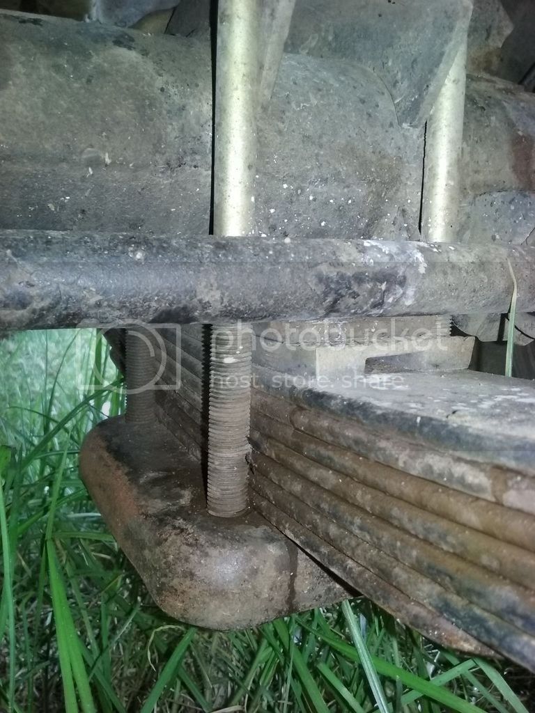

It was developing a slight death wobble which I thought was the slightly loose front wheel bearings. One day I threw a chock under the front wheel and the diff moved forwards a few cms! As it turned out the U bolts where very loose with one missing the nut. The diff was floating 3-4mm above the leafs! :eek:
Suzuki U bolt nut vs Landcruiser! :lol:
You can see how much the diff has been moving by the witness marks on my caster wedges. :eek:

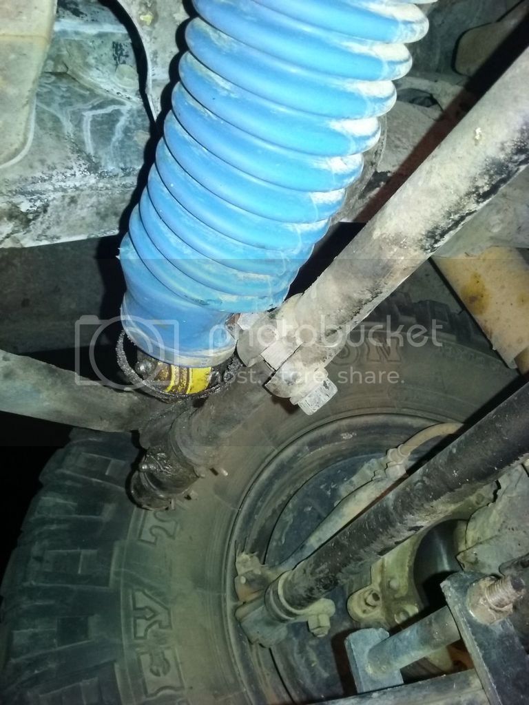

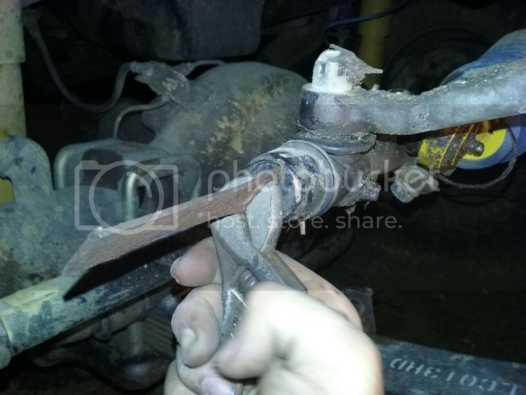

Whilst I was there I tightened up the rod ends, Landcruisers have a fantastic system for this. Pull out the split pin, turn the slot, reinstall split pin, done! Obviously with these and the U bolts tightened it drove much better. I can actually drive in a straight line now!
The steering wheel was about 1/3rd of a turn out when going straight due to the lift so I adjusted the drag link. I put the securing bolt rewards so it would stop eating my steering dampener boot.....

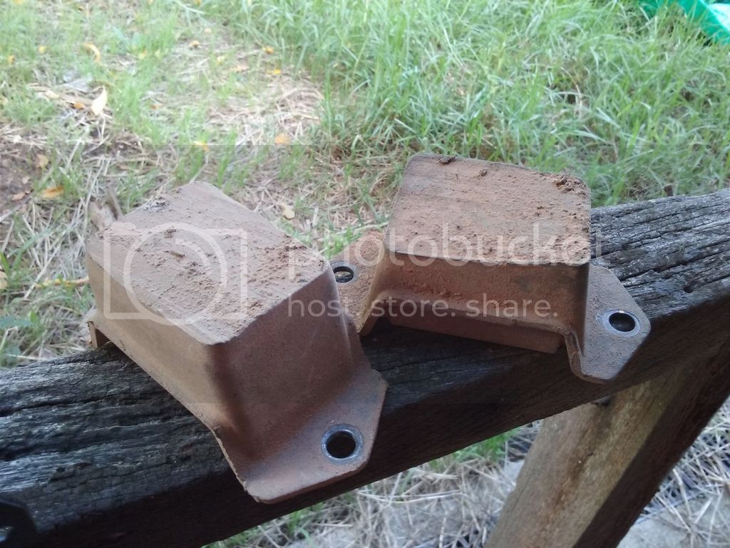

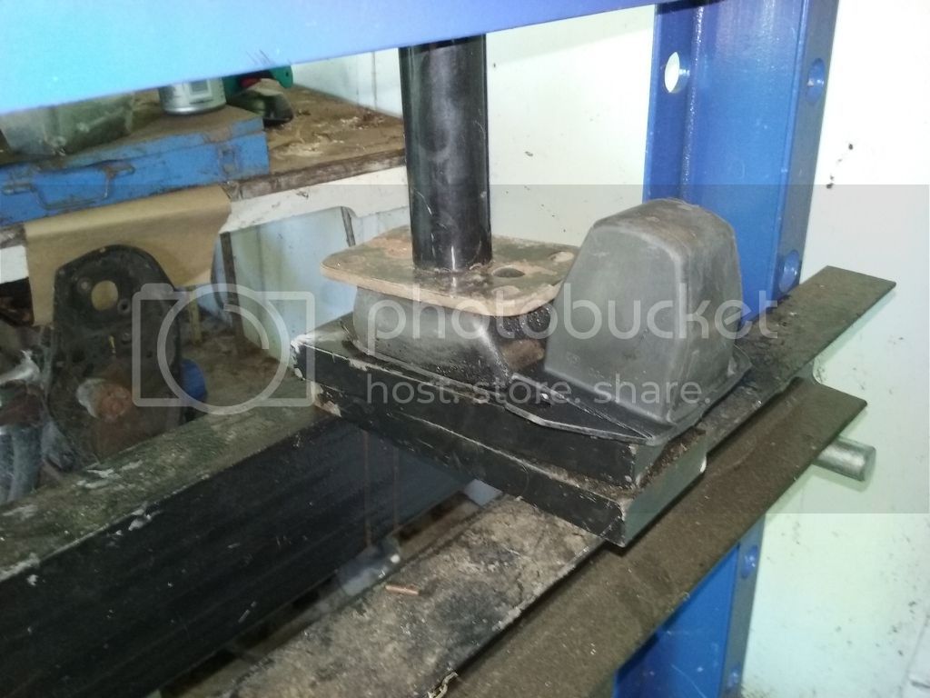

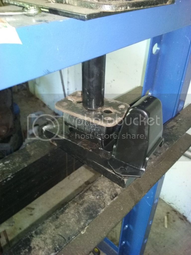

The previous owner had made the.... Questionable..... Move of cutting the rear bumpstops in half and removing the front ones all together with the aim of increasing the flex. Amusingly, it doesn't reach the bumpstops when it flexes anyway.
I know this likely means my (almost new!) shocks are buggered, but luckily the front diff hasn't hit the sump or chassis.

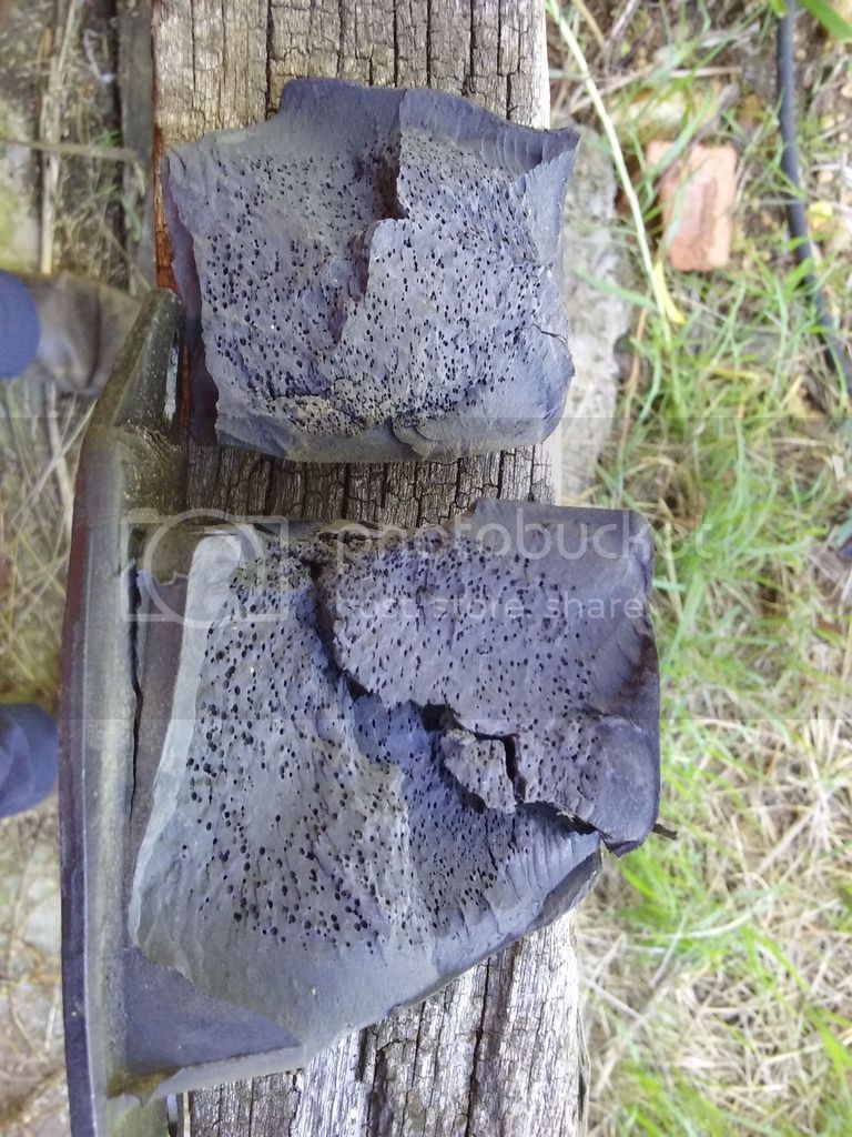

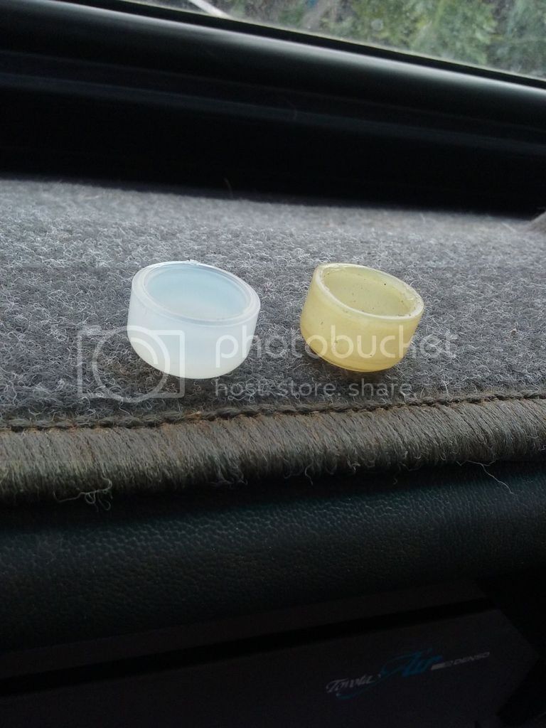

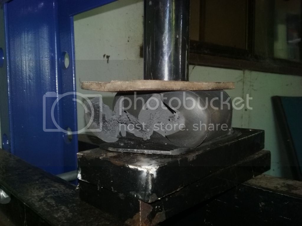

I bought some new bump stops and wacked them in my press to see how far the compress for shock sizing. As it turns out, they compress much more than I thought!
The fronts compressed down to 40mm and the rears to 55mm. My press is 20t but I didn't use anywhere near all of that, it doesn't have a gauge so I can't tell you how hard I squished them. Even if you really cranked down on them they wouldn't compress much more than the figures I've given. An original front one only compressed to 50mm.
One of them went pop with very little pressure. I'd say it's best to stay away from "good rubber" brand bumpstops. I cranked down on an original one as hard as the press would go and it survived fine.
It's interesting to see the inside of it. It split of the side with more bubbles. Luckily the only complete original bumpstop I had in one piece was this one!

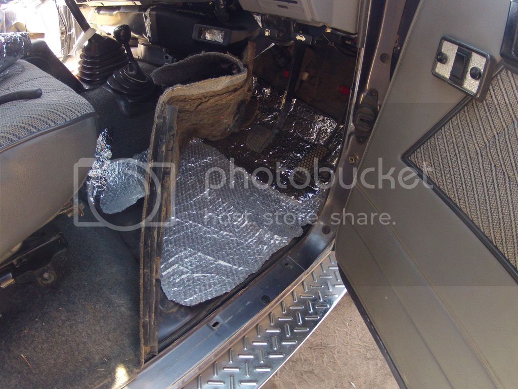

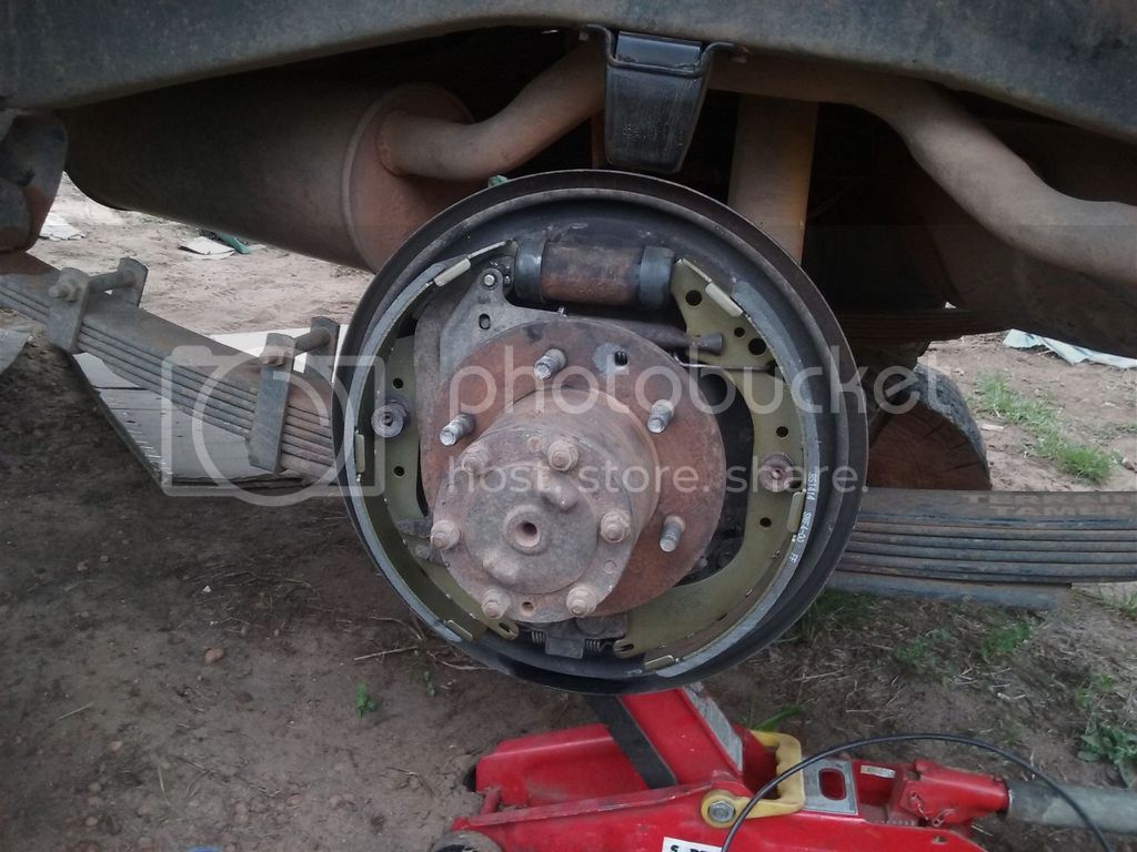

I replaced the rear brake shoes. The previous owner claimed to have just replaced the rear shoes and cylinders but only the shoes on the passengers side had been done.... This was an absolute arse of a job and I have less than no desire to keep drums brakes. The whole point of this was to get my handbrake working for my roadworthy inspection. The arm on the passengers side was seized and the drivers side adjuster has stopped working so it was way out. It now works quite well for a Landcruiser handbrake.

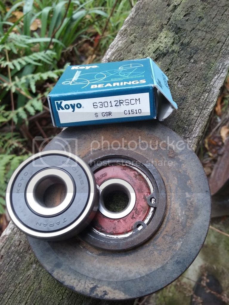

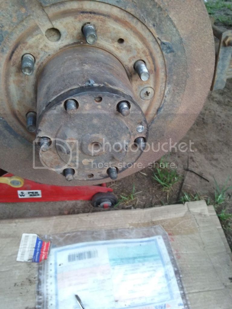

I also tightened up the rear wheel bearings. I sure a few people on this forum have been here, where both holes to back the axle out have a bolt broken off in them!
The drivers side didn't look to great! :eek: I'll be swapping out for a 60 diff soon so I just regreased it.

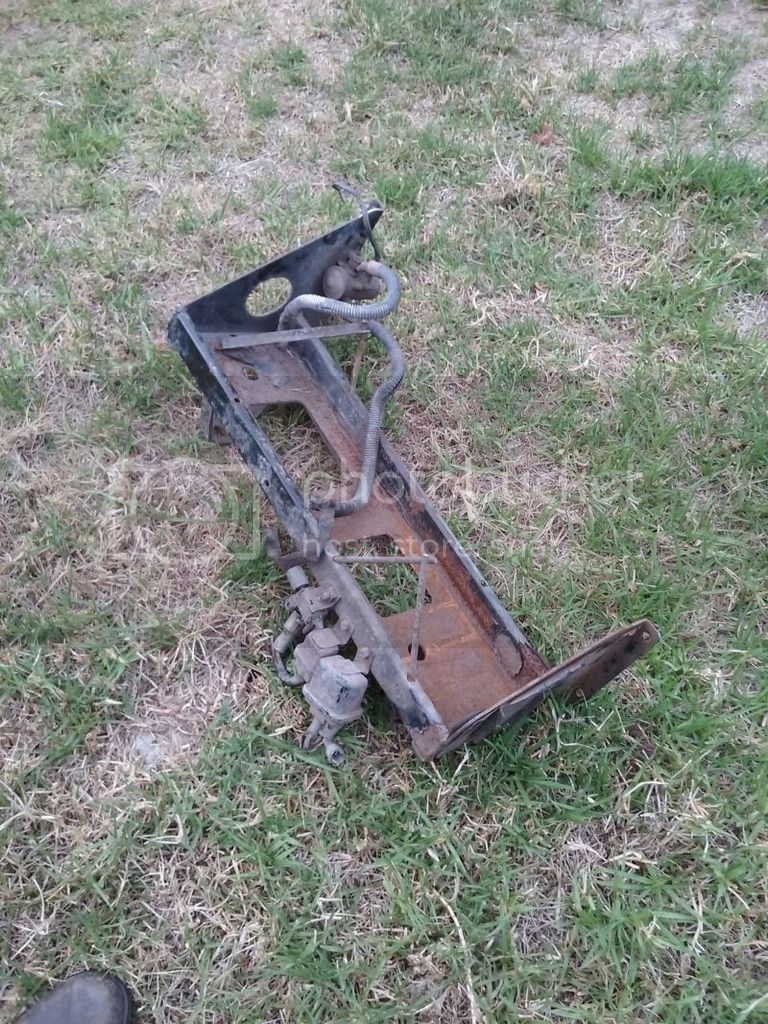

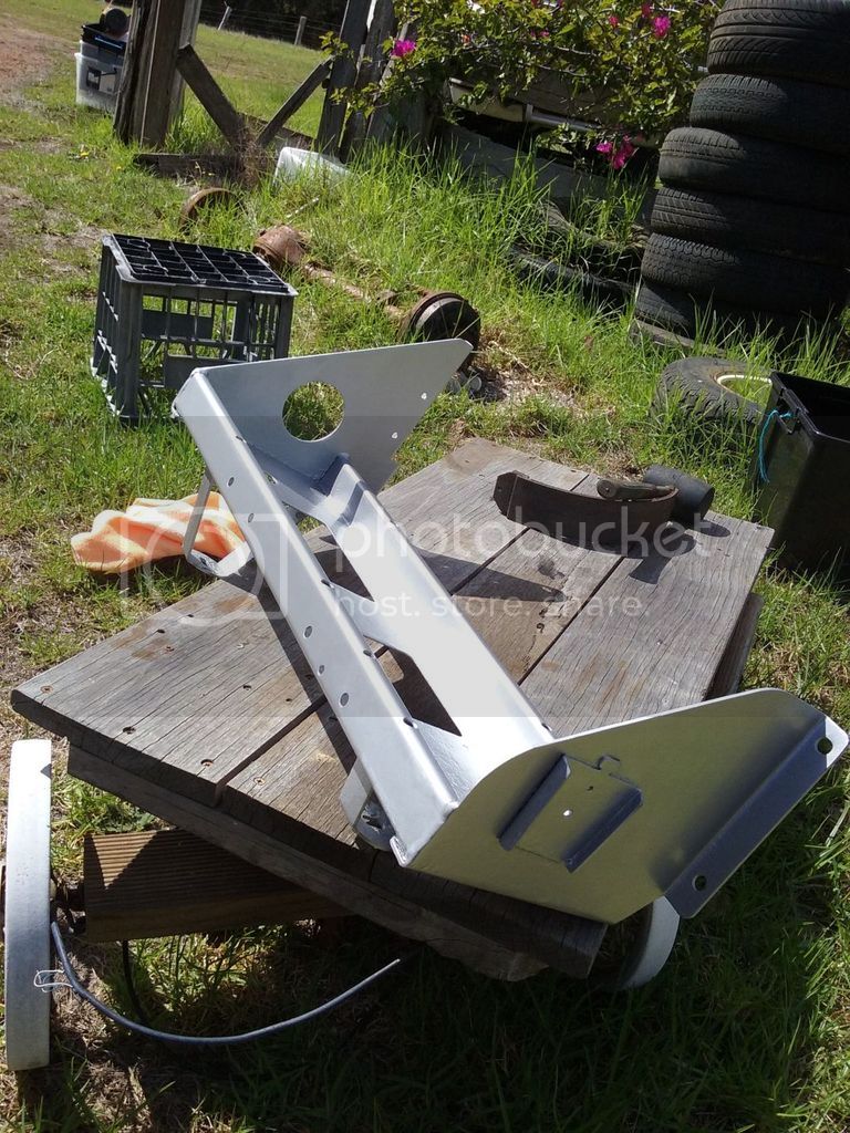

A friend of mine had this s***box troopy. It had suffered the most spectacular radiator failure I've seen. Something (they think a fence post) got caught between the diff and the radiator and totally stoved the radiator in from the back. It also smashed half the fan and bent the steering dampener almost 90 degrees. Best part is they didn't notice and kept on driving until the motor (1HZ) called it quits! They were driving bog holes so it's kind of understandable they wouldn't see the steam ect.

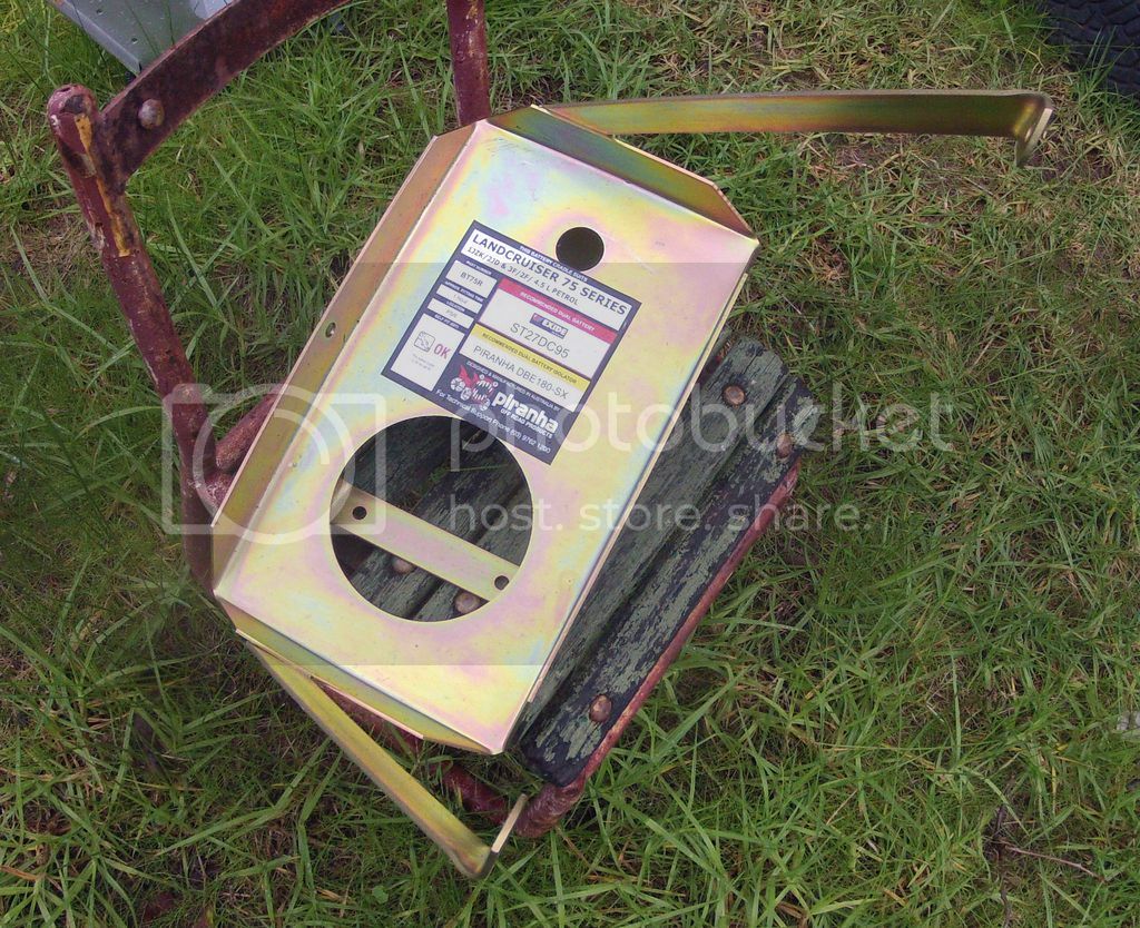

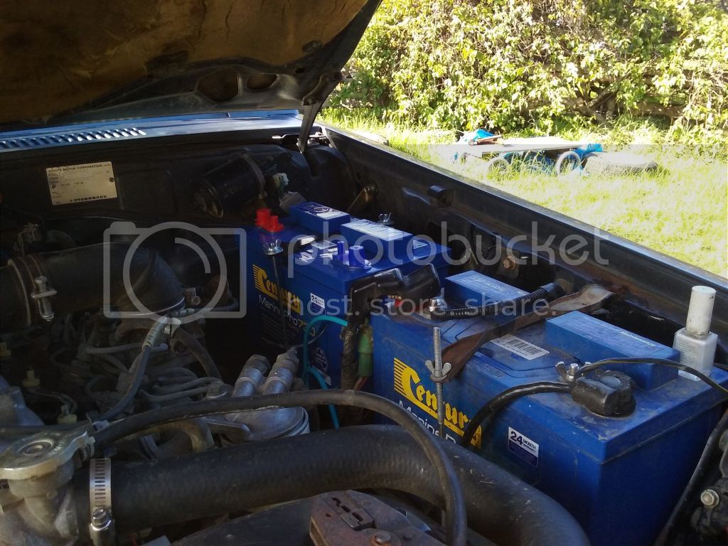

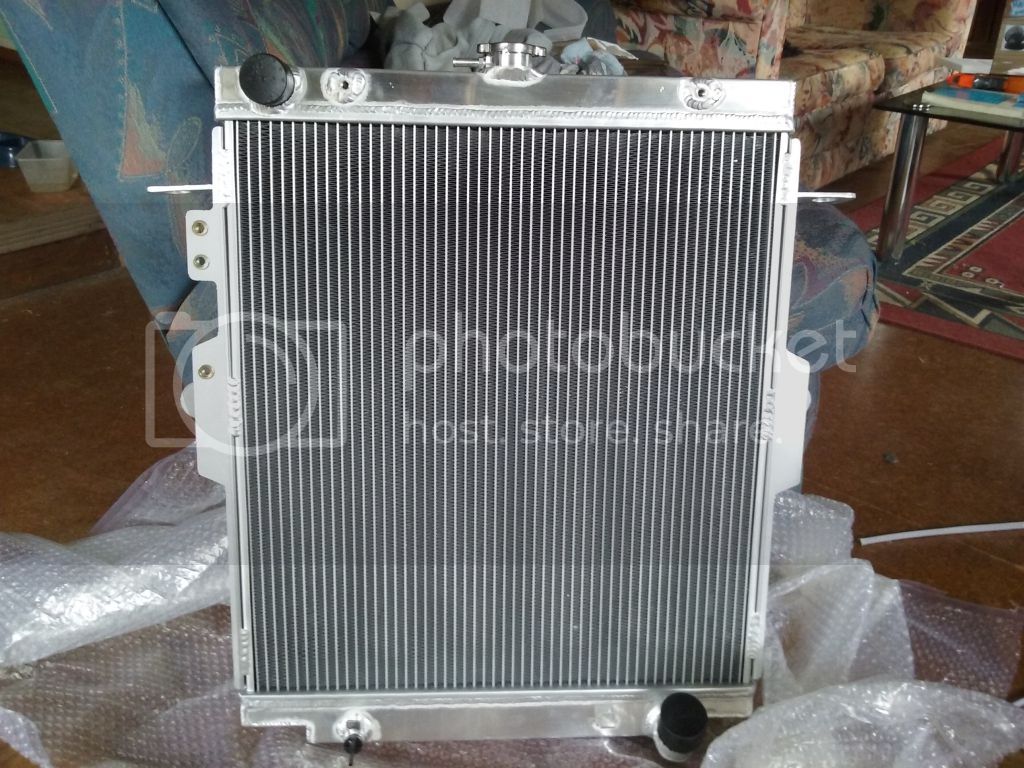

It had and ARB dual battery tray so I nicked that, I really should have taken the bullbar but it was very bent. I'm looking to make my own anyway.
After about 9000 hours and sanding and painting It came up pretty well.
Unfortunately it was quite some way off fitting. None of the bolt holes really lined up, the rear mounting pad sat slightly to high and the front to low. Simple filing of the holes wasn't going to make it work, it needed cutting and welding. Another issue was the clutch hard line had to be relocated and there was really no where for it to go without new lines.
My biggest gripe was the wiring loom has to be moved and the glow/starter relays had to be relocated from their spot in the inner guard to the side of the battery tray where they would cop all sorts of mud and dirt. It also has a sharp edge pushing into the loom where it comes out of the firewall. Basically, I cracked the s***s with all the stupid compromises this tray has. I haven't decided if I'll make my own tray or get a Piranha one. I'd like to mount both batteries as far forward as possible so I can put a compressor at the back.

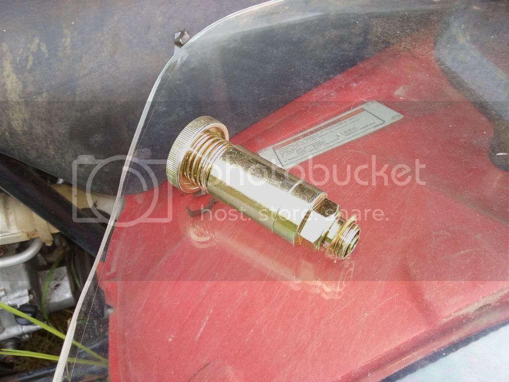

My fuel primer was leaking and using it resulted in a fountain.
I know you can rebuild them but I didn't fancy having a 32 year old piece of plastic in the range of sticks and so on that was critical to the running of my car.
Fitted and no more leaks! I've since seen there is a bosch one that you don't have to screw down.

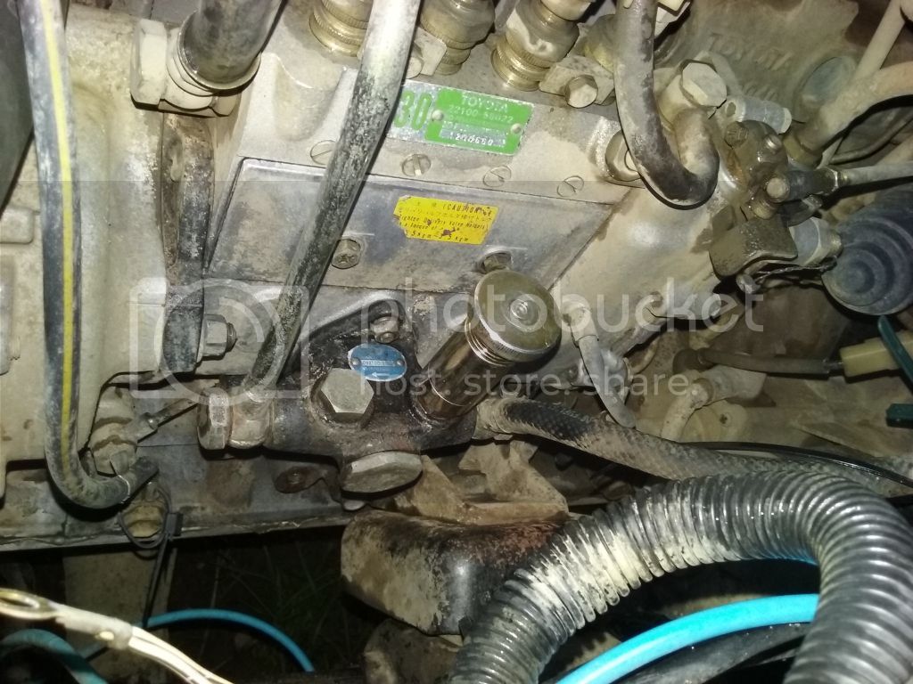

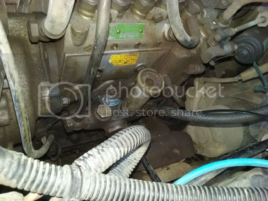

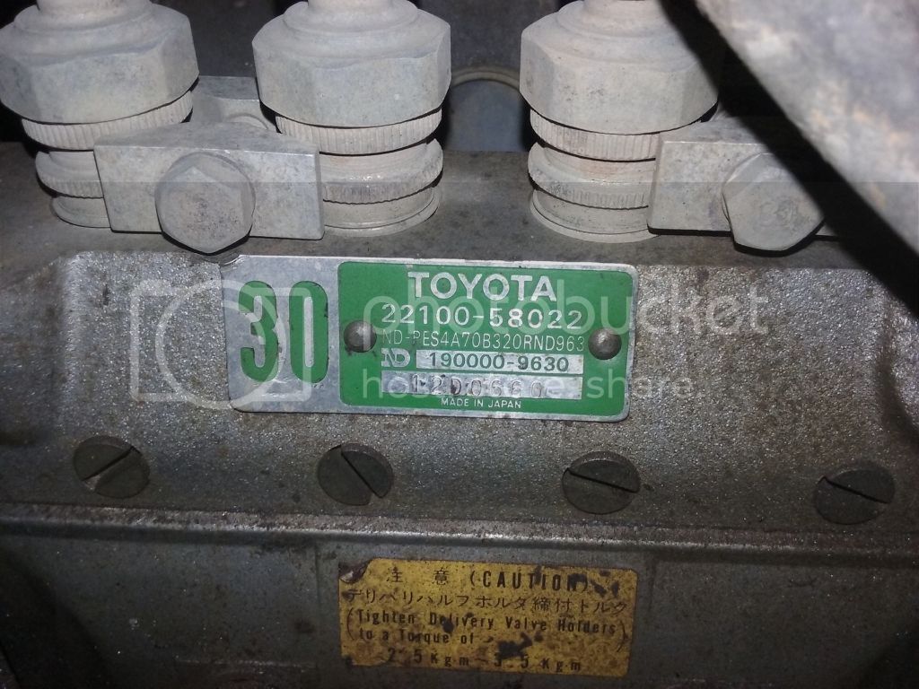

Whilst I was there I advanced the injector pump timing. It was actually retarded 2mm from the mark, I brought it to about 0.5mm above the mark. I don't think this really made any difference. It might help fuel economy a little.
In the longest line of letters and numbers the A"70" means this pump has 7.0mm elements.

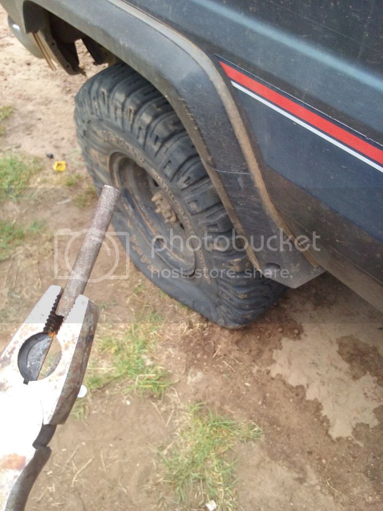

I got a flat tyre, there was the end of a freakin file stuck in it!

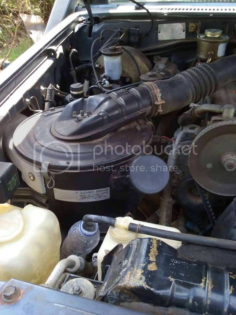

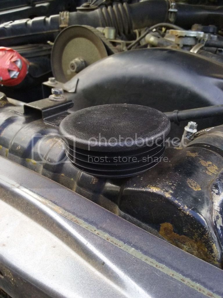

Whilst it had a snorkel fitted, the original intake was still fitted and open. I removed the piping back in Adelaide and taped it up. The red tape and lump of cardboard was to stop it making a wub wub sound.
I got this 70mm pipe plug to blank it. It wasn't as snug of a fit as I hoped.
I fitted it with some silicone and sealed a few pin holes in the airfiler housing. The motor sounds much quieter now, especially under load. I didn't think the tape made that much noise!

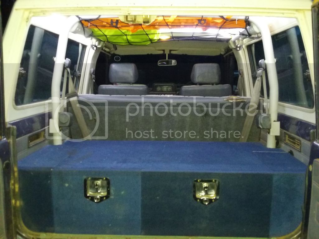

One of the best things about this car is the rear drawers. The previous owner made these. It's amazing how much stuff you can safely fit in and how neat and organized it can all be. You can see it has little hatches of either side of the drawers, on the passengers side I have a hand winch, belts, tarp and tow hitch. The drivers side has camping stuff (lantern, first aid kit, untensils, spare food ect). The passengers drawer has heap of tools and spare fluids. The drivers side drawer has my aircompressor, a trolley jack, tyre repair kit and spare parts. When I pull the back seats out a lot of that stuff will go into a box there and the drawers will get used for camping stuff.
As you can see, a pair of maxtrax are a perfect fit above the roll bar. Not the most convenient place to get them from but it's not like you use them often.

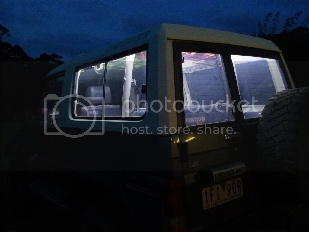

The previous owner also installed an LED strip light the whole way around the roof. This throws fantastic light inside and even lights up outside the car a bit. Great for camping! It's just jumped out of the original interior light.

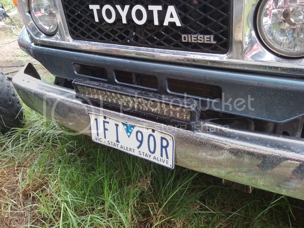

I bought a lightbar, I went for a 20" size as it will fit between bullbar posts. It's a 210w osram 4D eBay spec jobbie. I've kind of been against lightbars for a while as my friends ones have always had very blue light which IMO makes it much harder to differentiate objects and so on. The mounts are really great, they slide along the length of the lightbar and haven't rattled loose.
The beam pattern is actually quite narrow, maybe around 25 degrees max. It illuminates normal roads quite well but I'd like more spread for the windier roads and general bush driving. It has quite a long throw for a light bar, it puts useful light 400m away and is a league ahead of the 6 Narvas it had previously. The colou is whiter than I expected but still a bit blue for my liking.
I whacked the watt tester on it. I never expected it to make 210w but less than half that is a bit of a dick move by the seller!
It came with some 18w spread lights, these are great, I plan to stick them above my spare wheel. They only use around 10.5w though.
The watt meter is a handy little doodad, obviously you can do much the same with a multimeter but it has its place. They're cheap on eBay. 100A 60V DC RC Helicopter Airplane Battery Power Analyzer Watt Meter Balancer OG
Here's the totally bull**** reply from the seller. :rolleyes:

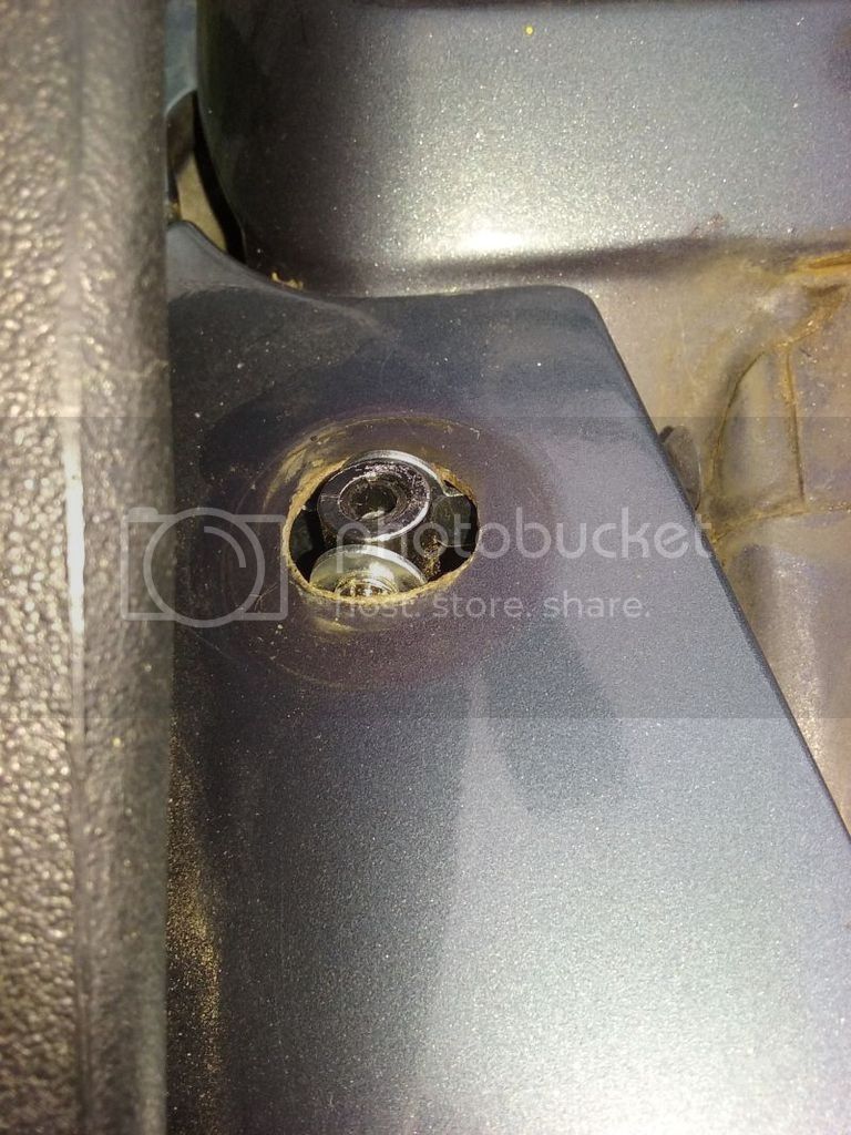

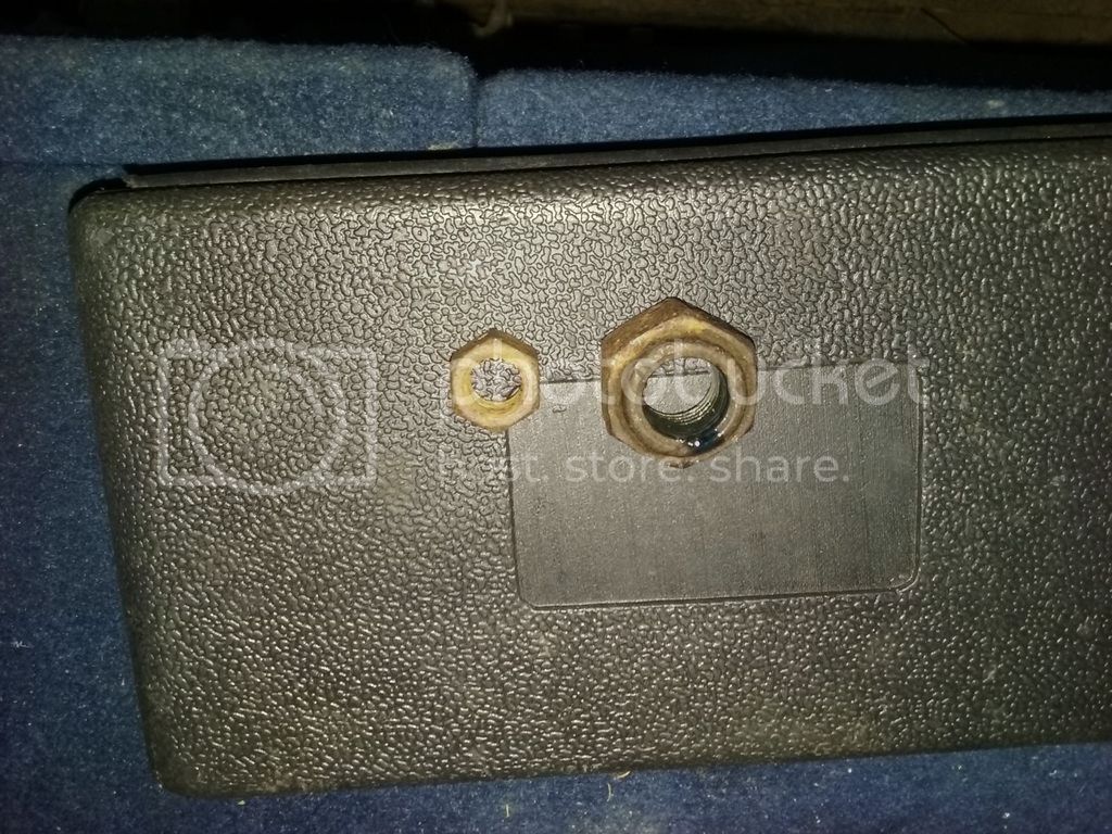

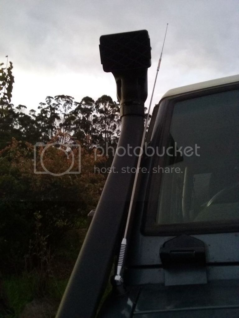

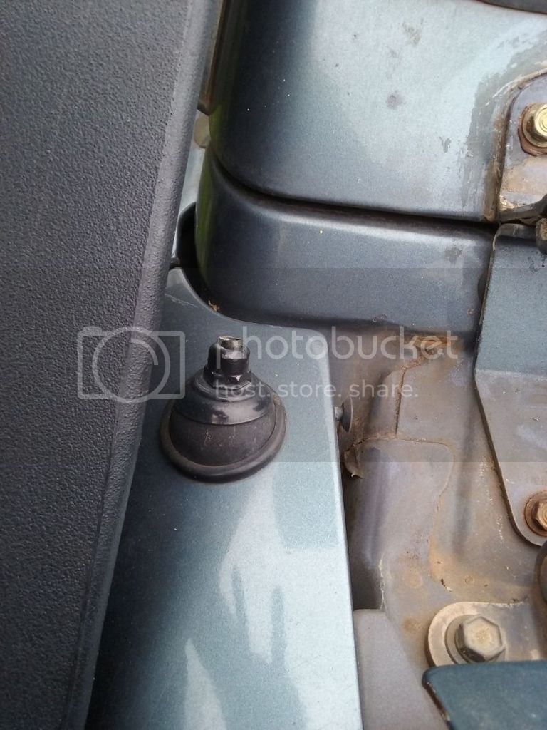

Yesterday I replaced the radio antenna, anyone who has pondered how on earth you actually get anywhere near the bloody thing will understand why this is worth posting about.
The culprit. Undo the nut and it falls into the inner guard. I found the remains of an older base in there too.
Remove the antenna from the base and slip the cord end in first Get your contortionist skills on so it comes into the engine bay. Bunch the cord up so the base doesn't fall into the inner and screw the fittings onto the top. This might take you a few hundred goes. Note the paint fade!
Viola! It gets better reception than any antenna I've used before and if I break it I only need to undo 1 screw instead of going through the whole ridiculous process. It's an Aerpro AP46.

After a lot of research I decided to go for an alloy radiator over a copper/brass one. I mostly based this on a few people saying they had improved cooling after going from a 4 core brass to an alloy. It's a HDJ7x radiator which is about 4" taller than the BJ7x one, to fit this I'll have to route the bottom hose to the other side and extend the fan shroud. Lots of people go for the copper for perceived "bush proofness" but I don't carry solder and a blow torch, I do carry epoxy which will fix both. From my reading the alloy tubes are tougher but my worry is the tanks/welds cracking.
I have a dual input thermocouple so I will be measuring the in/out temps of the current 4 core (66mm thick) copper and the new 2 core 52mm alloy one to see which cools best. Even though the alloy one is taller they both have roughly the same core volume.
The bearings in both my tensioner pulleys were noisy, especially when wet. From my research a lot of people had trouble finding a replacement air con tensioner pulley for a 3B. I pulled mine, measured it up and found a perfect match. Turns out about 11ty bajillion cars use the same pulley, including 4runner, Hilux and Pajero. You use the little spacer that goes behind the original pulley. Bonus is the new pulley has a replaceable bearing!
The power steering one is simpler, just swap out the bearing. They're only a few dollars. I also swapped out the power steering belt, I'd already done the others but Terrain Tamer in Adelaide gave me an alternator belt instead of P/S!

I put a Piranha BT75R second/dual battery tray in. I wanted to make my own and mount the batteries as far forward as possible so I could squeeze my compressor in but I just wasn't going to get to it before we went away.
The tray itself is pretty bling with it's yellow zinc plating. It all seems quite well made and I was very impressed to see it came with some very high quality Japanese Industry Standard bolts (so 12mm head on M8 thread). Impressive given the relatively low price ($195 delivered). I'm not sure where they get their Toyota model codes from though. "1JZK and 2JD"
Here's the gap. The main loom needs to be moved to run along the edge of the engine bay. It picks up the bolt that the aftermarket diff breathers are mounted on. This is where I ran into minor issues. That thread is recessed and the arm of the battery tray hits the body furtther down long before it touches the panel around the captive nut. Even if it didn't, it would have been crushing the loom. I needed to space the mount out about 10mm. Living in the middle of nowhere I can't just go to the hardware store and grab some washers so I knocked some up from flat bar, not pretty but they achieve the purpose.
And done, well almost. I have a Voltage Sensitive Relay from the 4runner I need to put in and I haven't found a good spot for a fuse box yet.
For the roadworthy inspection I swapped the tyres from the 4Runner onto it, I've gotten used to it now but at first it looked hilarious with the 31s (which measure 29"). It doesn't really feel any faster. As you can see I also put the 2 little 18w light bars on and I'm really impressed with them, they've filled in some of the spread the 20" light bar lacked.
With the transfer bash plate back on (it's been off for 5 months) I can now hear a heck of a whine from 90km/h+. Ugh, the list continues to grow. Hopefully it's somehow the diff, but it's likely the transfer or gearbox [EDIT it was the diff]. I hope it's not the gearbox. I've been chasing some auto 60 series transfer gears (2.29, 15% lower) but haven't had any luck. I really like a lower low range but the Marks adapters gears are miles out of my budget.

Cheers for putting up those pulley bearing part #s, I need to change mine too. Might just delete aircon all together though
