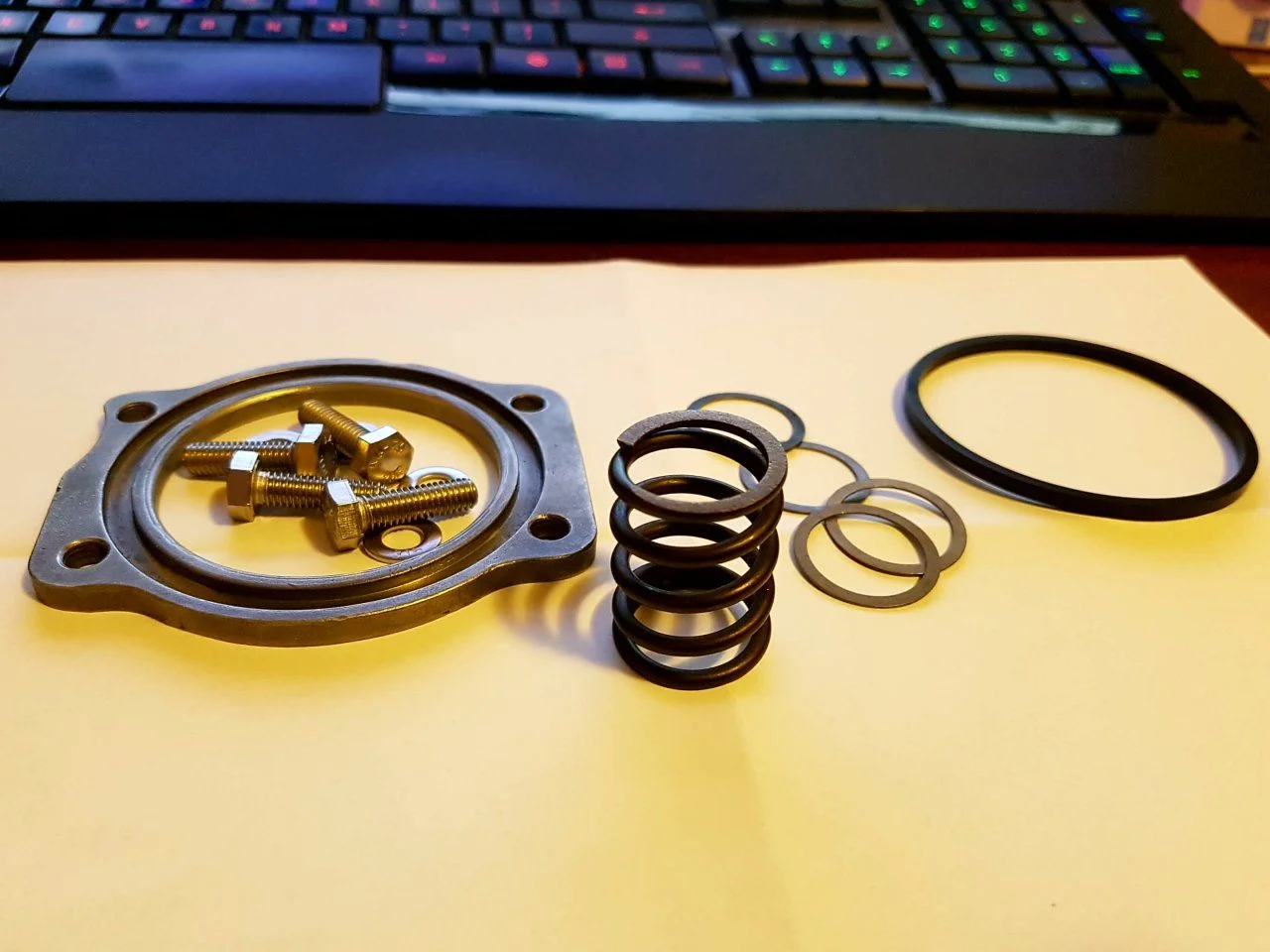

I recently stripped the boost compensator on a breaker i have. There was two washers on top of the spring, they looked stock, colour and size. Anyone heard of this?
Yeah, it was done in later versions.
My 1990 HDJ81 didn't have them.
They limit aneroid pin travel. Effectively a stops the pin going onto the fuel cut side of the taper

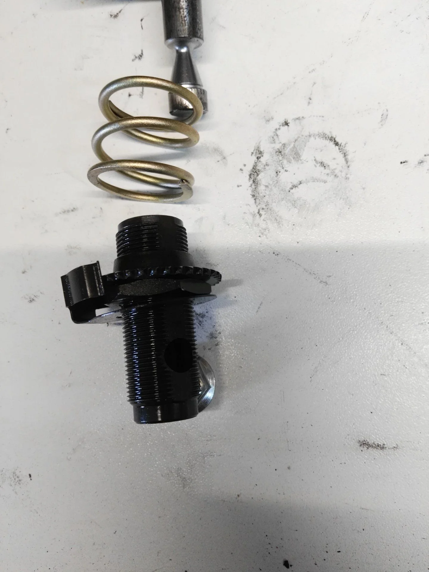

Here's a pic of the star wheel, and the aneroid pin bushing.
The wheel has maybe 60 notches around it (rough estimate).
The thread pitch is quite fine too. Maybe 1.25mm or (again, an estimate) may be 1.5mm.
If you're making big adjustments, it's far easier to take the aneroid cover off, remove the aneroid and diaphragm and rotate the star wheel from the top. If you remove the aneroid pin, you'll need to grind the bottom edge to get it back in if it hasn't already been ground.

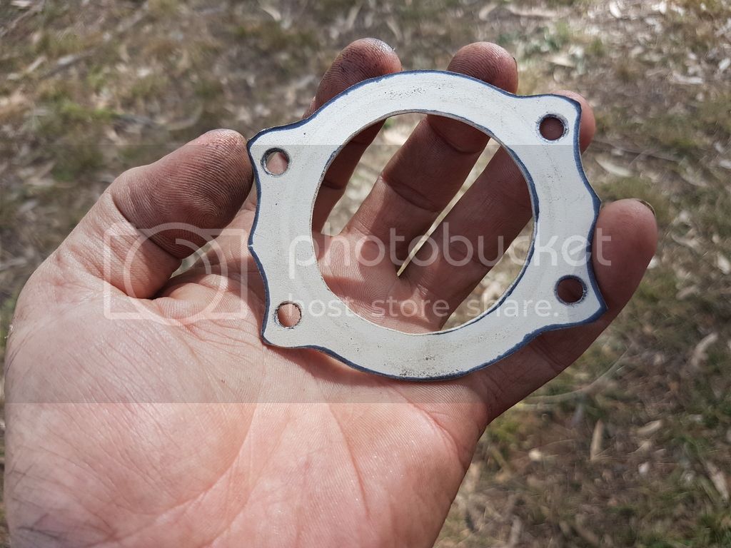

This is my solution to enable the follower pin to ride on the outside diameter of the aneroid.
Has held up past 35psi so far and still retains the smoke screw cam if you want to use it.
