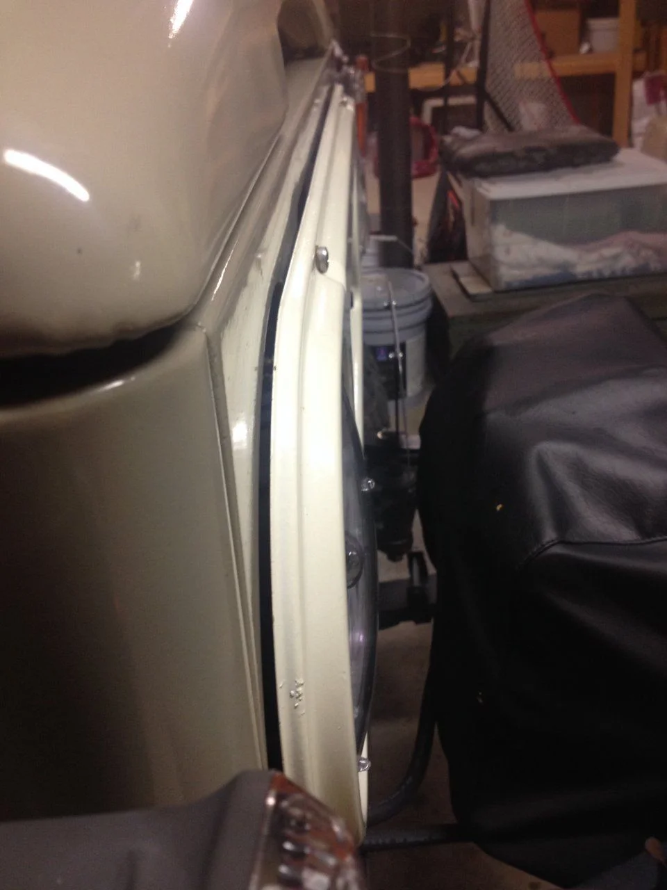

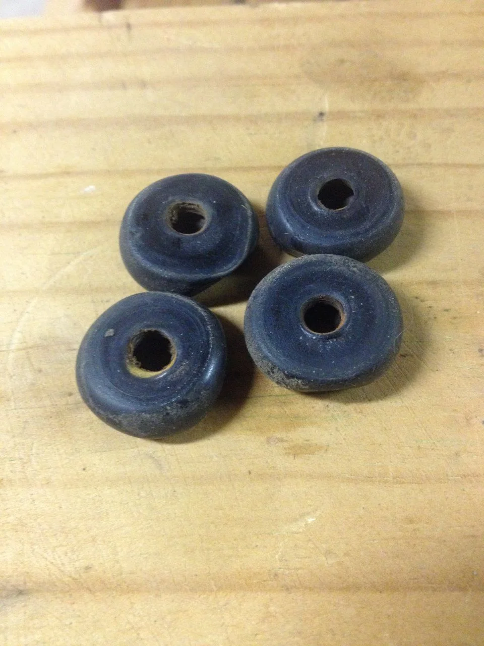

Because of this thread, which has some good bezel info, I just replaced these squished OEM bezel rubber spacers.

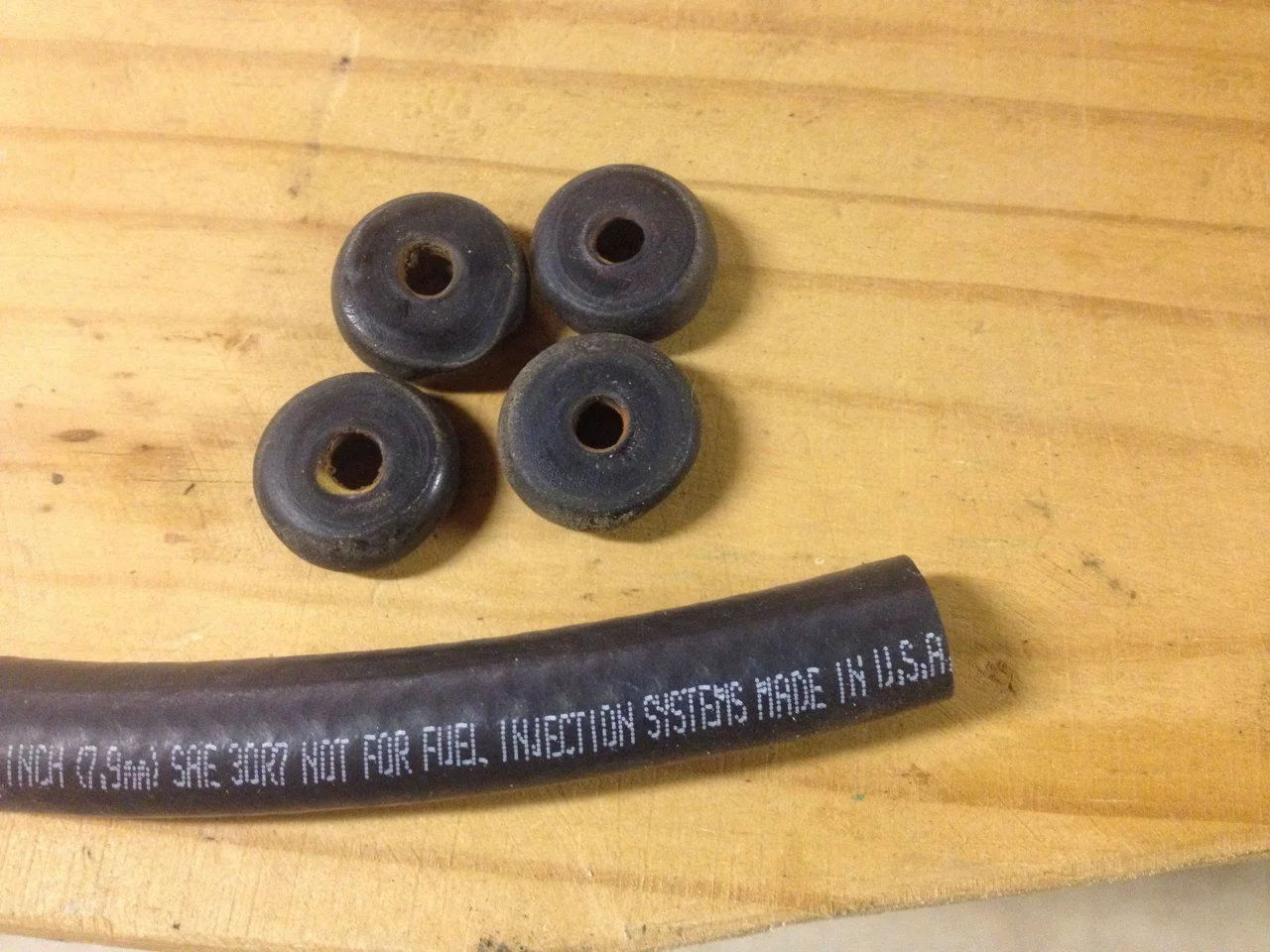

With this...some extra 5/16" fuel line I had in my stash, cut to 1/2" lengths...A $0.00 dollar non OEM upgrade I can definitely live with, thanks to some informative and frugal MUD members.
Never knew there was to be a space between the bezel and bib. Have a look at my new 5mm (+/-) bezel spacing.
American ingenuity!:bounce2:

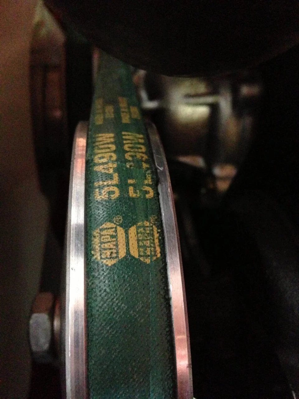

Installed a new NAPA fan belt for my Atlernator-A/C-Water Pump & Crank.....And now my Amp meter is working, more properly? How does changing a fan belt make the Amp Meter go from barely registering amps back to the battery to working more properly like Rudi's video?
Funny thing, when I got the old belt off, its shape was distorted. I can only surmize this distortion in the belt caused the issues?
None the less, I guess my 40 seems to like the new belt. :D
Did you use the green ones? They're awesome. @FJ40Jim posted somewhere that these trucks don't always run well with the thin car type belts. They need thick V belts that take up the whole groove in the pulleys. So that's what I did.
Due to the aftermarket CCOT A/C unit, the wide fan belts that typically fit our 40's doesn't work on that pulley of my rig. I had to go with the XL 25-9580 NAPA belt. I am looking to see if I can replace the pulley/clutch on my CCOT A/C unit for one that has the wide groove pulley. I think another option is to get the 3 belt pulley from an FJ60 and rework the brackets. I believe the inner pulley of the FJ60 is for a thin belt? :meh:
