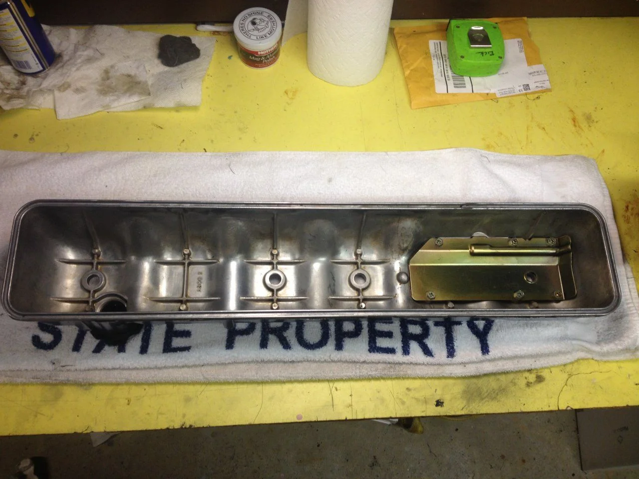

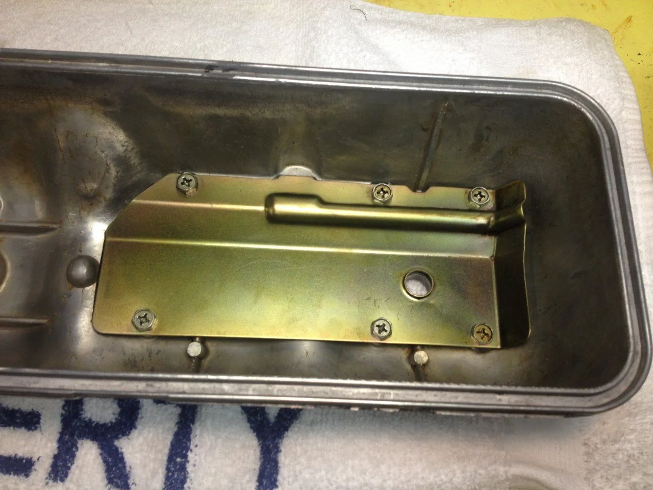

Mine has a baffle in the inner rear--I assume to keep the oil vapors down going into the pcv/vent. I didn't see that baffle in yours--Is this something that can be removed, if necessary?
Mine has the yellow zinc plated metal baffle as well, I just took it out to clean it and under it. I reinstalled the baffle, gasket and all six bolts with some thread locker. I don't think you would want to permanently remove it.

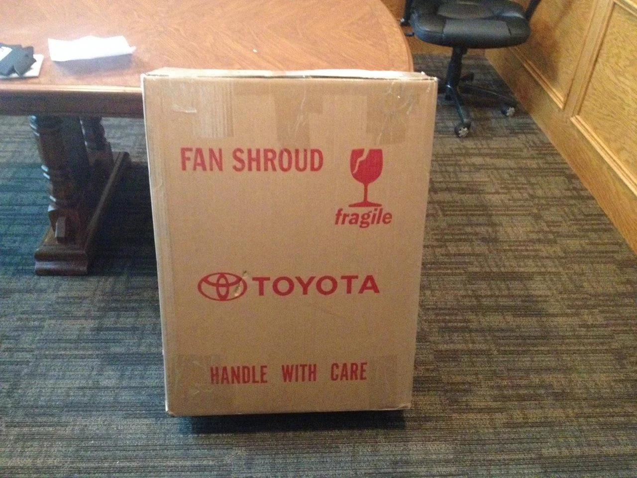

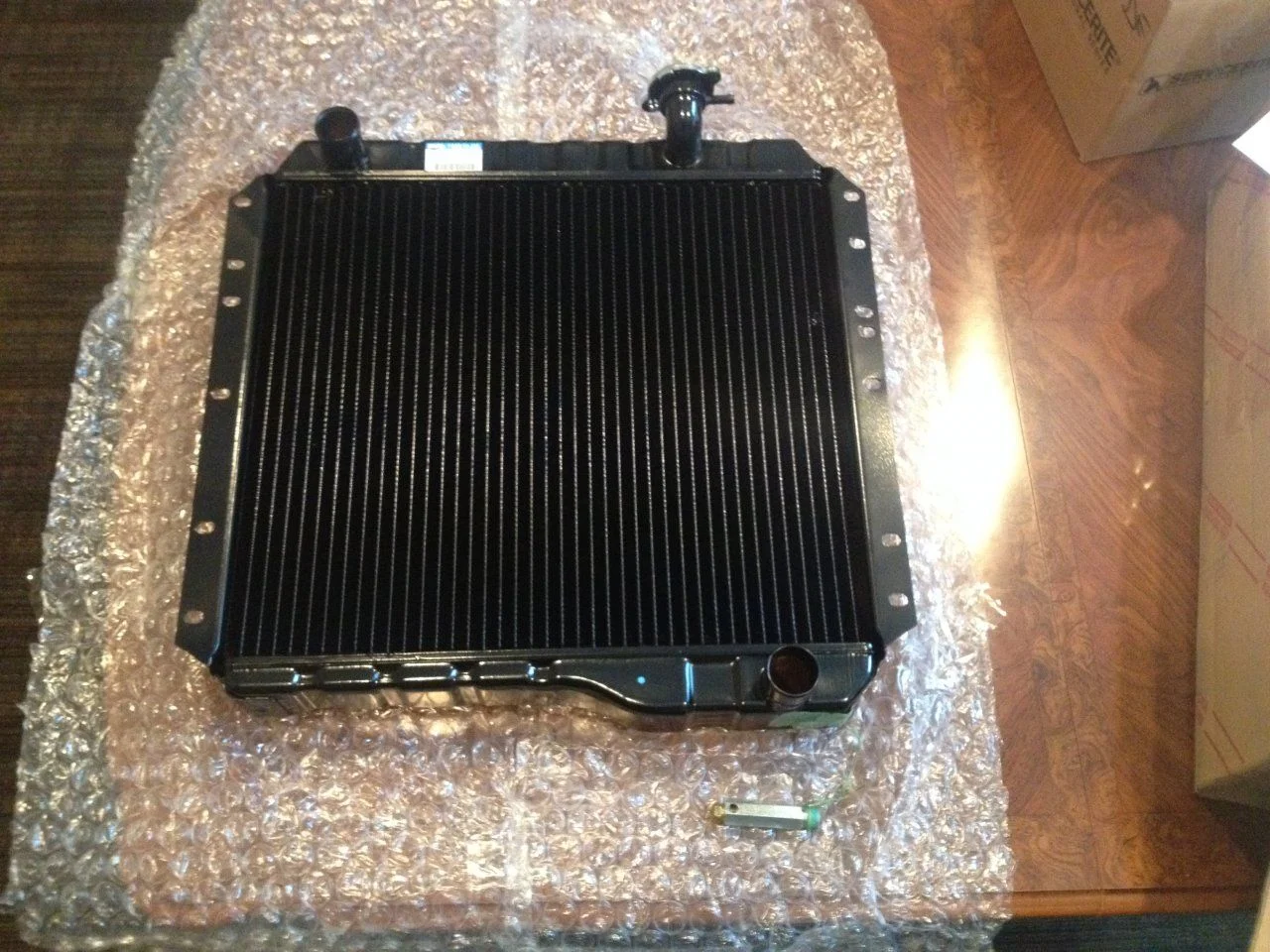

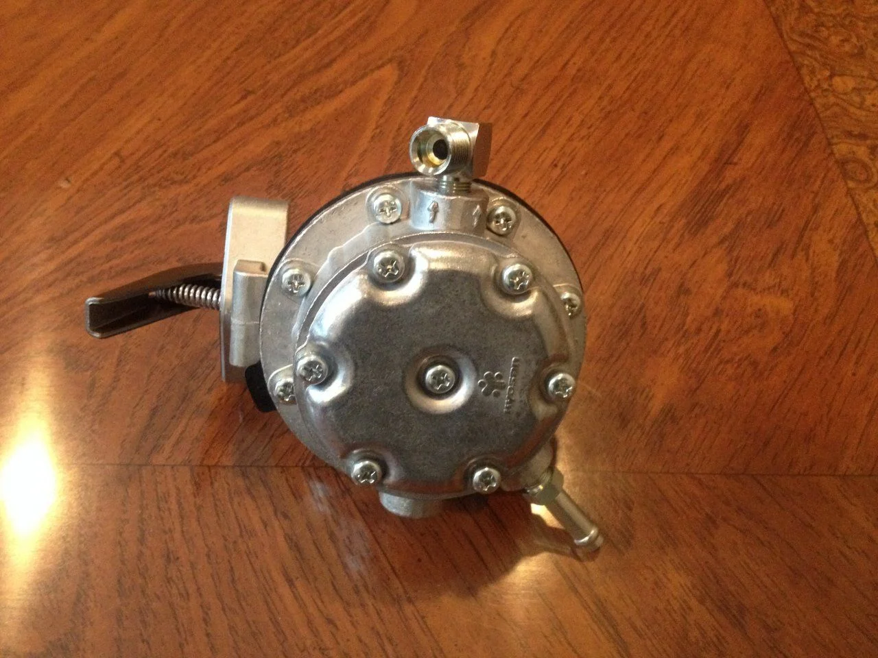

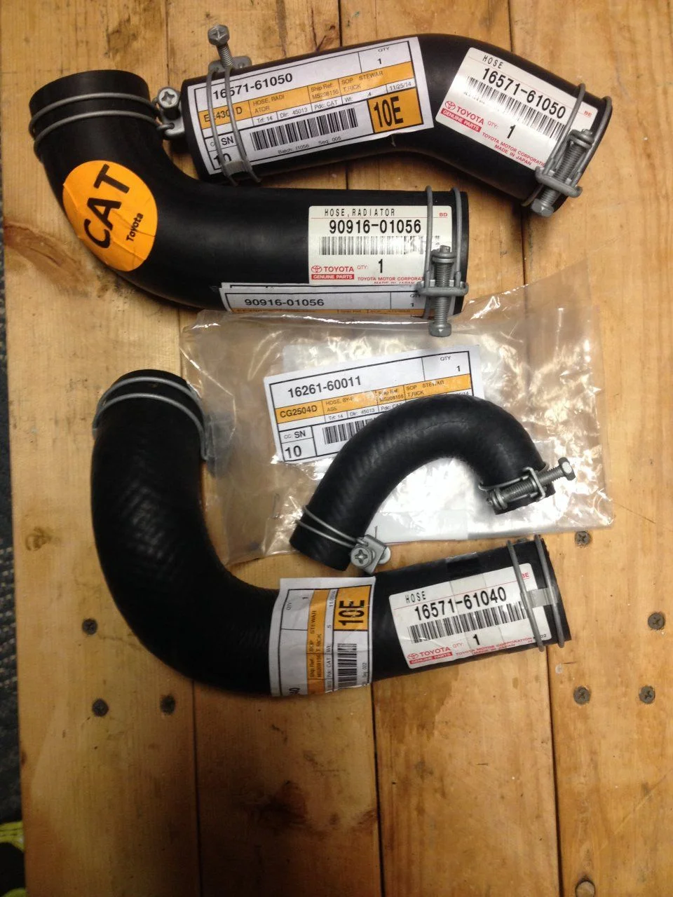

Come this Spring/Summer, I have a major project slated for my rig. I will be installing a new 2F power plant out of an '86 FJ60. The engine work has begun, and thanks to Beno, the machinist has most all the parts to get this done. While the shop is balancing & blueprinting my engine, I'm getting other new Toyota OEM parts for this change. Here are some update photos.
Big box of Toyota parts:
New OEM radiator:
New OEM fuel pump: (I will order the '80 FJ40 #90923-06001 insulator to run the '77 pump on the '86 block.)
New OEM Hoses & clamps:

It has been stated on more than one occasion, and by more than one Mud member, it is best to use OEM parts when available.......SO, the PO's aftermarket crap is getting removed and replace with some good stuff.
One way to look at it, I'll have some tested and working back-up parts when I get done. :)
Where did you get the OEM radiator?
Thank you, sir
