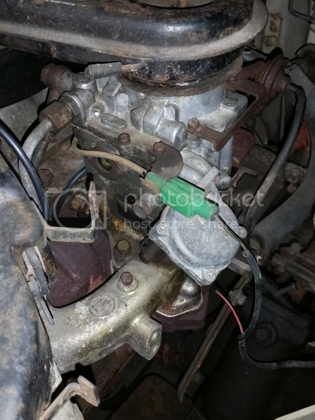

A few months ago, I had Jim C. rebuild my Aisan Carb, but in the mean time, I used a Trollhole. I was impressed with the Trollhole carb, and have peace of mind knowing I have such a nice back-up carb since reinstalling my Aisan.
Trollhole carb along with an updated Coolerman's connector:
Whats the updated Coolerman's connector? I have a trollhole coming right away is this somethin im gonna need?
Yo - My 40 came to me with a simple aftermarket male/female (LIGHT BLUE EYE-SORE) carb solenoid connection.
orig-carb-jpg.942179
Below is the white carb solenoid connection that comes with the Trollhole carb, and the black connector is Coolerman's PLF1P6.3B part.
img_0586-jpg.942180
Oh ok! I gotcha now. Mine has one that looks more like coolermans!
You had me worried there for a second! I had to go out to the garage to double check what was on mine.
