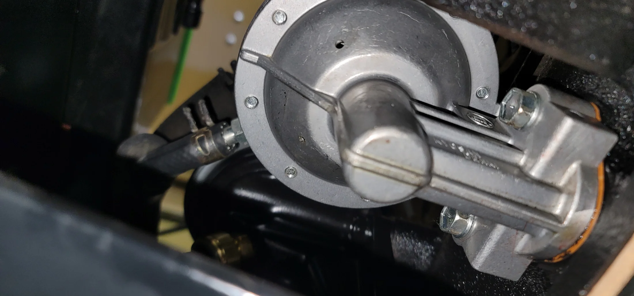

Question,
I just finished a restoration on my 77 with stock 2f engine. I have fuel leaking from the bottom of the fuel pump. Threaded connections for supply and return seem tight and dry as well as the hose connections. Is there a diaphragm inside that could go bad? If so, would it leak from the two holes located on the bottom of the pump. I currently have the carb off and being rebuilt so I can't run the engine and look while it's running.
Thanks
Dave

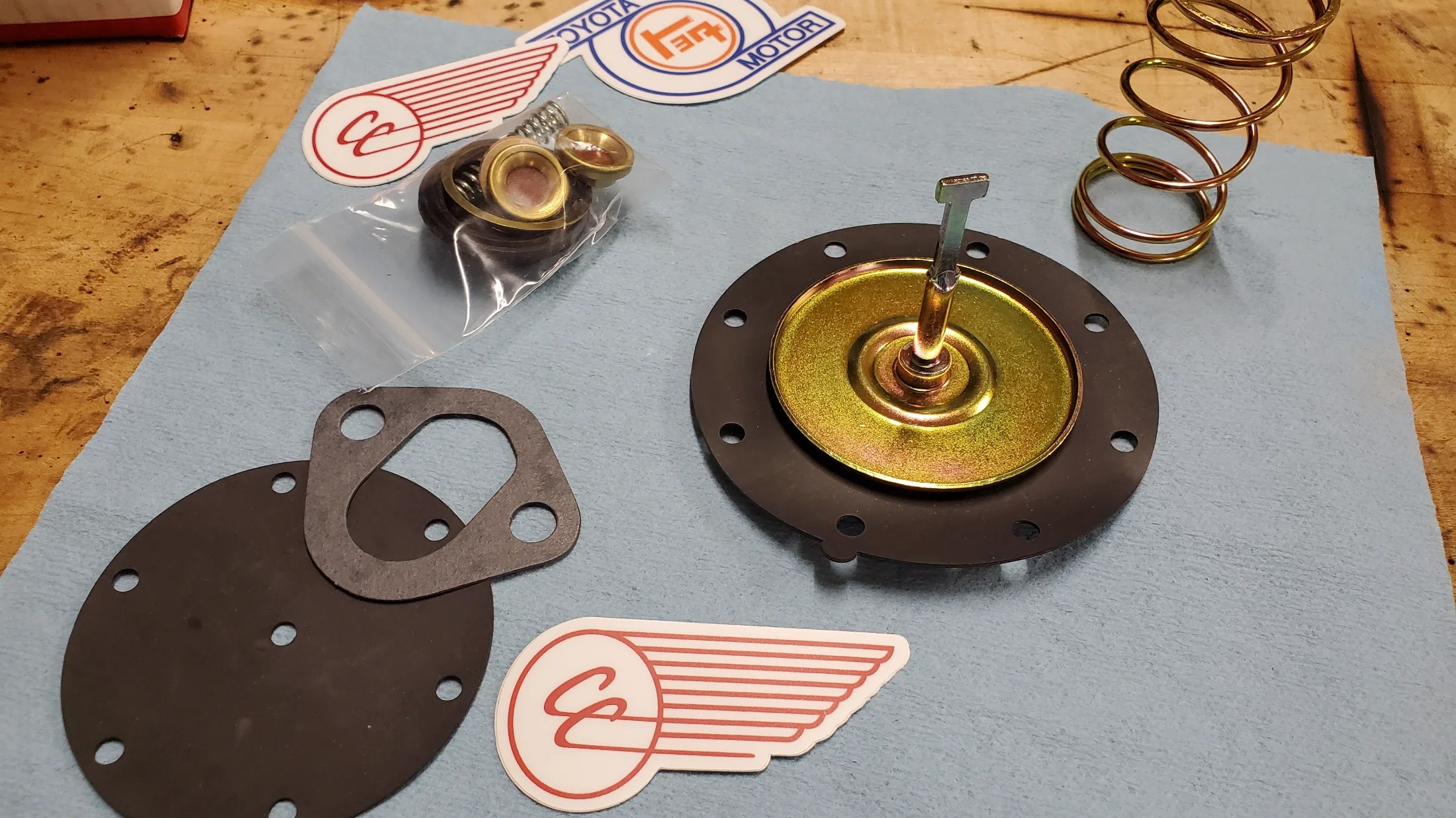

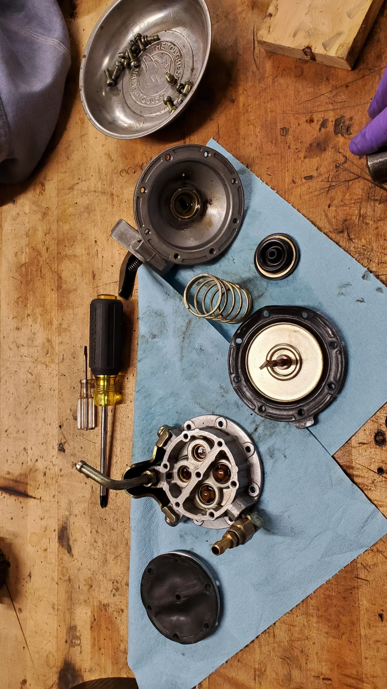

Looks like this on the inside.
You can get this from @Cruiser Cult.
Yes the diaphragm can crack and leak out the weep hole. It can also leak into the crankcase and dilute the oil - sniff test the dip stick.
Thanks for the fast reply. I will definitely check the oil for fuel contamination. I had Jim C desmog the carb over ten years ago and even replaced the fuel pump and the engine ran fine. During this restoration, I had the engine/carb rebuilt and started it for the first time. It has only ran for 5 minutes or so. I am having an issue with the carb idling. The fuel solenoid was bad and replaced but still has an issue with idle. Just wondering if the fuel pump with a bad diaphragm could cause this, although the level in the window looked to be in the middle. Off for vacation, so it will have to wait till I get back.
I just ordered a new OEM one from Toyota but will pick up a rebuild kit for the one that's leaking. I don't think there is 500 miles it although it is over ten years old. Thank you for the link.
