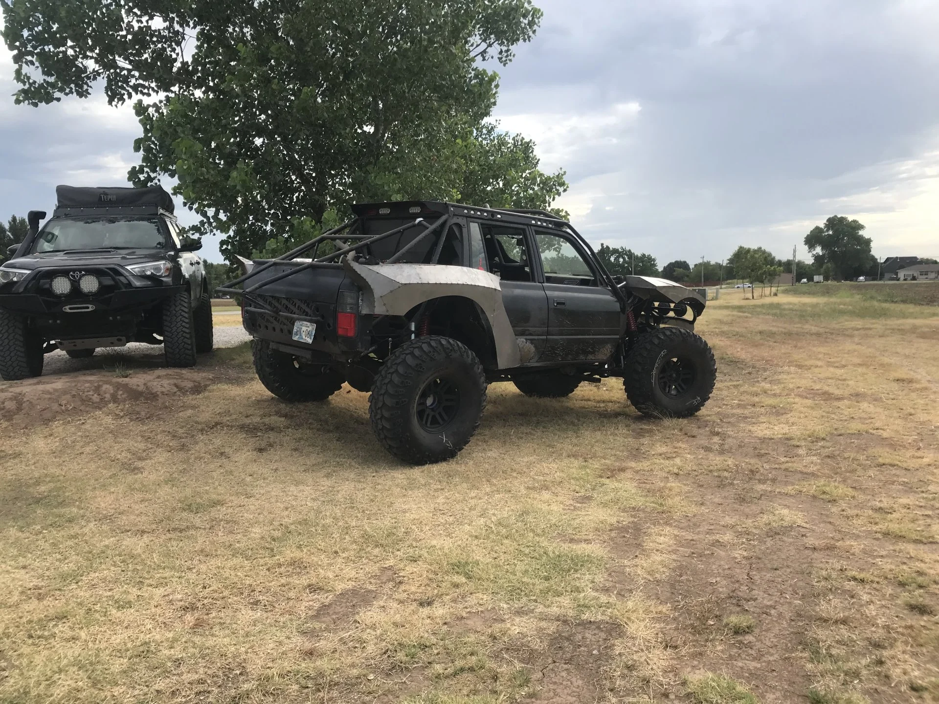

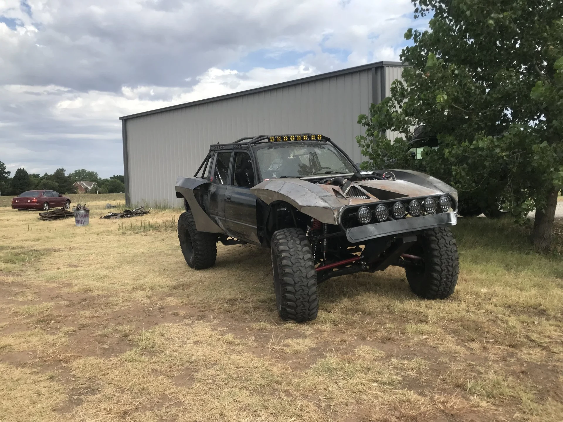

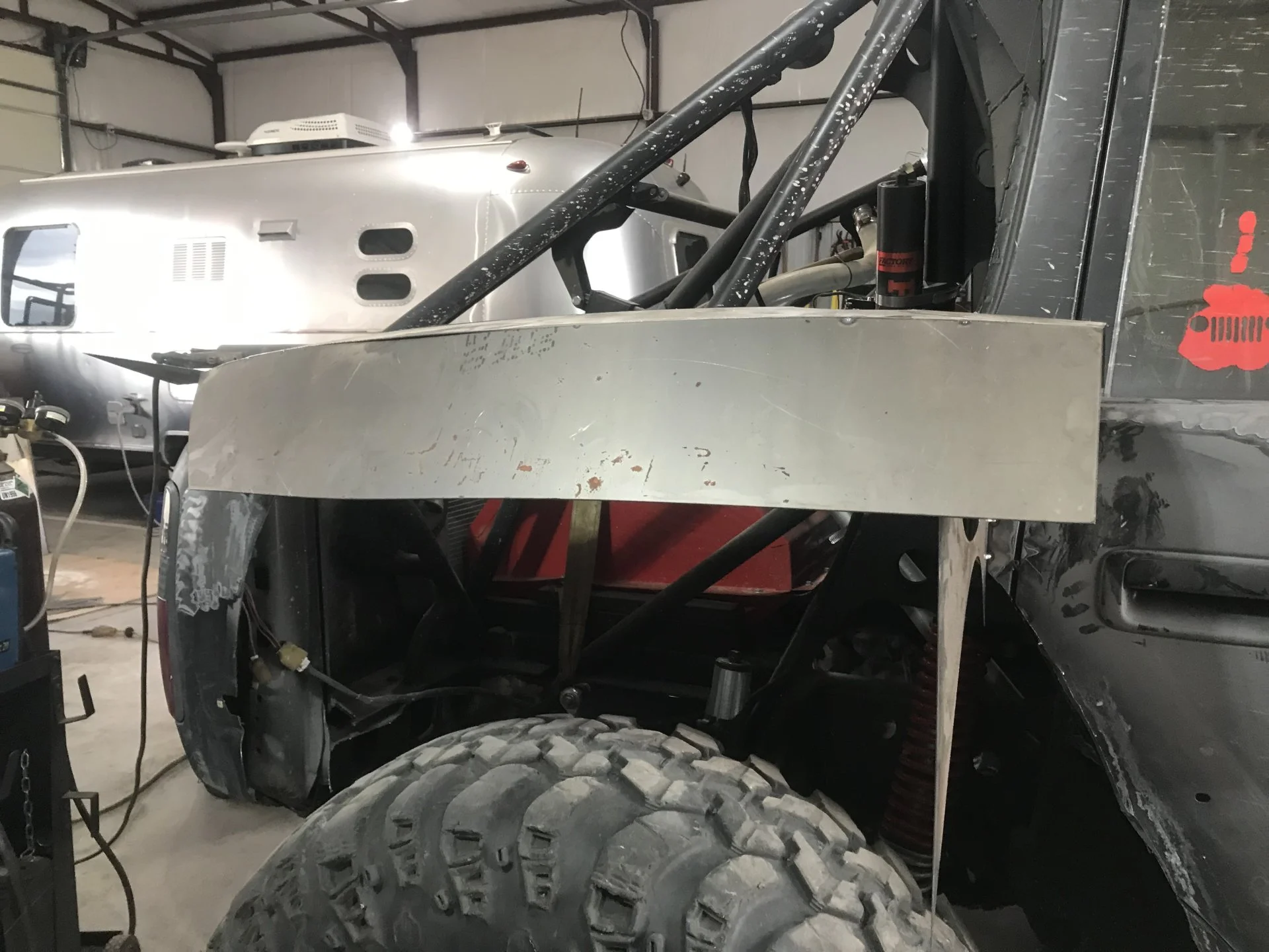

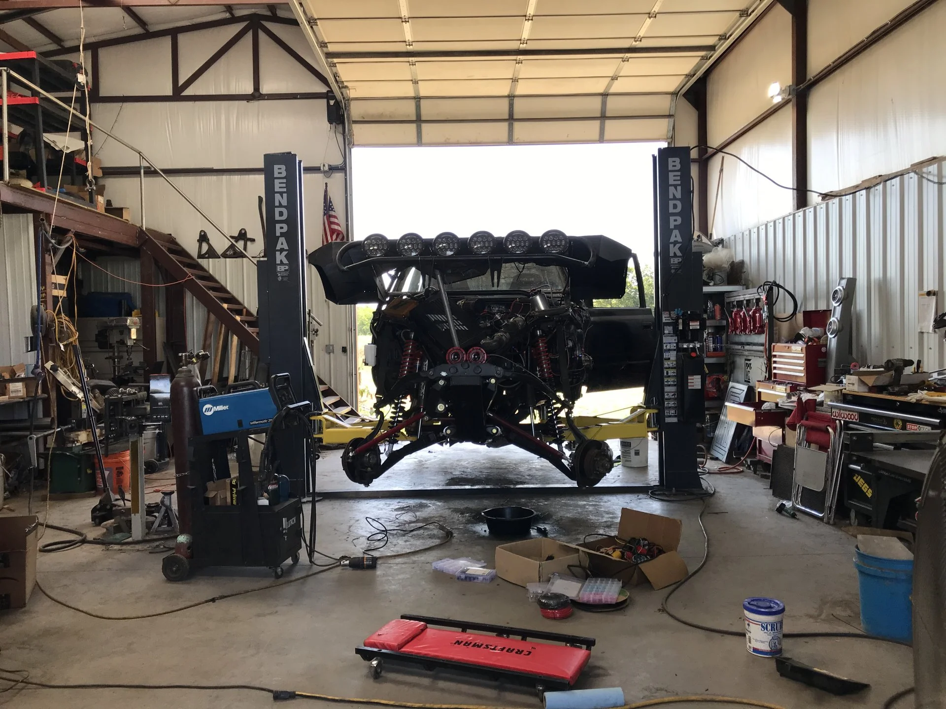

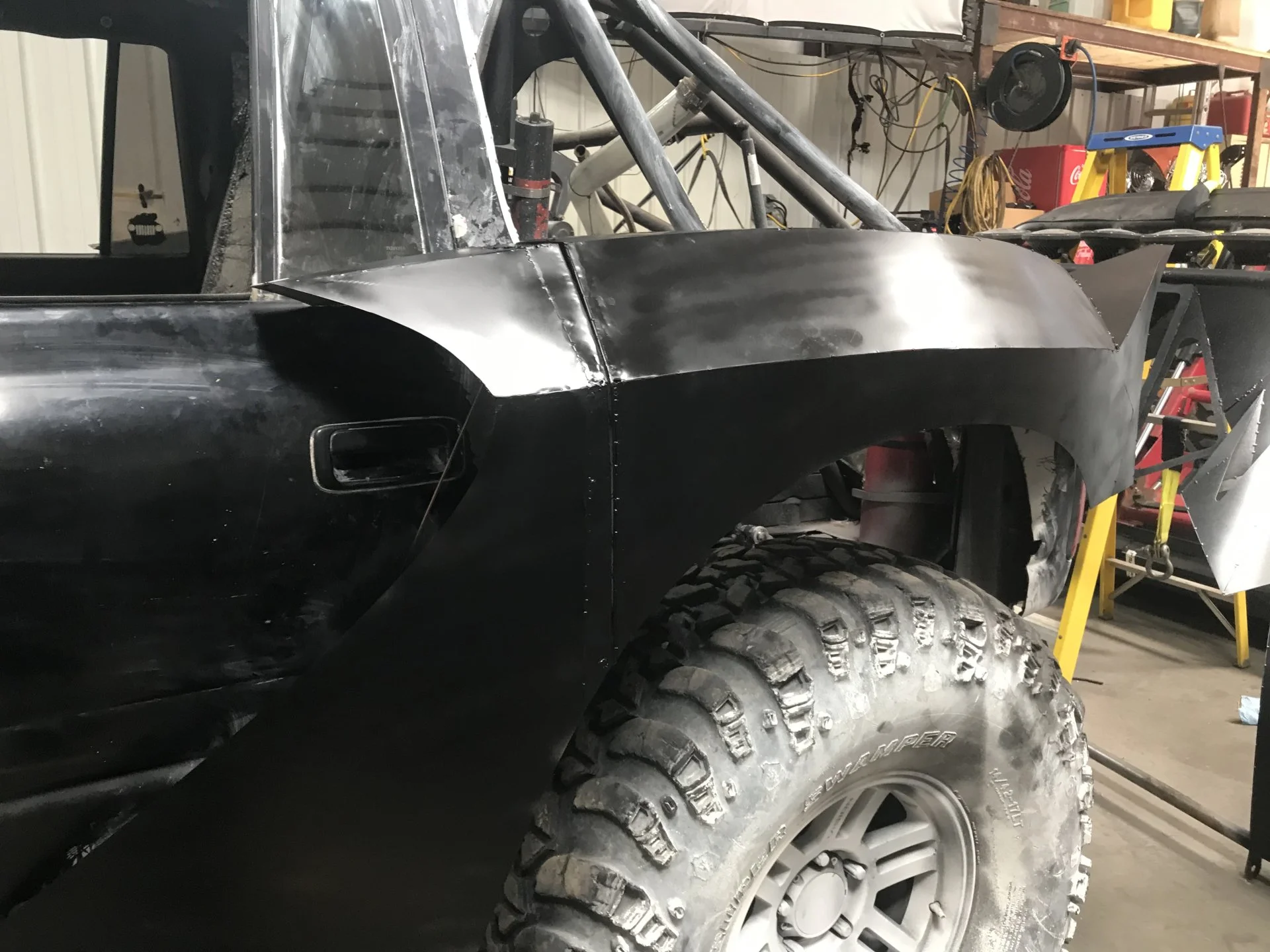

all the fenders are not done buttt they are on there at leastšŸ˜‚
This thing just makes the ground look smallšŸ˜‚
Needs gullwing doors!
it's like if toyota built a halo warthog

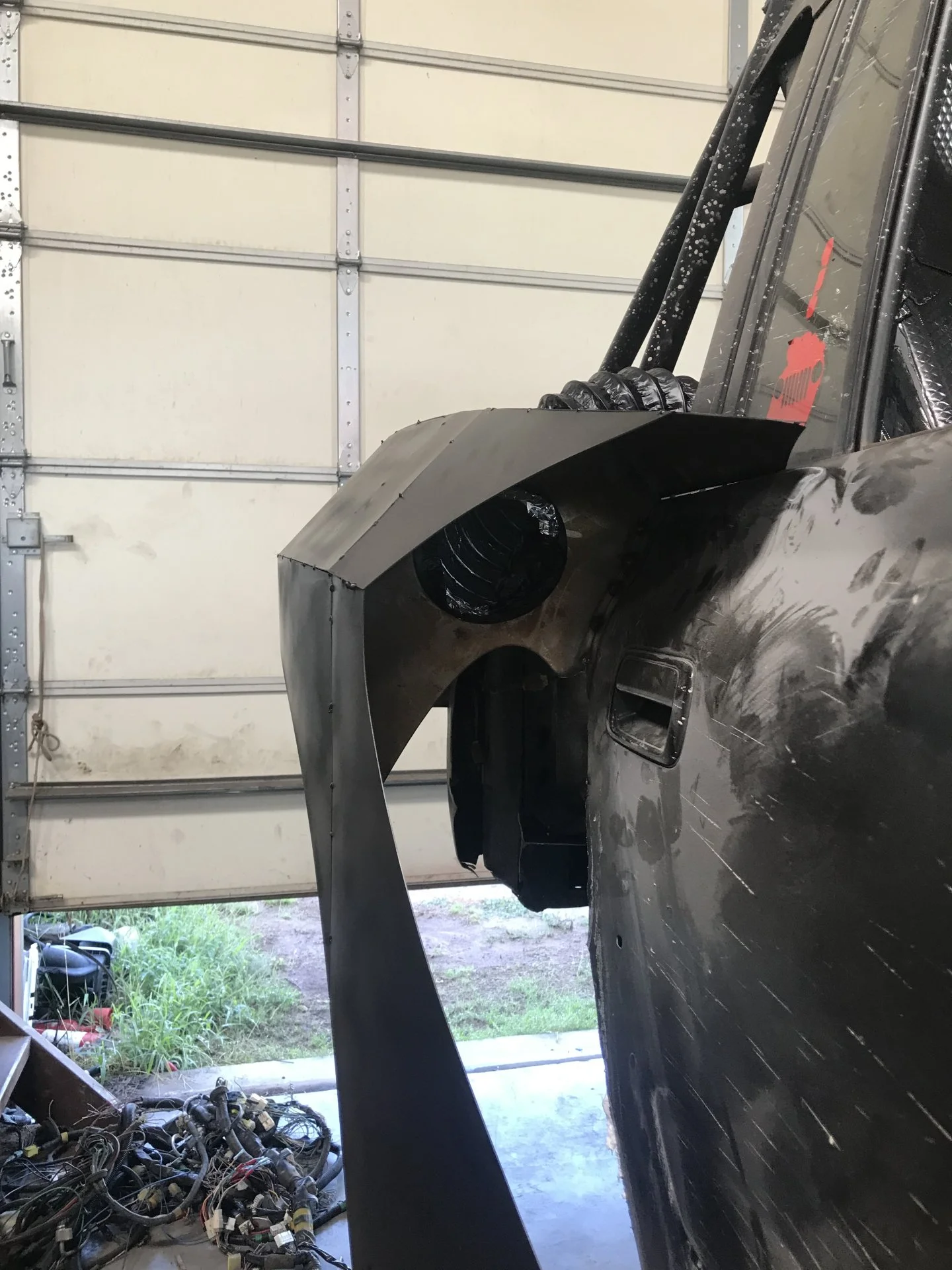

I think I’m only going to do this sidešŸ˜‚

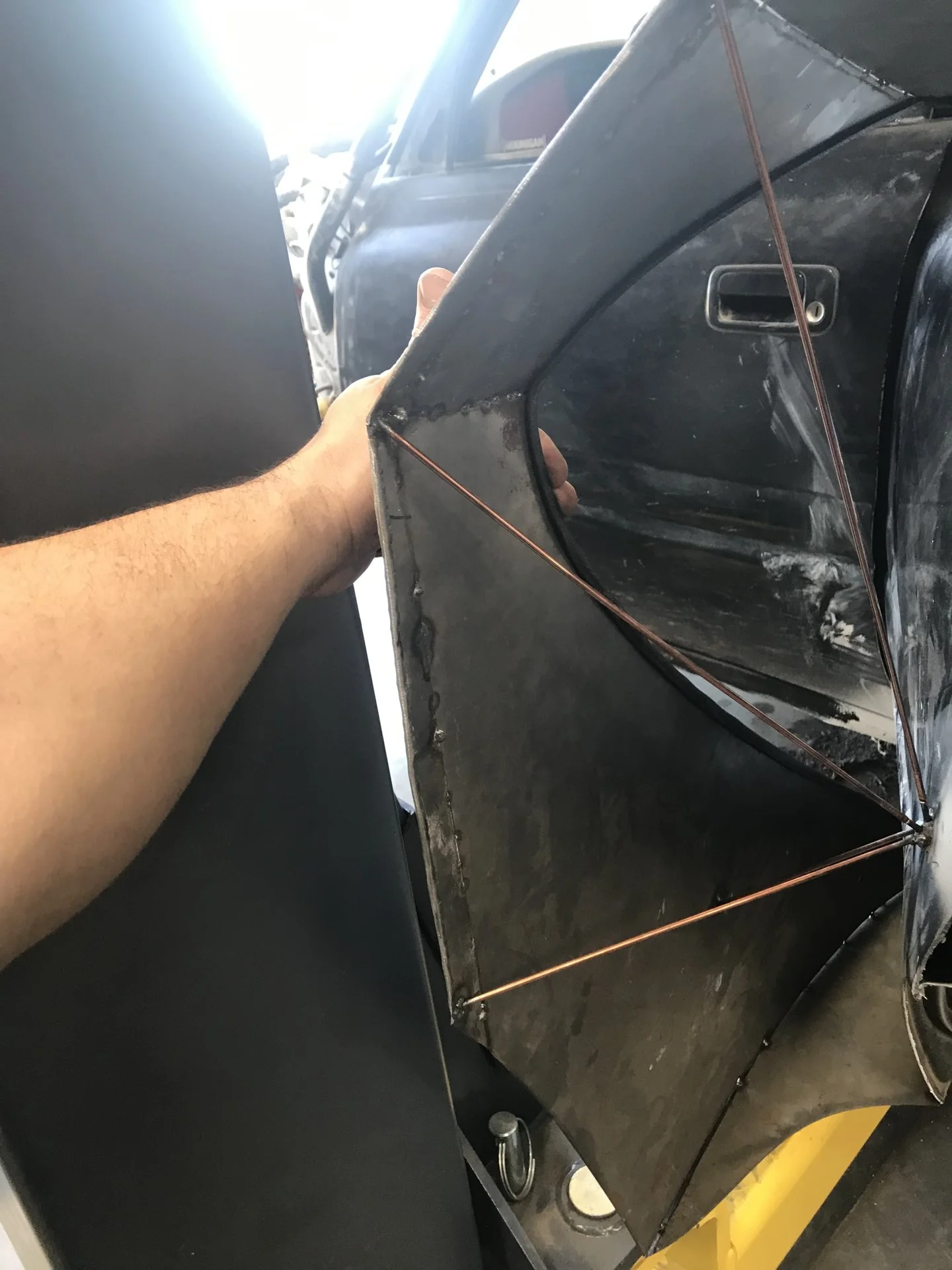

Creased seams door side and tacked on some tig rod for the other it survived the slams test no idea if it’ll hold up at 120 mph or even 70 or a small tree but that’s the fun part.

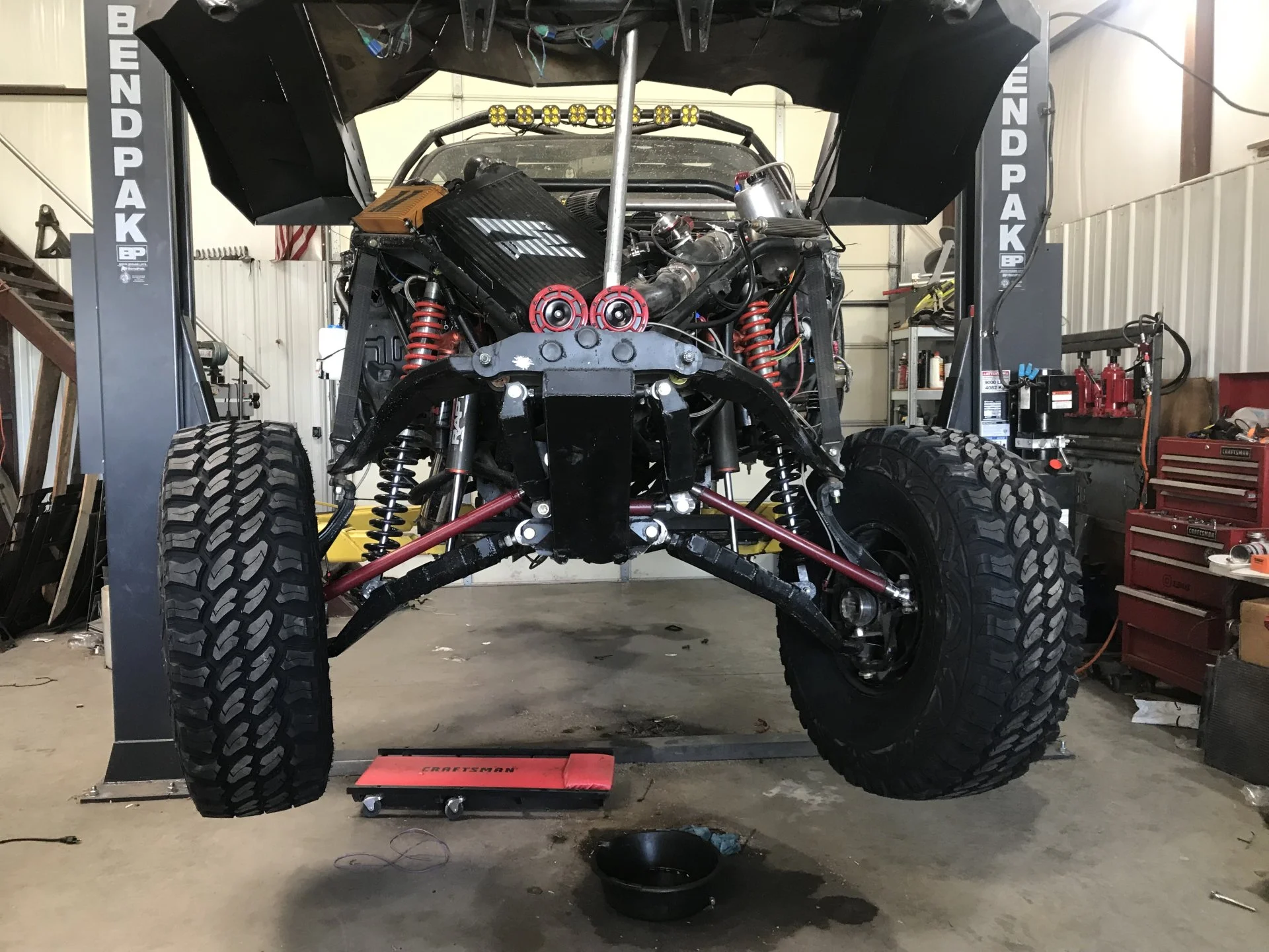

Dropped the front diff off at a shop to get it re geared and then need to final mount the front diff and get axles ordered then in theory and only that it’s time to start breaking s***šŸ˜‚

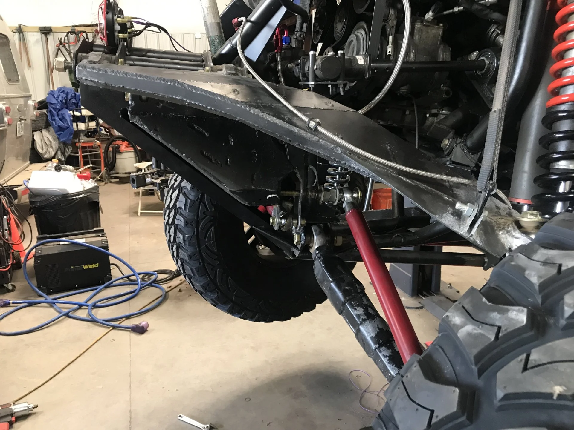

Starting on the steering arms v2
Current issues
Play in the steering
-this is due to the steering actual box since I shortened the arm I’ve noticed that I can turn the wheel quite a bit before anything budges
And if I turn the wheels with the steering wheel locked they both point at the actual box
Lots of boring little issues like angular forces on the steering box
Trying to get a more linear feel on the wheel but also less rotations

Front is getting hydro bumps
Front diff is at a shop getting re geared

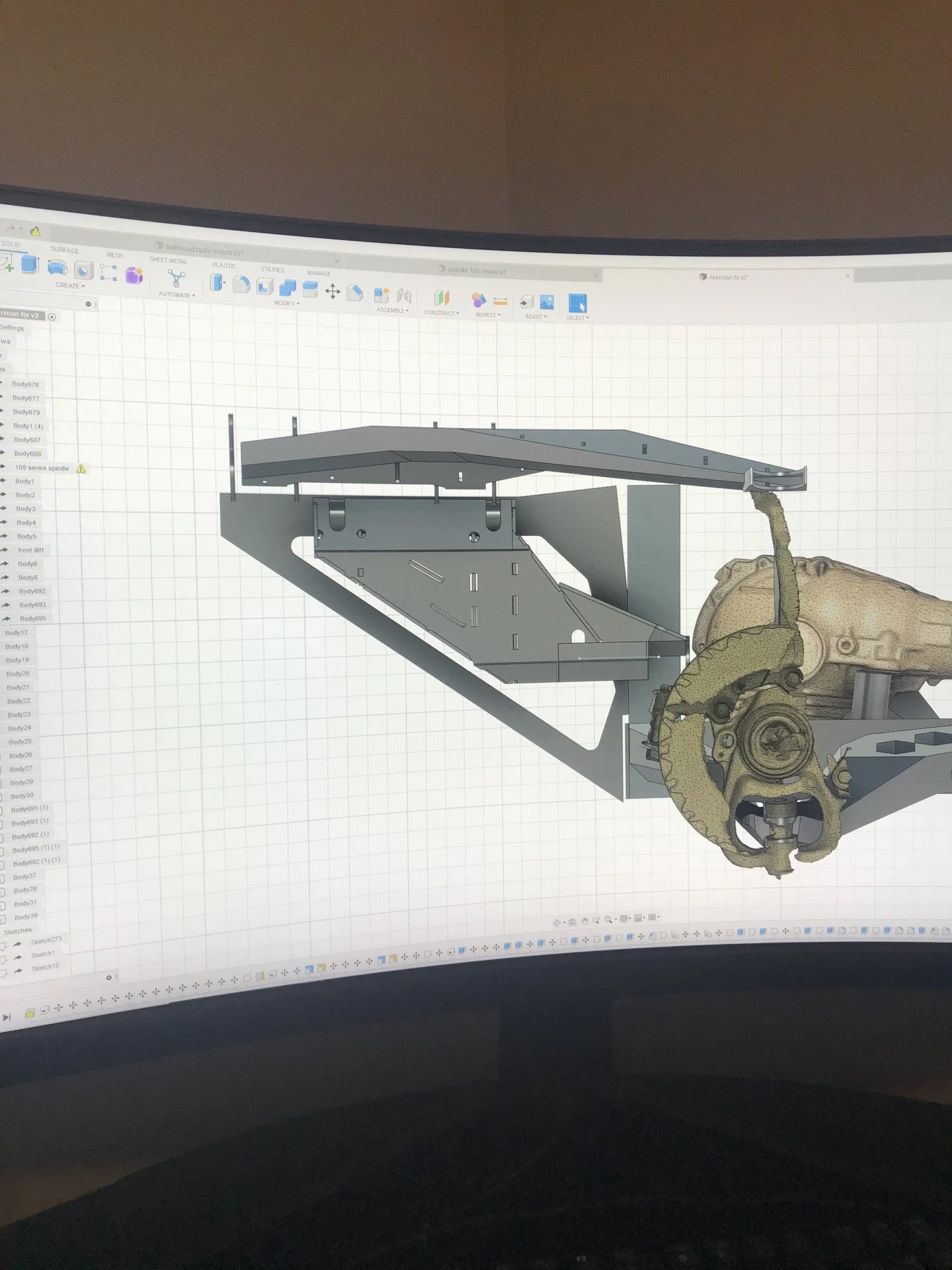

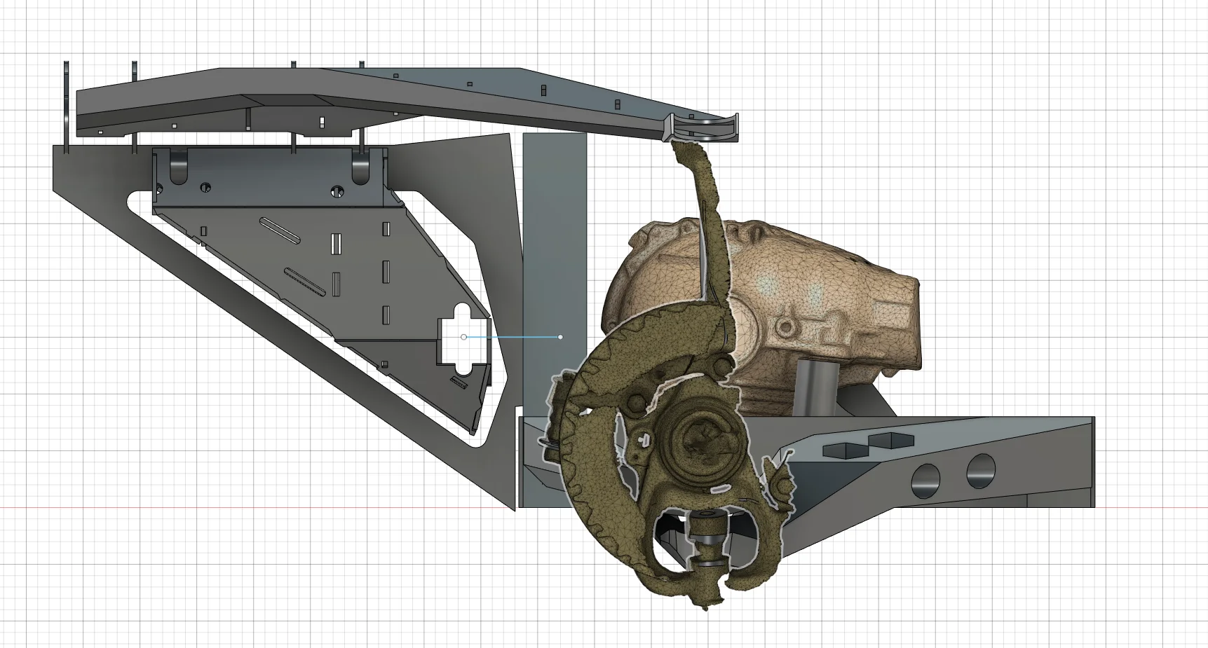

Basically I screwed up again... have a lot of reverse akerman at extreme steering angles... but i know how to fix it. Any steering rack that is mounted forward of the centerline of the steering tie rod mount on the spindle side produces negative Akerman. I thought i could get away with doing some weird stuff with the swing arms but no luck. So my options are to move the frame side mount back or the spindle side mount forward or a combo of both. Crazy how much has changed as far as how i go about building things. I remember trying to model the 2j in cad based off of pictures. Still chuggin along getting the truck ready for little Sahara

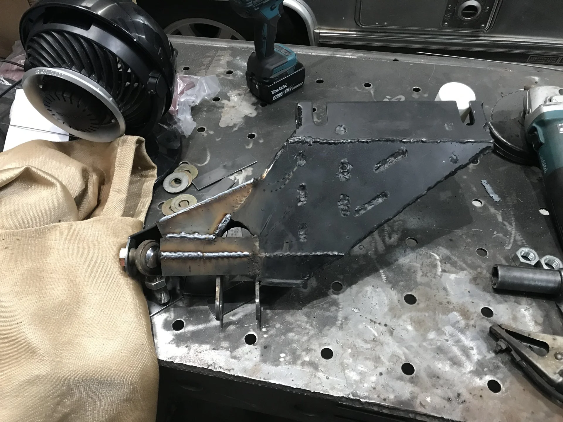

Just an observation, from seeing KOH competitors failures of front IFS parts IMO the upper and lower A arms attachments points on frame have to thin metal, the bottoms have a good brace but still thin metal tangs where bolt goes thru, the top needs some plates across top, box it up and still the thin part that reaches out to bolt is suspect, maybe another plate across front to double that part. FWIW the cast nuckle(especially the tower) have failed on impact for some people. I see the gussets, they look good just a point to keep an eye on for stress/fatique failures.
I agree on the uppers just have been to lazy lol
I believe pretty much all spindles from Toyota are forged which makes adding to them easy and also increases their strength
As for the upper J arm mounting points-I’d like to put a winch around there and was thinking I’d mount the winch plate to those!
The original plan was to put a tube in between the mounting point and one long bolt but because of the winch idea I have put it on hold
Yeah ideally for ever bolt mounting point you want to lathe a bolt insert thing to get a symmetrical cylindrical mounting surface so the load is distributed evenly and won’t woller out.
The bottom is stacked 3/8ā€ but obviously I’d be happy with over half an inch.
