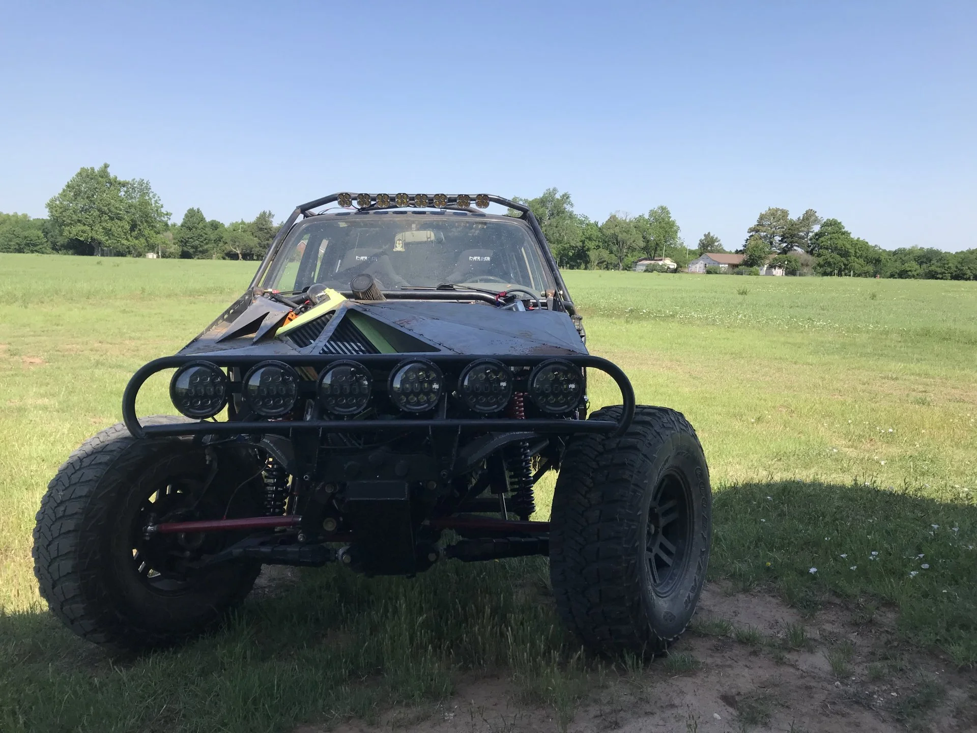

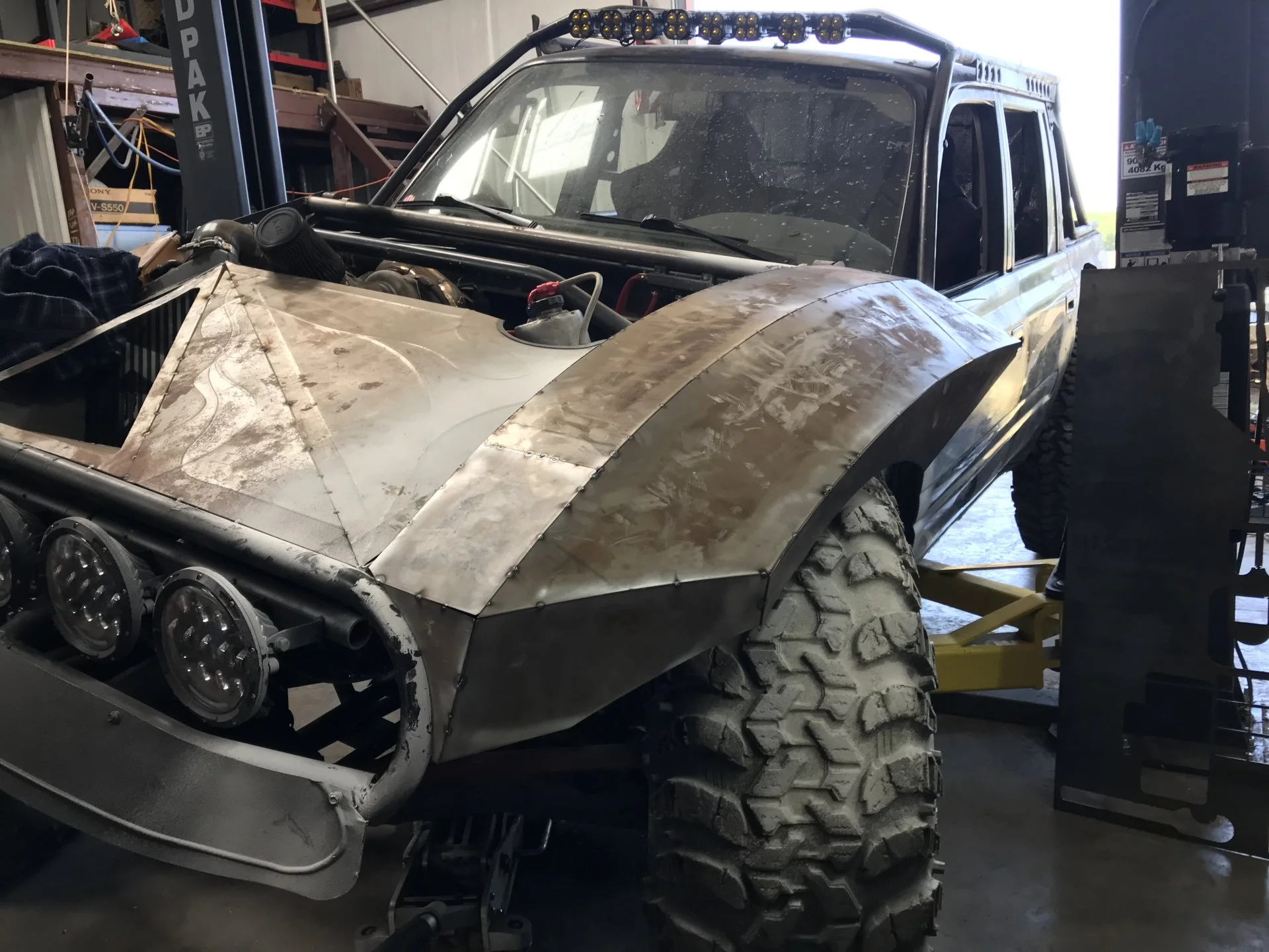

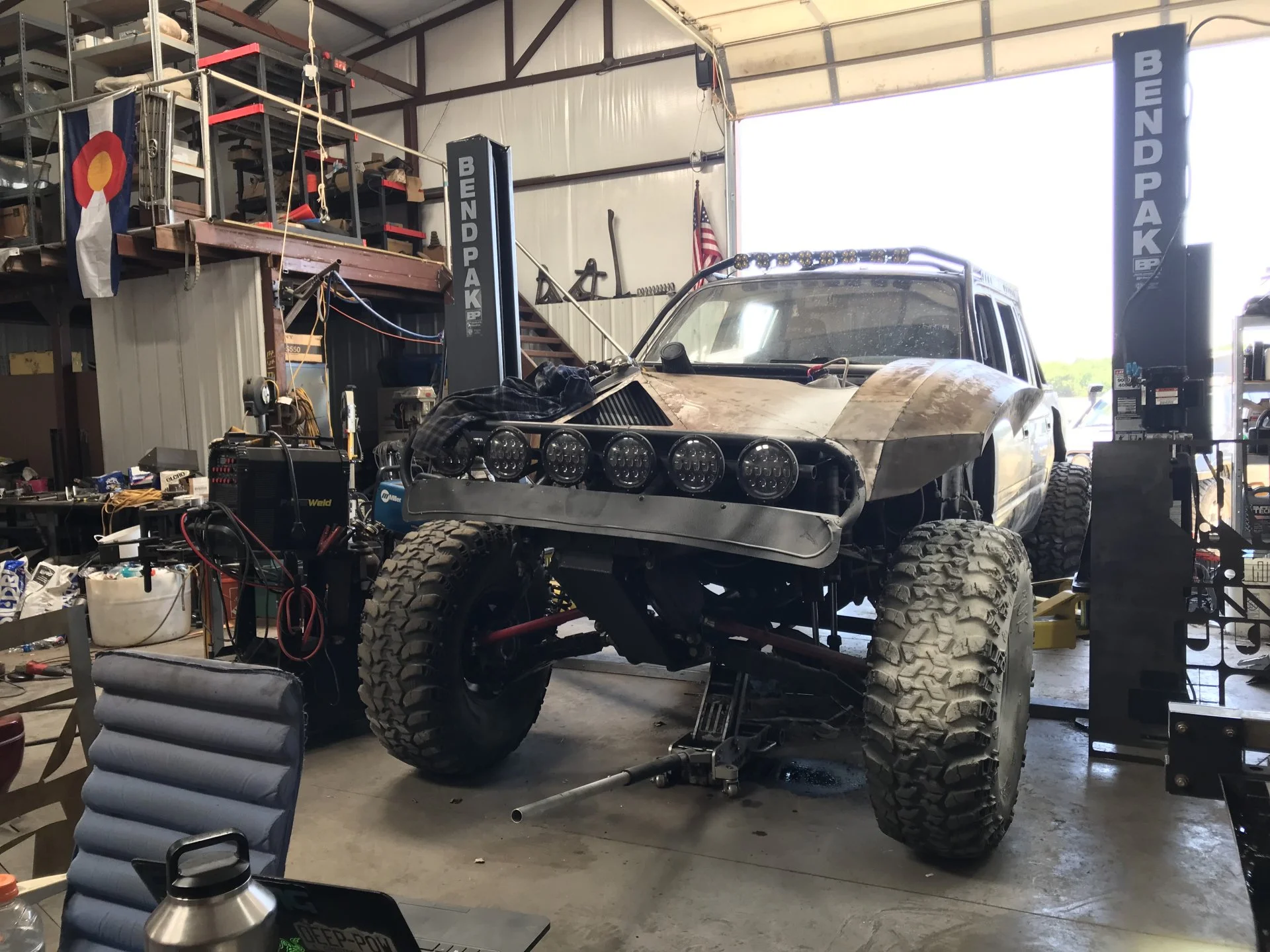

Lots of things to do started on the hood today so the cops look at it slightly less😅

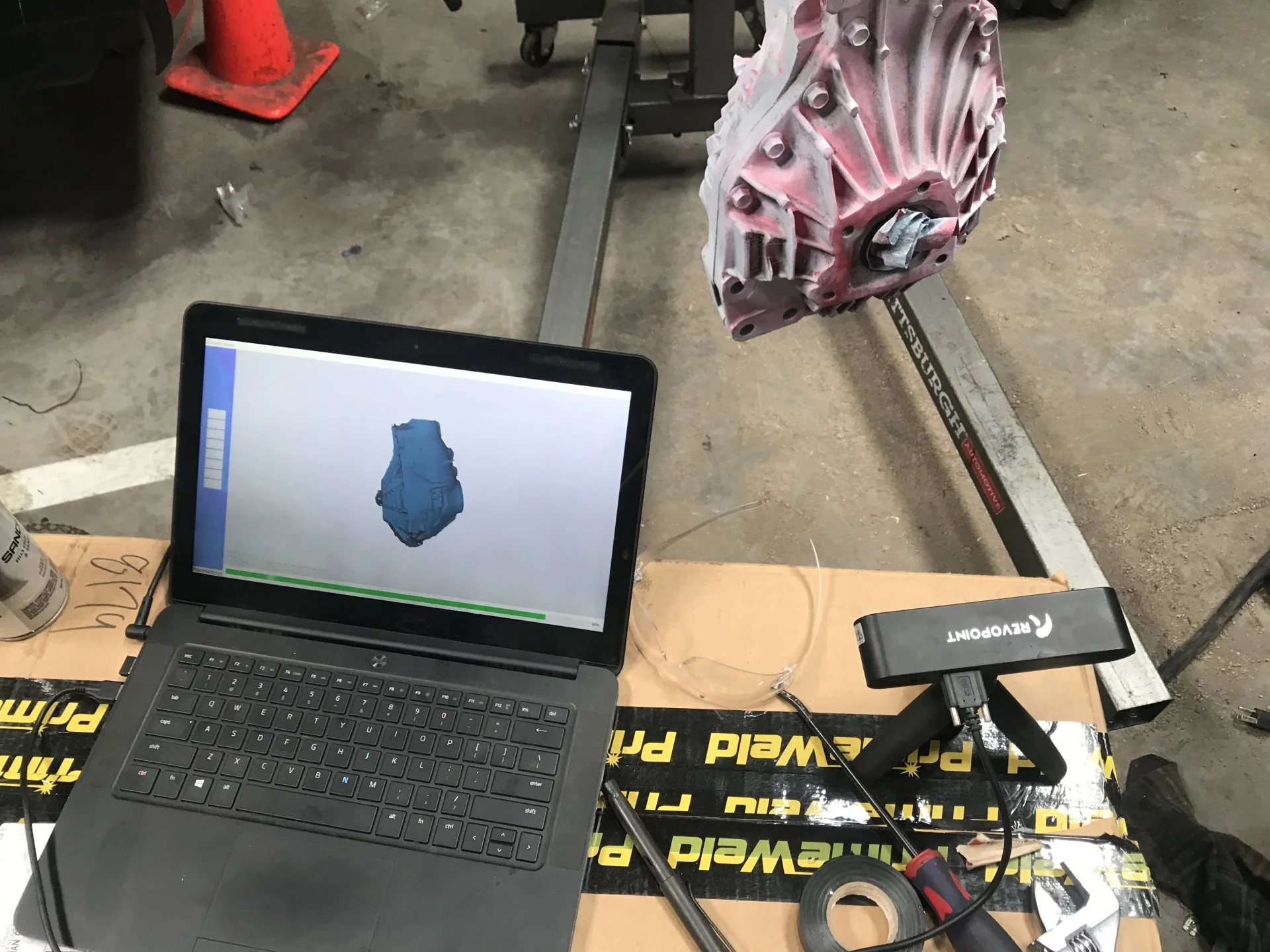

Front diff is getting scanned so I can make a serious mount for it without position it by myself
Basically a 9.5” third member weight wise
Needed to go down a bit and maybe make it easier to get in and out, no rush since I’m saving up for RCV axles a locker and gears… probably 40s as well

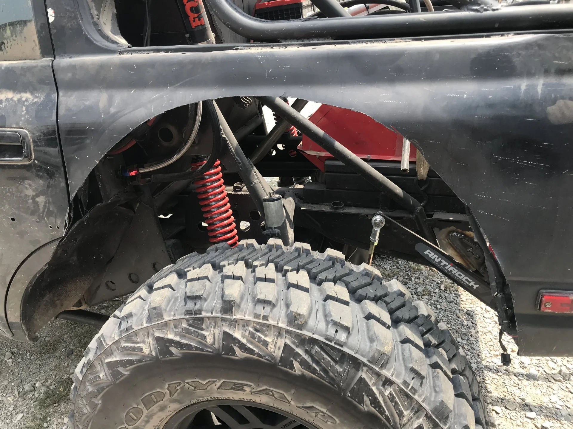

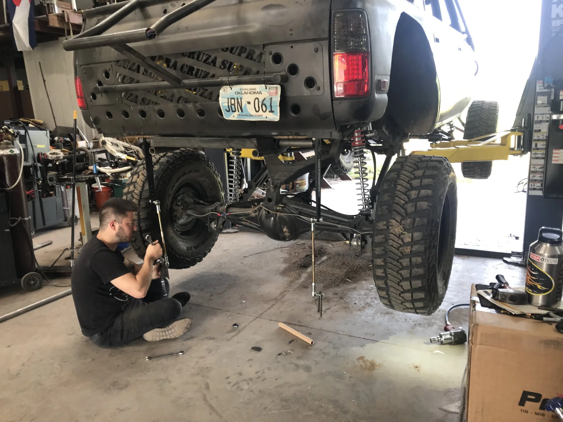

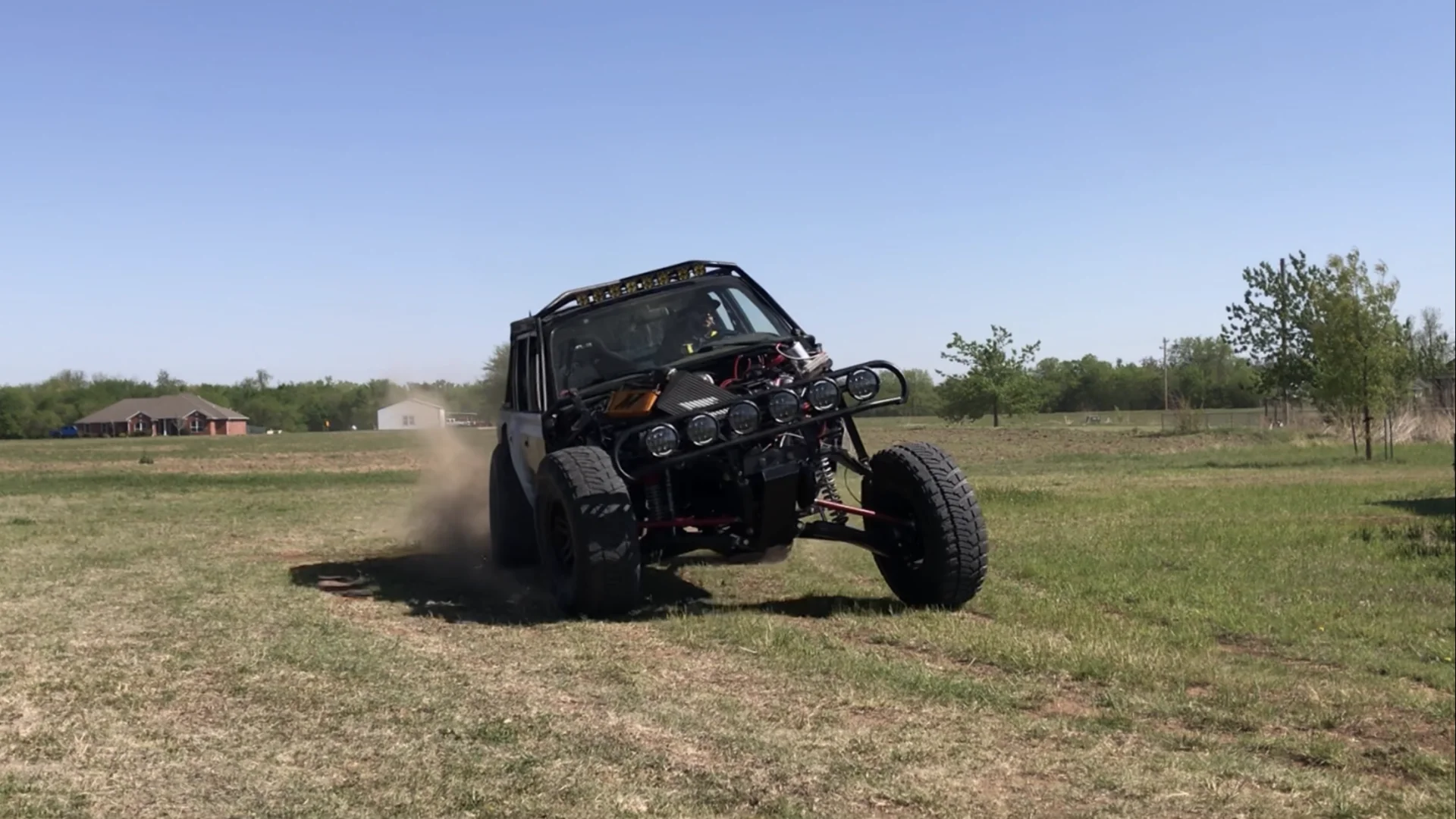

Also have really been testing the suspension
Definitely needs a sway bar, handles like a big boat no question. Steering Ackerman angle is meh for the street works great when it’s sliding and off road so might make it adjustable
As far as accelerating on the street it’s a little too much squat. Not sure what it is but definitely not anti squat. Which is what it is supposed to be buttt It’s almost un drivable as it picks up a front tire if you get on the gas hard enough…which is sick butttt yeahhh😂
Needs to be adjustable if I want to drive it on the street.
Steering needs to have bungs for all the bolts so that it feels tight and doesn’t wear and get loose. Which it is now😅
Dual calipers brackets are designed going to cut them out of the thicker material
Wish I did the whole front end like this

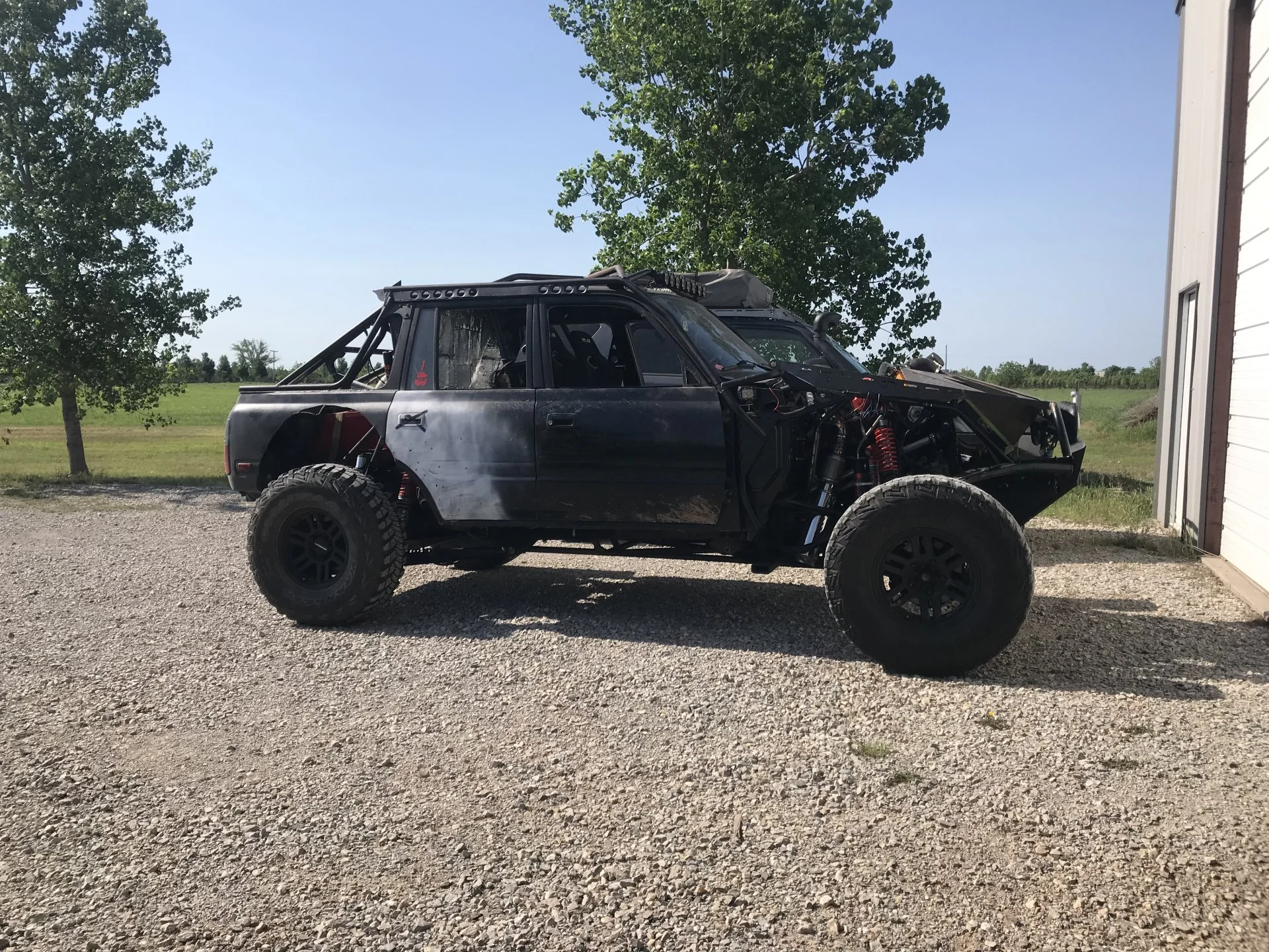

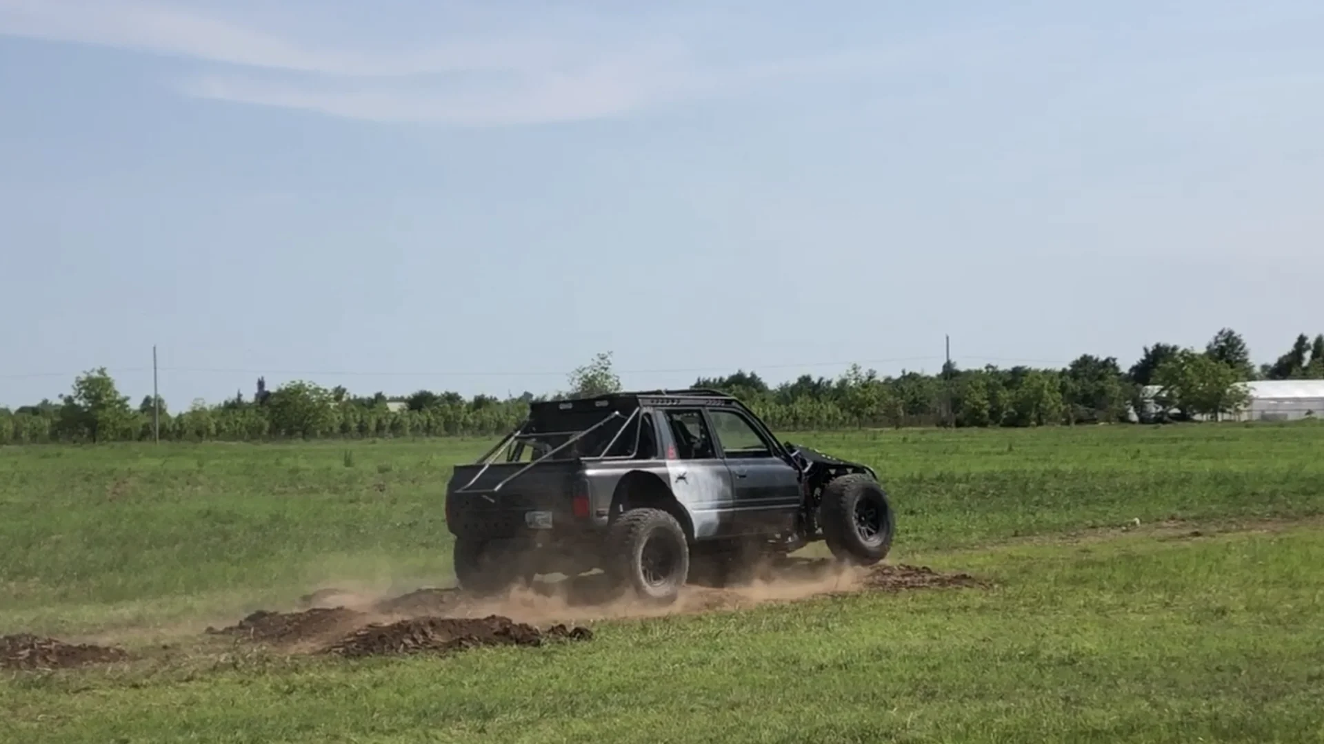

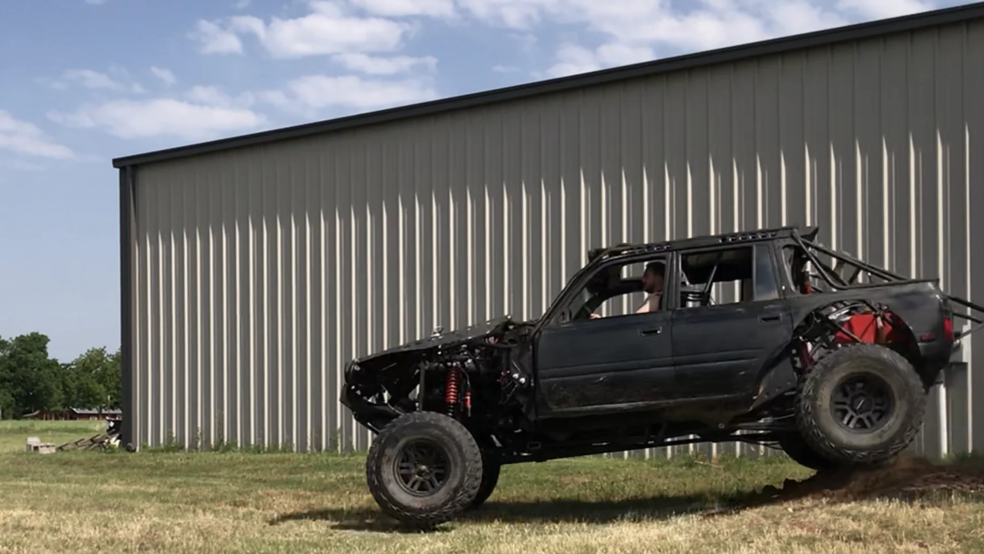

Moved the coilovers out for a trophy truck mode
More lift less preload less lean
Preload = leaning

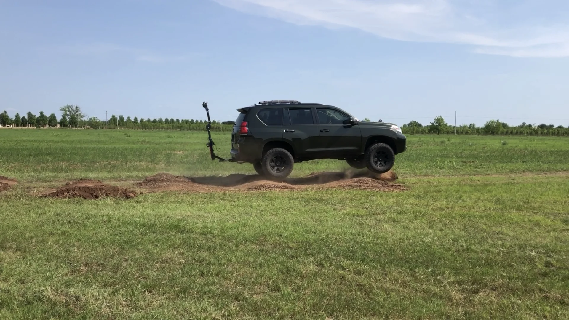

Huston we got some liftoff
Felt like butter
Finally ...sweet jumps!
Well after a lot of effort and exhausting every resource I have it now flys on the highway wayyy better😂 plus it can do sick jumps

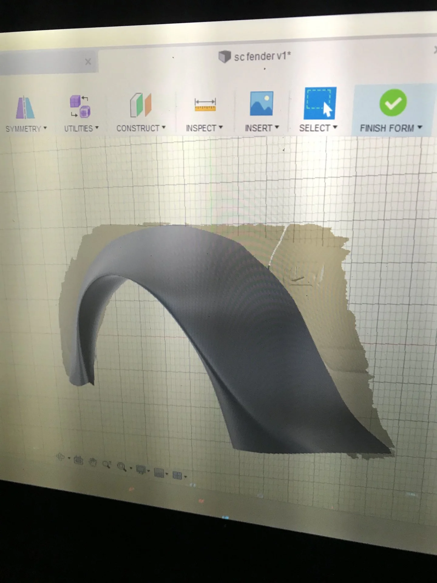

So naturally I’m picking up some 42 iroks this weekend which will make doing fenders easier

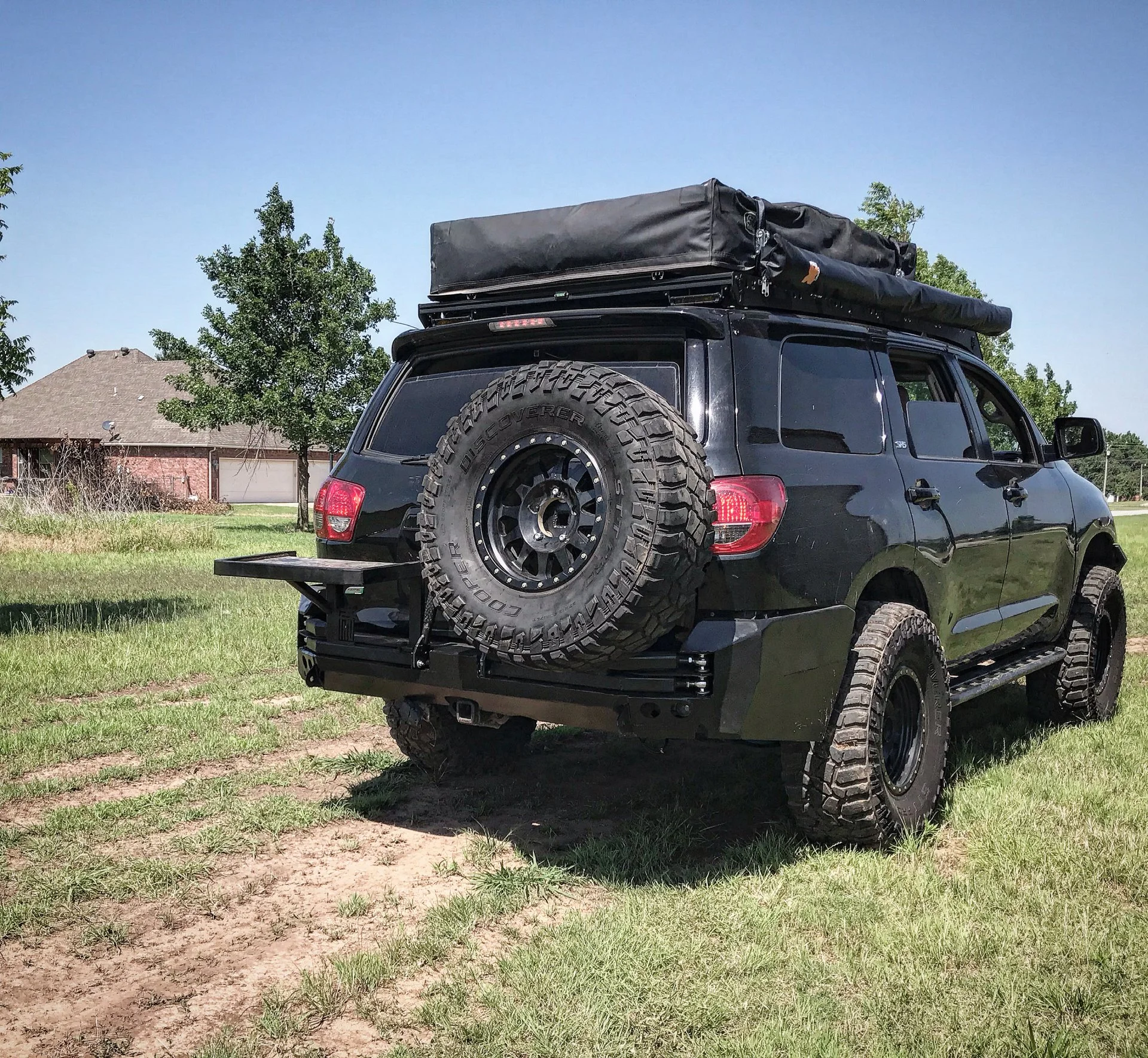

Have been busy on a sequoia rear bumper
Should have some time to do a regear and throw these on
Clean looking rear bumper for that thing.

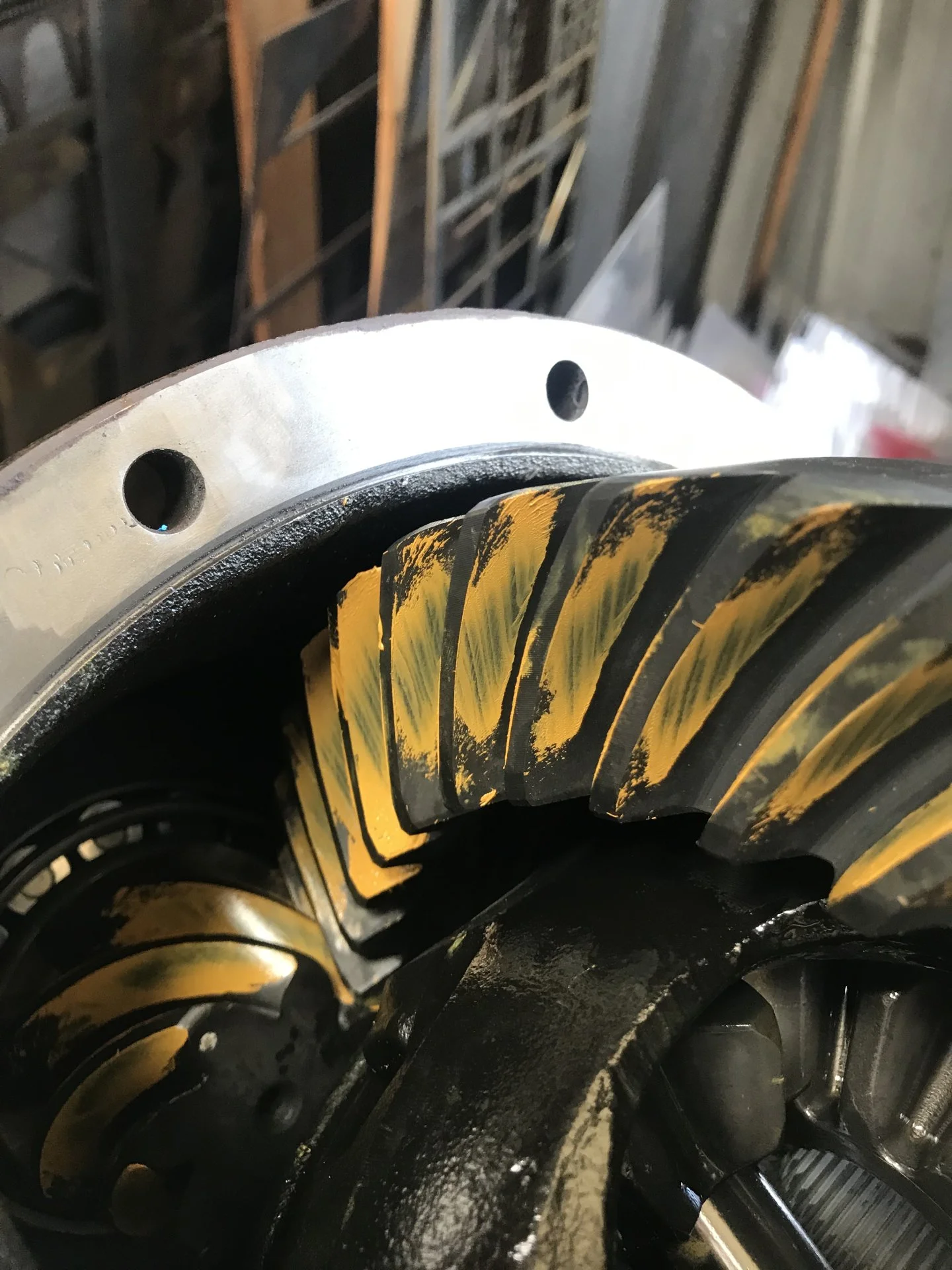

Gears are done very small whine when de accelerating
Gear pattern below
Backlash is around .005 +- .001
.006 I believe is factory spec
Drag guys run the smallest amount to minimize breaking stuff so that seemed like a decent idea if I wanna launch it up some walls of rock and dirt

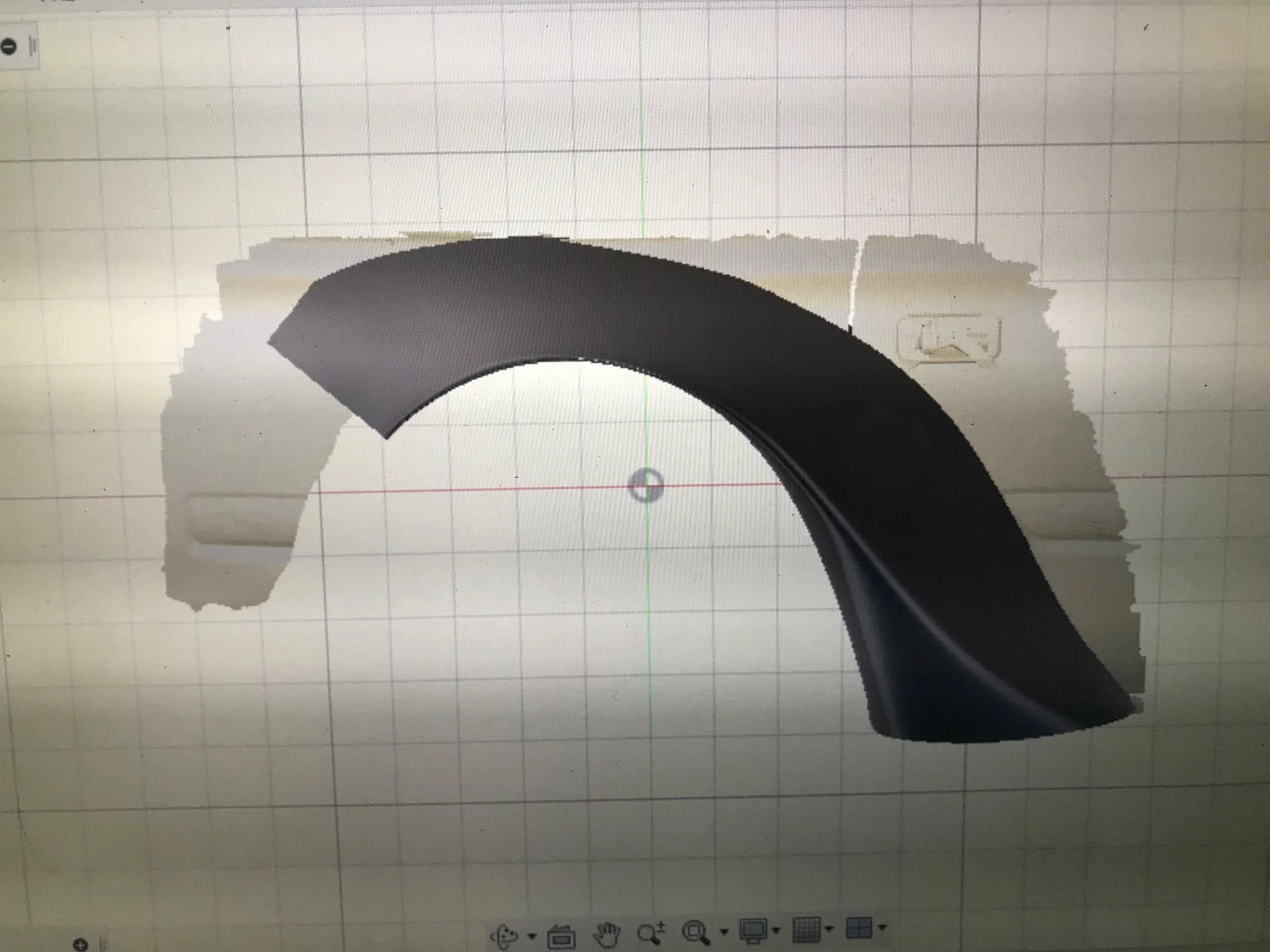

Need to start on fenders and 4wd
