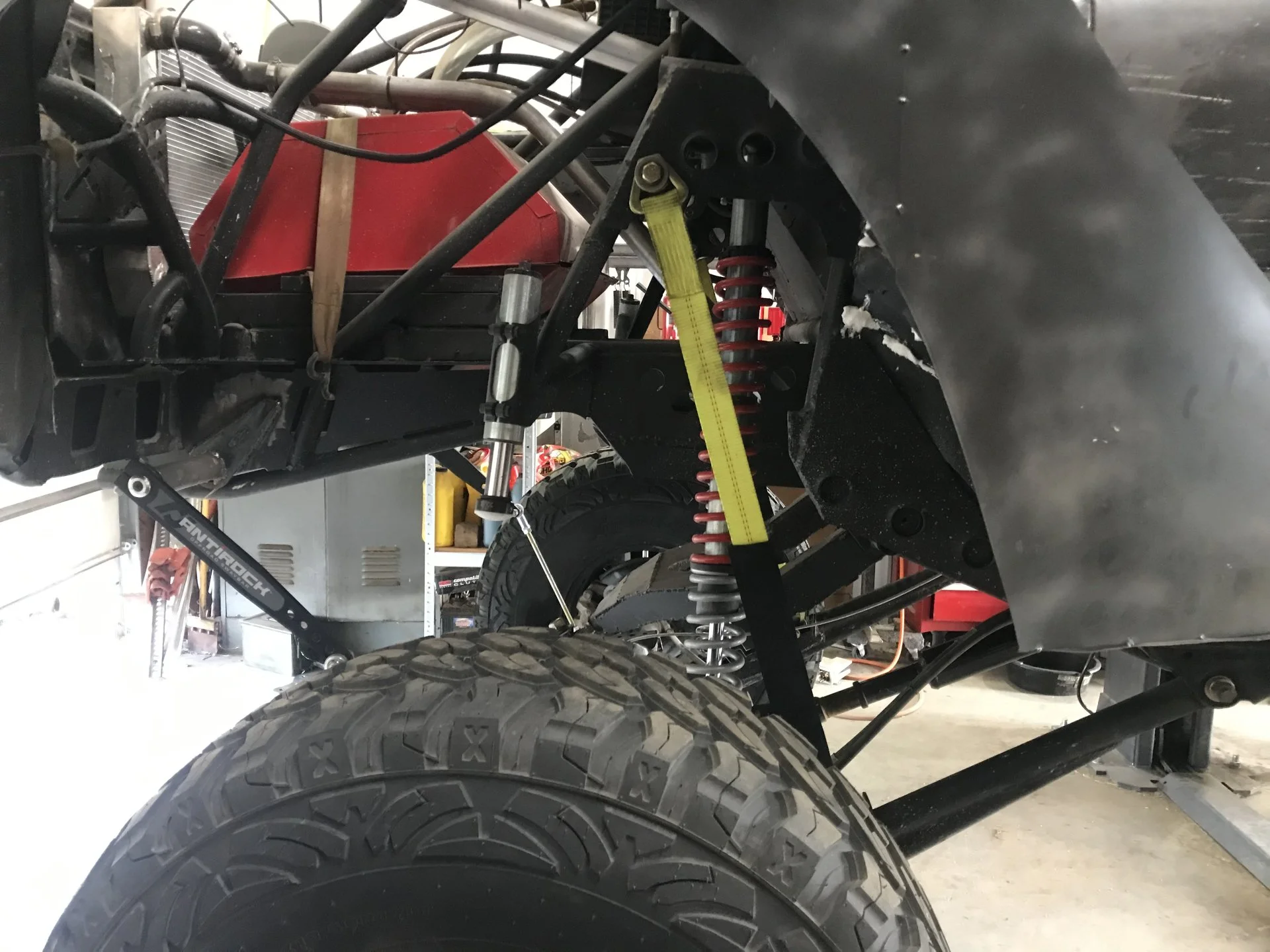

Gots some limit straps final for the rear
Blew the top seal on a front coilovers sending it on the whoop section at god knows what speed
Top of first🤷‍♂️😂
Time for more bump stops!

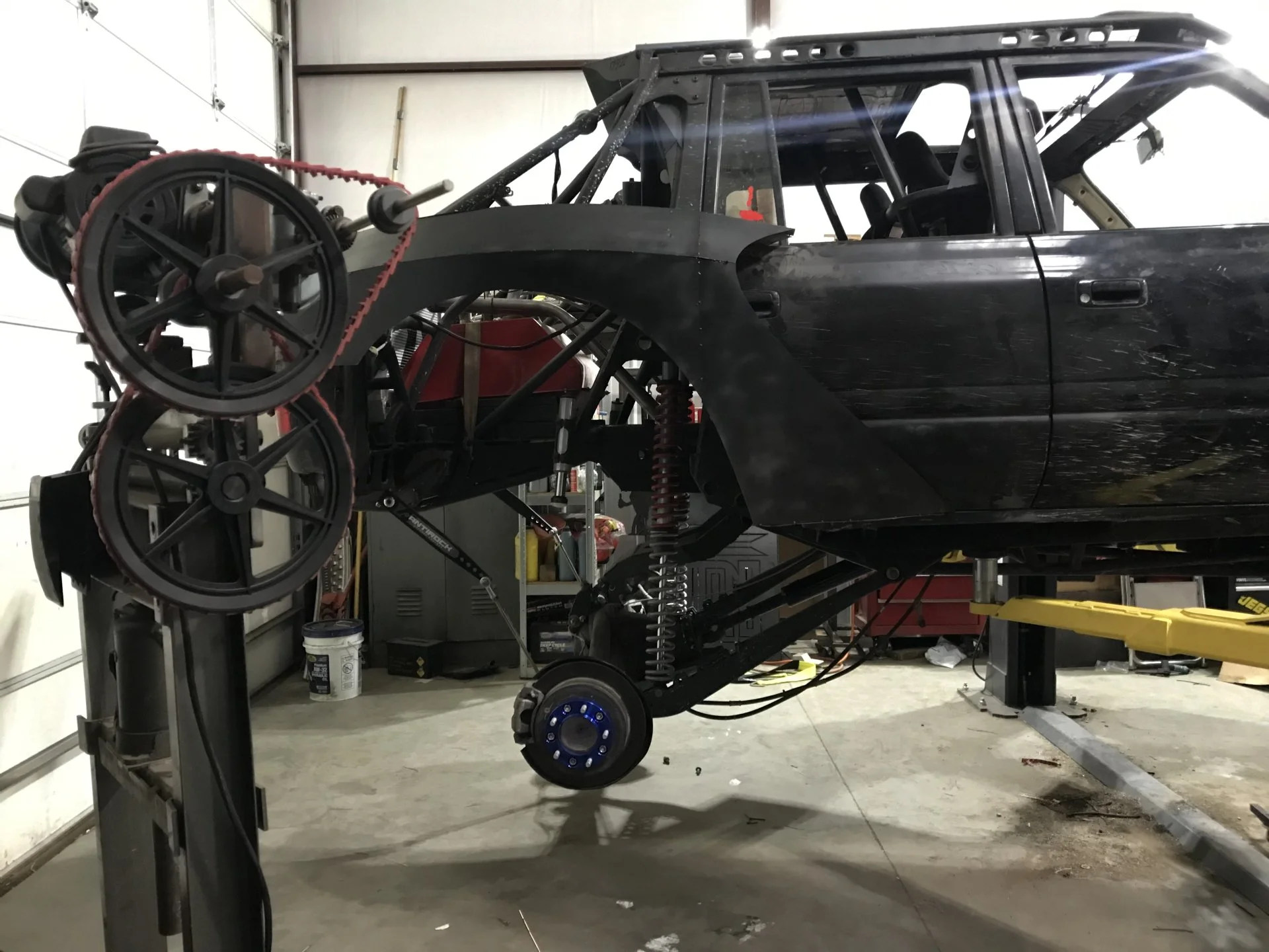

What's going on with all the pulleys on your press?
Bead roller on top actually works decently well still pretty hard by yourself even with a pedal and all that with bigger sheets

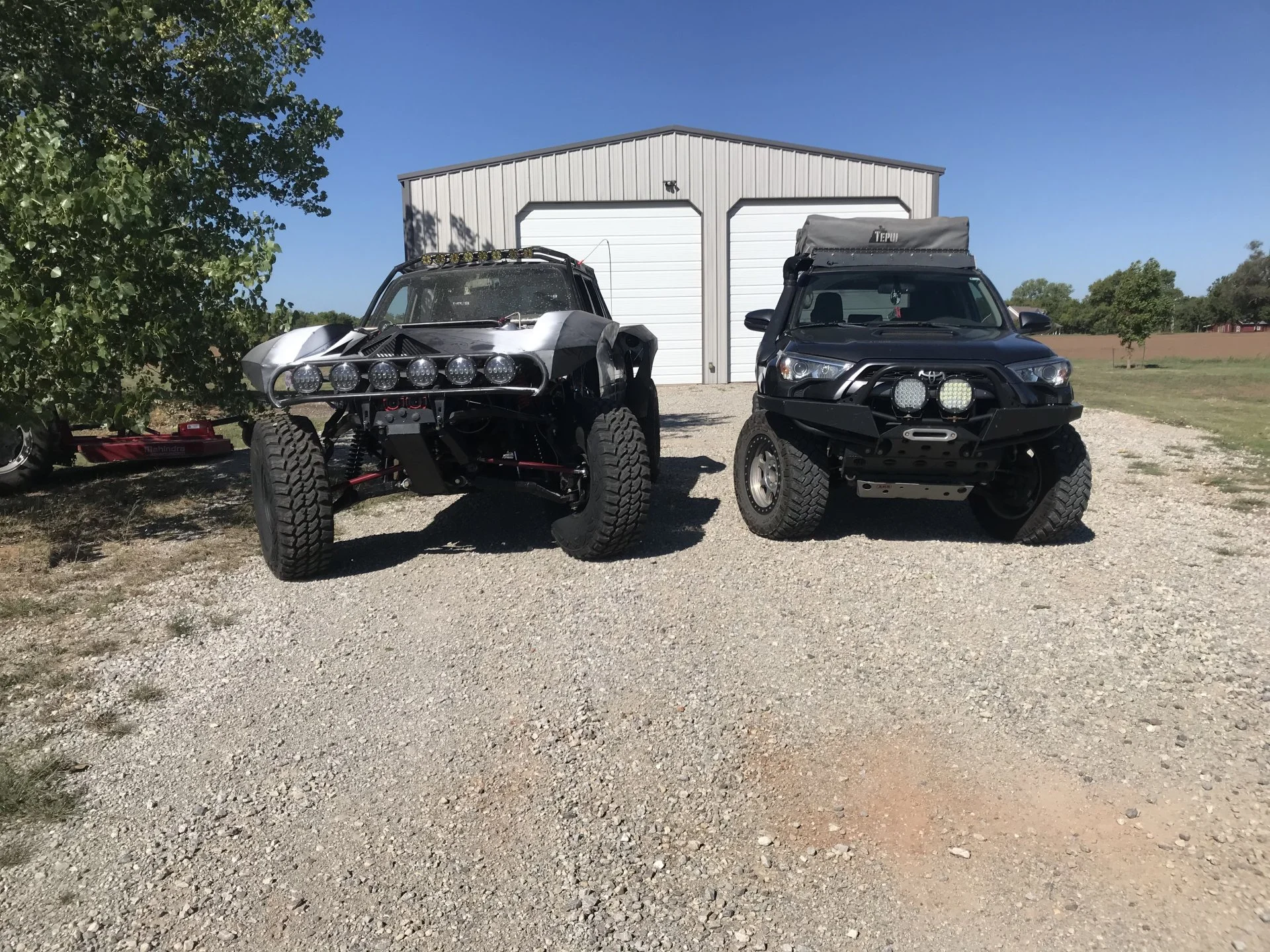

here's your closest competition

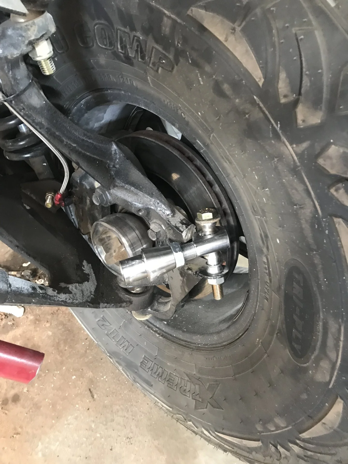

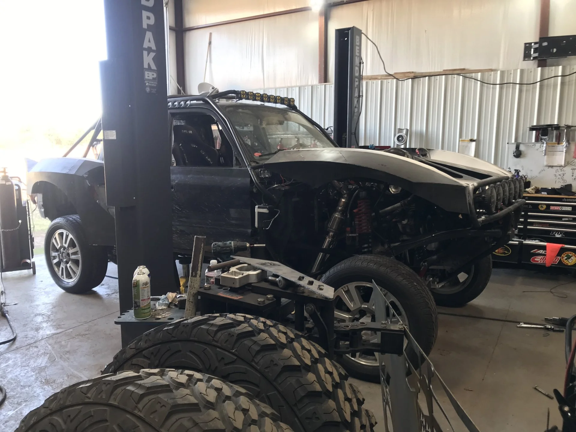

Got some bigger offset steering hiem joints decided to go ahead and make the bump steer adjustable
The 3d scanner showed I was off about a half inch low on the spindle side so I’m redoing this real quick

Thing is going to look dumb on 31s with a roof top tent😂

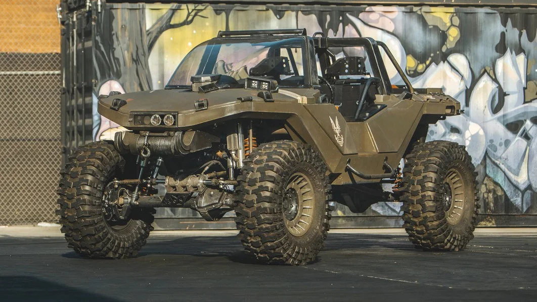

Exactly! The new wheels and tires indicate this being a street racer also right!? :)

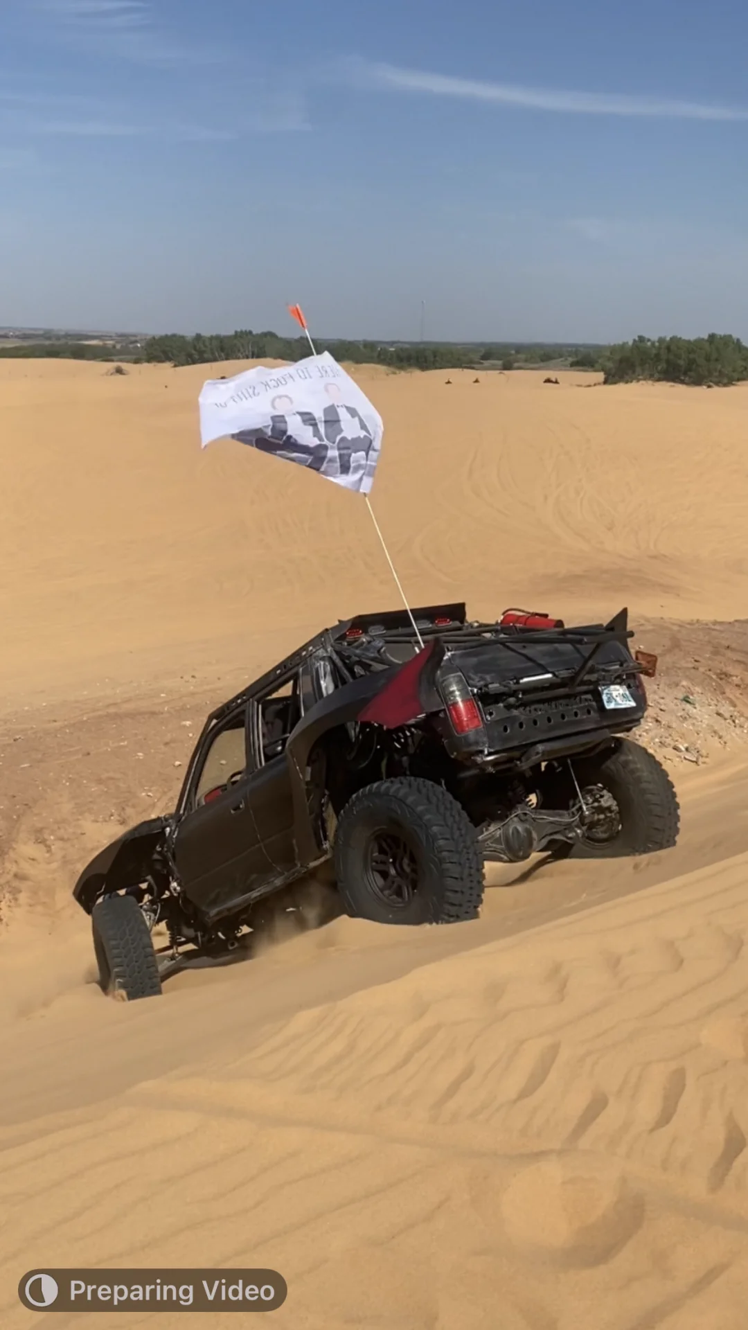

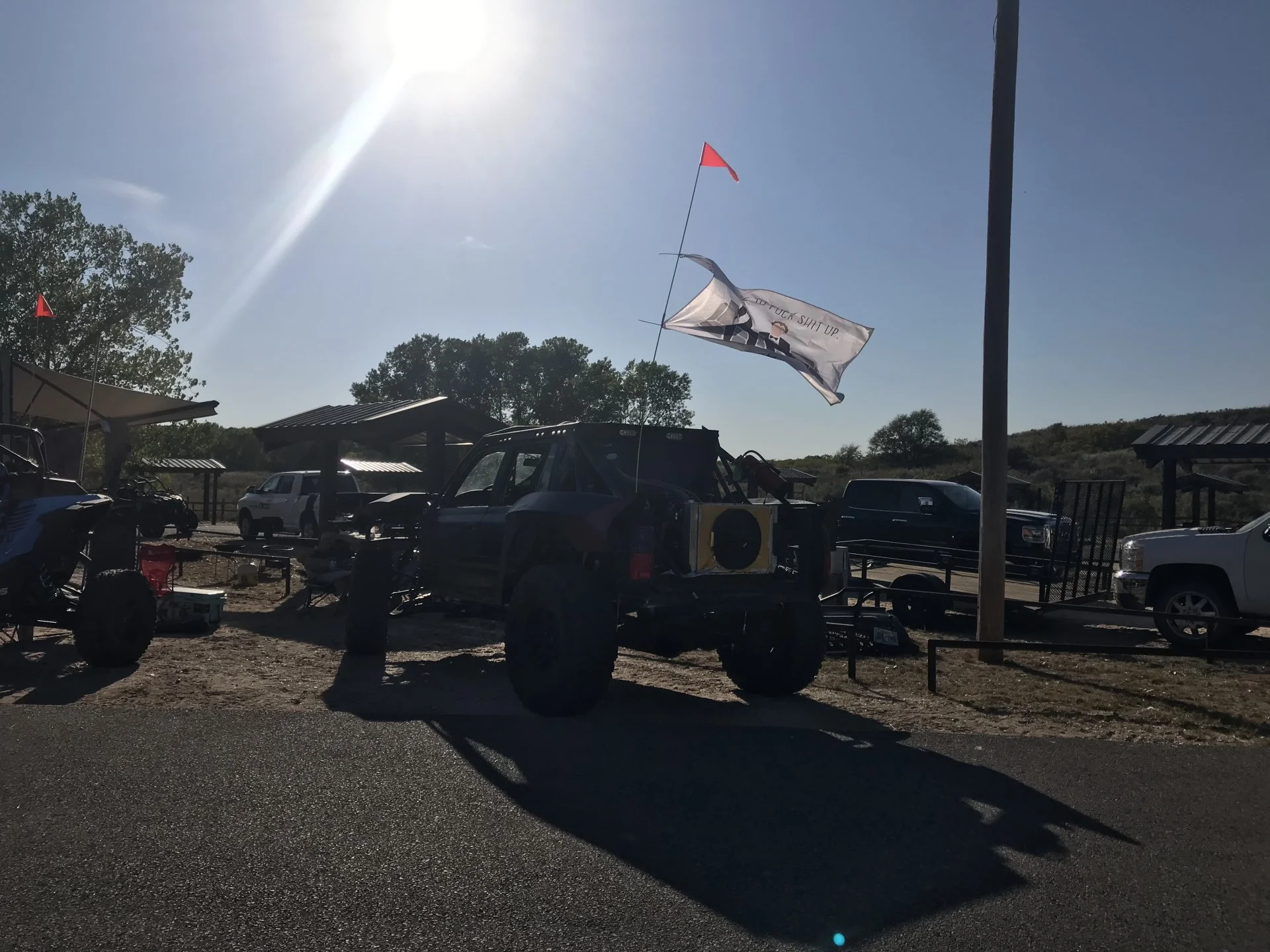

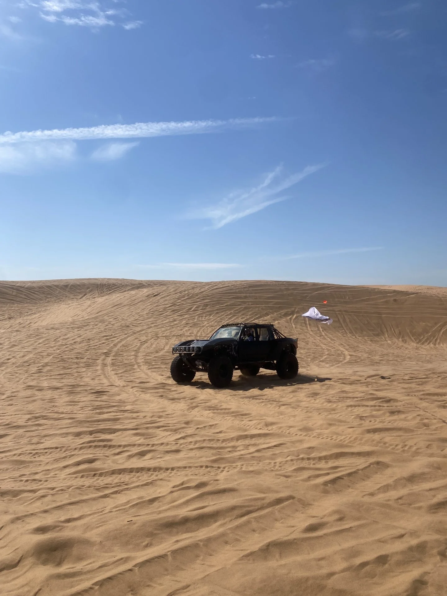

First things first, after an hour of absolutely thrashing on the cruiser’s rev limiter it puked water got pretty hot and had to limp it back to camp. A little disappointing but that was the point of this trip the real one is next weekend.
How did it do otherwise?
It was able to flatten out on the big whoop sections where even the LT turbo RZRs struggled to put power down. It was able to go straight up sand dunes while shooting massive rooster tails. It was able to pass built Sandrail’s on the whoop sections with ease and even able to kick the rear end out while doing so. Steering geometry is dare I say it, dialed. I and everyone I was with with was nothing less than surprised on how well it did, I couldn’t be happier!
Unfortunately didn’t have time to find a good jump… plus it was 4wheeler weekend and there were kids everywhere doing wheelies, next weekend should be less crowded.

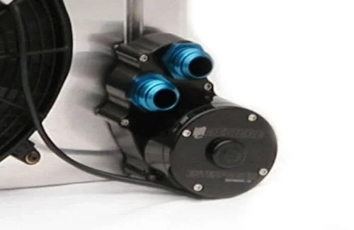

Ordered a bad ass pump to compliment the factory pump, using this in a booster pump configuration.

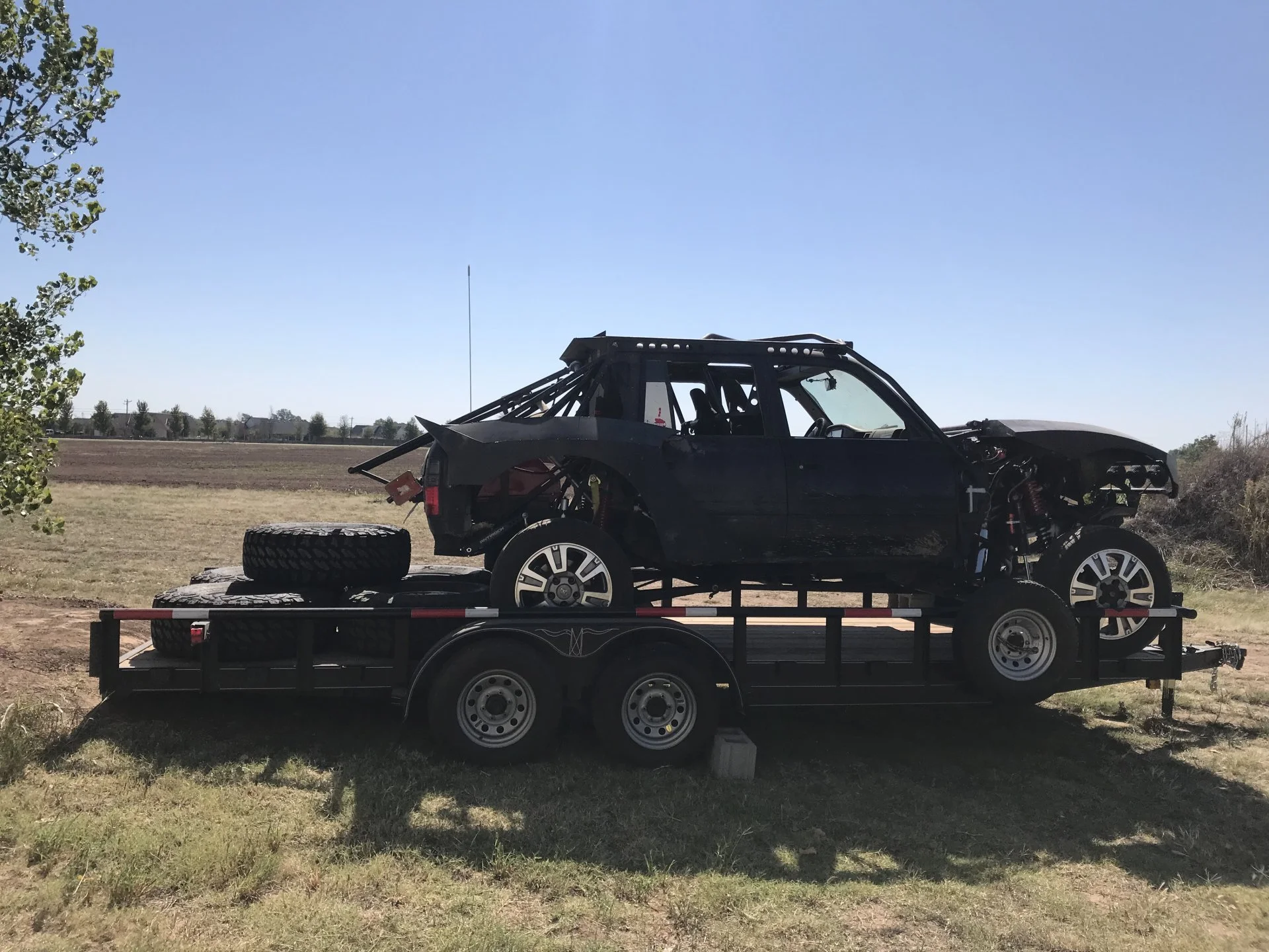

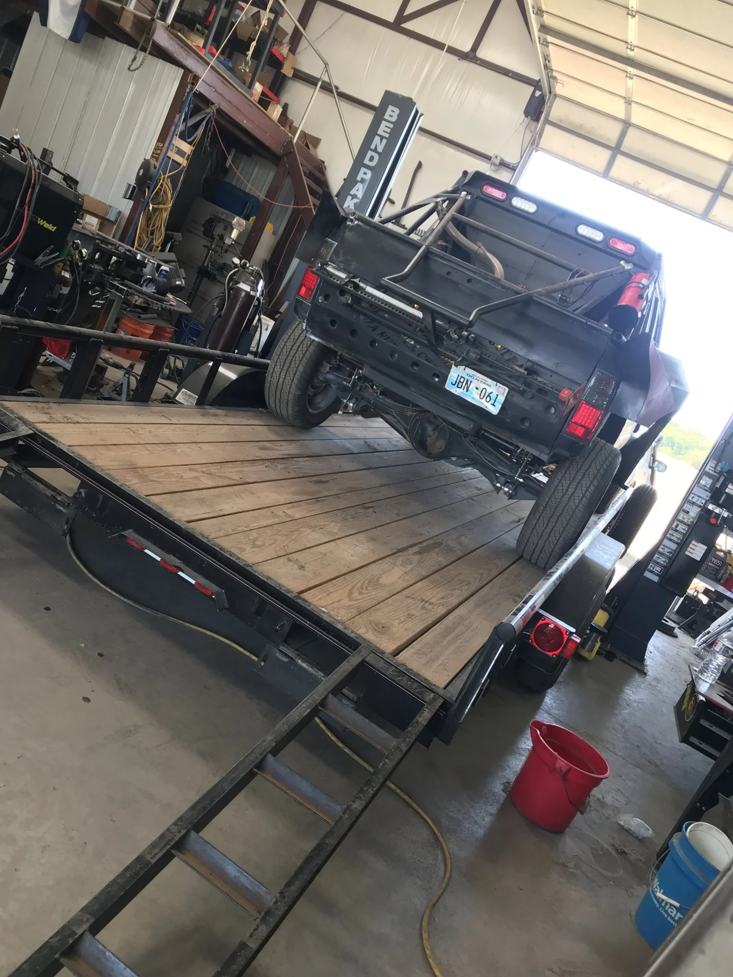

Appreciate it! Trailered it up there! Drive was over a couple hours and figured something would happen 😂
