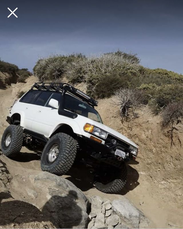

This is one test rig essentially, 80 chassis, 4 link front, 16"s front set up for droop, coil overs and bypasses, has 16s droop set up rear with a frame too, but #superslinky will be with 18s and a frame and triple rate coils.
This is the turbo diesel 80 version testing, with the pre production LHD and RHD frames bolted in for the mount system in the front, and cross engine bay bolt in brace system. Secondary bypasses will be an option over the CDC coil overs.
Rear 16s and bolt in A frame droop, going to 18s.
[drove to there in 2wd]
Working on this ride height, [50mm or 2"] but on 40s, this pic is 37s.
Will cut, tub, and pump for the 40s to travel up into the composite fenders and rear door back longer flare.
