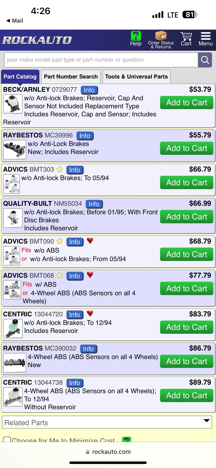

Sure would be nice if there was an OEM replacement for the '93-'94 master cylinders, or even a rebuild kit. I'm looking at converting my son's '94 into a '95, just to be able to get parts.
Isn’t the OEM the Advics branding? I believe the OEM has that stamping on it so this should be a suitable replacement. It’s what I used on my 96 and they show all options that you would need…
Yes, but it's "OEM quality", which isn't the same thing as being OEM. At least not always. I may have to go that route, if refittgin the later model master cylinder proves to be unworkable.
Yeah I understand in some cases the OEM “quality” can be a difference, but I believe CruiserDan sells this exact brand master cylinder because he did the research and found it’s the same quality.
