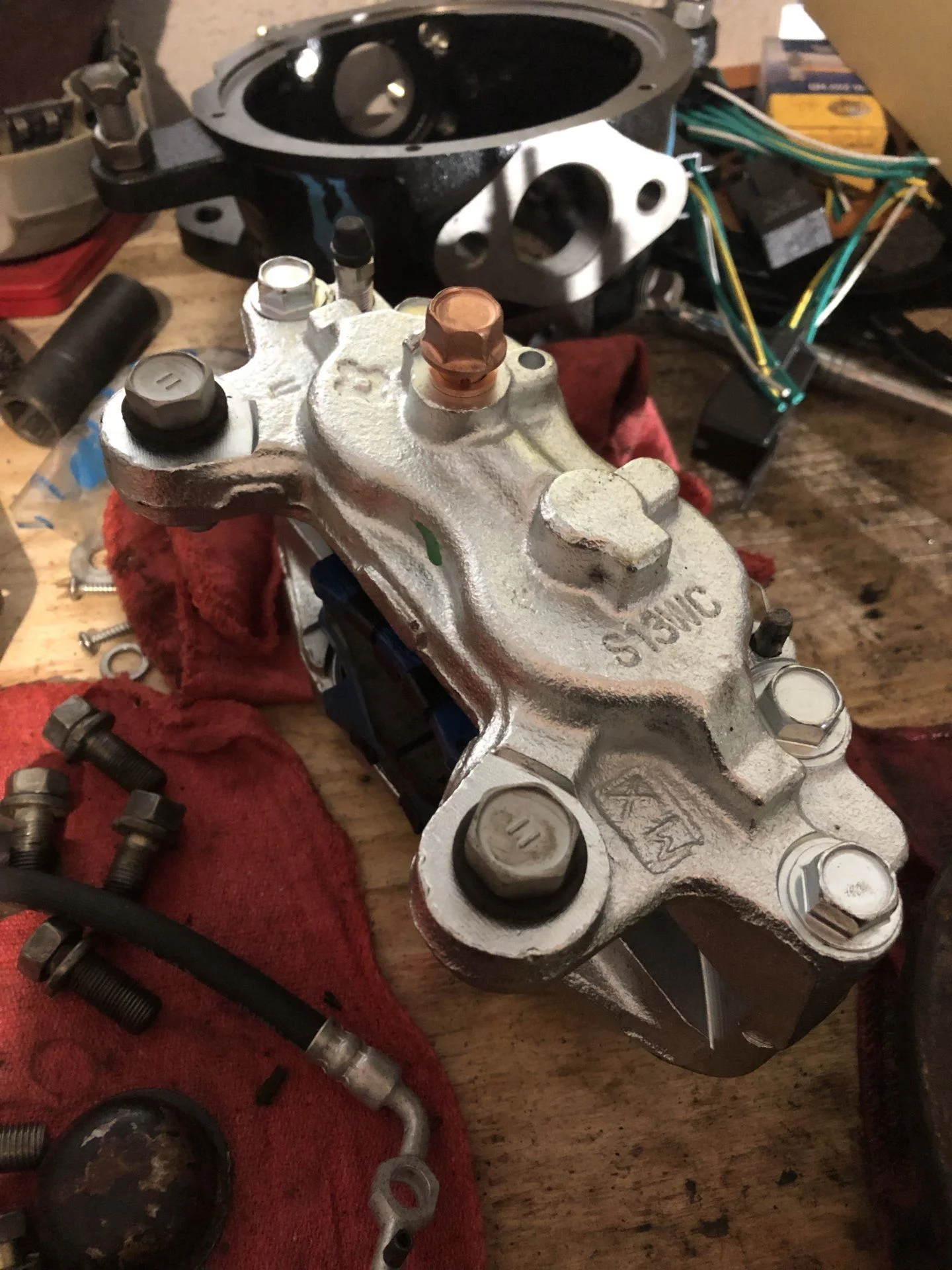

Same experience with the NAPA this week. Got them. They sucked. Pitted, corroded, surface rust. I returned them and got the Toyota iterations. I just don't have time to d!ck around anymore.
I just wish I knew someone who could possibly get them for me.

@beno : That caliper you show is an OEM rebuilt, or 100% new? I seem to remember you were not impressed with Toyota's rebuilts from another brake thread. Also, I seem to remember the "S13WC" casting from the '00-late '04-'05 Tundra. Same caliper?

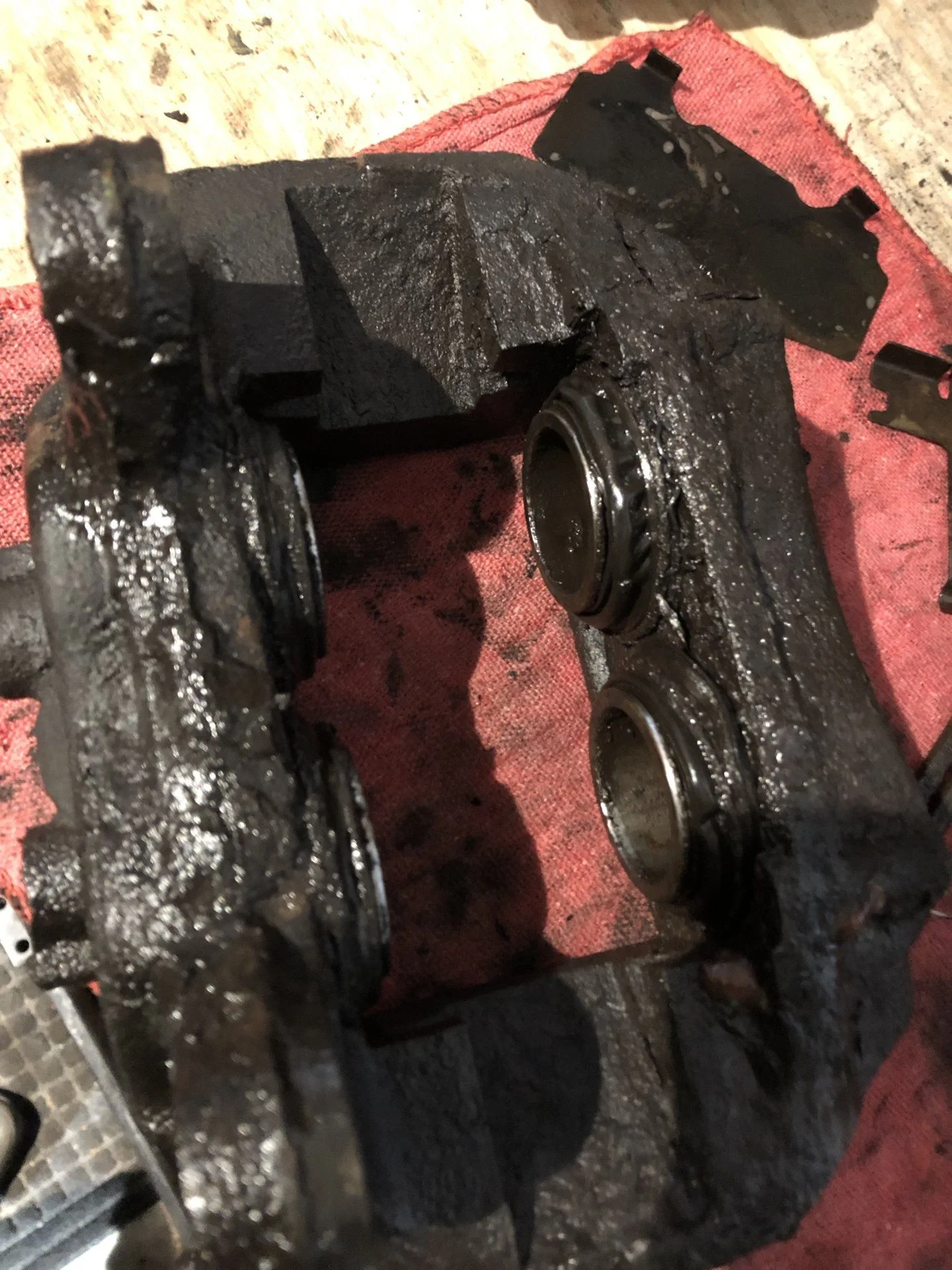

Are you keeping those old cores?

Crap, Tundras were "S13WE, and S13WL"
