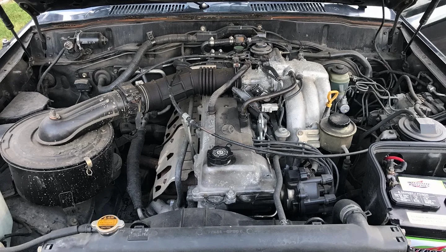

  • She’s a bit dirty under the hood and needs a general cleaning but you have to start some place, right? I’m baselining her; tires were first because the old ones were way too unsafe and now I'm moving onto under the hood…the engine is super tight and runs extremely smooth for 222,xxx miles…I’ve had her seven years (200,xxx miles when purchased)…
  • Air Cleaner Intake Hose was one of the first parts replaced (OEM) back in January (?) 2015 (Before I started my recent/new spreadsheet). The Air filter was replaced at the same time as the intake hose and is still beautifully clean after 20k miles.
  • Radiator doesn’t have the telltale yellow staining indicating it’ll need replacement (which seriously makes me happy) but I’m going to have a pressure test performed, and if that’s good, then a flush. Most of the main hoses LOOK good but could probably use a replacement; I don’t know what the PO did and didn’t do so the hoses could be original 1997 for all I know; considering all the hoses seem to have o-ring style screw clamps, a lot may have already been changed out. But I'd rather be safe than sorry, especially since the hoses on the Heater Control Valve look a bit worn...AND the heater control valve at the fire wall is half yellow so that will need to be replaced ASAP

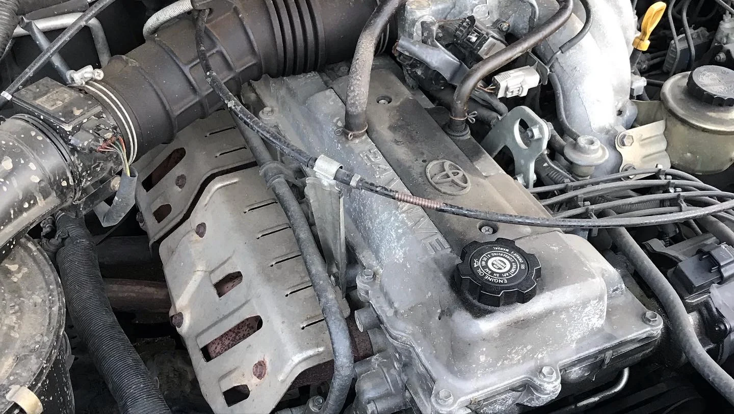

  • The distributor gasket needs to be replaced as apparent in the images (blowback). The valve cover gasket doesn't seem to have ANY seepage at all upon inspection.
  • The battery...yeah, I don't know what's going on there. The PO did some janky ass stereo wiring with an off brand single Din and shoddy amp to include some weird fuse set up to the battery…so I’ll need to fix that when I replace the stereo with a double din. Right now, after reading through a bunch of posts about stereos not working, there was one thread that indicated that a fuse set up under the hood, if not done right (?) can blow most of the electrical in the cab...which seems to have happened. The stereo cuts in and out, the clock barely works, cigarette lighter refuses to work (charging area) and the dash lights only light up the tach.

Take a hard look at the PHH. Since you are draining the radiator to do upper and lower hoses and the water valve and tstat I'd probably go ahead and replace that. Might also replace both crankcase ventilation hoses and PCV valve and grommet.
I'll add those to my list, thanks!
I d
The hose clamps there are not OEM. It should be easy to pull those off to check condition of the valve.
I didn't think they were OEM...OEM are the squeeze kind of clamps, right?
I have no idea if the PO had any HG issues and had them fixed...there's absolutely no seepage around the valve cover that I can see. I'll try to get a few more photos of the block and valve cover this weekend.
Thanks!
While you are in there can get pretty far and deep.... But if you are, and you should, replace the heater valve, then you should be going after the peaky heater hose too... Now you can bundle a bunch of other stuff in there to make some of those tasks easier and if that is the choice then the little hoses for cooling that are in and around the intake....so you can do the fuel lines and vacuum lines as well. All at once keep you from going back in there and th cost is not much at all. It will give you lots of room to wrap insulation around the wiring harness near the EGR. Also let you clean the throttle body etc and you won't be adding too much time or cost. It is annoying to drain the coolant multiple times so a flush and this hit everything that would also require draining coolant done at the same time will save you time in the long run.
