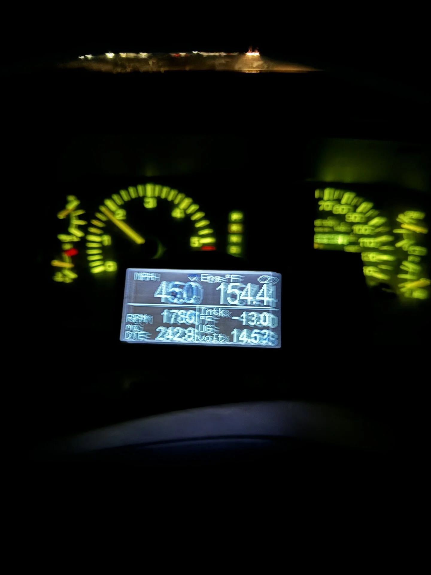

i just wanted to use this as an opportunity to post this picture i took of my dash. Check out the intake temp. we were pushing -40 in montana this last weekend. take good care of your battery.
ultra gauge reading -13 on the air intake
