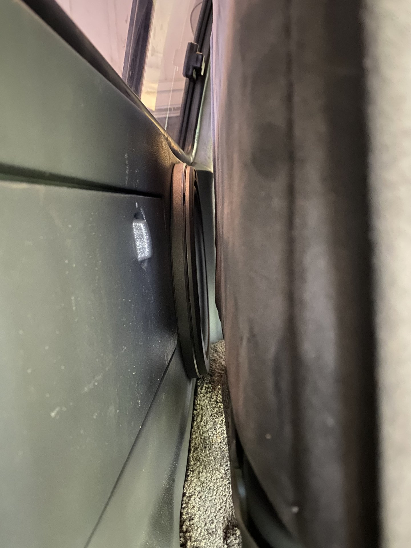

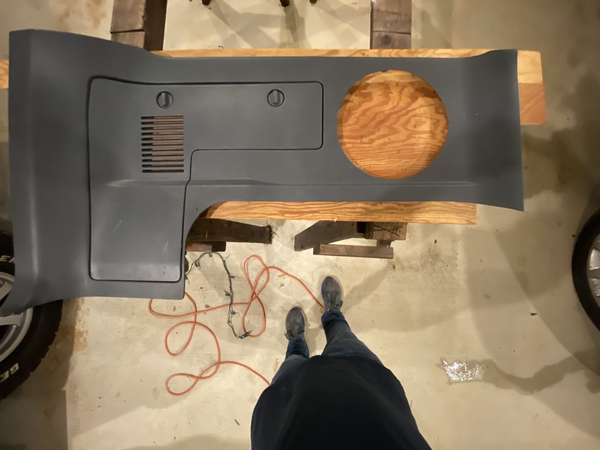

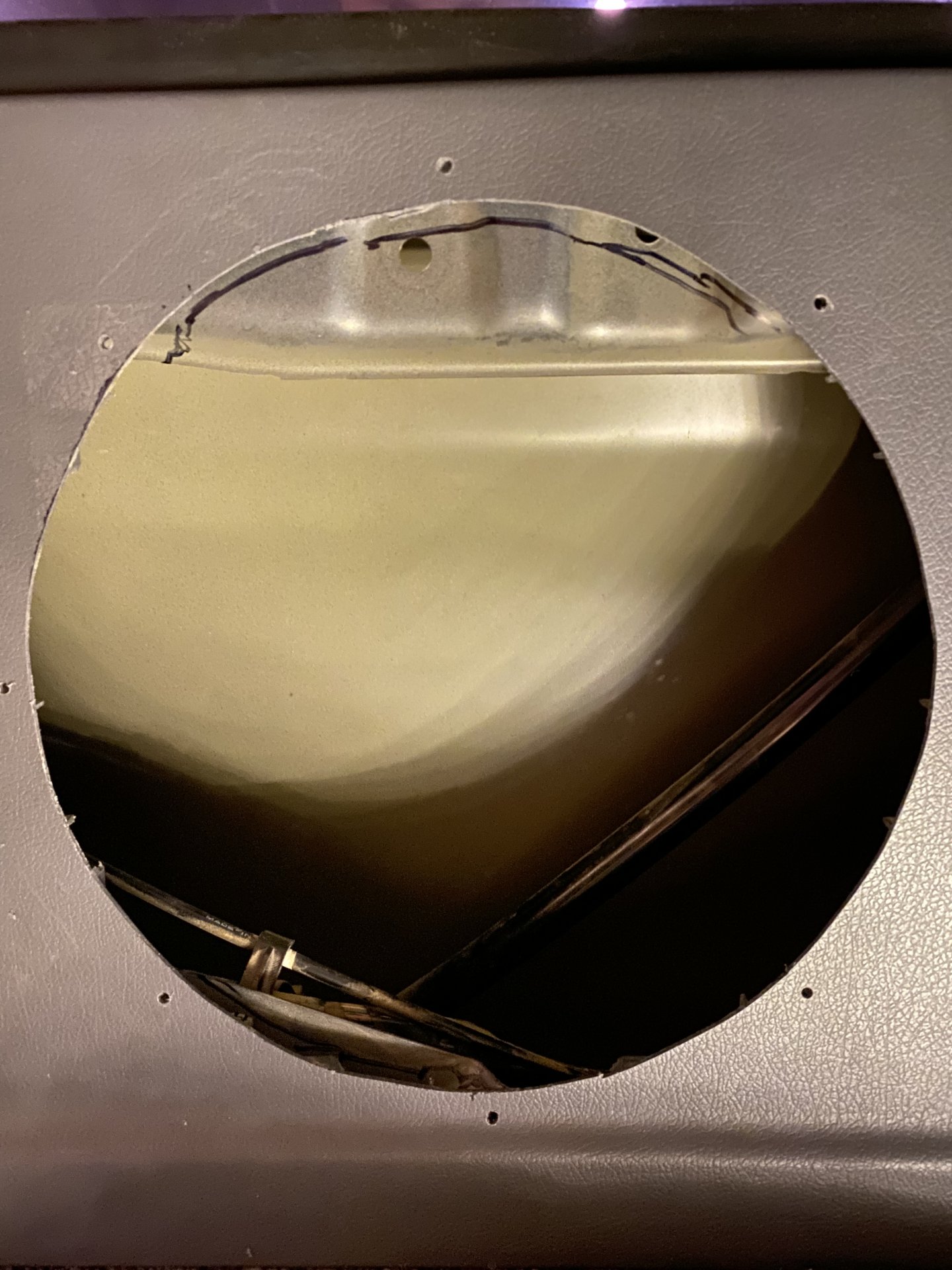

Alrighty. I got her installed. I’ll be going back and putting dynamat all over every panel in the vehicle, but here’s pics of the finished product so ya’ll can see what it looks like. The sub came with a template for the hole size and where to drill from screws. First, I marked and cut the hole in the panel.
Next, I put the panel in place to see what metal needed to be cut. There were some small places that I got with a jigsaw.

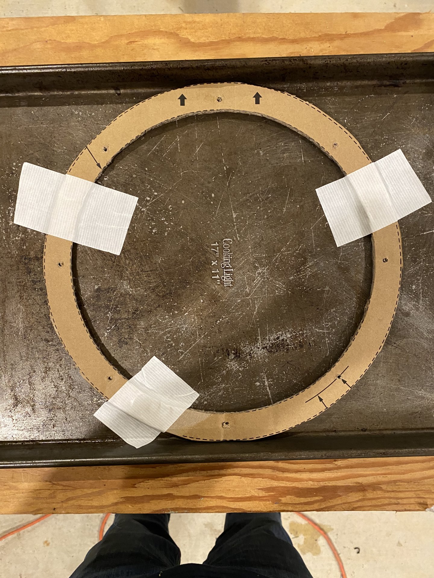

To create a mounting bracket, I created a marvel of engineering. I used an old steel baking sheet (11x17) and cut a hole in it. I had to trim some edges for it to fit, but it’s sturdy.
Finally, last pictures with the sub installed.

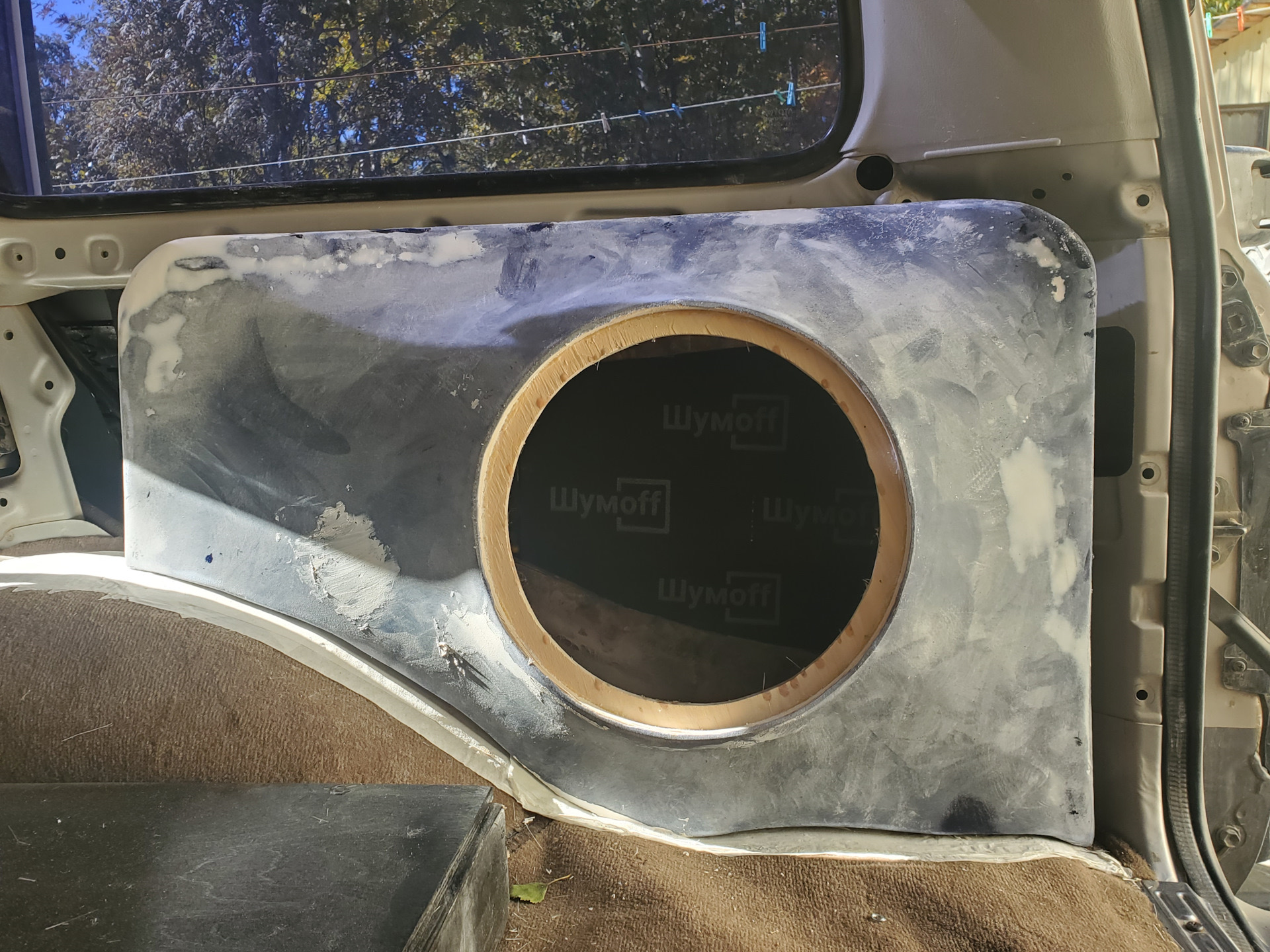

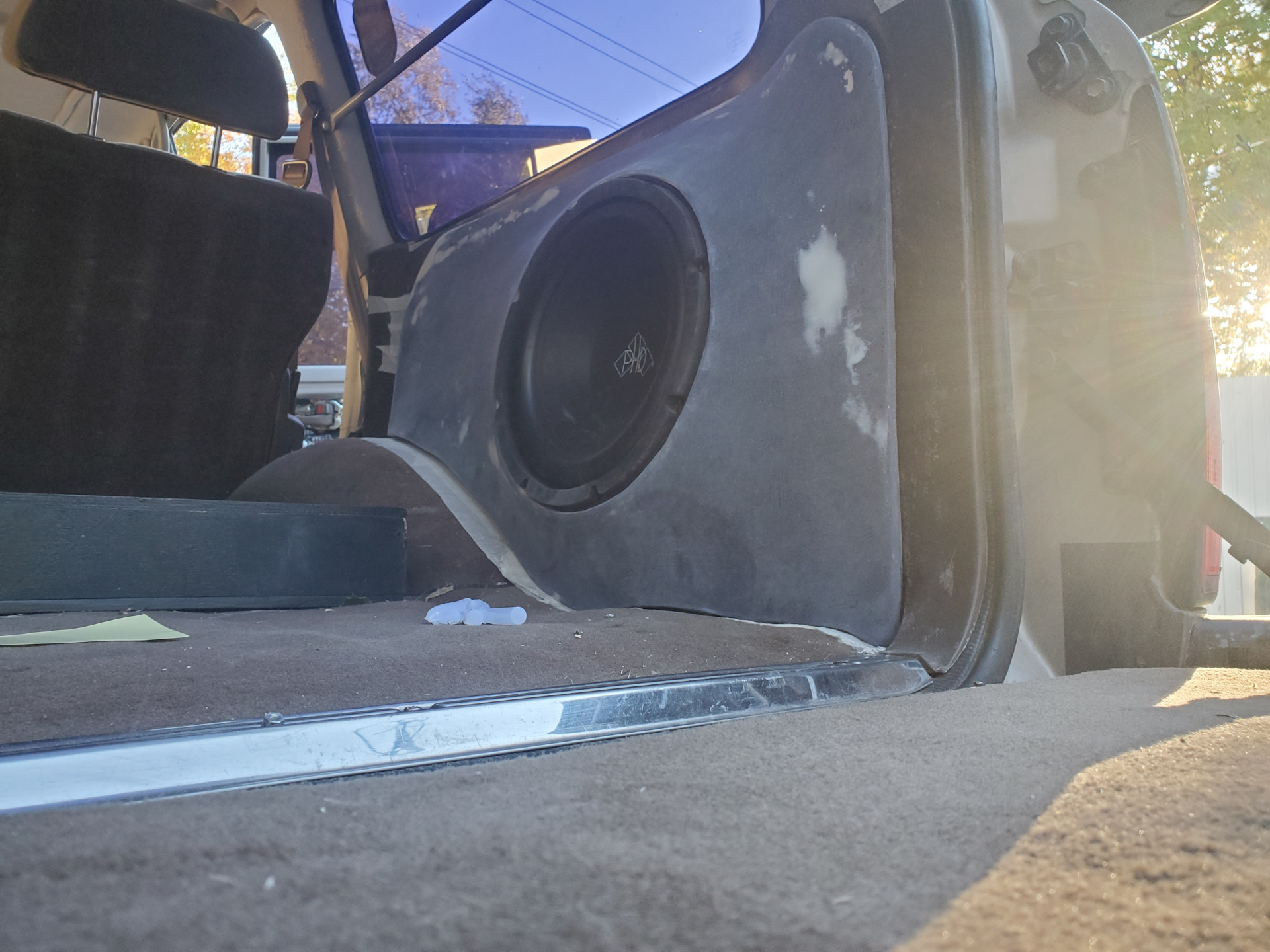

I don't know why nobody else is utilizing the ceiling to mount a sub.
I built a box that attached to the mounting locations for the rearmost grab handles and I have been running a low profile 14" kicker sub in this location for 4 or 5 years now with zero issues.
It doesn't really take up any cargo room and the only modification it requires is removing the handles......
The only downside is the loss of headroom for those building storage and sleeping systems in the back.
It is such a great location from the audio point of view. No rattles or vibes and it is centered nicely in the back.
I don't want to hear saftey comments. This photo is from my previous rig. I totalled the rig in a bad wreck. Bad enough to bend the frame and jam the passenger side doors shut along with sheering body mounts.
The sub didn't budge a mm.
A 10" or 8" would use a much smaller box and could probably double as a small storage area.

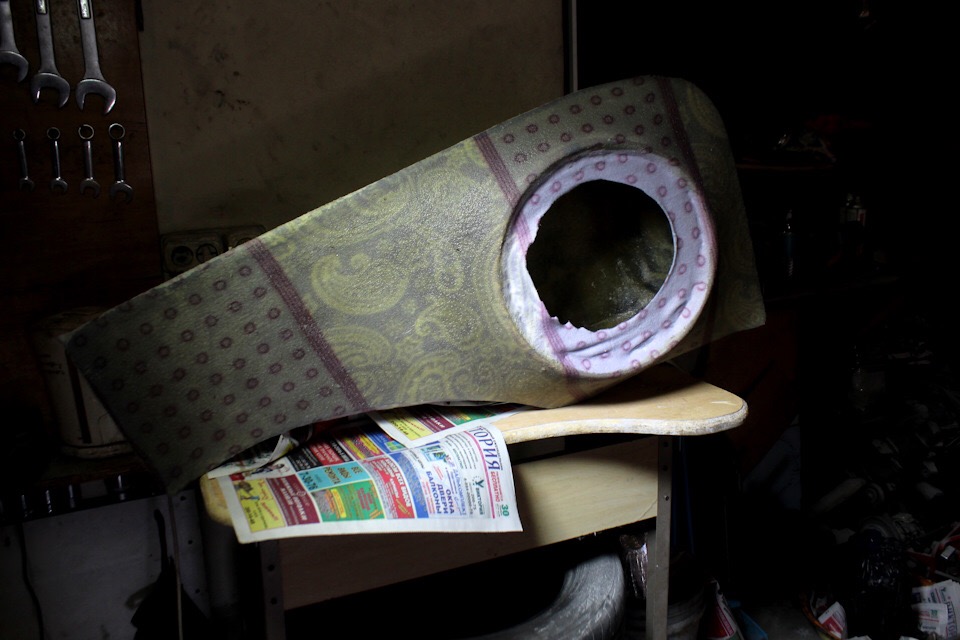

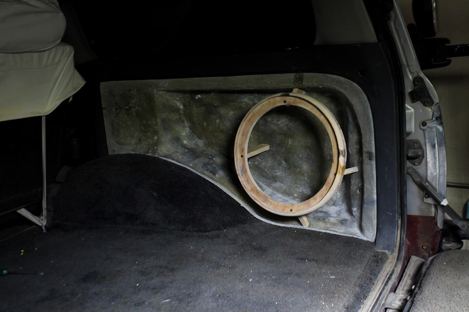

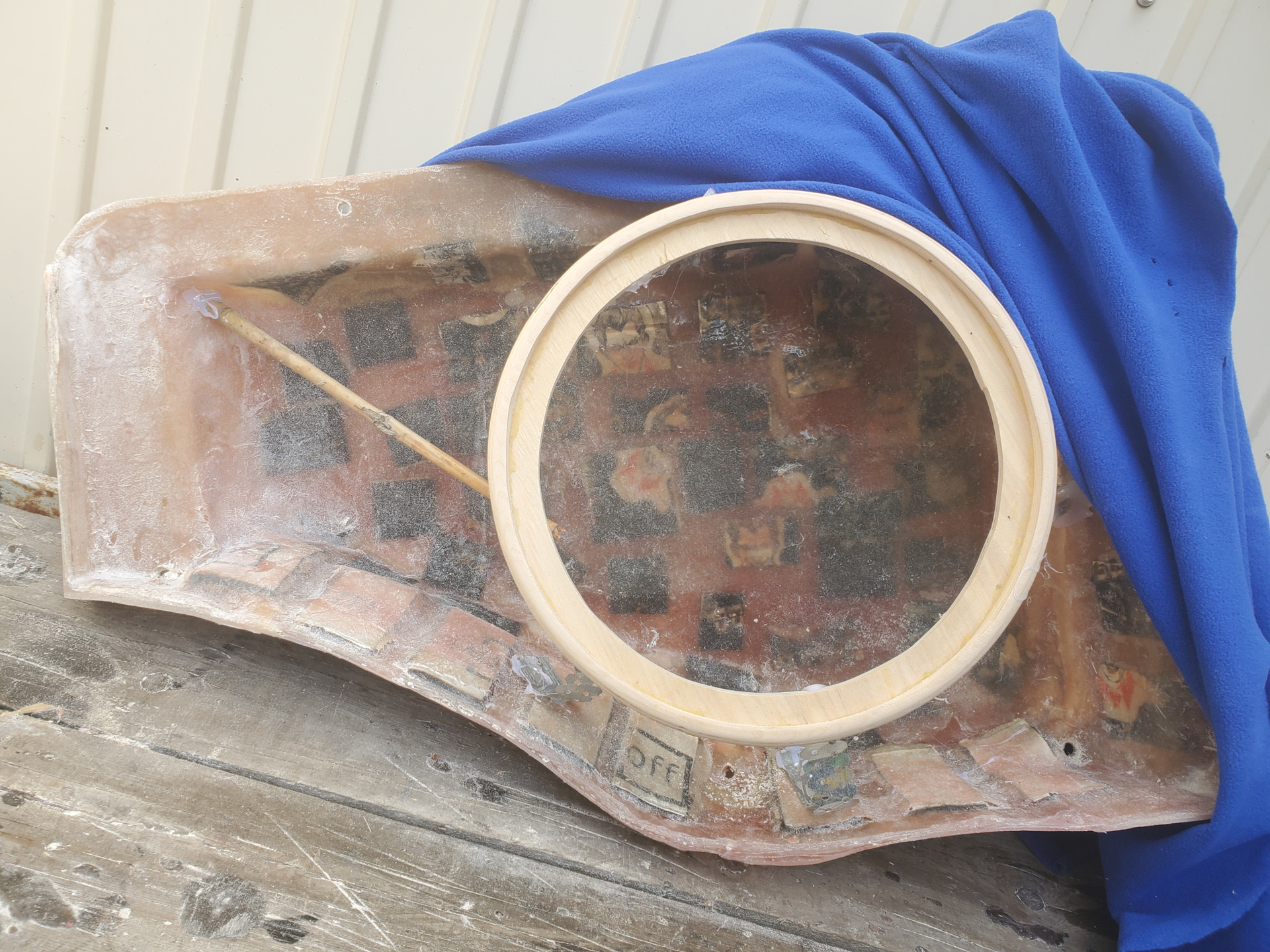

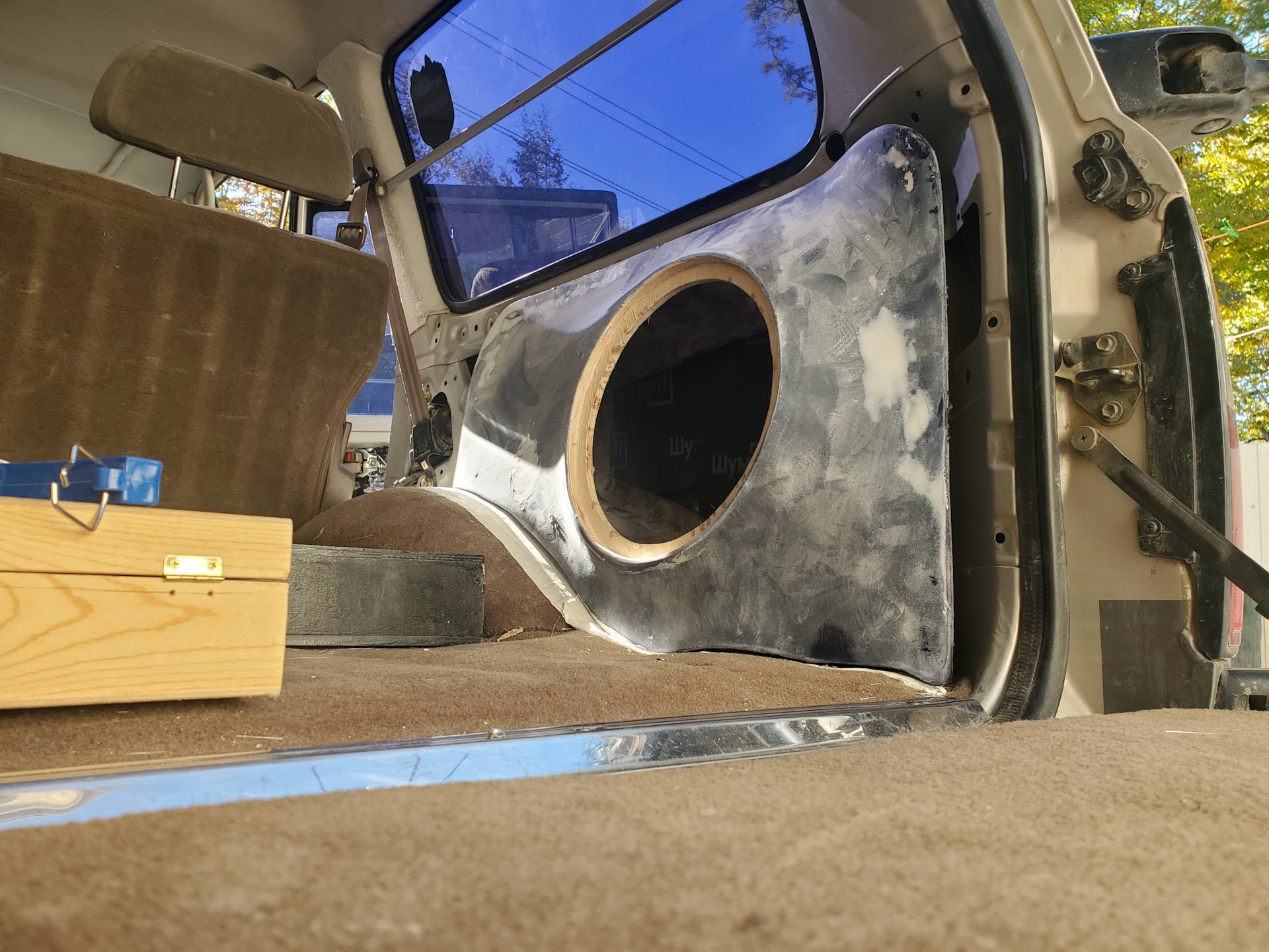

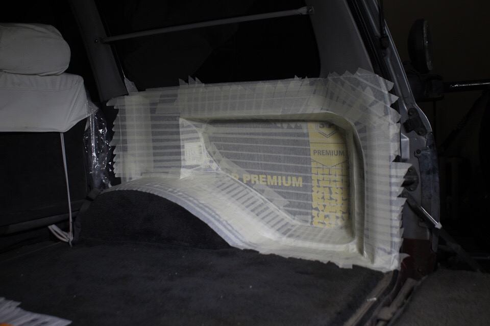

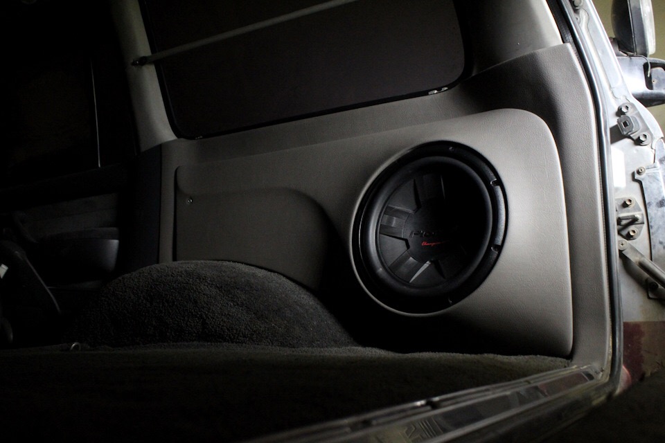

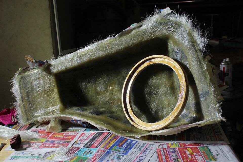

Exactly how I want to do mine, looks great! Any pointers on doing the fiberglass?
The most important thing is not to rush and do everything carefully.
The first step is a cardboard base, then gluing with painter's tape.
Next, dial several layers of glass mat, at least five.
To give rigidity, add vibration insulation between layers.
The ring is installed and covered with a soft cloth.
