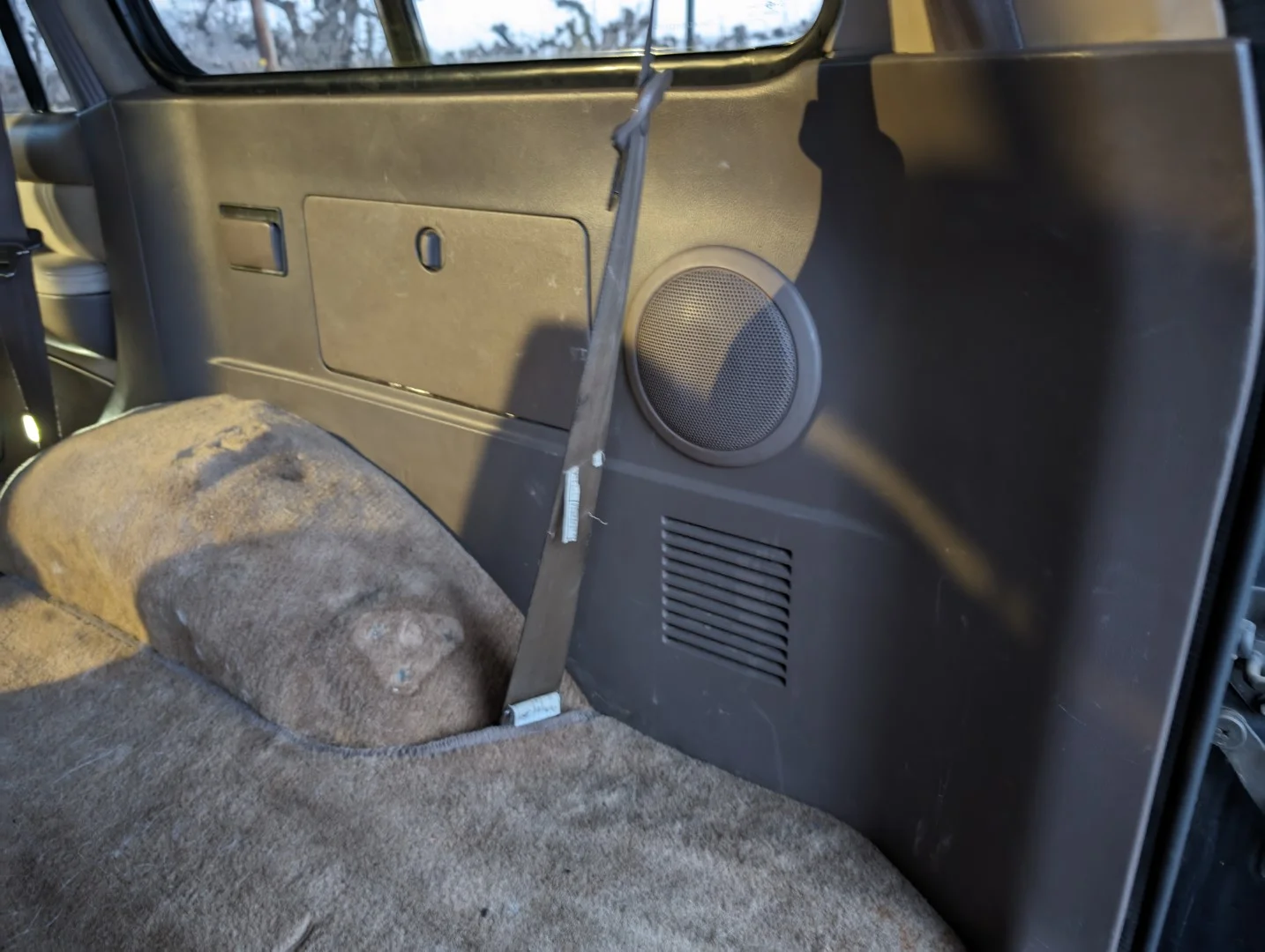

Hi group . I have a 1997 lx450 and I was wondering if anyone makes a subwoofer speaker enclosure that fits in the passenger rear side panel . I 'm looking for something that will fit in that space . I don't mind if the plastic panel is cut out f the way to make it fit . Whats some options ? Thanks in advance .

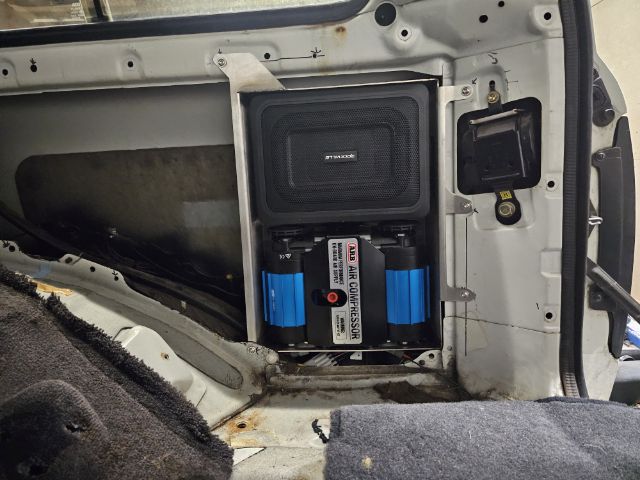

Mounted one of these, and even cut up the old subwoofer bracket to mount it. It sounds great.

I didn't see any wires in that area for speakers . I was trying to use a 12 in sub woofer so I ran the wire back to the amp I added in the same area from the new head unit I installed . The subwoofer just doesn't work right with out a box behind it . I thought since I put it behind the panel that would act like a box but it doesn't . I would have to make a custom box to fit . I'm now just going to take the 12 in woofer out and add a all in one subwoofer and patch around the big hole I made .

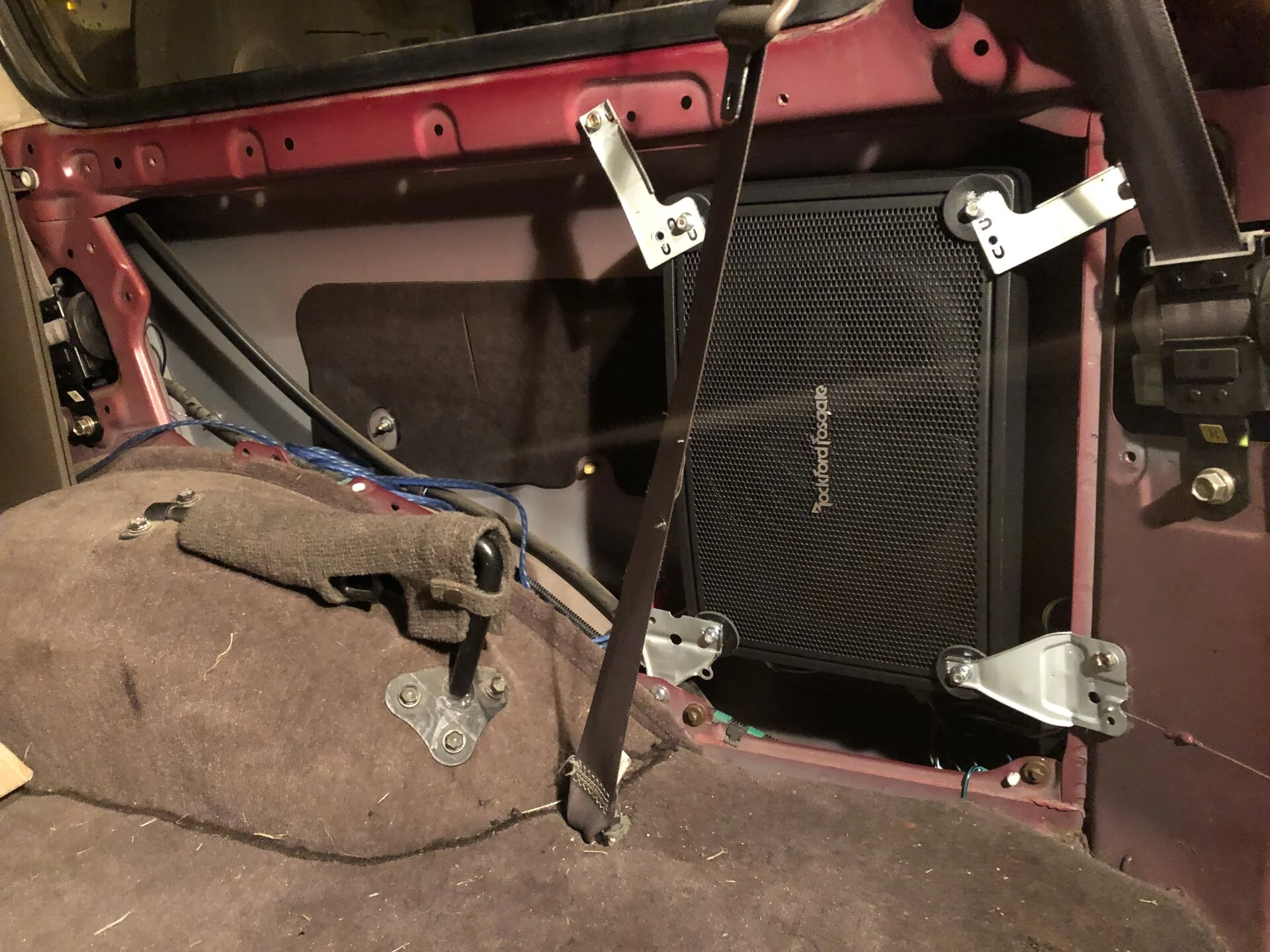

Made a mount for my powered 6x8. Cheap sub and I haven't fully wired it yet but you definitely can't tell it's there visually when the trim panel is on.

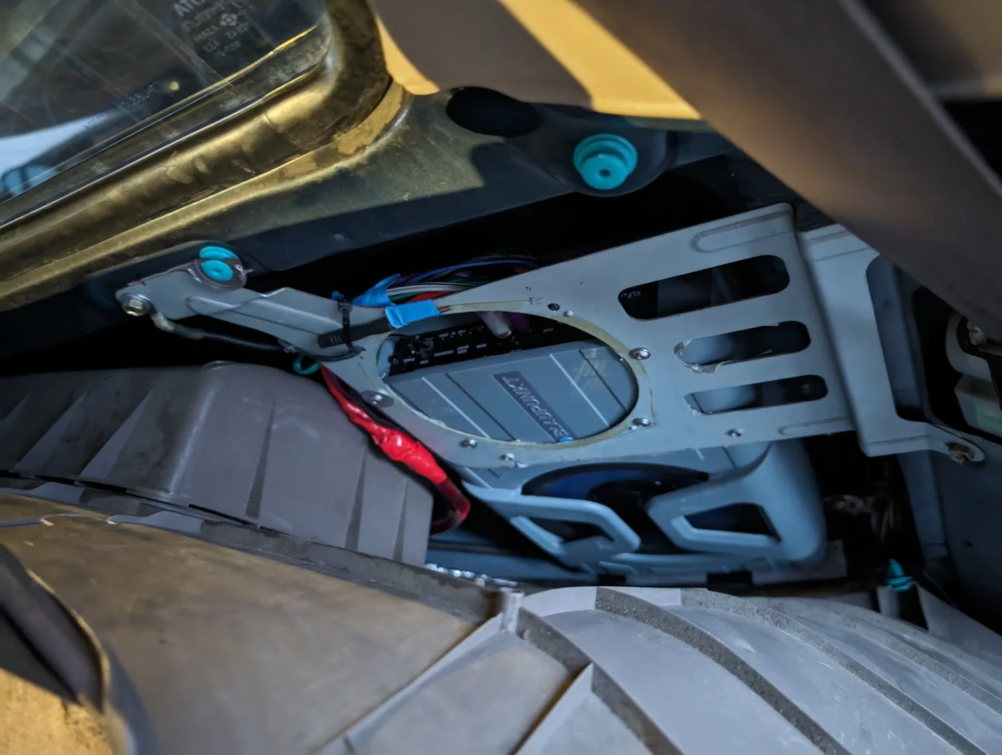

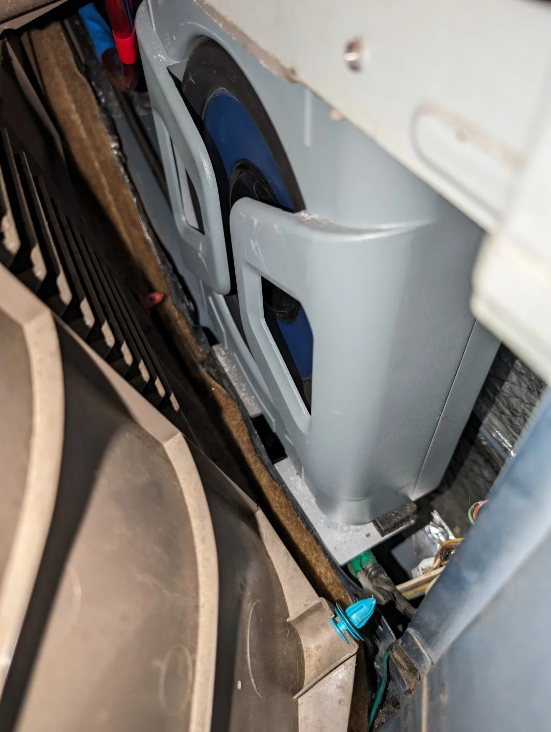

I fit this blaupunkt sub there. I used the factory bracket and some aluminum angle. Had to drill and tap the sub alum enclosure. It all fits really well. I'll dig up a picture later. Here's the sub. BLAUPUNKT Blue Magic XLf 200
