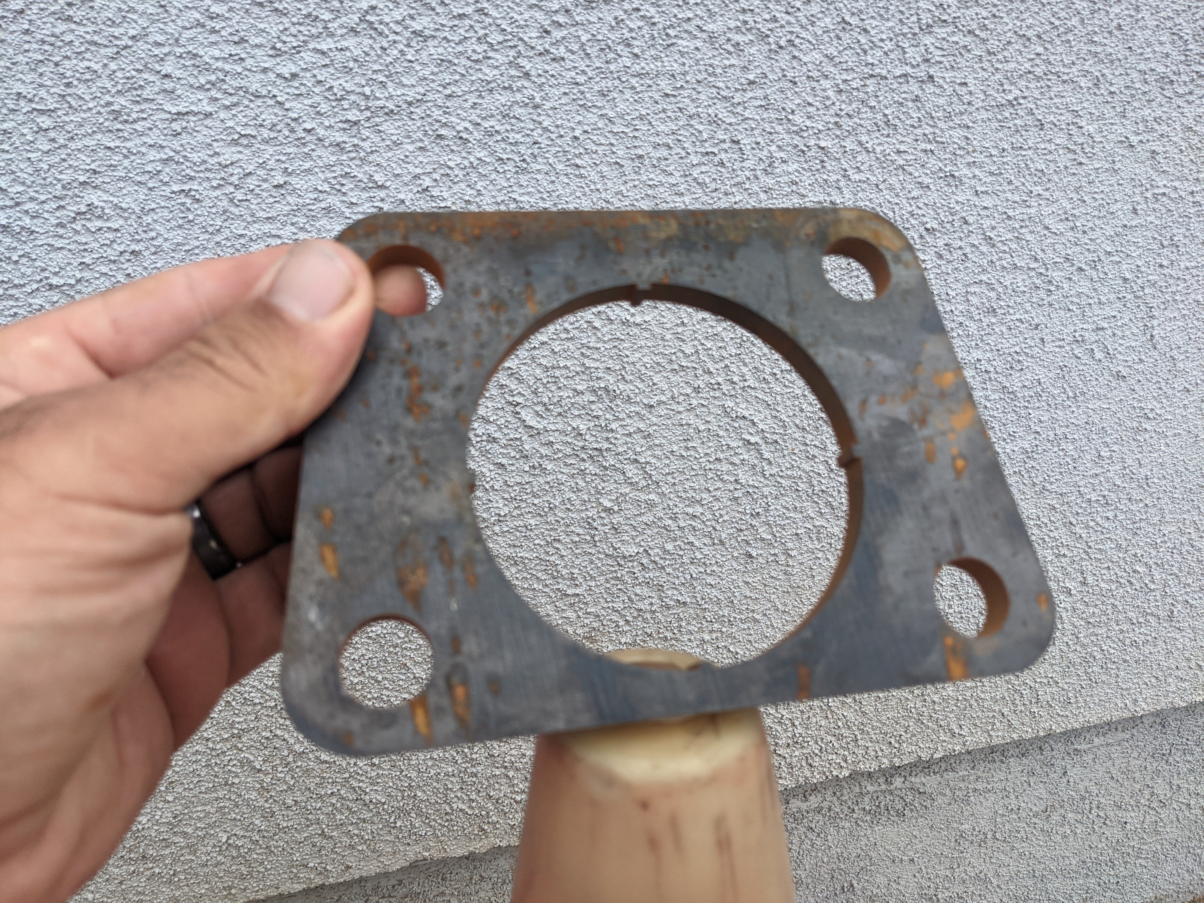

To put the late drum-in-hat style brakes on you'd have to cut off the flange from your housing and weld on the later style, not to mention buy all of the individual components.

There was a guy on Pirate4x4 making a weld on flange for the older 14B to install newer hat=drum parking brakes and disc brakes off a 2500-3500 GM. I have a set somewhere. Cut off the old one and weld the new one on. The guy may be on Irate4x4 now.
