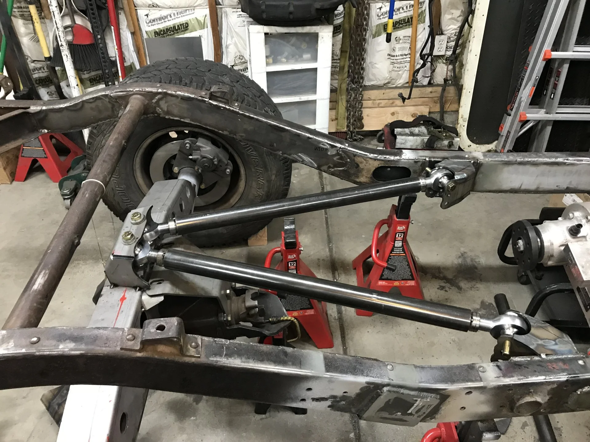

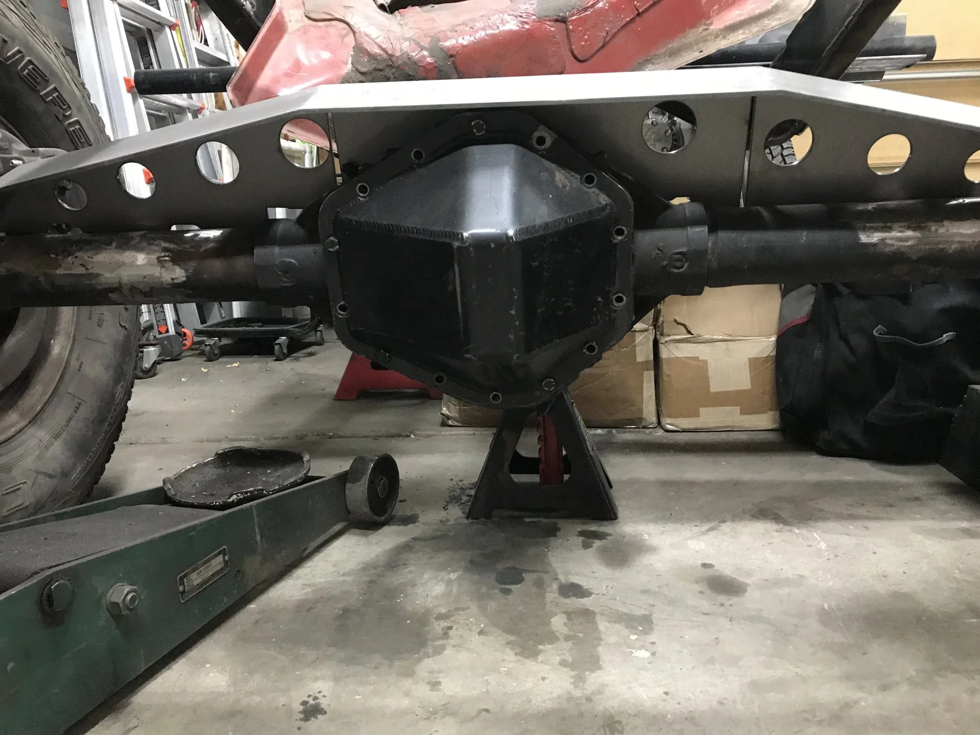

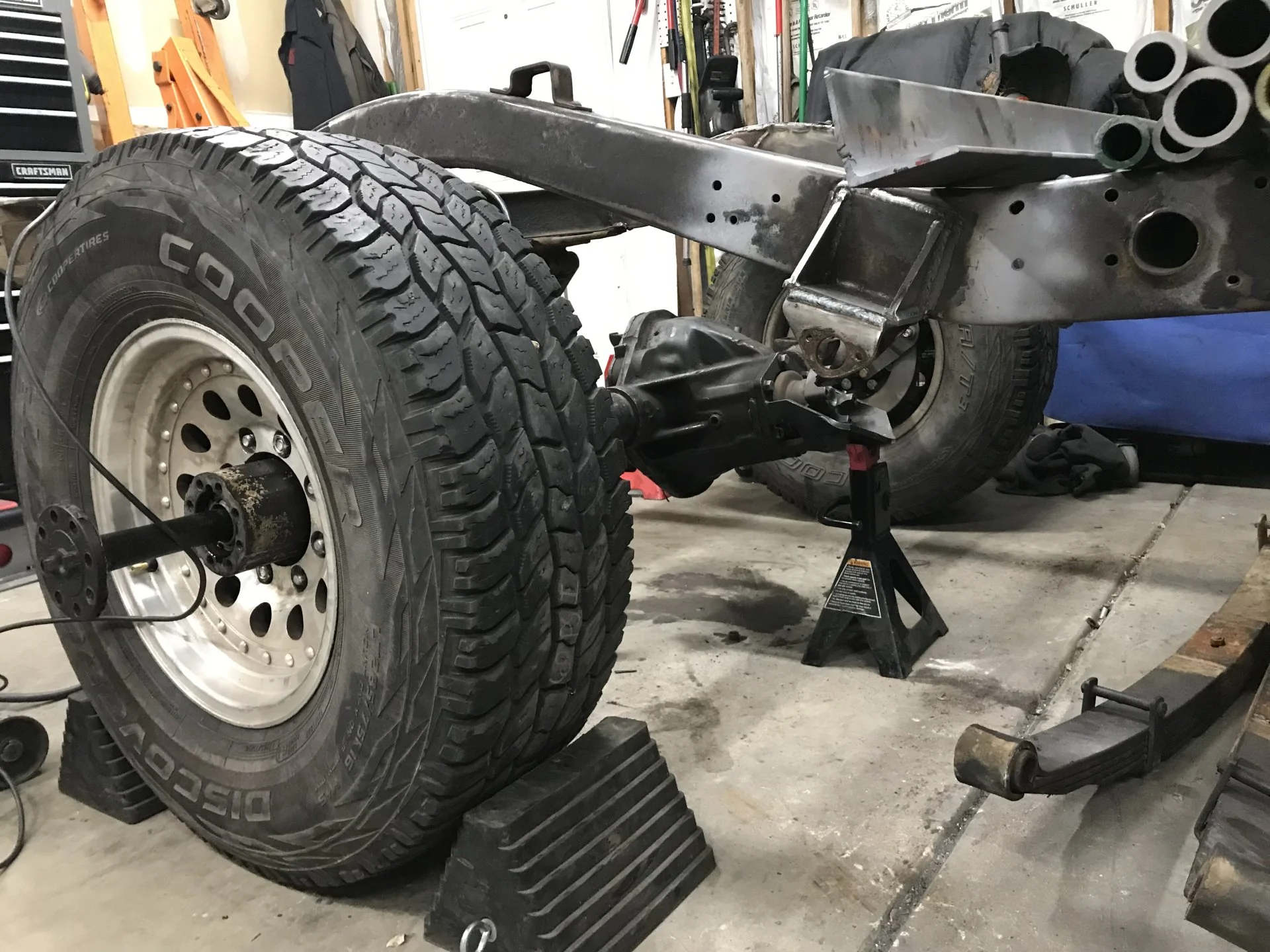

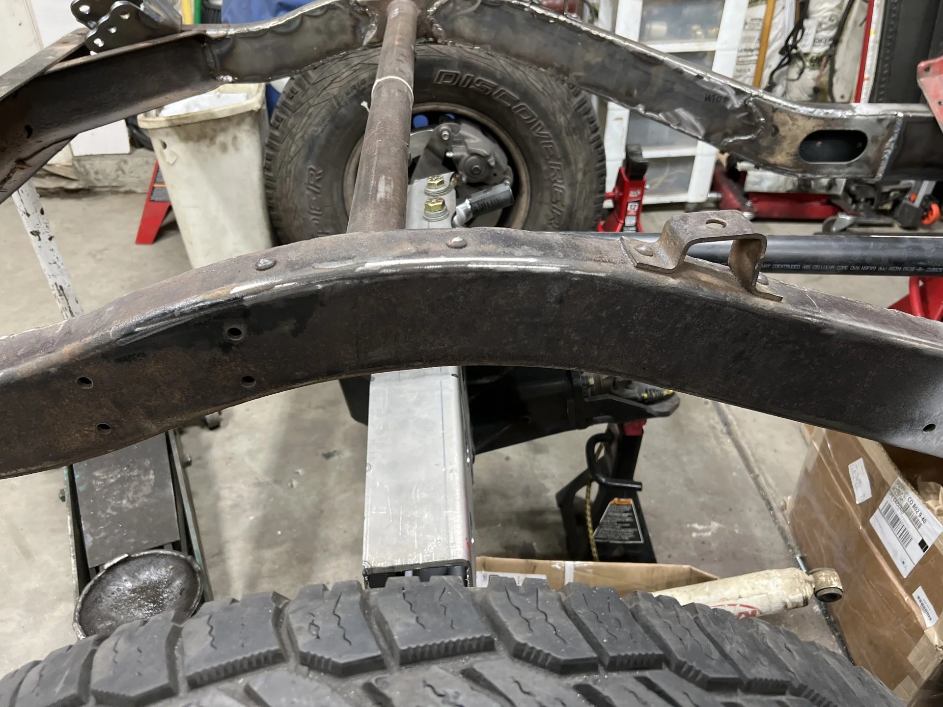

I started working on the Cruiser again. The rear leaf springs and mounts have been removed and it’s ready for the truss.

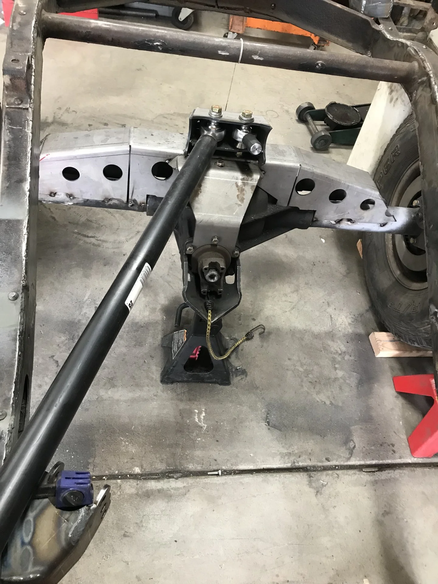

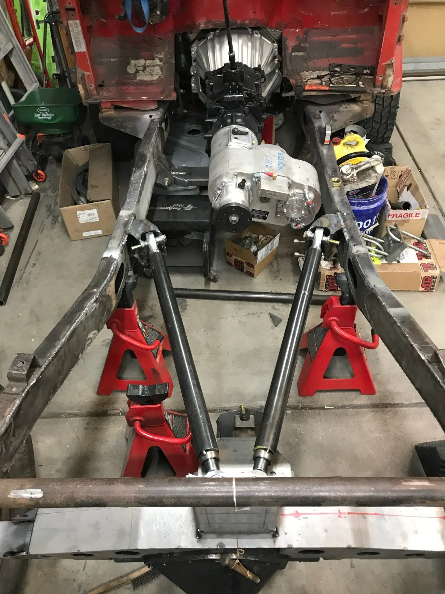

I made some more progress this weekend. I’m glad that @DangerNoodle talked me into doing the rear suspension now.

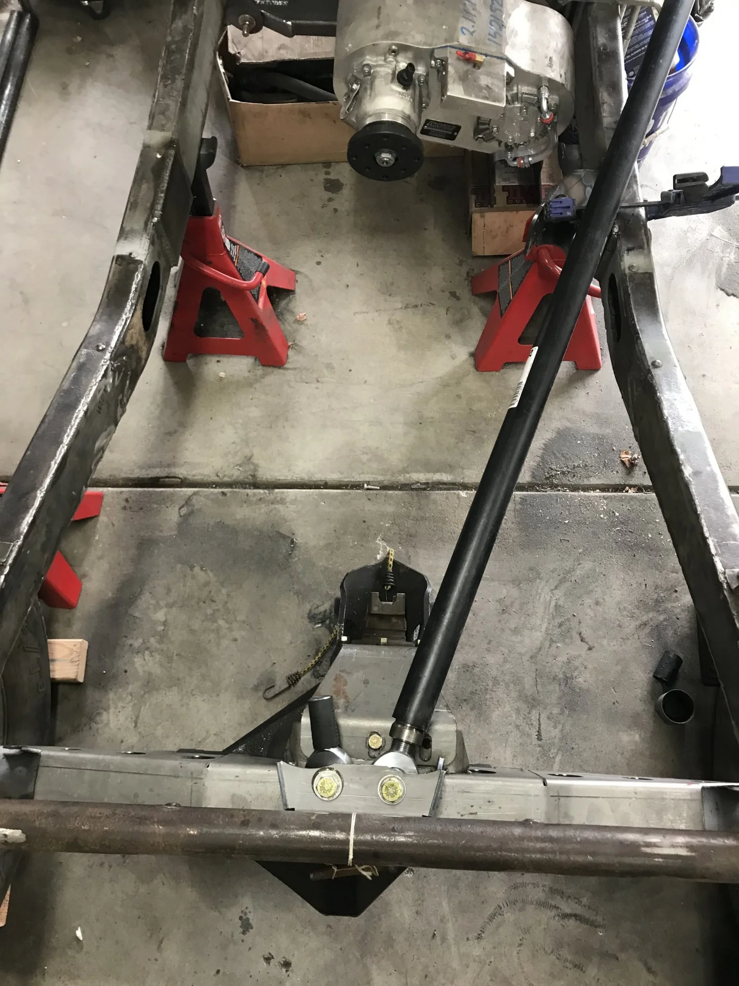

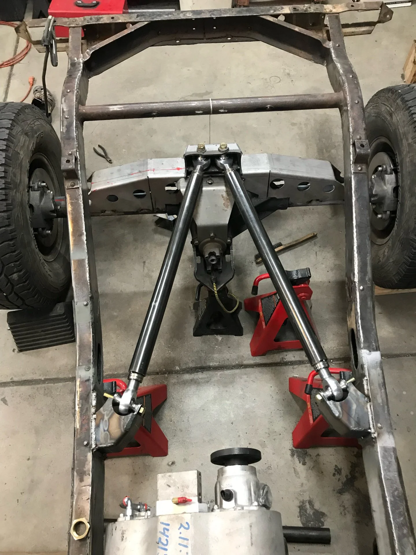

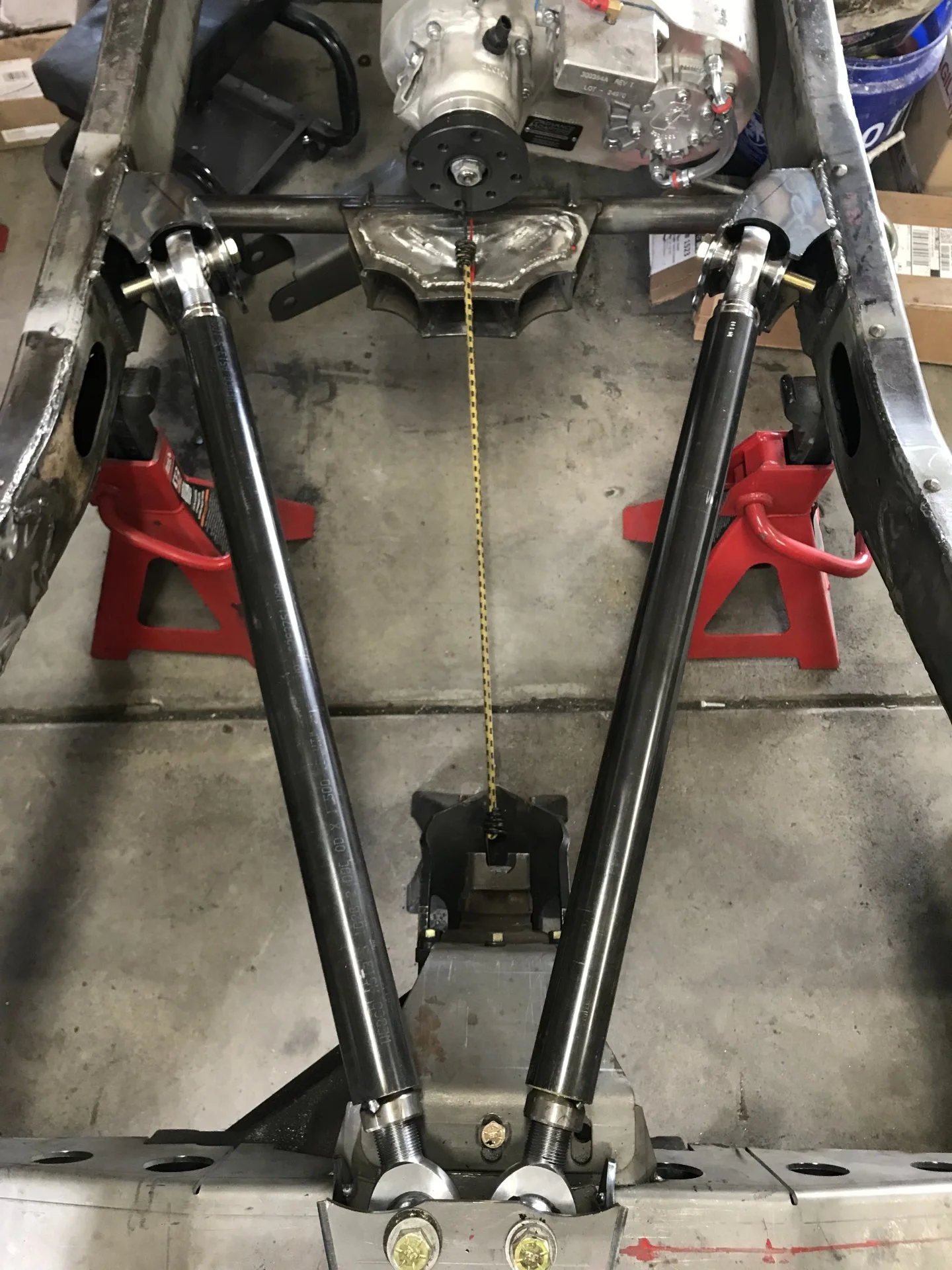

The uppers on the rear are going to be 36” in length. The lowers will be somewhere between 40-42” to clear the rear driveshaft.

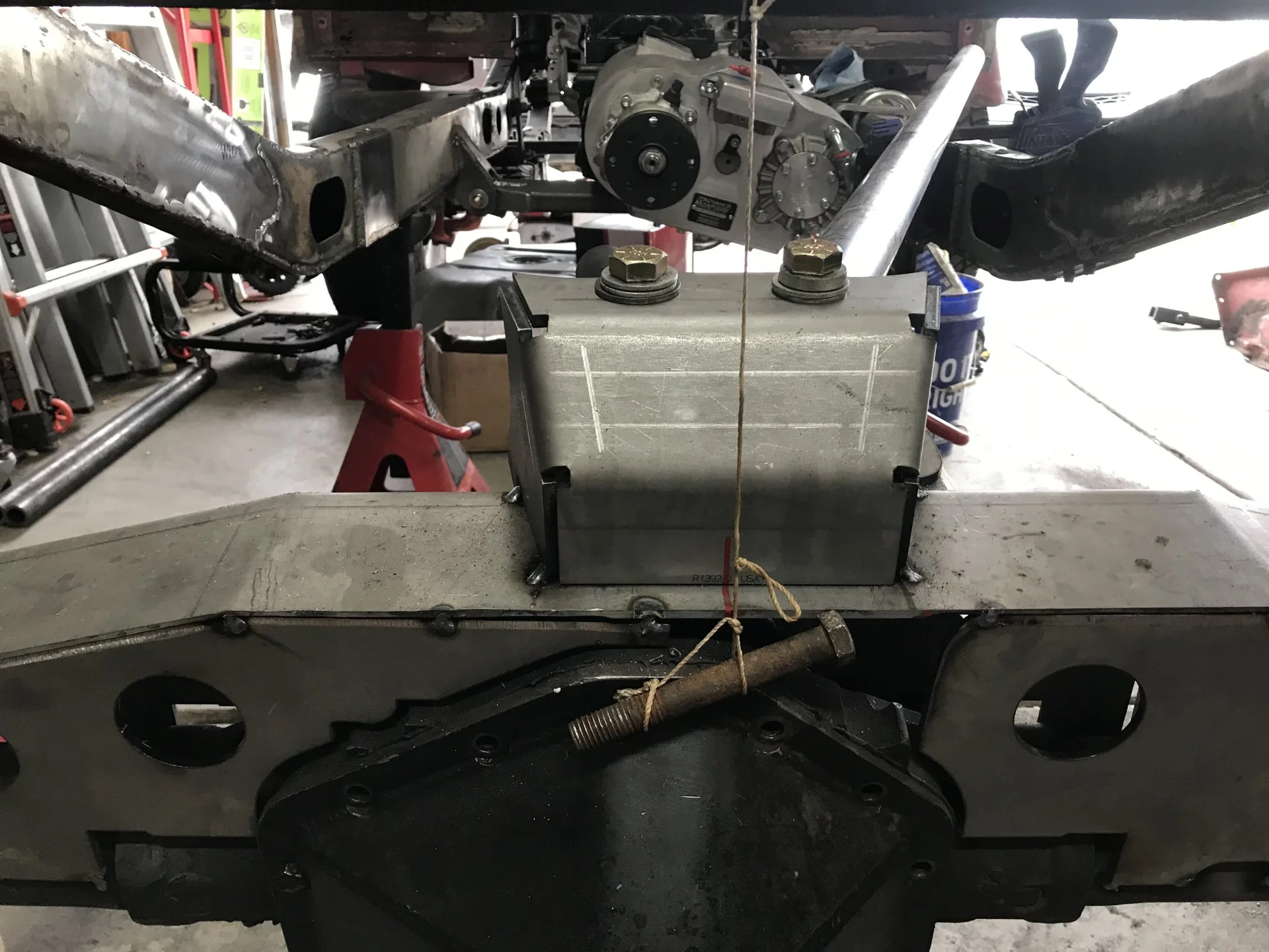

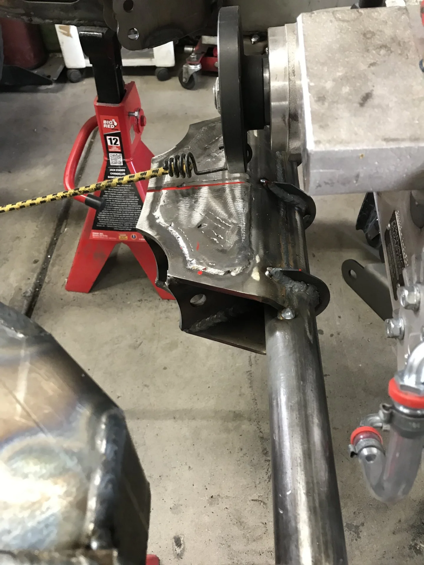

I learned that this pinion is about one inch off center so I adjusted the upper tower so that it would fit centered on the axle.
