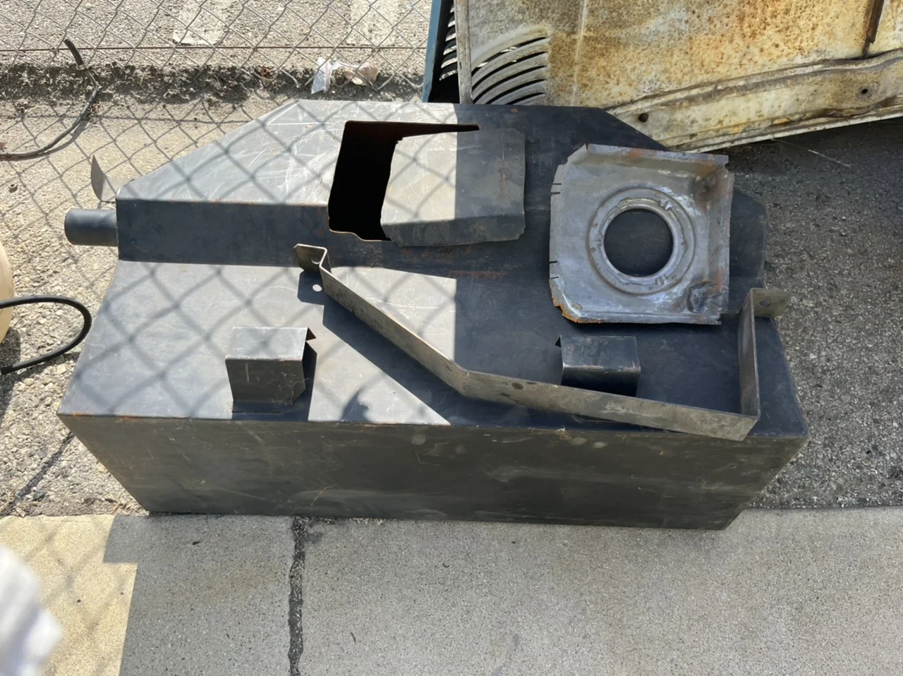

Mike, with the cost to build that custom tank, I would think hard on the LRA underseat option. Out of the way, and more than enough fuel for your needs.
Or start with something like this and cut/weld until your happy and it doesn't leak
I had that tank before. The main issue Is that I’ve moved my fuel filler to the rear and it’s painted.

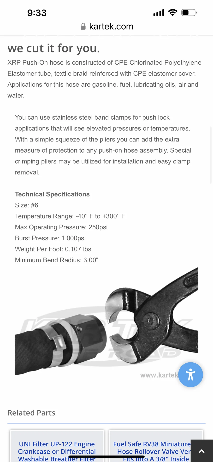

I like the XRP hose with Fragola push lock AN fittings and Oteiker clamps as a safety measure to keep the hose on…
Kartek sells it all. I have used cheaper rubber push lock compatible fuel hose, and it deteriorates and cracks like any cheap china fuel hose. Pretty pissed actually, i had to re-plumb my whole fuel system last year due to junk hose from a very name brand supplier that only lasted 4 years. Have friends that have been running the XRP exclusively for many years with zero issues.
Thanks, Evan. This is exactly what I was looking for. I want this stuff to last and they seem reasonably priced.
Do you run this same line for your return?
Do you have any recommendations on the Oteiker clamp tools? I thought that I had one but it’s not looking so.
Yes, supply and return is now all XRP hose. The clamp tool is about $40 from kartek, im sure amazon sells a knockoff or cheaper model. I run -10 to my fuel pump inlet, -8 from pressure side to pressure regulator, -8 from regulator to fuel rails, -8 crossover between rails, -6 return to tank. It is likely fine going -6 for all of your hoses.

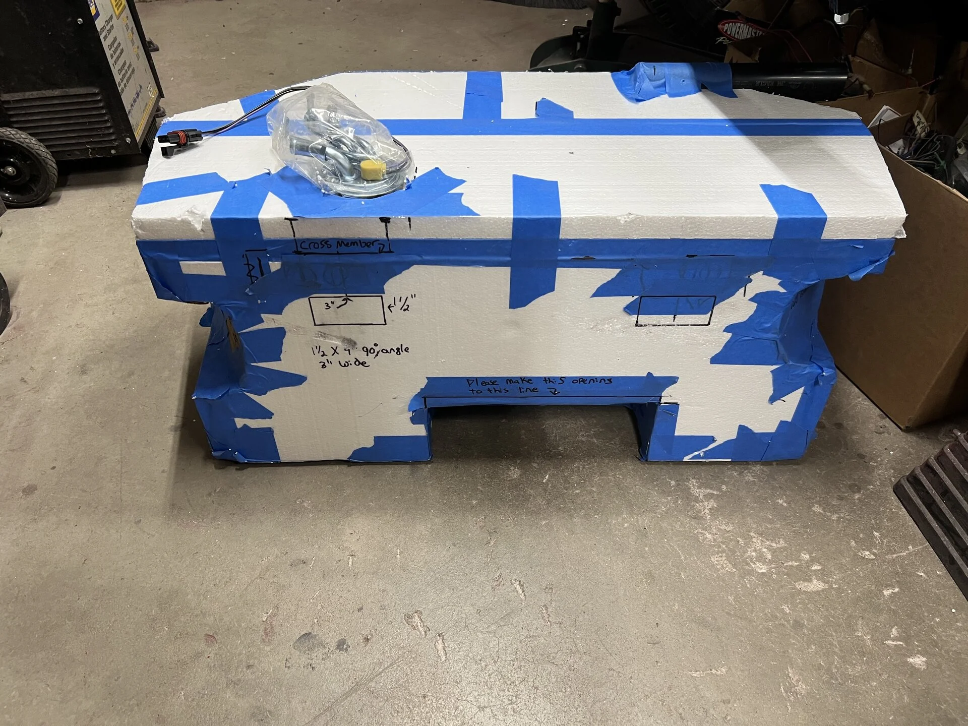

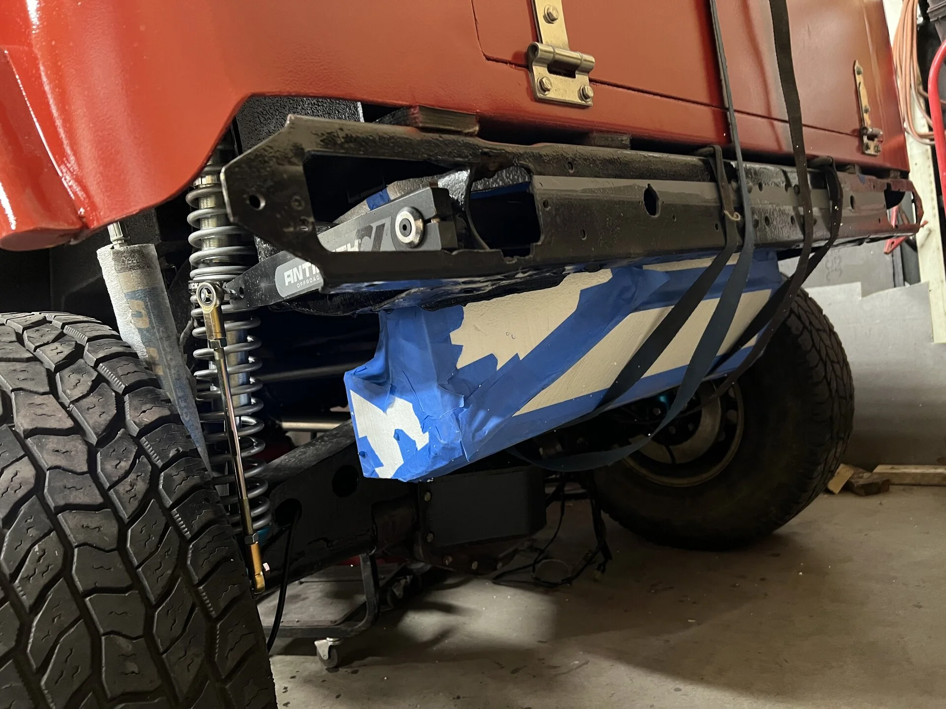

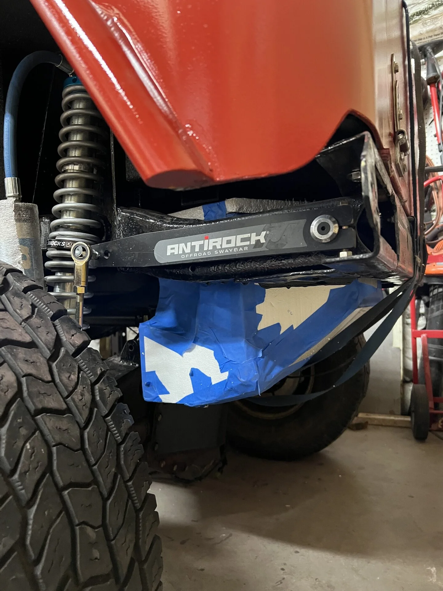

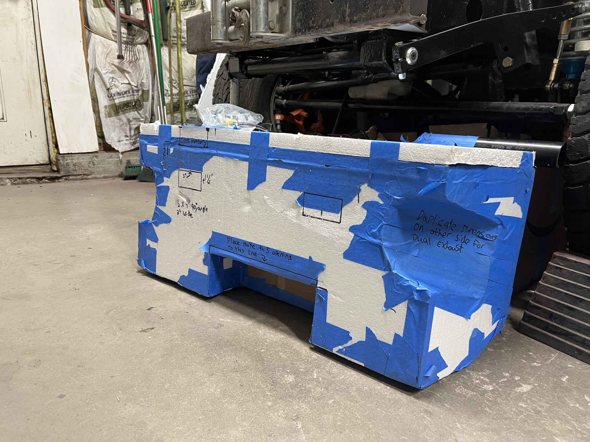

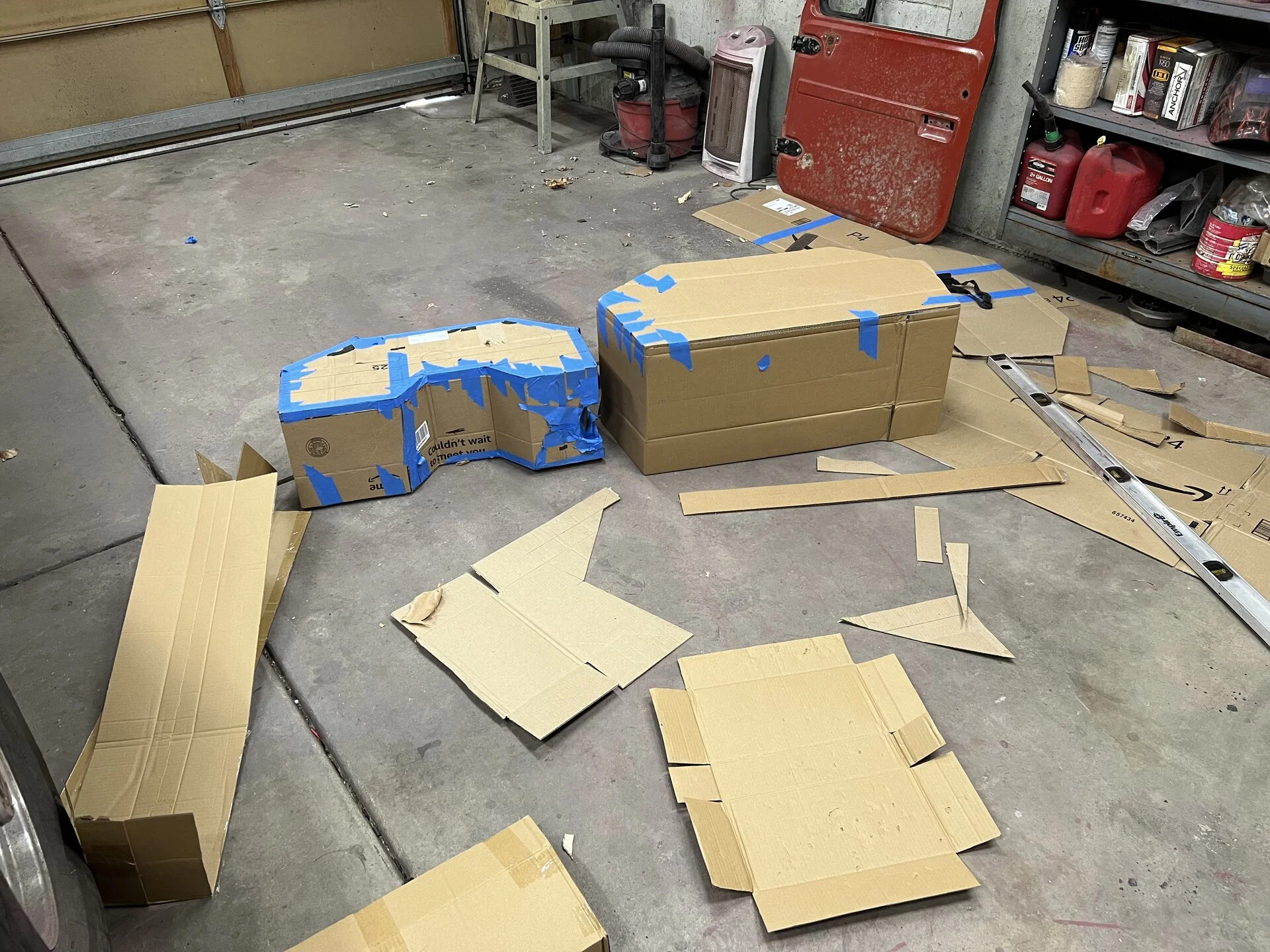

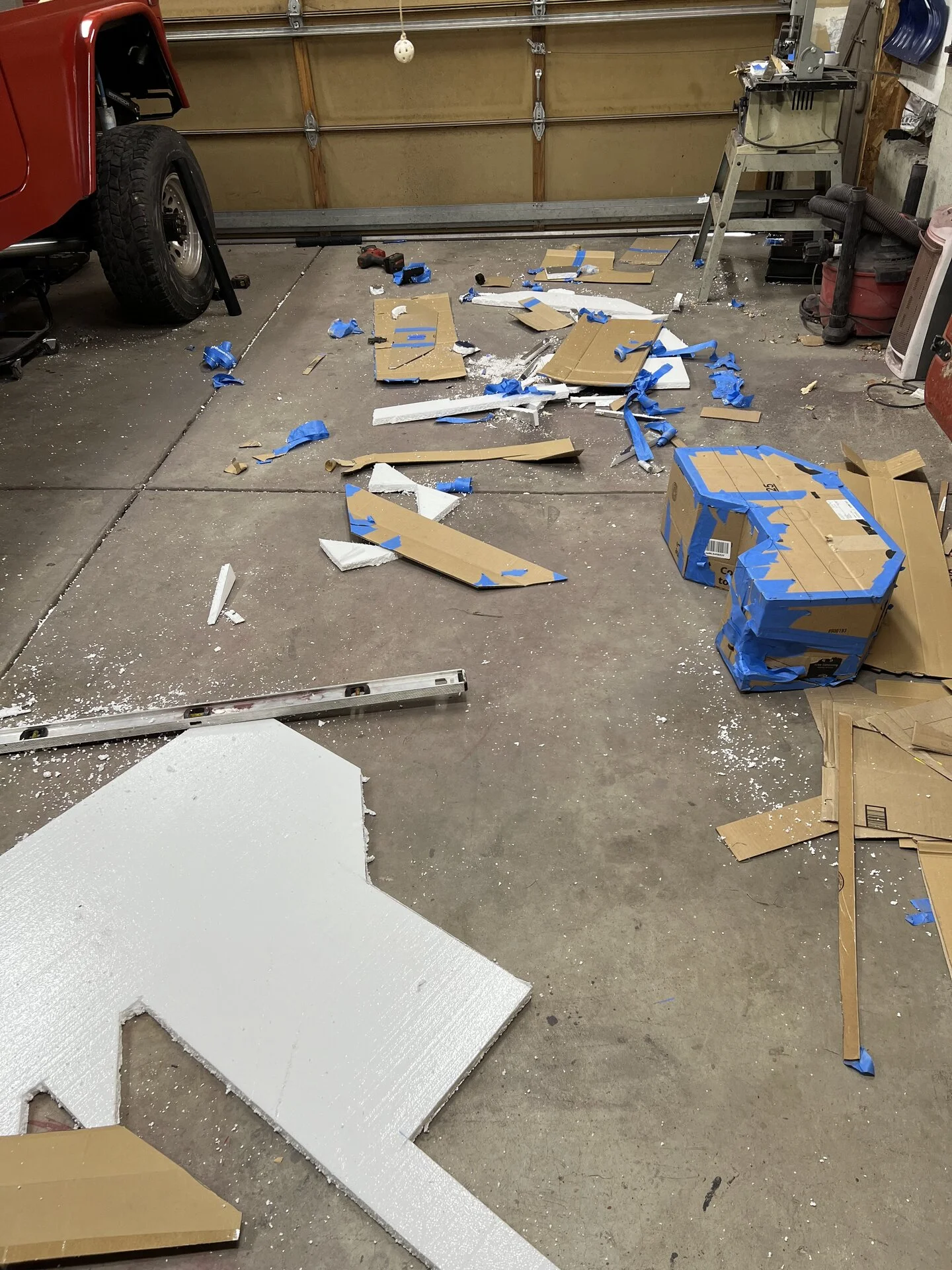

It was chaos today but I have a very good end result (mockup #3!) that should provide a solid mockup for measurements. I changed the design a bit so the above measurements are not current.
It got a little out of hand today.
P.S. I have the S-10 in tank pump housing in the mockup. This was here before @EWheeler ’s suggestion to use a different style pump. I’m still open to hearing the pros and cons with this setup and I have 2-3 weeks before it will be built.
I plan to finish the throttle pedal and miscellaneous wiring next weekend, then I need to wait until April paychecks arrive to get more parts coming so I may be somewhat silent in late March. The cooling system will be next in line once the fuel system is done.
It was chaos today but I have a very good end result (mockup #3!) that should provide a solid mockup for measurements. I changed the design a bit so the above measurements are not current. I’ll let JWF hit it with a laser and I’ll report back the measurements later.
