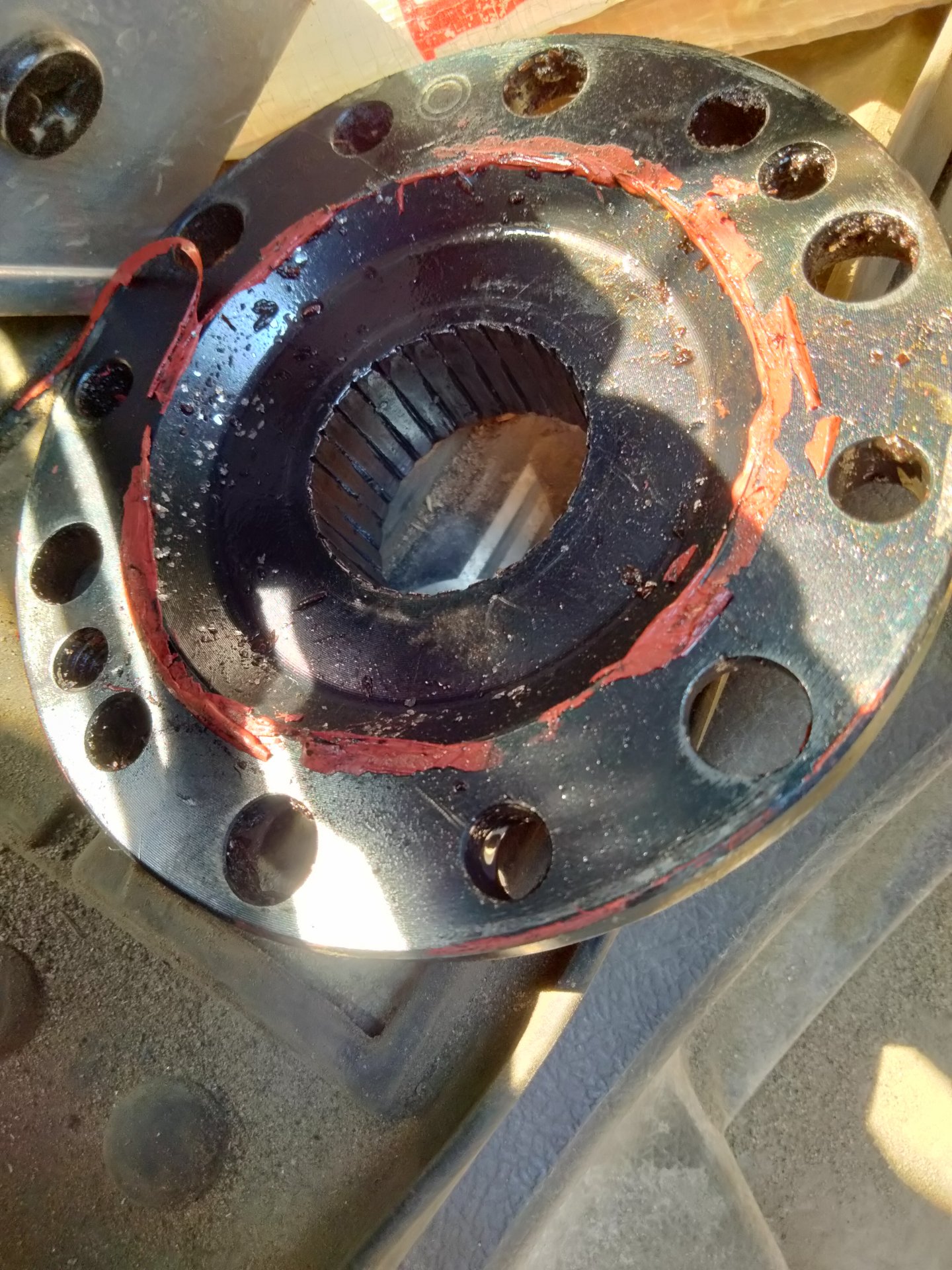

Dang! Are those the RCV flanges? Saw a video of you on Instagram. I think you need a rock bouncer on some Rockwells :D
yes RCV 4340. haha that video is my buddy driving the truck. I gave him the keys to have fun. He took the truck out the morning after we fixed it after he rescued me and brought spare parts from my house. I just stayed at camp and took the kids to the lake to play in the water. I was beat and tired after nearly 24hrs no sleep and hard wheeling just to get to WH3.
I do not drive my truck like that. He did damage my qtr really bad too but whatever. he rescued me and my truck with parts.
