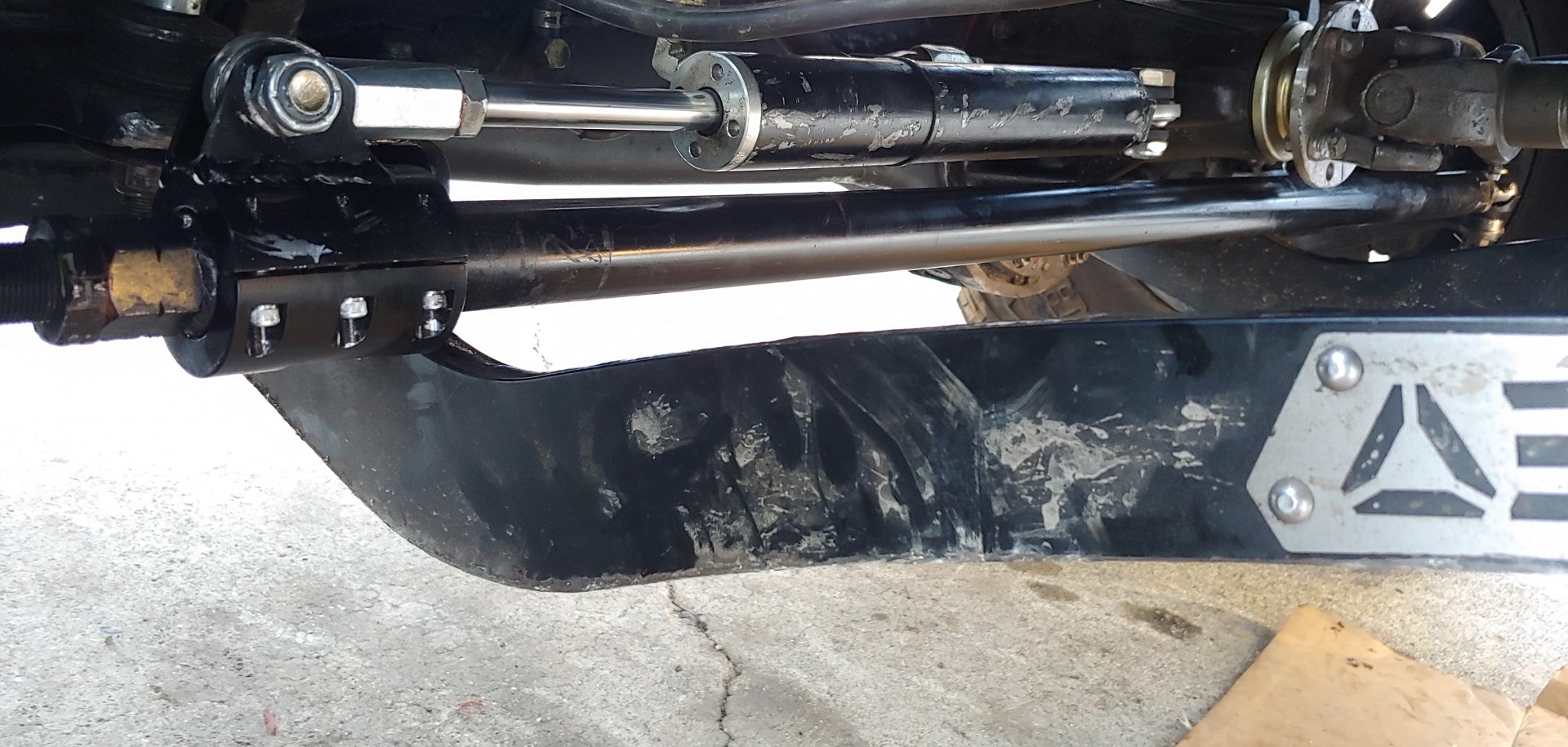

Also bent my Slee tie rod bar ar Rubicon.
This bend was significant and took a lot more press work to get it close enough. I will keep this as a spare bar.
I have brand new weld on bungs for my 1.5 .25 wall Ruffstuff bar. Cutting to length and welding on shortly!
Need to weld my hydro tabs to my Ruffstuff clamp for double shear strength
The MT rear lower links use a 1.25” shank JJ as opposed to TT using the 1” shank JJ. You took a step in the right direction in my opinion.
Tie rod welded and painted. Ready for remount as soon as it dries.
Trail Tailor now reinforced with Ruff stuff tube plate. Total thickness is now 1/2 thick.
Wondering if I should reinstall these onto Crawler80 and move the Metaltech onto Turbo80.
Or just sell the Trail Tailors to recoup some money
New tie rod bar in with new hydro clamp installed.

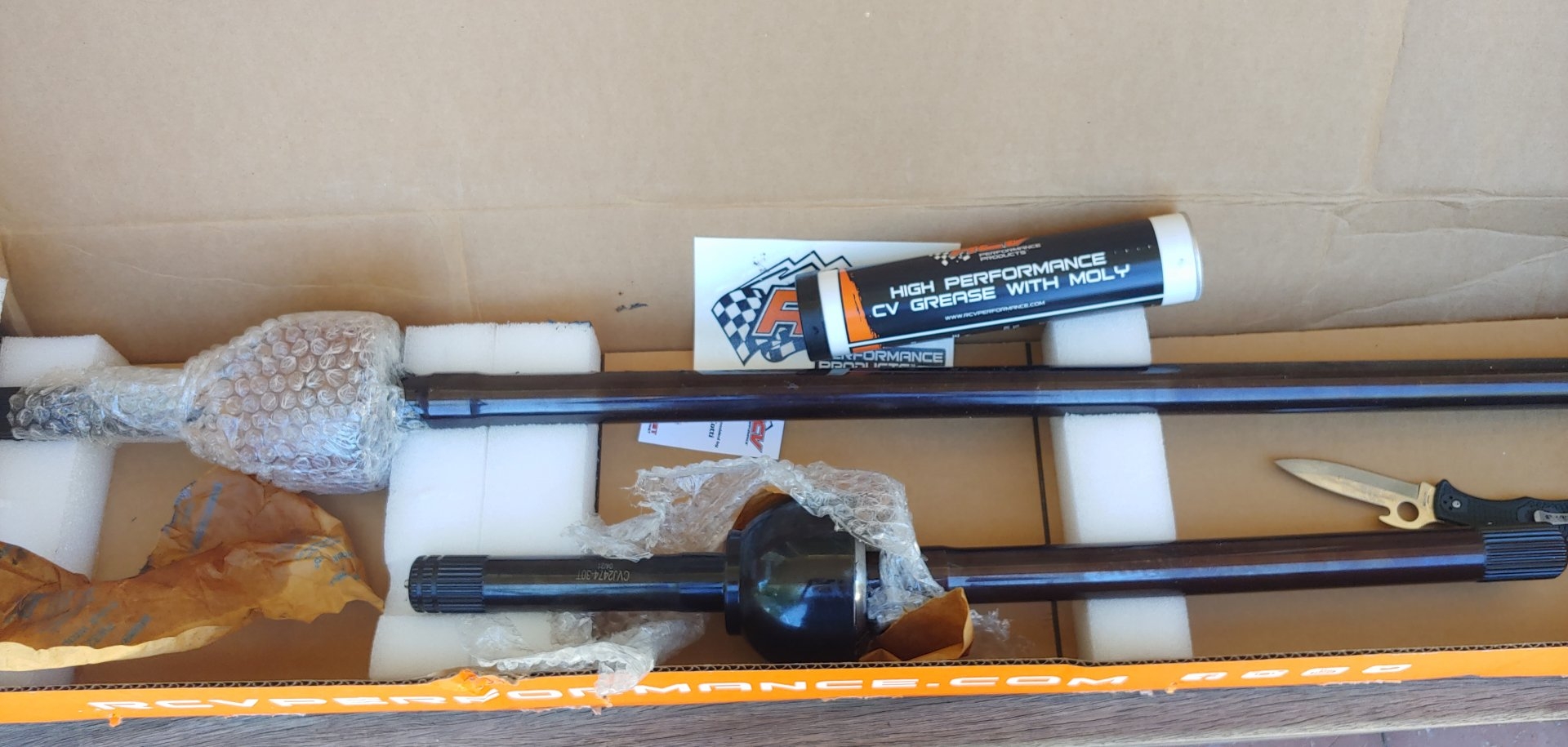

Did a lot of work today. Still need to remove 30mm spacers and install my front RCV 300Ms.
Rear 300Ms are still back ordered.
Also rewelded a broken exhaust hanger. I will do a frame over exhaust after Rubithon event. That will be enough time to get that done before Sierratrek event.
Removed 30mm spacers from front and rear. before and after shots of measurements.
RCV 300M installed in front. Those stocks did 1 trip at Rubicon with 39s. Impressive how they hold up to massive tires.
300m rear still on back order. Waiting for them.... Wont be here in time for Rubithon though.
