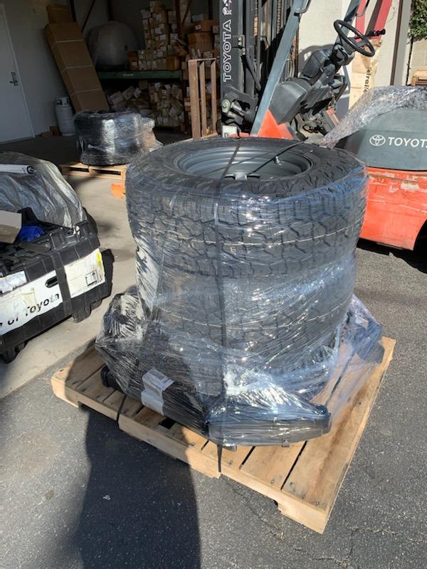

Bought some rough country rims and went with some Roughcountry Steelies 17 inch rims spec’d for an FJ Cruiser, but fit the 60 perfect. New Falken Rubitrek A/T P285 70R17 or 33 inch tires for those who still can’t wrap their heads around the ratio thing… Load Rating E for the full floater.
