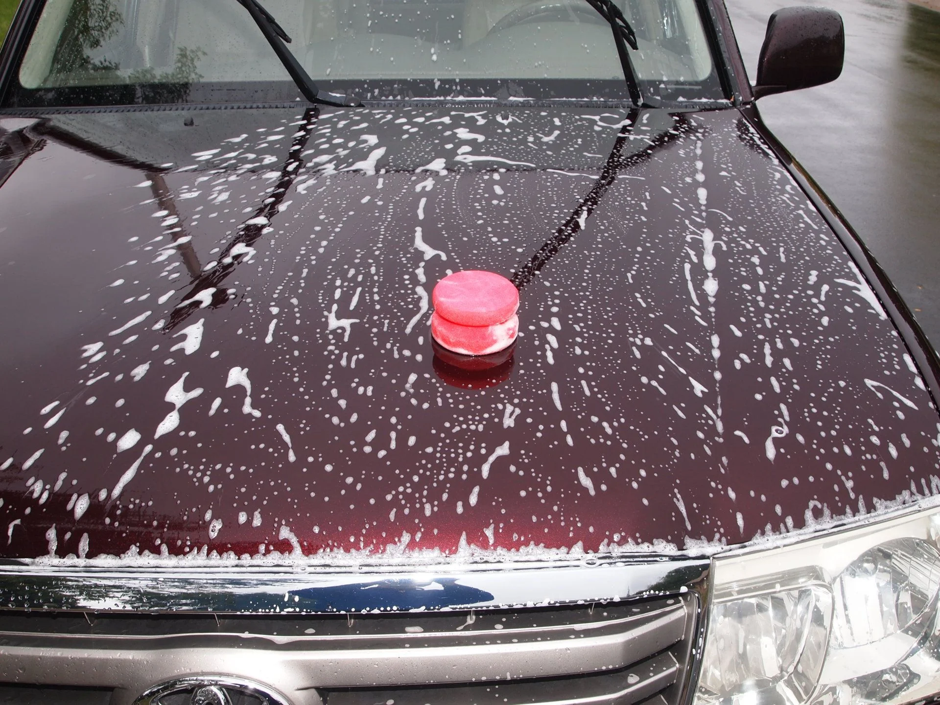

I couldn't wait to get started so I was in the rain today cleaning and using a synthetic clay bar. The cold weather and rain aided in clay bar. I used something (new to me) a synthetic clay that is used with car wash soap for lube. I'm impressed so far. I did plastic bag test before and was grainy, after one pass with syn clay plastic bag test was smooth.
View attachment 1543358 View attachment 1543359

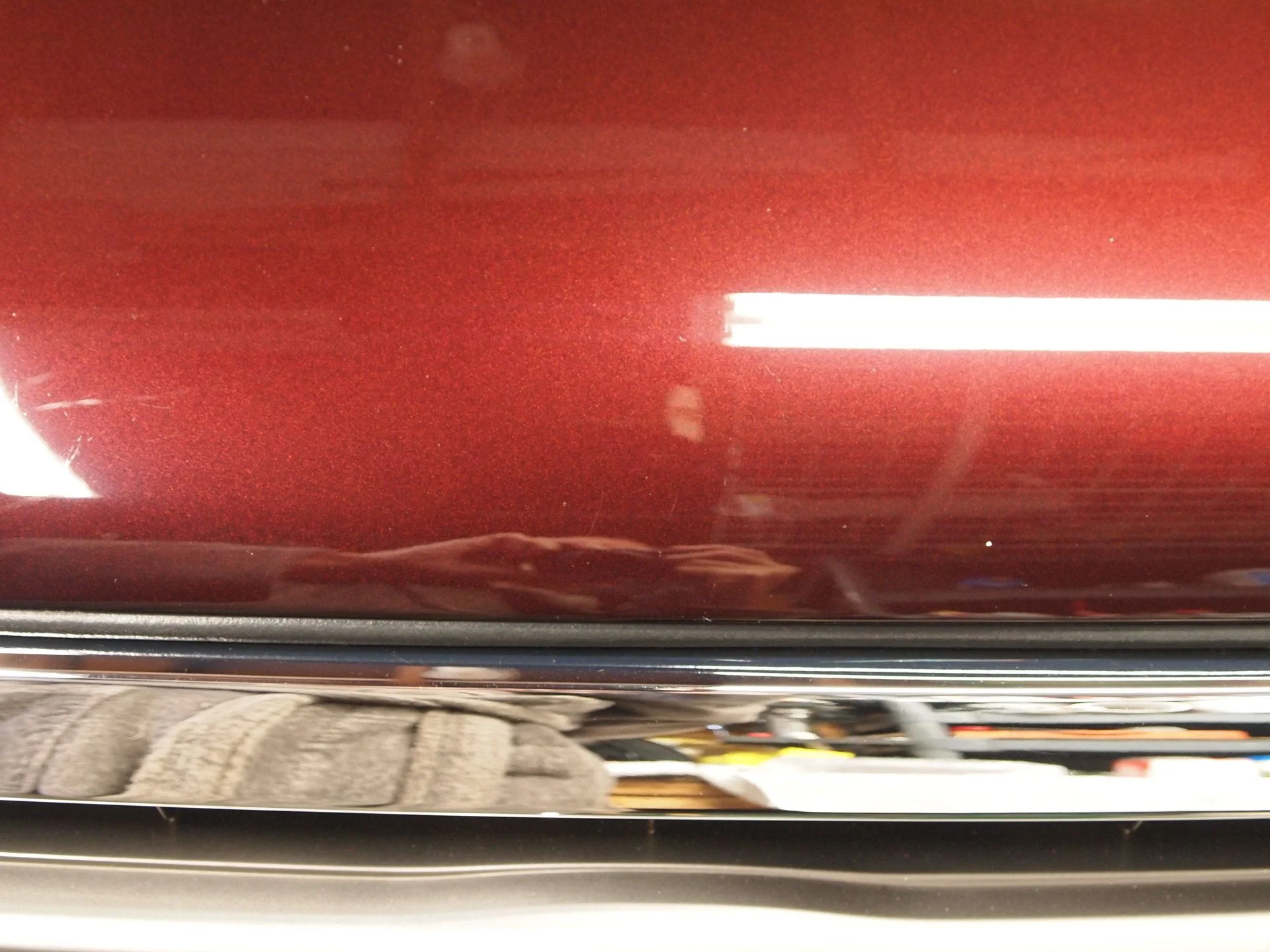

Paint as I said is a 9, but looks like it will buff well, maybe to a 9.5. I'll cut with correcting compound and micro fiber pads on my DA buffer then wax. I'll come back with touch-up paint when I can get it if needed. Touch-up paint has been taking three week to come in, I'll order in the morning.
View attachment 1543361 After first cutting with Meguiars micro fiber DA correcting compound & cutting pad. I'll touch up then final cut & waxView attachment 1546541

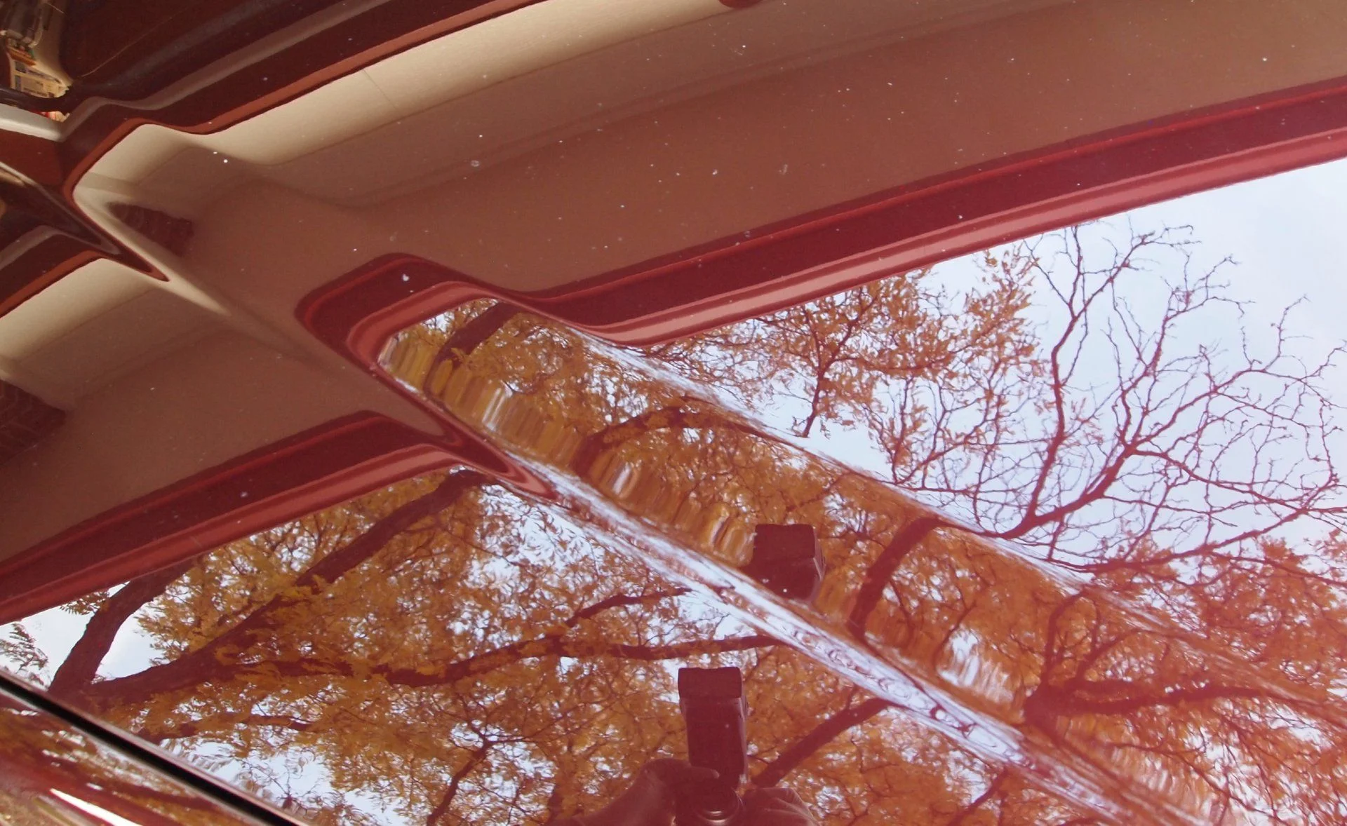

The windshield is and issues in the 100 series. If any paint bubbling seen, even the tiniest spec if found around windshield you can bet rust is starting to take hold under molding/windshield. The sooner you address the less damage to deal with.
I took mine to a body shop and they said it's not bad enough to deal with,,,wrong. Although rust did not perforate metal "yet" it did leave some pitting once ground out.
Obviously the older the rig the more chance of rust. But it seems this is less of and issue after 2005. I say this not due to age, which obviously plays a roll, but Toyota may have made some adjustment to the manufacturing process. Toyota settled a "rust" class action that only 2005 and up can make a claim from what I've heard. I've notice bare metal chips in paint on the 2006 & 2007 models, don't seem to develop rust as fast as older models. This makes me think Toyota legal team navigated the cut off date carefully.
The argument of why we have windshield rust issue is two sided. One side says it windshield installers, the other states it a design issue. To date, I've only seen in windshield that have been replaced. It's not to say factory installs don't have any issue. It just what I am seeing, is, installer nicks paint during removing of urethane with a razor blade. The body has some bump out along roof line under windshield molding (6 in all) and tight spaces along sides and roof line that are hard not to nick. Any nick not treated, no matter how small, will start the rusting process.
Newer vehicles have been design more open and flat under windshield and around molding. They also have less molding. This make windshield removal easier and less like to be nicked. So design was changed. So do we have a design issue, yes in this respect.
The another design issue has to due with three things: The metal, paint and design. Does the 100 series lend itself to rust around/under windshield organically, perhaps. If those here in mud that have factory windshield report issues with rust or not we would then have data points to gain a better understanding.

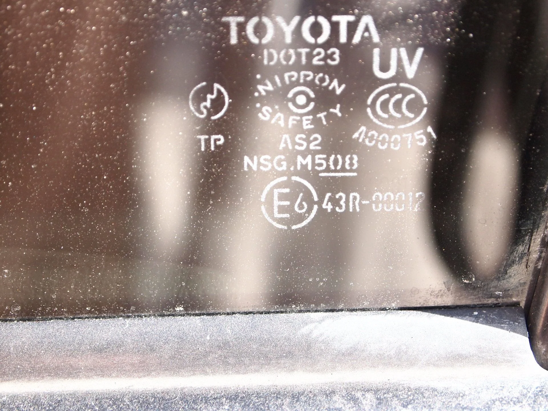

It seem I've factory UV tint on front door drivers window.
I was under the impression Toyota never put tint in front side windows.
I notice while driving north in the afternoon through a desert, the sun didn't feel hot with window up, but was scorching with it down. Yet the glass is easy to see out of in day light and not bad at night either. The tint is in excellent condition
I've not seen this UV before on a 100 series, much lees up front. Nice stuff.
I've not seen this UV before on a 100 series, much lees up front. Nice stuff. View attachment 1552127
I've got the same glass on my front driver & pass windows on my 05. I did put 30% ceramic tint on the windows anyway.
I just never noticed but they all have the Toyota UV. The Black Knight also has the addition tint as well. Interesting the PS Toyota UV stick is reversed so can be read from inside.

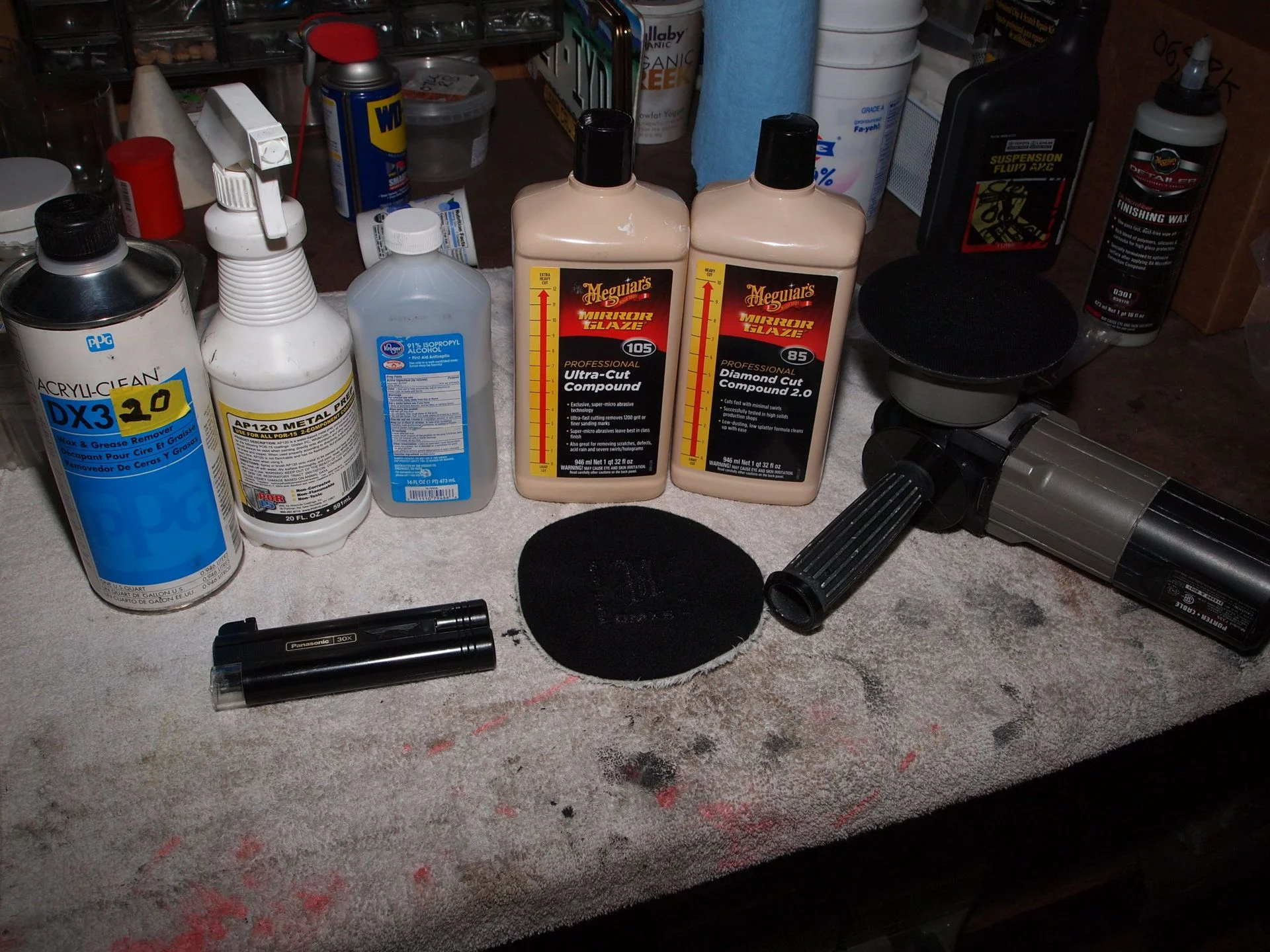

Anyhow I needed some advise on best course of action. So I called Detailing shop out of SoCA. After a few dials, I was very blessed to find Courtland Courtland’s Auto Detail | Car Detailing | Glendale, CA This guys has been detailing for 30 years in SoCA. He's really giving me some helpful advise on dealing with contaminants in paint. Stuff I just don't see in Colorado. I've not yet tried one of his suggested which is Wire Wheel cleaner in spray bottle, as I've yet to find one. I did see Mequiar's has a Chrome Wheel cleaner pro strength that mentions wire hub cap in it's uses. This stuff does stated keep off clear and or paint, so testing is needed. I have tried the 85 cut he suggested and getting good results.
With my first order of the day being to protecting body metal which paint does, secondary is beauty. So I've armed up with some more detailing supplies. Some giving some good results to task at hand. My biggest gains are from 105 cut, POR's AP120 Metal Prep, Rubbing Alcohol and Meguiars 85 Diamond cut. The 105 and then 85 are more aggressive than the Micro fiber cutting compound. In fact 85 is made for a rotary buffer with wool pad. I've only a 5" DA Porter cables, so bit of experimenting was need. I found using a heavy cut micro fiber pad which has almost no backing worked best. The standard micro fiber cut pad with foam back just separated with the grab of the heavy cuts. The tech at Finishes Master (Auto paint supply store) recommending using a slow speed with the 85 Diamond cut compound on my DA. But that did nothing with my DA. Dialing up speed to what I normal use (4,800 RPM) to cut and started getting results.
I could have saved time by going with a 3M sanding kit. They run in the 3000 to 5000 grit range and are pricey, and I hear do wonders. They only take little more paint then a cutting compound off. I may still give it a try.

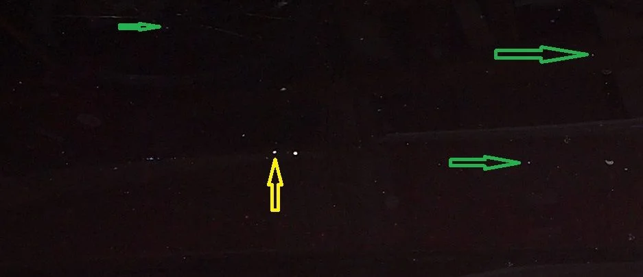

Very hard to see what I'm dealing with. Takes just the right light then my 30X microscope to see the microscopic particles.
Two lager chips are just that chip down to primer, that just need touch up paint.
Yellow points to chips. Green arrows point to specs of contaminants in clear coat surface. It's believed these are lime or calcium. The AP120 Metal Prep followed by high pressure water cleaned out larger chips and scratches. The microscopic specs seems too small for the chemical I have to penetrate, but I'll try again now that I've cut with the 85. Some you see are just dust on paint.

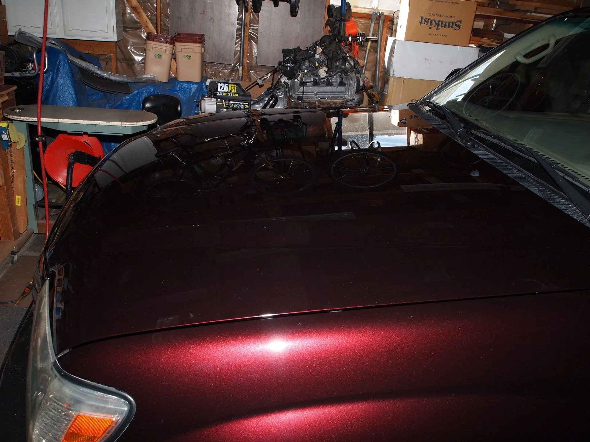

I've been working the paint a bit more as weather permits, getting cold in the garage.

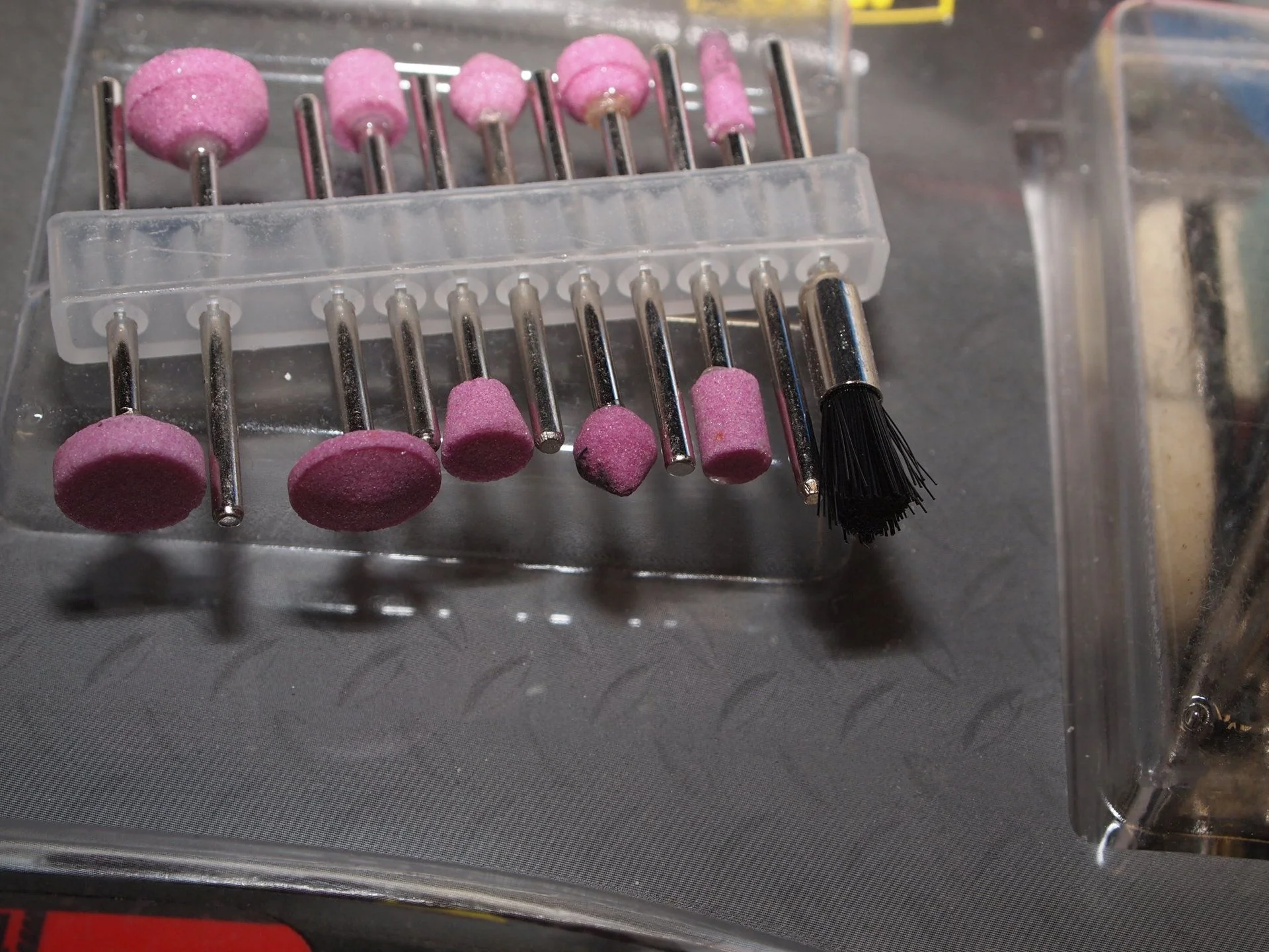

Found about 4 chips or scratches in paint with mild rust which was only visible with my 30x microscope. In effort to keep grinding area a small as possible I found a few new micro bits stones (pictured) and diamond needle points (not pictured) even smaller than I've been using. I keep look at work area with 30X then grind a little and repeating until I get a good clean line between factory primer and body metal.
After grinding only chips that I had to, I cleaned hood with AP120 metal prep and high pressure water. This did and excellent job cleaning out the compound and other contaminates from chips. It also etches the bare metal and remove the very mildest oxidation from exposed metal surfaces. I used some WD40 in bare metal chip to stop any new rusty, until I had time to paint. Cleaning out WD40 before painting of course.

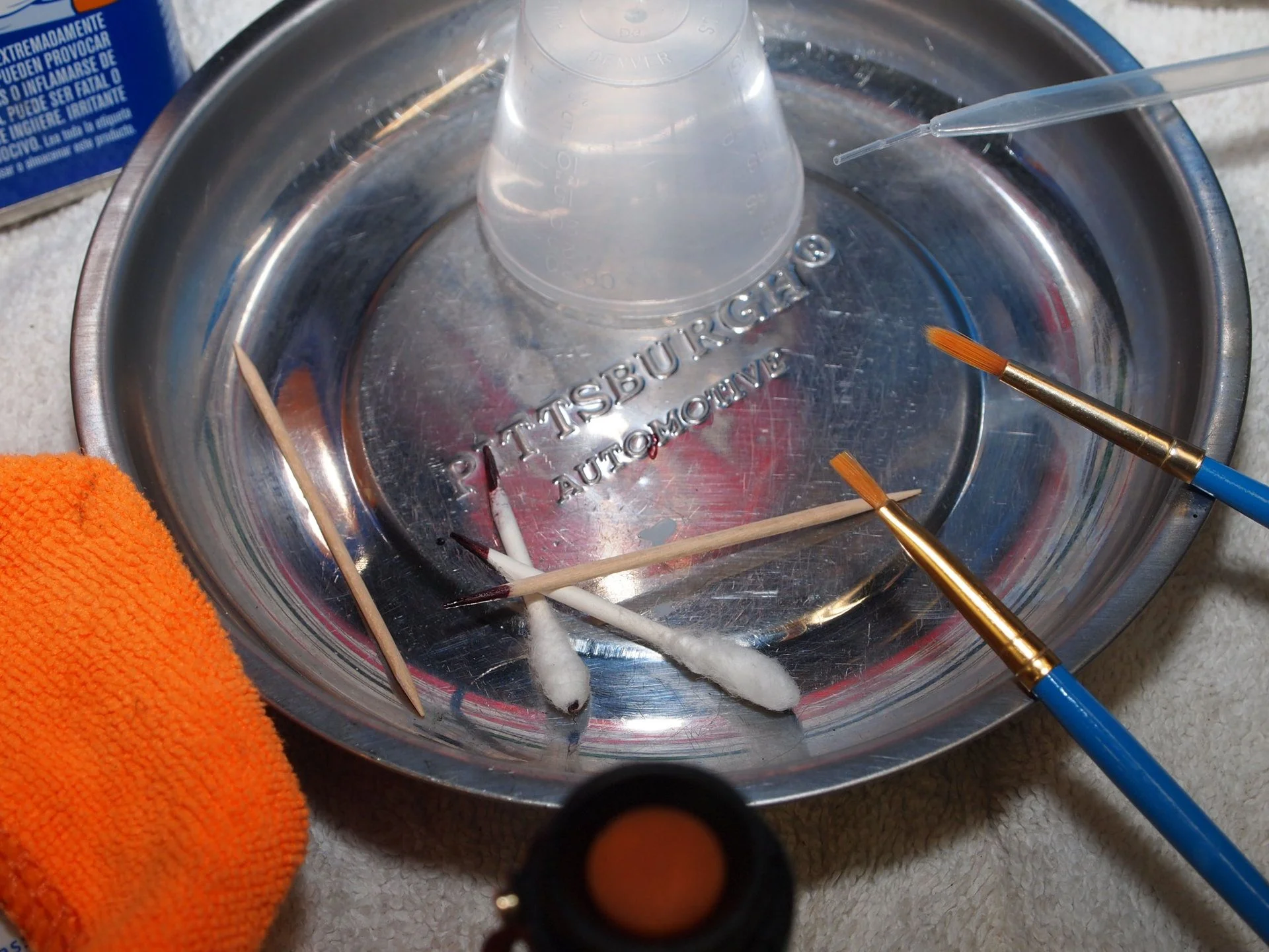

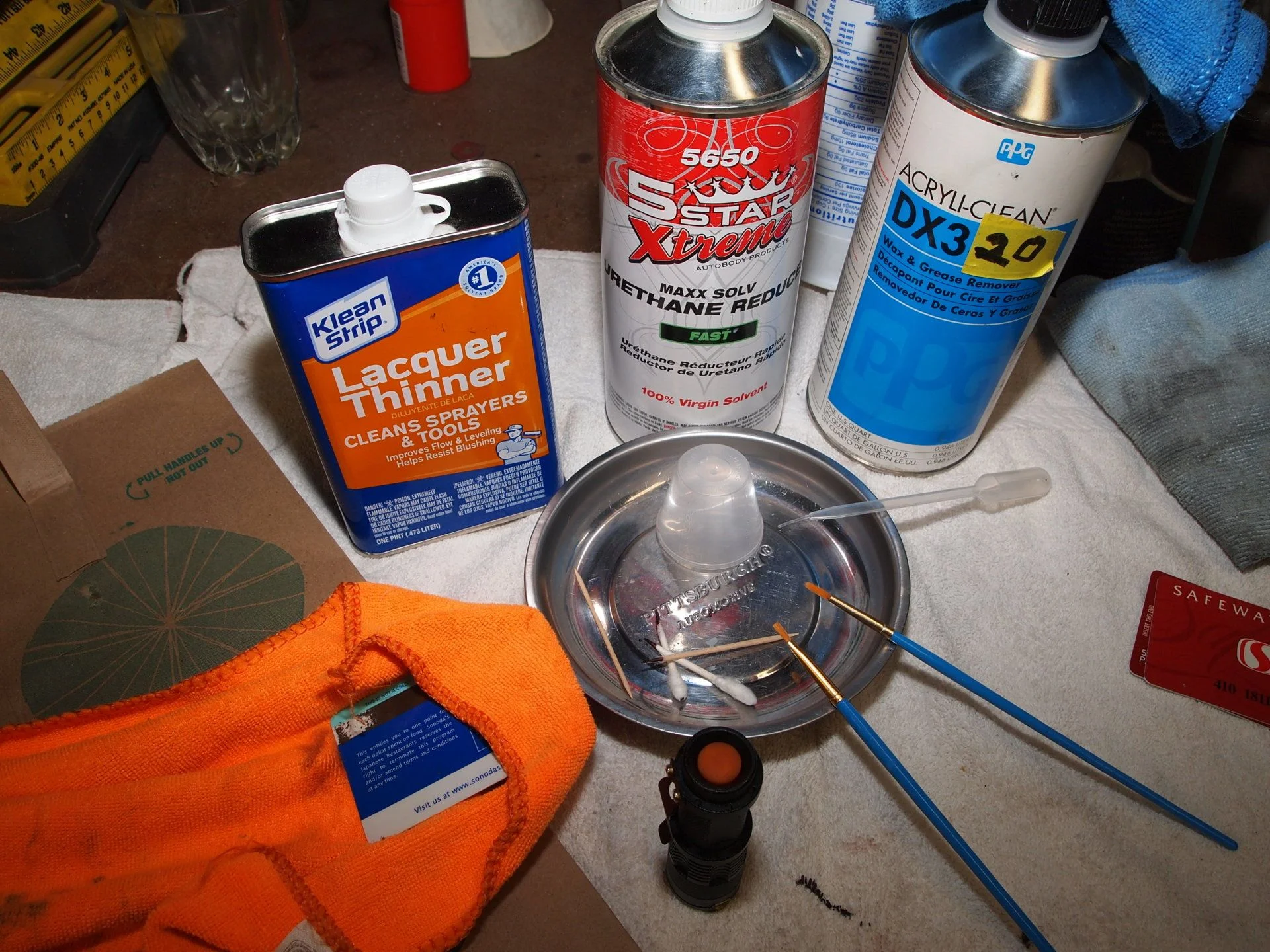

I've now started using a few paint brushes out of a kit of ~30 I bought for $3 at a craft store. The fine tip give nice follow control. Using cut Q-tip paper stick is my most used. I've use tooth pick now and then, but follow doesn't work as well as a cut Q-tip for me. I cut papaer stick of Q-tip to either shape point or flat as needed.
I've been using a micro fiber rag soaked with a little Lacquer or Reducer with credit card or tip of a Q-tip cotton or paper to level and or clean excess paint. Something I've been experimenting with opposed to sanding. I avoid sanding if at all possible. I'd rather the touch up be more noticeable then cut through the clear paint with sanding. Touch up is for protecting body, not a substitute for new paint job IMHO.
Sometimes I reduce the paint, sometimes I let thicken depending on flow I'm looking for. The cotton end of Q-tip can be used to soak up a little excess paint as needed, but only if paint is very thin (reduced).
I always start with self-etching primer on bare metal. Even if i see just a microscope chip through factory primer to metal, it gets SE primer.
If i mess up I just wipe out paint with lacquer, or Reducer is it has set-up longer. Both must be use with care (don't puddle or let stand on paint) or factory clear can be damaged.

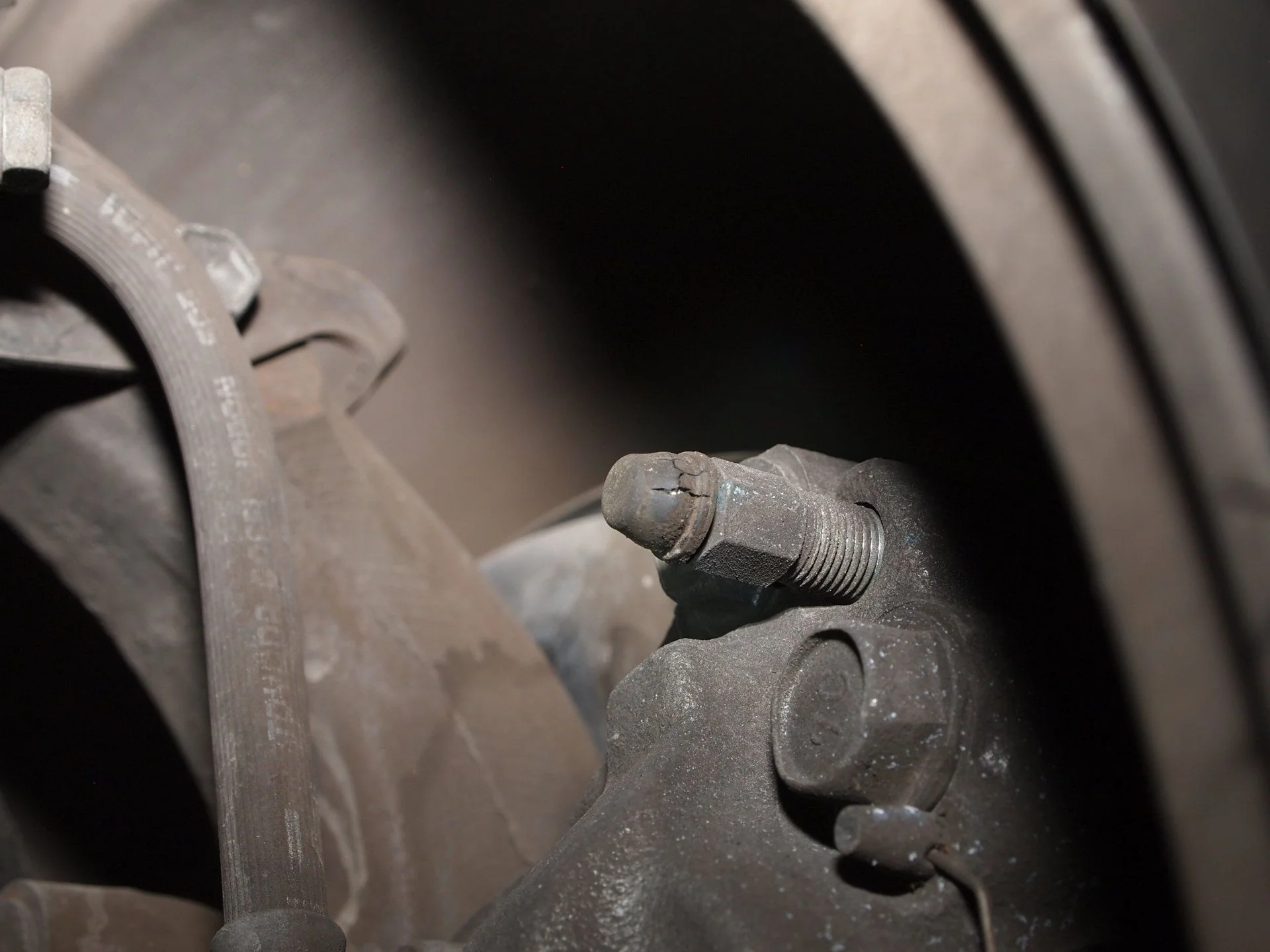

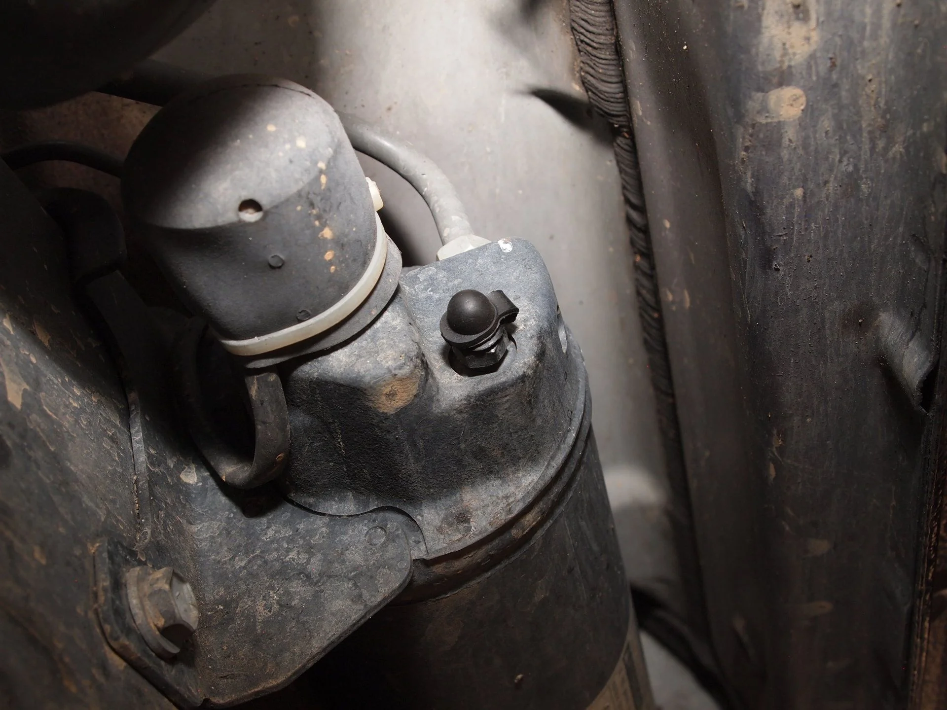

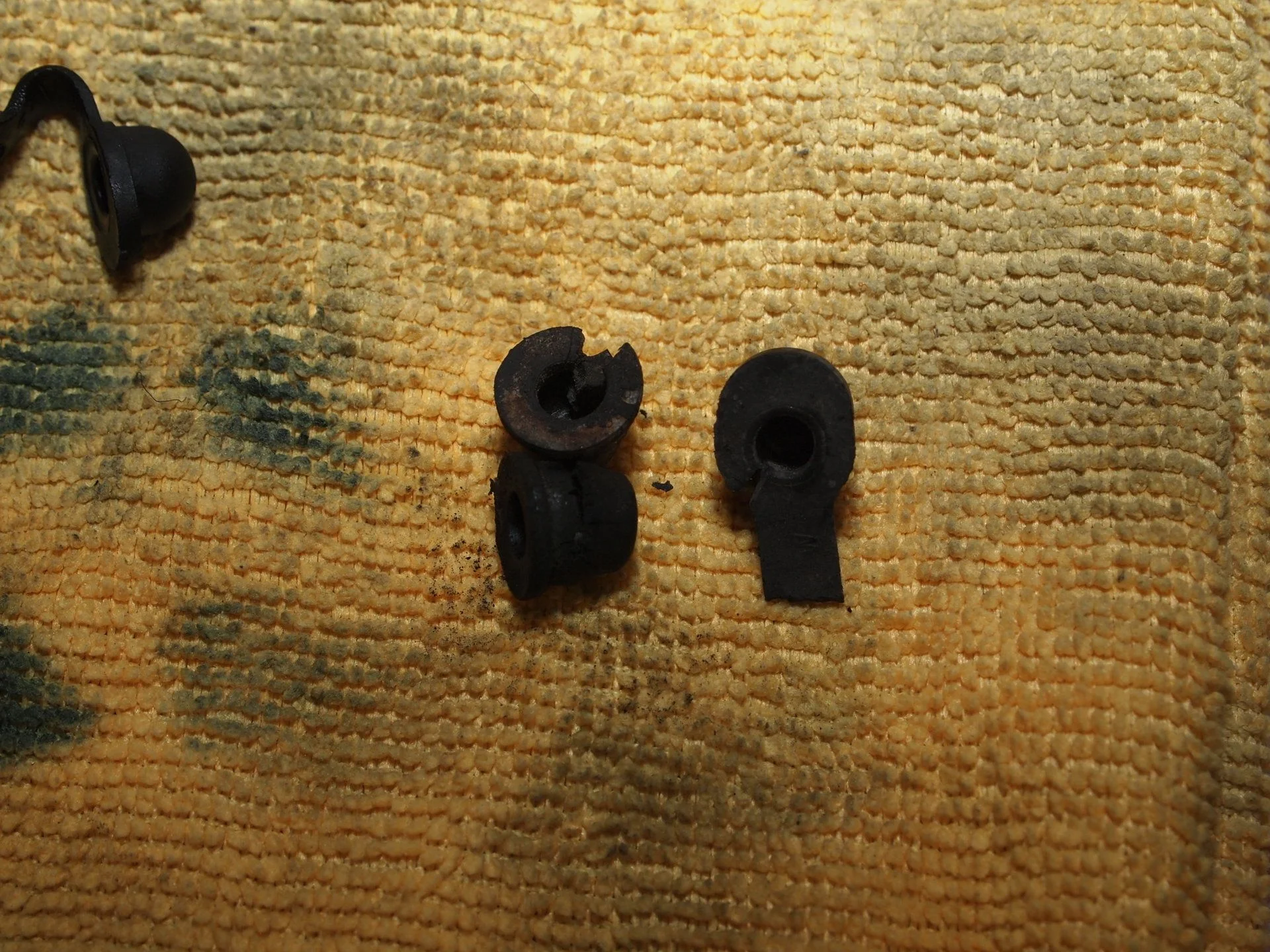

I finally started doing some post purchase inspecting and mechanical lite work.

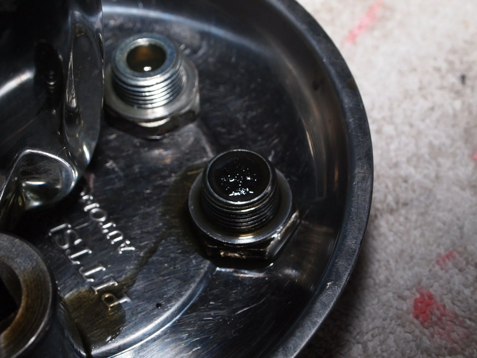

First off is replacing bleeder caps, they all needs this. These $2 parts can save major expenses down the road. I now try and get these replaced before even washing undercarriage.

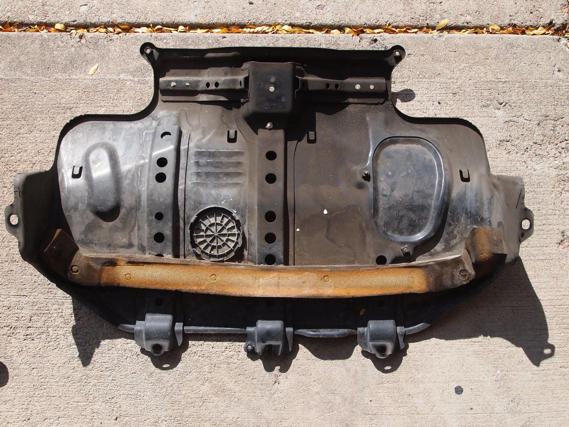

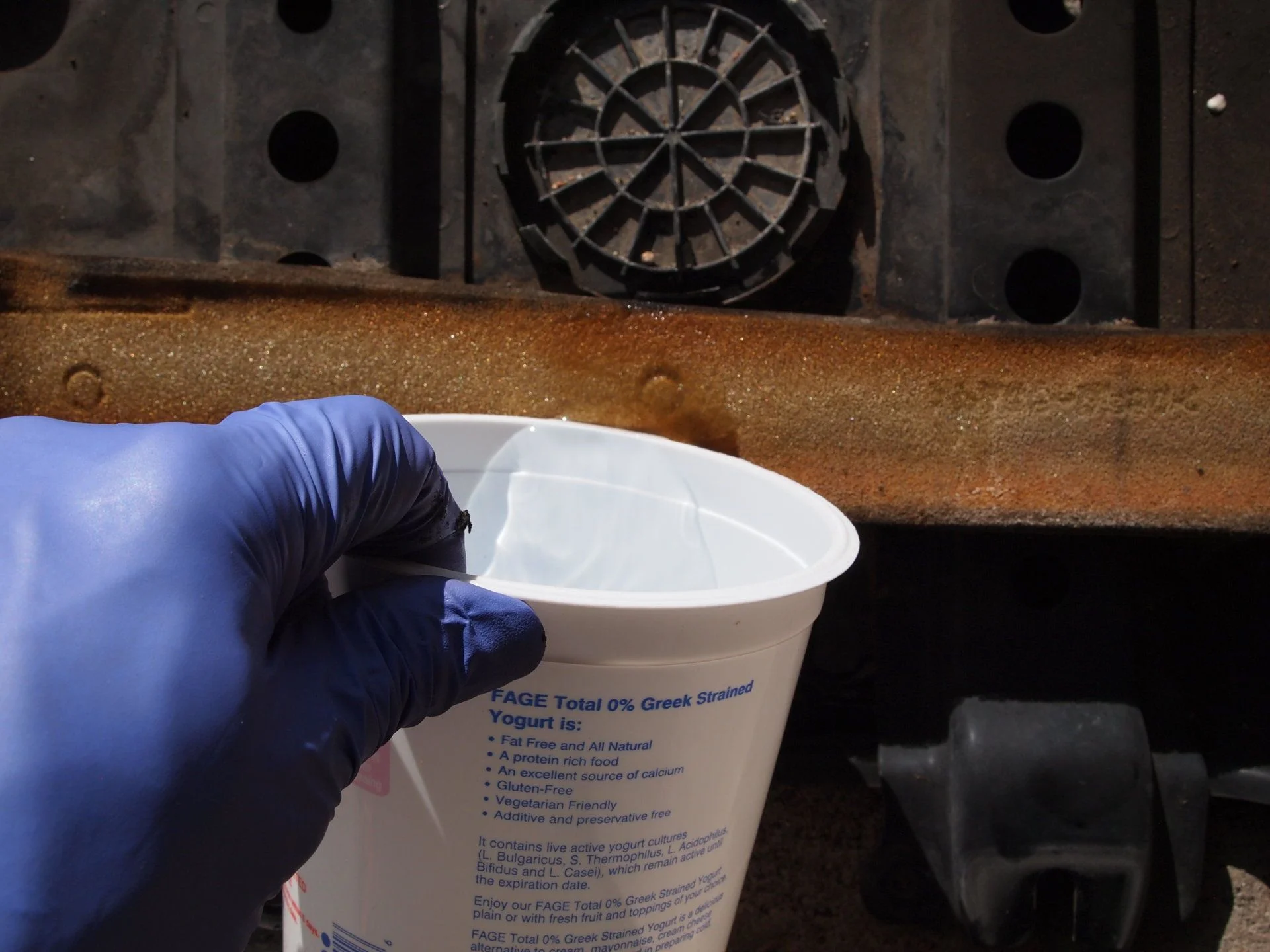

Removed the skid plate and test the foam for water permeability. It failed as usual as water enter cell of foam, new OEM will repels water. This will cause skid plate to rust out so a remove. Toyota tech supports states it's a vibration dampener. Is this necessary- Skid plate foam pad?
But I think engineers intended as a dame. A dame for air, dust, snow and water. I've been leavening foam off but not a bad Idea to replace if you drive in rain or dusty condition. Drive belt slips if wet, but wet condition and foam holds water promoting rust of skid plate. "Six of one half a dozen of the other," as they say.

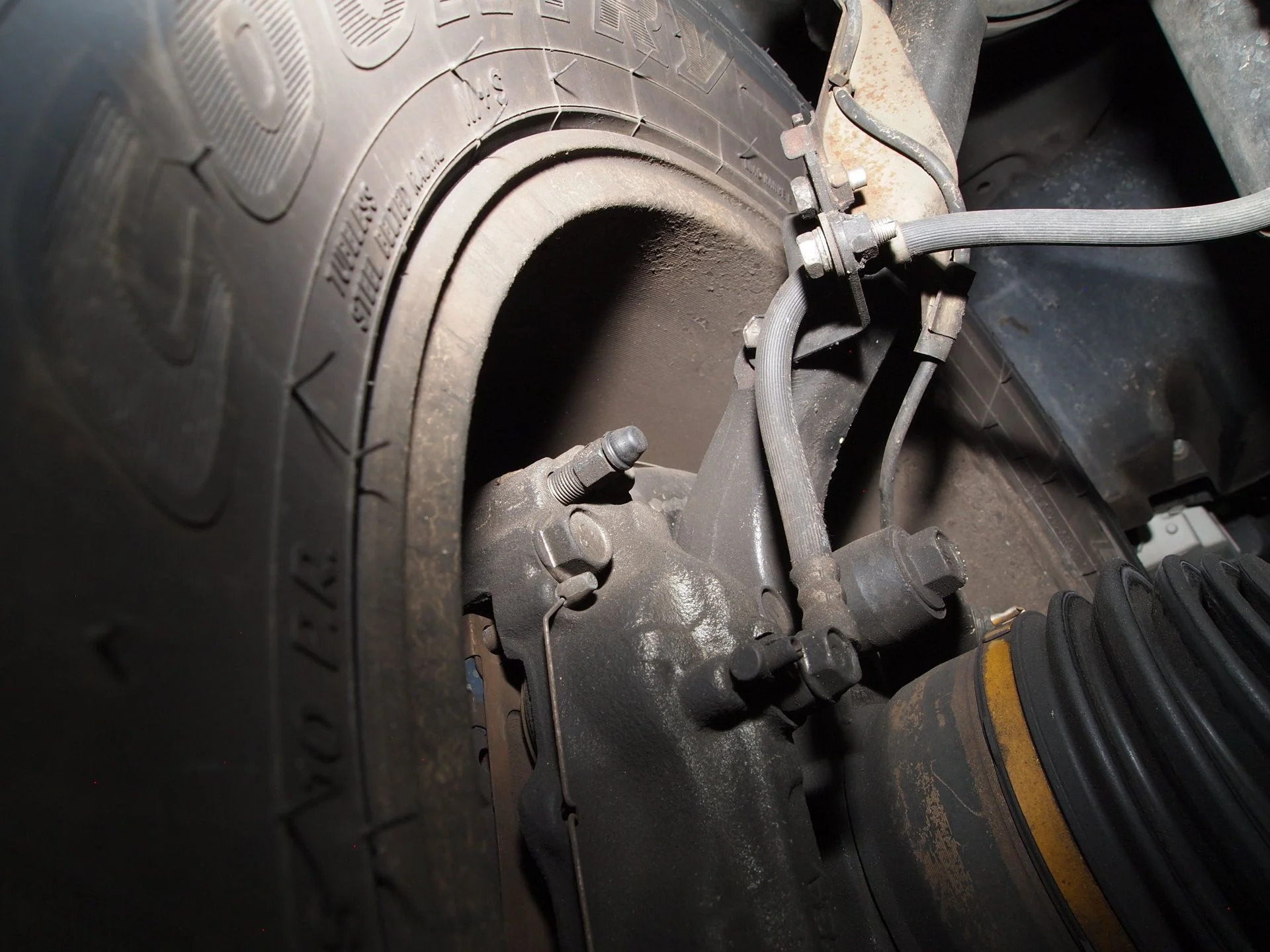

Also pulled the #2 shield and engine cover. I'm looking at undercarriage covers for signs of leaks. The little bit of water stain and white trial is from me cleaning battery with baking soda to neutralize acid. So it was spotless!
Remove moving all the cover for inspecting undercarriage end to end for leaks, damage, broken or missing parts is a must.

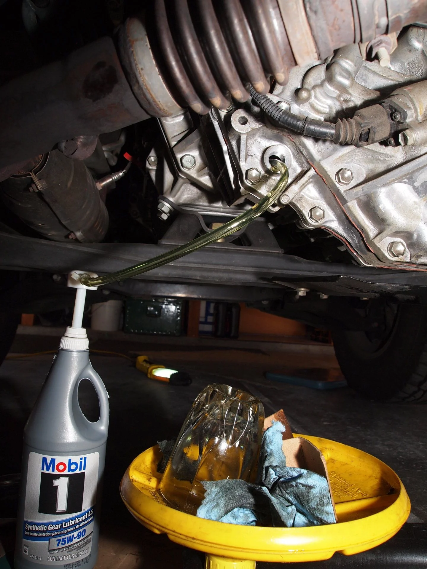

I also did some flushing of fluids. History records show they've been flushed, but still I like to baseline and see for myself the conditions of fluids. So far I'm very pleased with what I'm finding. Little things like drain & fill plugs at proper torque and with new washer, job done right. It these little clues that speak volumes about a particular mechanic's job or area he worked.
Transfer case lube was darkening as one would expect at about 13K miles.
As always let sit for 5 to 15 min. after lube starts running out, then add some more until runs out.
