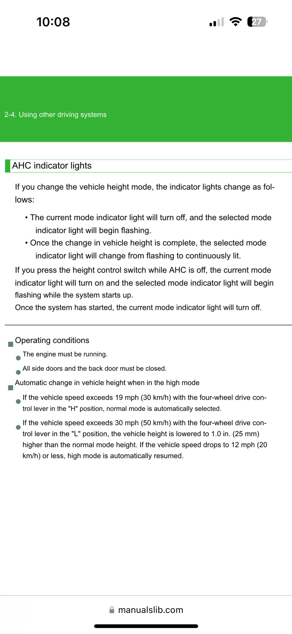

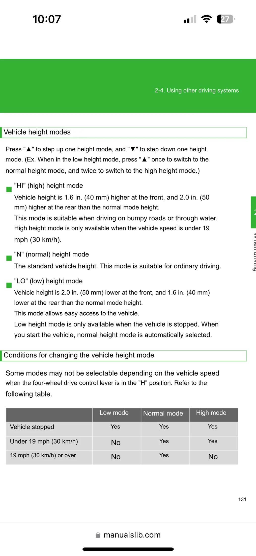

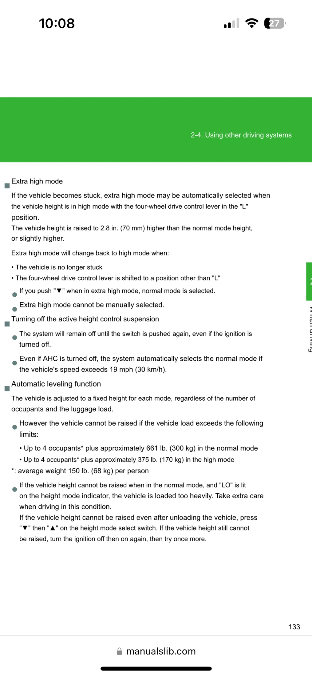

I read somewhere the vehicle lowers an 1" when over 70mph, but never could find it in any documentation, and of course you can't really tell driving. Probably an old wives tale.
Nope, not on this, but my Mercedes in sport mode, yes;)
Here you go
Reading fully through, it’s 4.8 inches of range from low to extra high.
