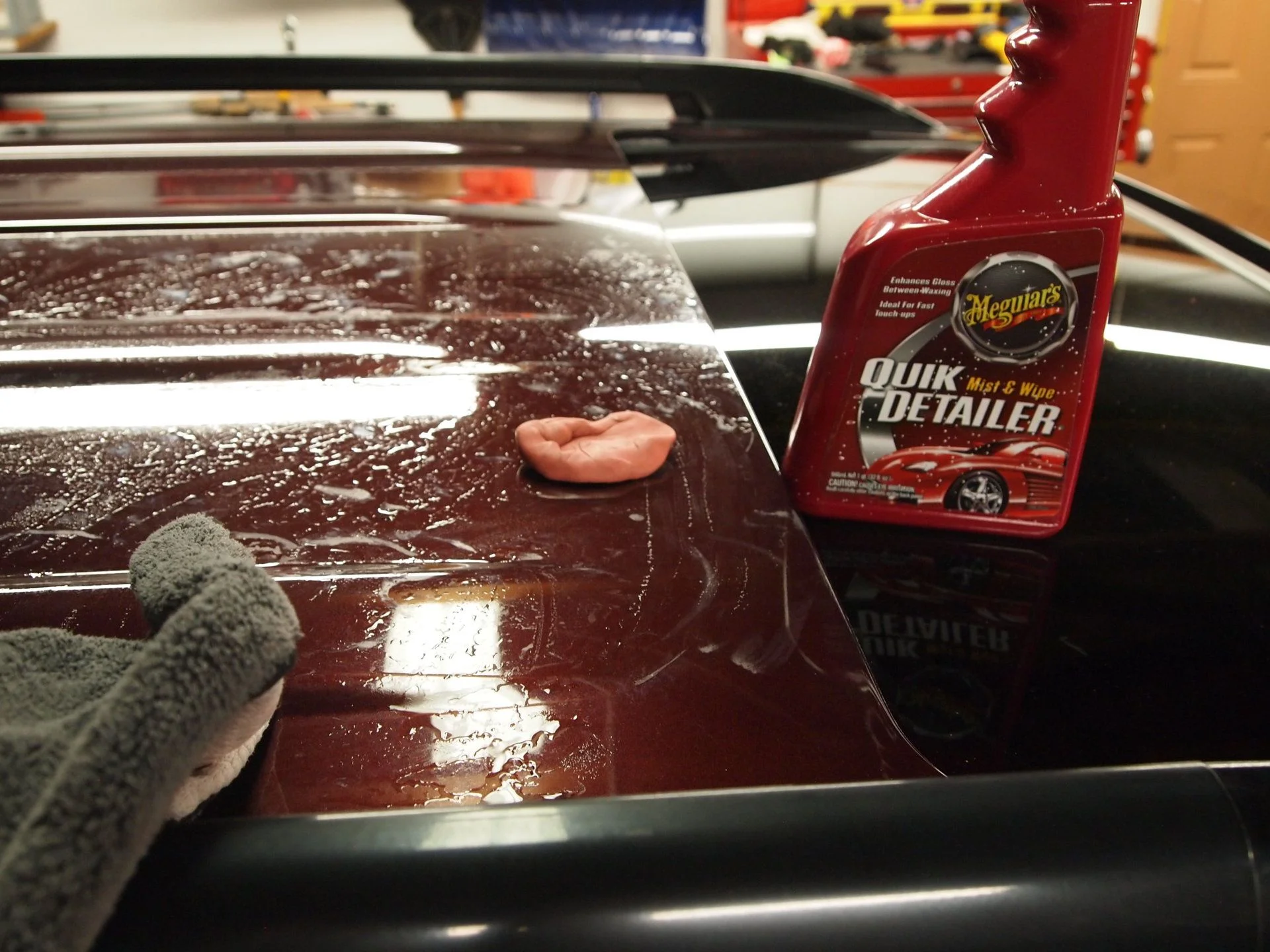

I did plastic bag test before and was grainy, after one pass with syn clay plastic bag test was smooth.

Put your fingers in a plastic bag (sandwich bag) and glide fingers tips over the paint. Bumpy or rough feel means clay bar use is a good idea. Fine clay bar can be used without scratching surface of paint, provided a good lube is used. Use of medium to aggressive clay and paint will need cutting with compound then waxing or sealing.
I'm also using some aggressive clay on top side.

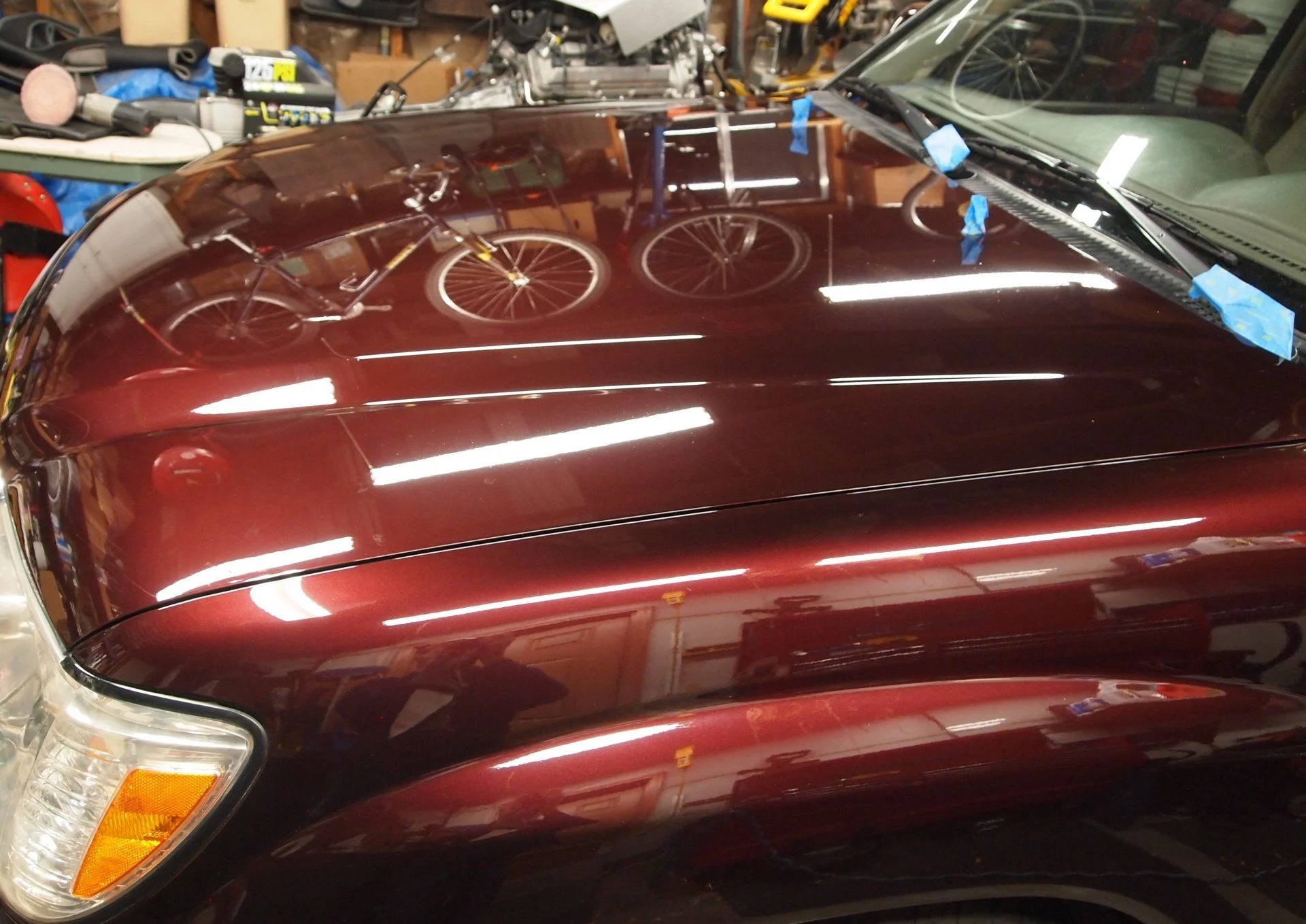

Anyhow for now I'm just taking advantage of the mild weather and cutting the paint. The 50's are a good temp for the compounds, it's easier to work. Hoods been tougher than I though it would be, but it is starting to pop. This hood took 6 hrs with my DA buffer, 4hrs just with my extra cut disk, and it will need more work.
Lord you are OCD, but we admire your attention to detail.
You make me look neglectful toward my LX470 with 38K miles.
Never waxed it yet, hand washed it a couple times but have run it through car wash a few times.
Still looks great but not as good as the hood in the above photo.

After working the paint on WhiteLady Body trim polishing & correcting compounds I gain a new prospective. Cutting and polishing really made it pop. With help & inspiration from members like @landylover21 and @Manhattan just to name a few, I learn the ropes. I've over $1K of detailing supplies & tools in the shop today.
Cleaning is a big part of my inspect processes. Even when doing the mechanics I spend at least a 1/3 of my time cleaning.
Washing, Clay & Cutting with a correcting compound help me see the paint and pulls out pollutants. Pollutants destroyed the clean coat, then work into base coat. Paint has two propose; 1) to protect the body metal from rust. 2) To beautify and personalize our rigs. When I'm done the paint won't be perfect, but it will protected.
I've come to appreciate each ones unique patina and scares as I perfect the paint. I don't think that's something a person with OCD could appreciate. My number one goal is protection. This one has some spot damage to clear, that's it's unique patina. I'll protect from future damage by this process, as will keeping clean and waxed once under control.
Even The King has fade/thin clear coat on front bumper from not properly protecting over the years. With Snowy the paint was very nice, cutting only took 8 hour, but clean paint and carpet was a bear which really surprised me. Cutting Snowy did reveal 140 rock chip, clean them out, so I could see which ones of them needed de-rusting (micro grinding out). Snowy really looked clean when I brought it home. But deep cleaning revealed a lot. I spend over 45 days (200 hours) perfecting, protecting & detailing that one.

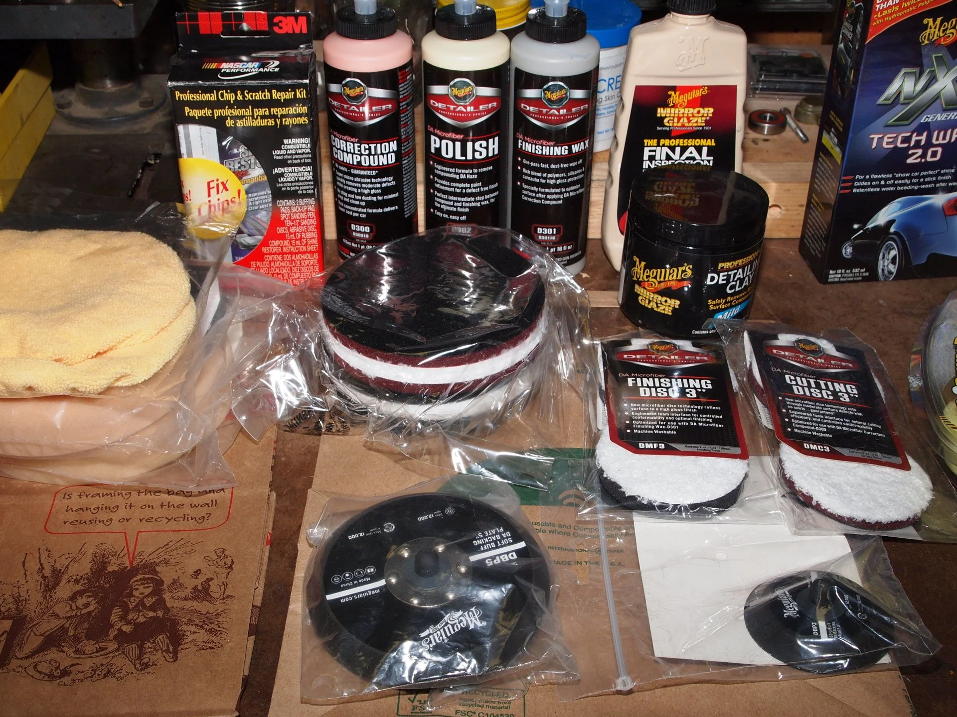

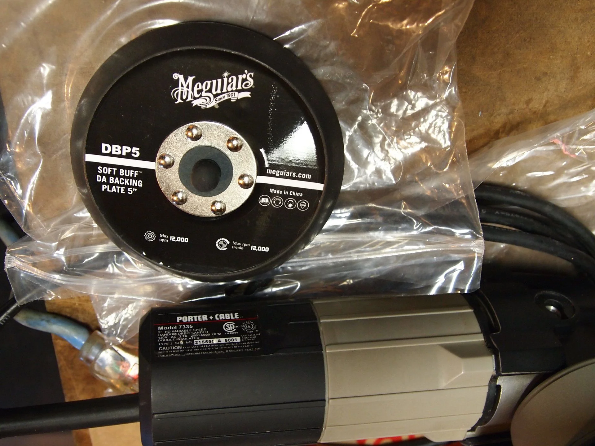

Looks really good. I love the color. Probably answered somewhere before... what DA, pads and products are you using?
Thank you my friend, I think it does too!
I started with a 5" Porter Cable I picked up off CL. I match it with Meguia's micro fiber pads & compounds.
They are ok, and according to Meguiar's are more aggressive than foam pads. But they're hard to find and not available locally even in a city Denver's size.
If I where to re-tool I'd go with 6" and just a foam pad system, cheaper and readily available locally. Porter Cable is great, but there are some high end DA buffer that I believe could speed up the process of cutting.
I would like to find some more 3" cut pads, they've been discontinued. They work well for small spot work and tight areas. I can also give a lot of pressure with them on stain glass.

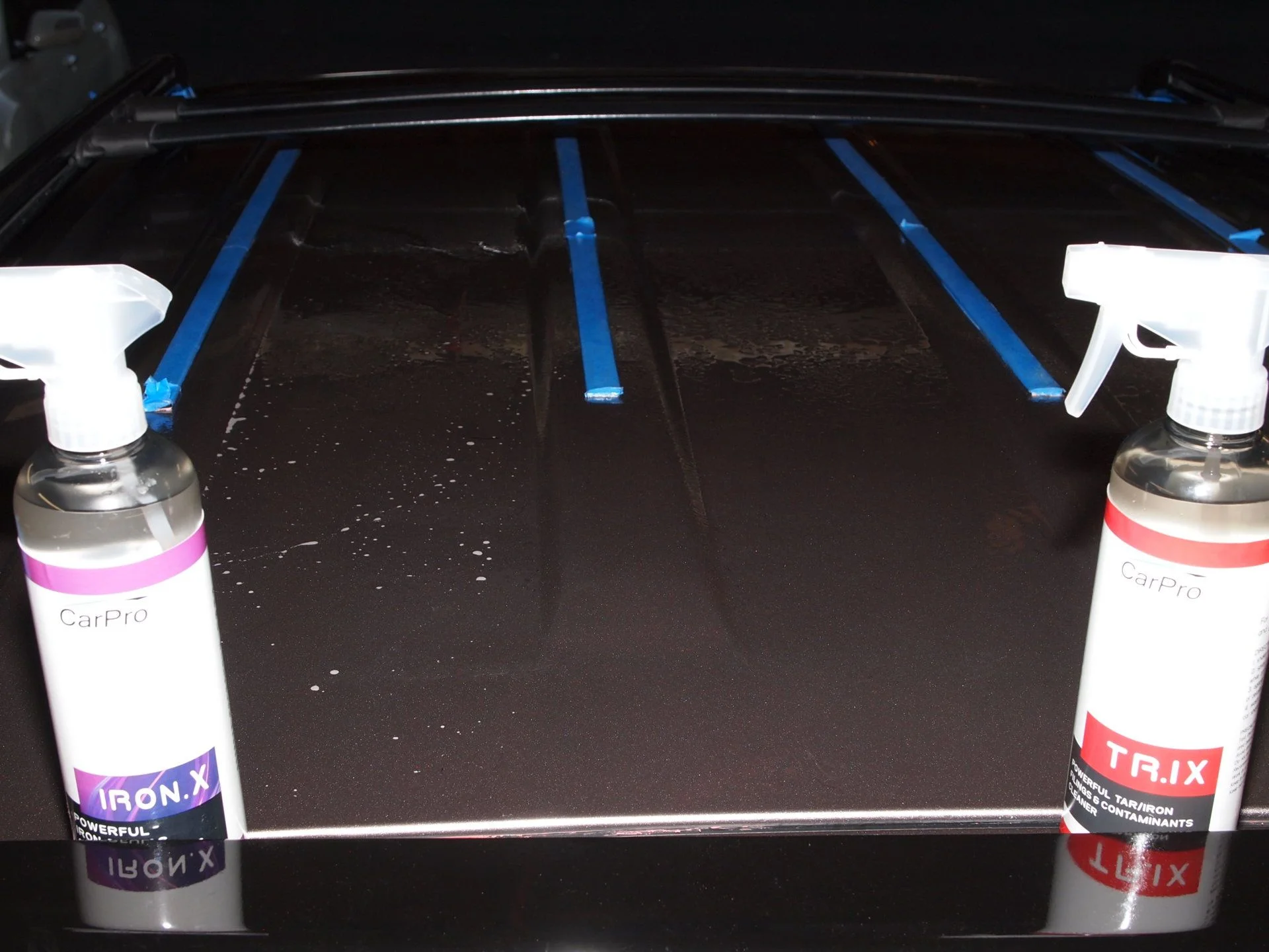

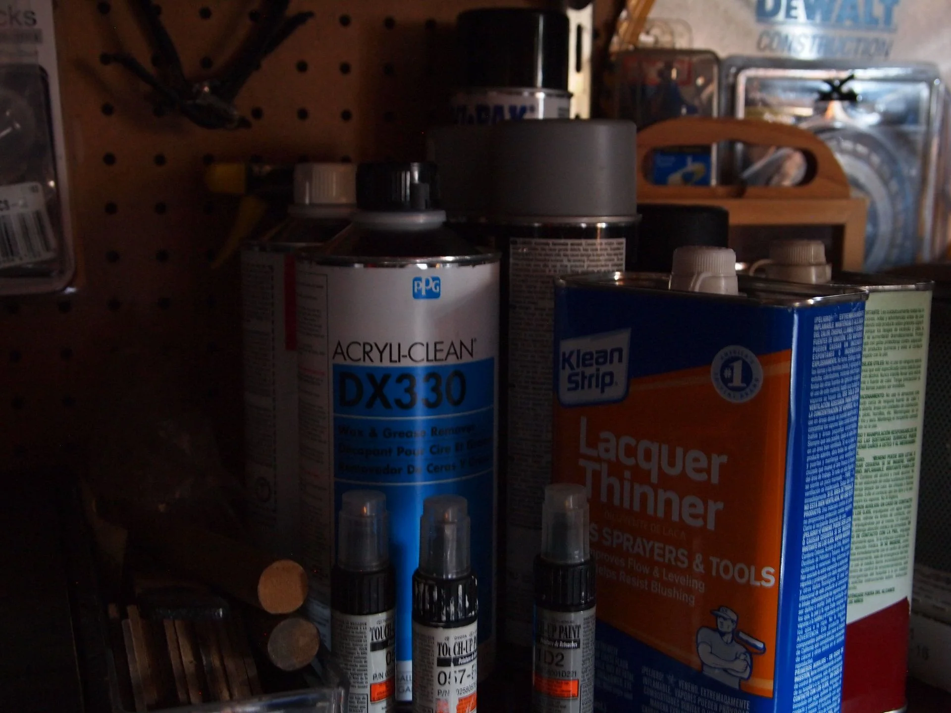

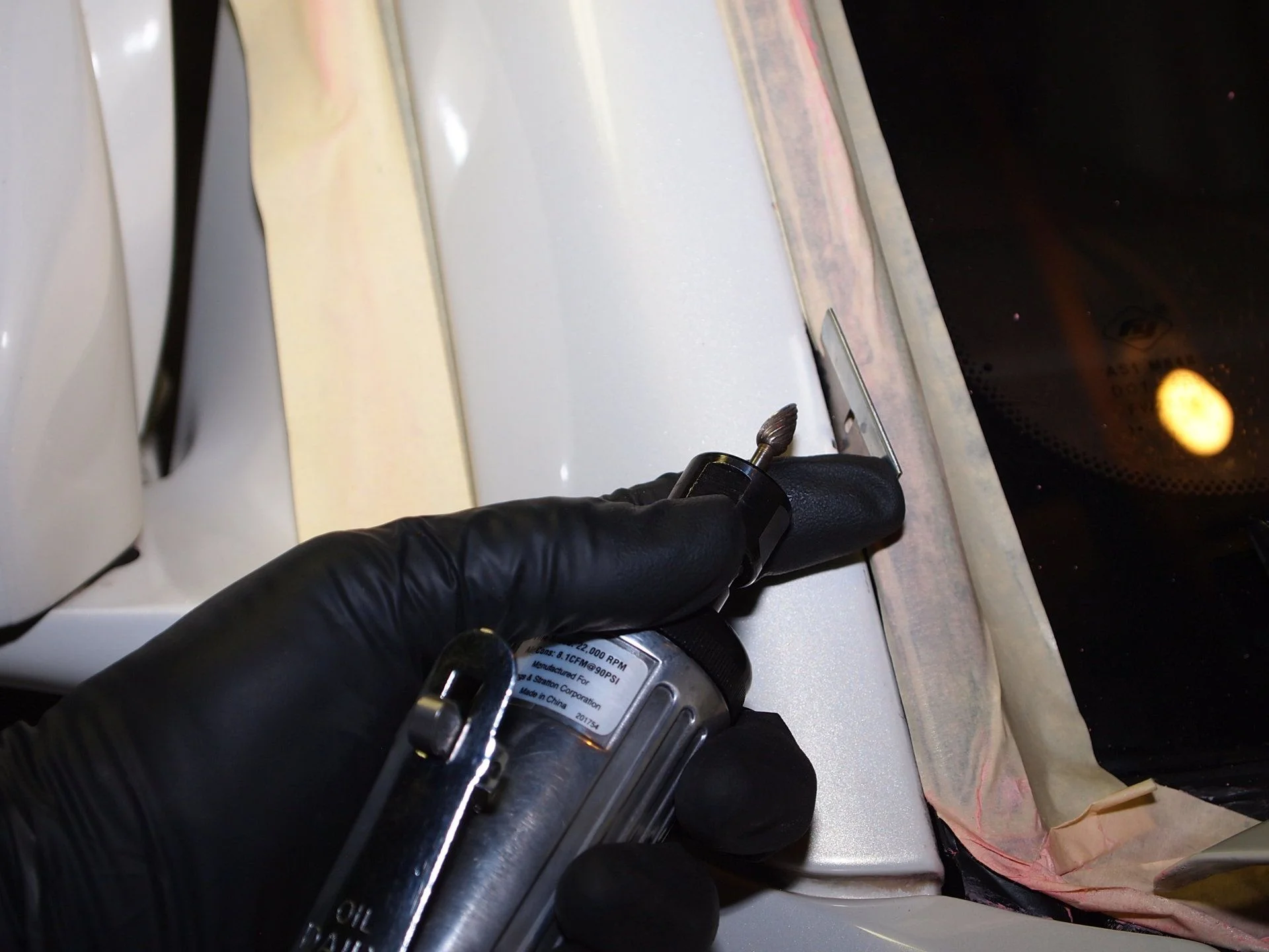

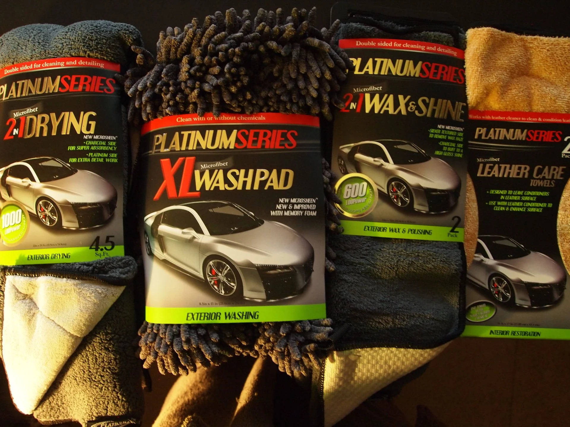

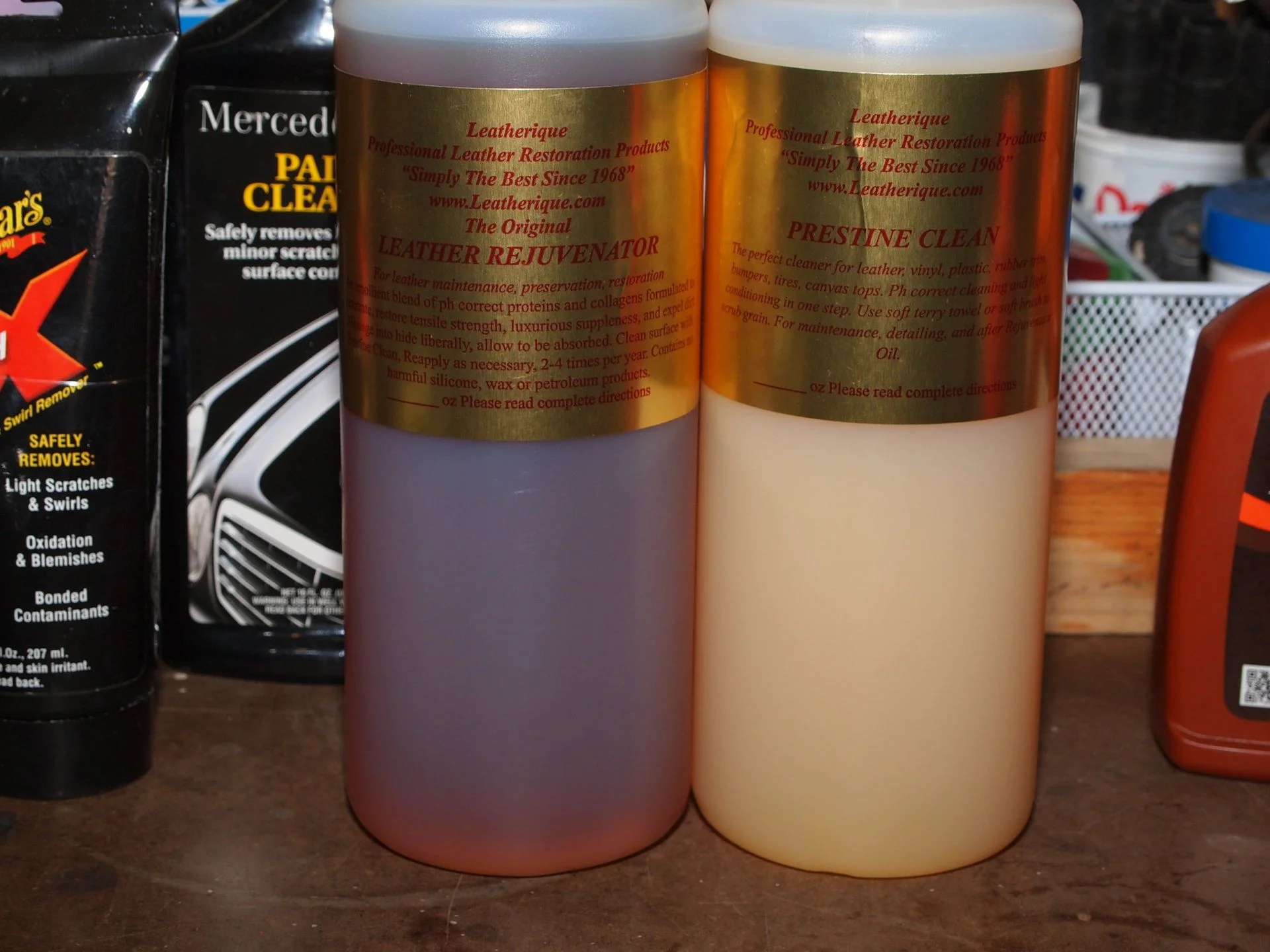

Here is some other stuff:
A Meguiars man... Good stuff.
I've got an original PC 7424, from around 2000. Swapped out the backing plate to a 5" and Lake Country thin pads from Autogeek back a couple of years ago. Still didn't have the power I was looking for. Went to a local detailing supplier that was opening a training facility for an Open House. Registered to win a Griot's Garage GG6, and ended up winning it. It's got considerable more power than my PC. So far, I've left the 6" plate and have purchased several 6.5" GG pads. Haven't had the time to devote to my LC, but I can tell the GG6 will get the job done for me. I'm not going for perfection since my truck is relegated to sitting outside and shows numerous paint chips and clearcoat failure on the bumpers, but I do like to see reflections in the hood. After winning the GG6, I ended up purchasing a GG3 for those tight areas. I think I'll be happy with that combo for a while.
One of the instructors at the training facility suggested sticking with foam pads. In his opinion, he felt the microfiber loaded up too quickly and you needed to clean or swap them out more often.
