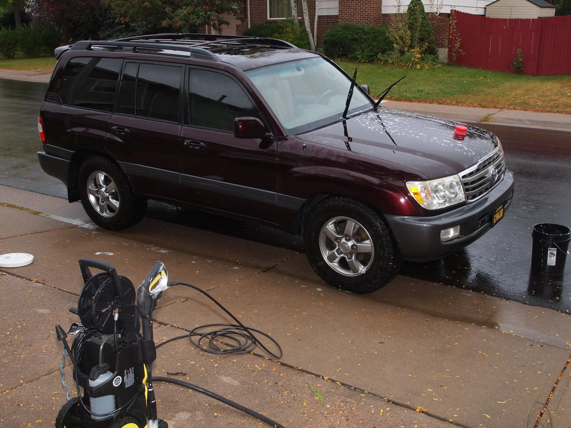

I couldn't wait to get started so I was out in the rain today cleaning and using a synthetic clay bar. The cold weather and rain aided in clay bar. I used something (new to me) a synthetic clay that is used with car wash soap for lube. I'm impressed so far. I did plastic bag test before and was grainy, after one pass with syn clay plastic bag test was smooth.

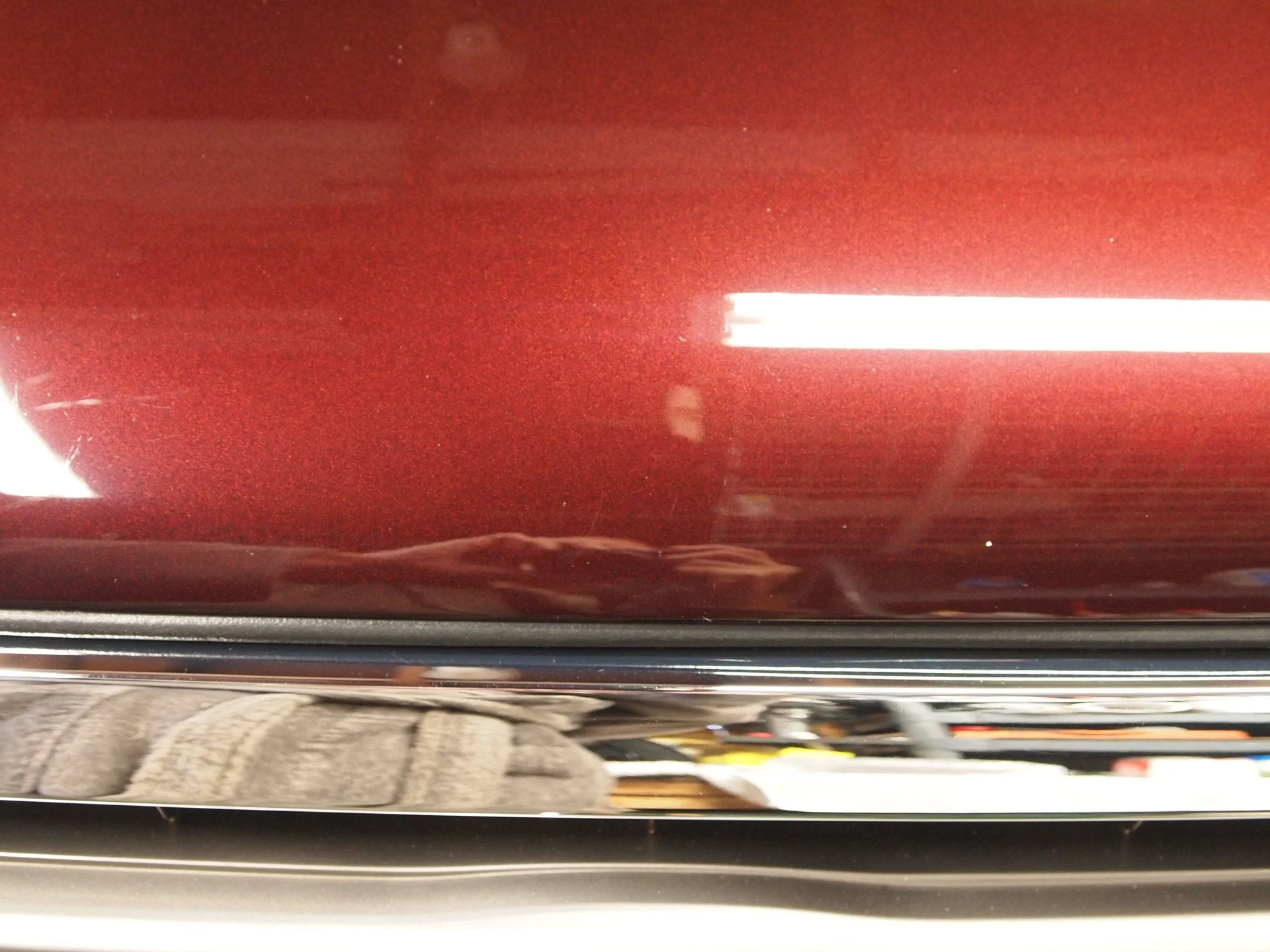

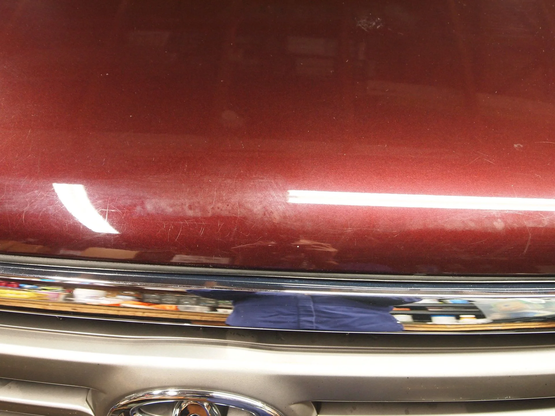

Paint as I said is a 9, but looks like it will buff well, maybe to a 9.5. I'll cut with correcting compound and micro fiber pads on my DA buffer then wax. I'll come back with touch-up paint when I can get it if needed. Touch-up paint has been taking three week to come in, I'll order in the morning.
After first cutting with Meguiars micro fiber DA correcting compound & cutting pad. I'll touch up then final cut & wax

Looks good, these minor scratches show soften nicely with correcting on first pass.

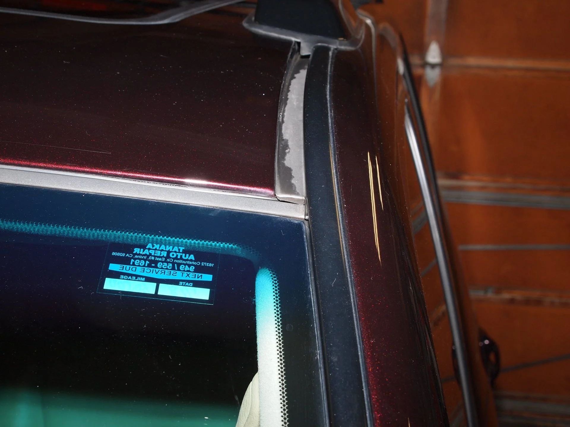

Some shots of the windshield. which I believe to be factory install.
The light color on side molding in rain gutter is more of my camera setting highlighting it, a little rubber conditioner and will look like new.
