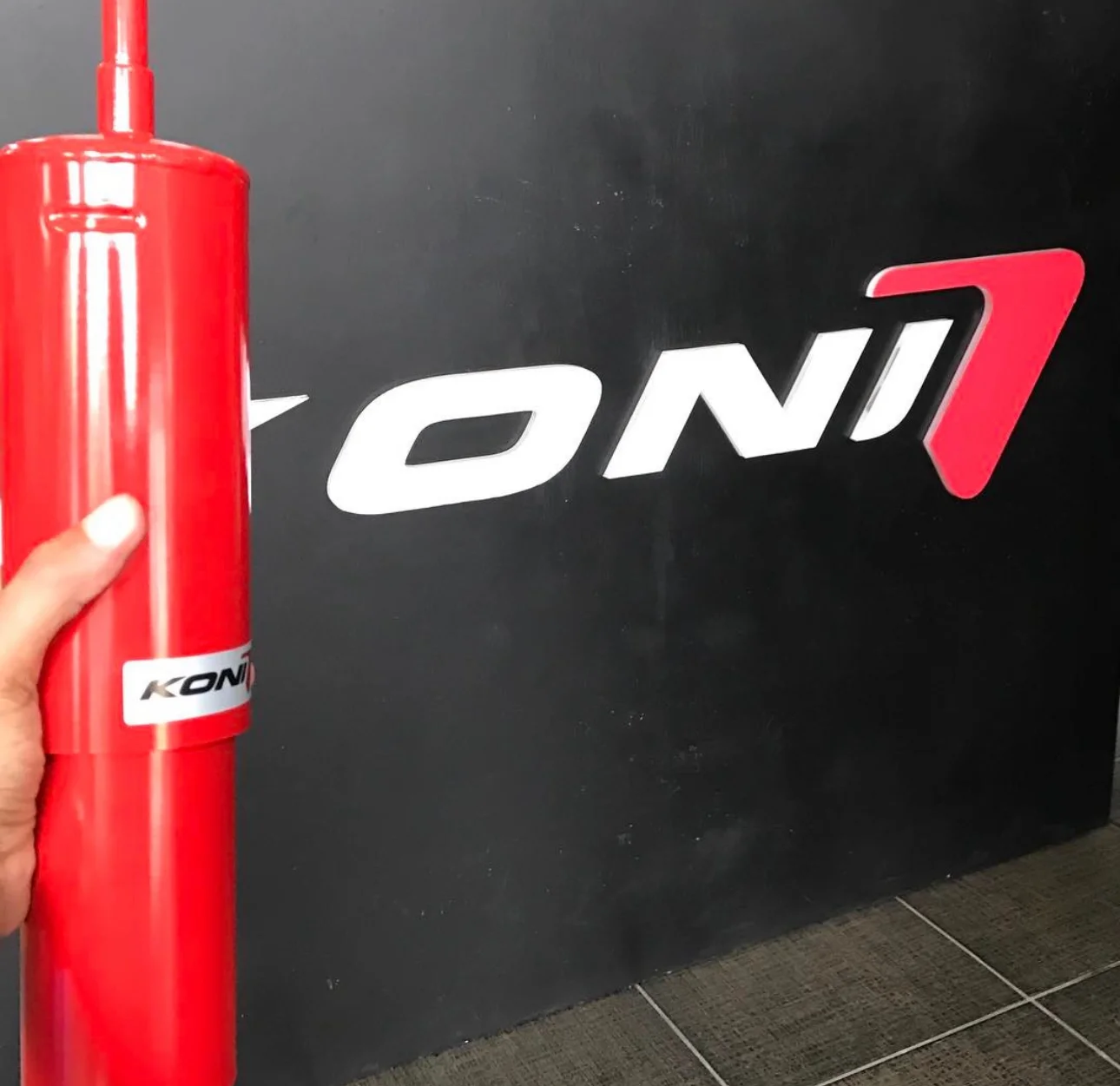

Did find this -For those with torsion bar questions
KONi Raid is my favorite after OEM. OEM is still my top option for practically, ride comfort, longevity and reliability. If you are looking for aftermarket, KONi Raid has adjustable damping plus all those 4 positives that I mentioned OEM has.
