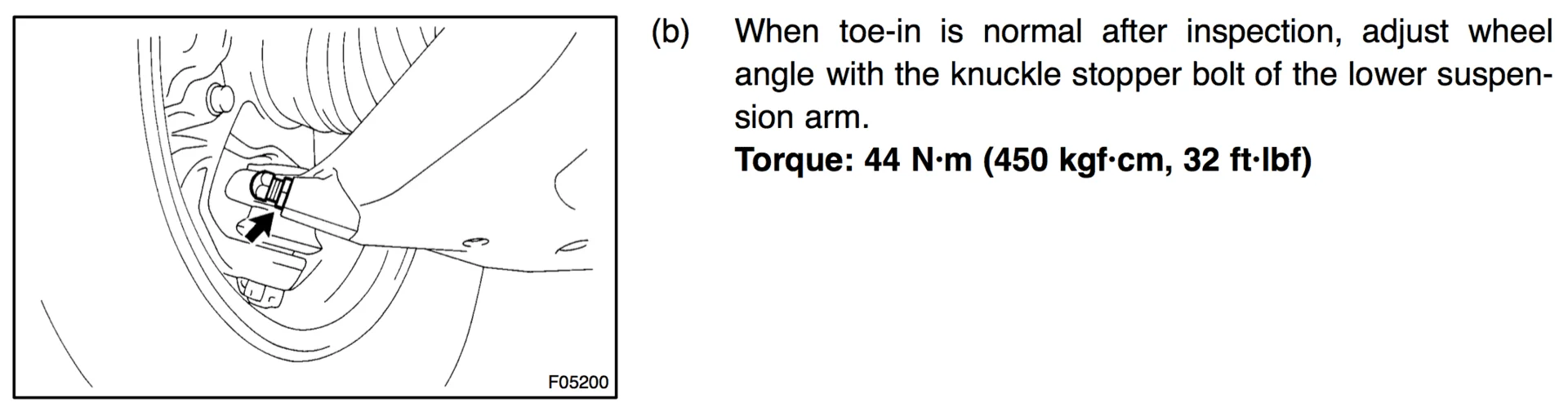

I could not find the procedure in FSM for setting the stops. Where is it??

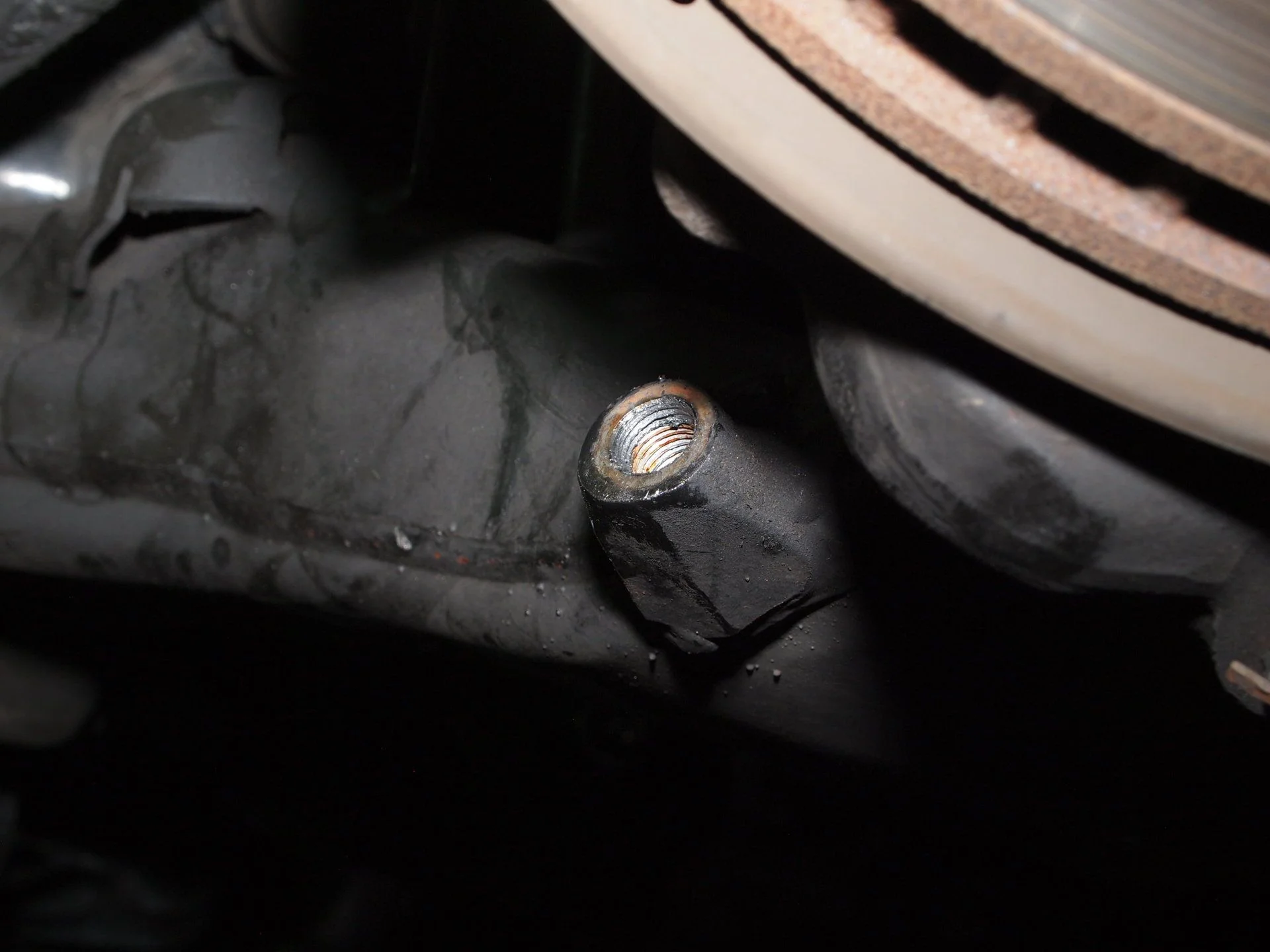

So just locked in DS, after repair, with about 2 threads showing for now.
PS was real PITA. Threads in LCA receptor were buggered (tech term) up bad. I tried and tried to get tool aligned for about an hour, just could get. Finally I took a break for dinner. Getting away form frustrating jobs always helps one gather thoughts. On returning I found a grinding stone just the right size in my tool box. Used the stone in thread to grind down first few bad thread. Then thread repair tap tool aligned easily and set this PS stop bolt and locked.
Test drove in parking lot, and got nice tight LH & RH turns without any rubbing.:)

Thanks @labcab, looks like alignment shops job to get set..

I'm thinking last alignment which was done when oversize tires mounted at tires shop, adjusted stops nuts not set then. But Could have been PO did himself IDK.
Before I found knuckle stops loose, I noticed I couldn't make my U-turn as tight. I had them out from awhile, notice tire squeal in full turns. Now in full turns I'm not hearing tires squeal or rub, so good for now.

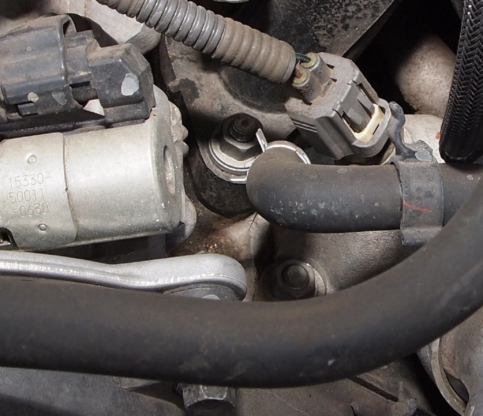

I'm looking for any clues as to condition of intake manifold gaskets, fuel injectors and fuel pressure regulator. This involves monitoring MPG, idle variances and visual inspection of intake gasket area.
I do see just a little oily look at head to intake, but it too little amount to make much of. I also noticed that same coolant hose to vacuum line clip broken, this one is so common.

First time I found a bad intake gasket the oil came up intake plastic plums ~4 to 6" from capillary action. This one does not have oil on intake plums.
Here a shot of that on The Redbaron before i cleaned or replaced gaskets. Notice dirty intake plums, the oil attracts dust.
