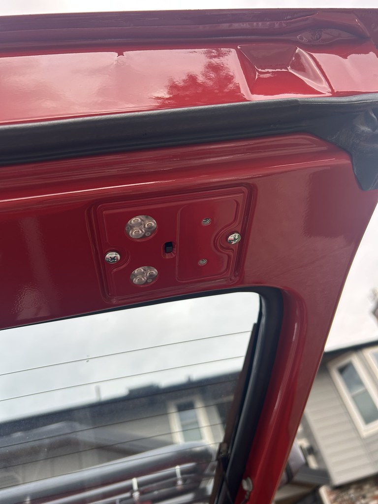

This was really my first machining project. Kind of swung for the fences here. I've always seen these panels on the back hatch of the land cruiser. I'm pretty certain there were for access during the build of the trucks. Running wire and the sprayer hose. Maybe they have another use, some of you might have opinions. But they are just sitting there.... waiting. When the hatch or liftback is open these panels are about 7 feet in the air and could sure serve some sort of purpose right? I mean certainly feels that way.
So I embarked on a journey to put a couple lights in something and some multi-purpose threaded locations for an eyelet and possibly some other junk. I settled on a ram mount to start. I don't know, put a tablet mount on there and watch movies at the campsite or something. This kind of lead me to doing something with 1/4-20 threads as that is a common thread for an eyelet, ram mount, even camera tripod equipment. The main feature was the lights though. I ended up with a CAD design like this.
I wanted it to look kind of like the original panel with recesses around the screws. I think I achieved that in the design but machining it proved difficult. 3D printing one worked well as a test fit and I tried out the lighting which was promising. Really gave me some motivation to keep going.
I set off on learning CAM which took ages. Also the part gets quite thin so I was testing the work holding I could accomplish. I had a couple failures along the way. Here's one where I caught one of the thin edges and tore it off with the endmill.
Anyway. I finally got all the machining worked out and installed it unpainted as a fit. Which was really promising. Could tell I was really going to like it. The eyelet obviously wont' support a ton of weight. Eventually if you put too much on it the weight would overcome the the gas shocks and pull the hatch down. Now you could clip the gas shocks to keep them up or put a pro rod in. Some of you have probably done this. I figured it would be nice to run a line to a tree to hang wet clothes from, or hanging something low mass when you're setup for camp. I will keep searching for other 1/4-20 accessories holler if you think of something that would be cool to have in a camping bag. I'm going to leave the holes empty until setting up somewhere so I don't accidentally smash and eyelet or ram mount into something.
So then I took it apart again, sanded and painted it, then polished and did the final wiring. I am not a great painter but I think the illusion works. The pic below is before polish.
One light is white and the other is yellow for camping (as you can see). Pretty proud of the end result. I have a more simple version that we should have available on @Cruiser Cult in the not too distant future (unpainted). The bigger panel looks prime for some serious lighting as well. So will make something for there too. Thanks for following along as usual. Happy Memorial Day!

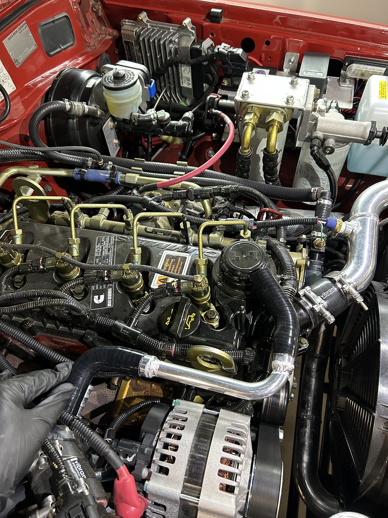

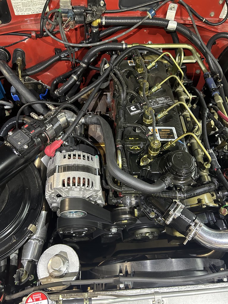

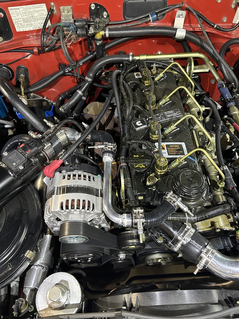

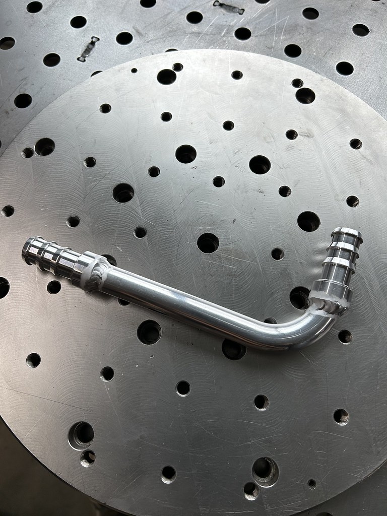

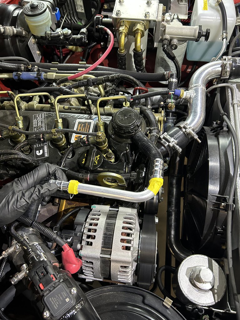

Little update. I didn't get this PCCV alignment quite right when I did the intake for the truck originally. You can see the molded rubber hose that Cummins provided is kinked a bit off. No fault of theirs. It probably works fine, but it's always bothered me.
Decided on an aluminum pipe with some silicone couplers.
Polished it up a little to try and match the radiator pipes
And some t-bolt couplers to finish it off. Looking at it now, I might shorten one of the silicone couplers to get it straight with the engine.

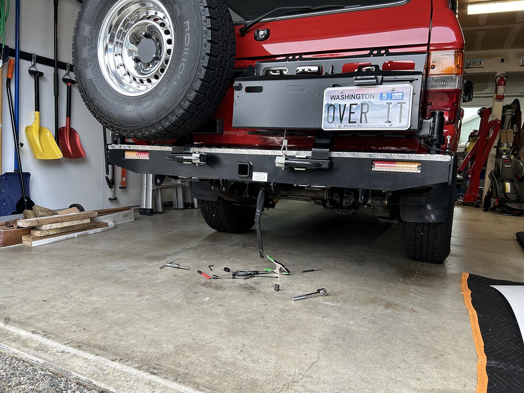

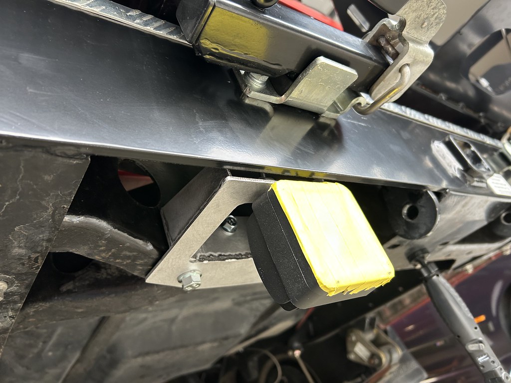

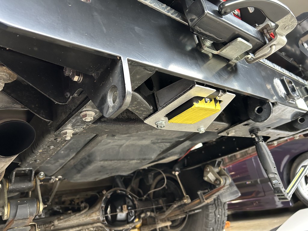

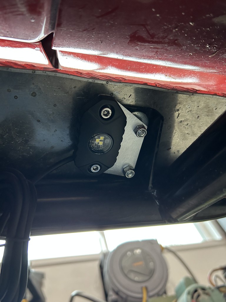

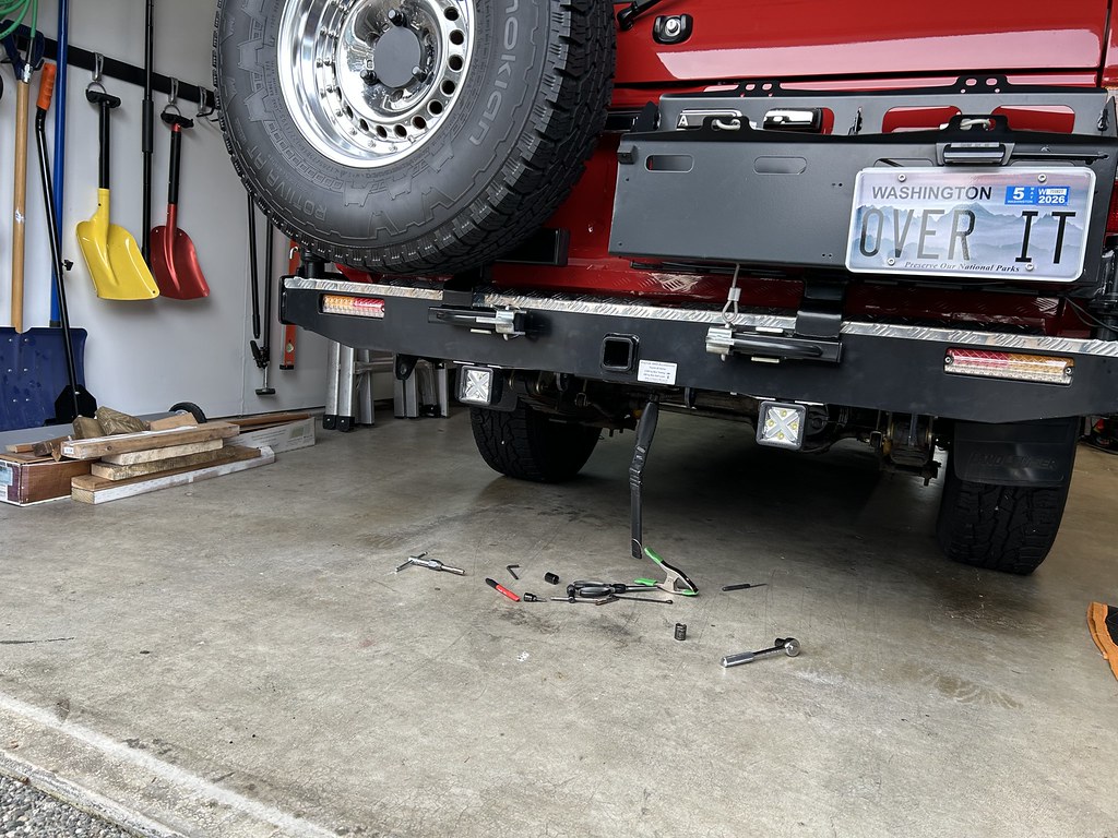

Rear fog lights. I've had thes Sylvania X-Cubes lying around for a very long time. I like the form factor of them and that they have two possible light outputs. One is a fog function which is decently bright, not sure how much you really need for a rear fog but they seem bright enough. The other function is an "X" sort of ambient light. So it's a 3 terminal fog light. The X ambient lighting will be something that I'll address in a future post. I'll get this out of the way too; I love fog lights, I think lights are just cool in general, but I like things to be kinda clean and sleek. So I had an idea to make a retractable fog light. Something like what you see on the Baja Designs light bars with the solenoid that adjust the beams direction. I worked up a prototype but abandoned it. It felt like a big lift to run some controls all the way to the back and some sort of solenoid that will just get blasted by rain spray and other junk. So I decided on a more manual approach and I think it turned out pretty good.

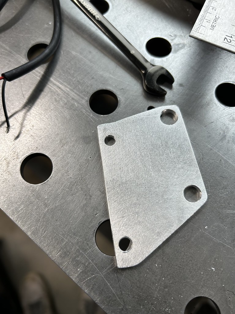

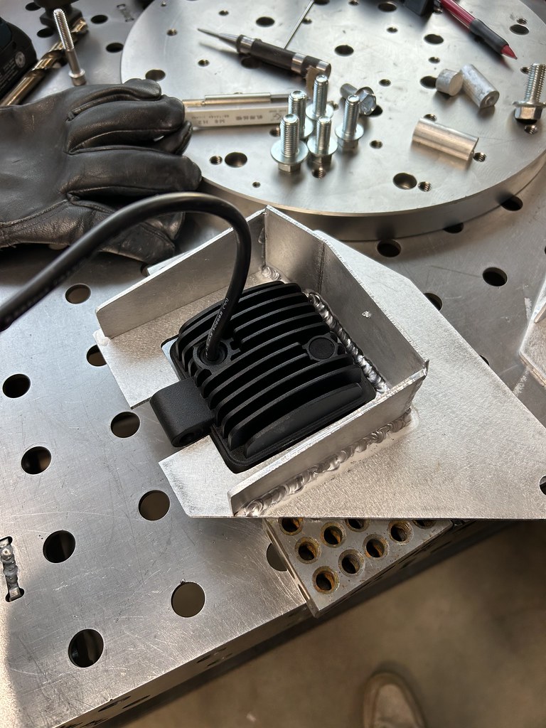

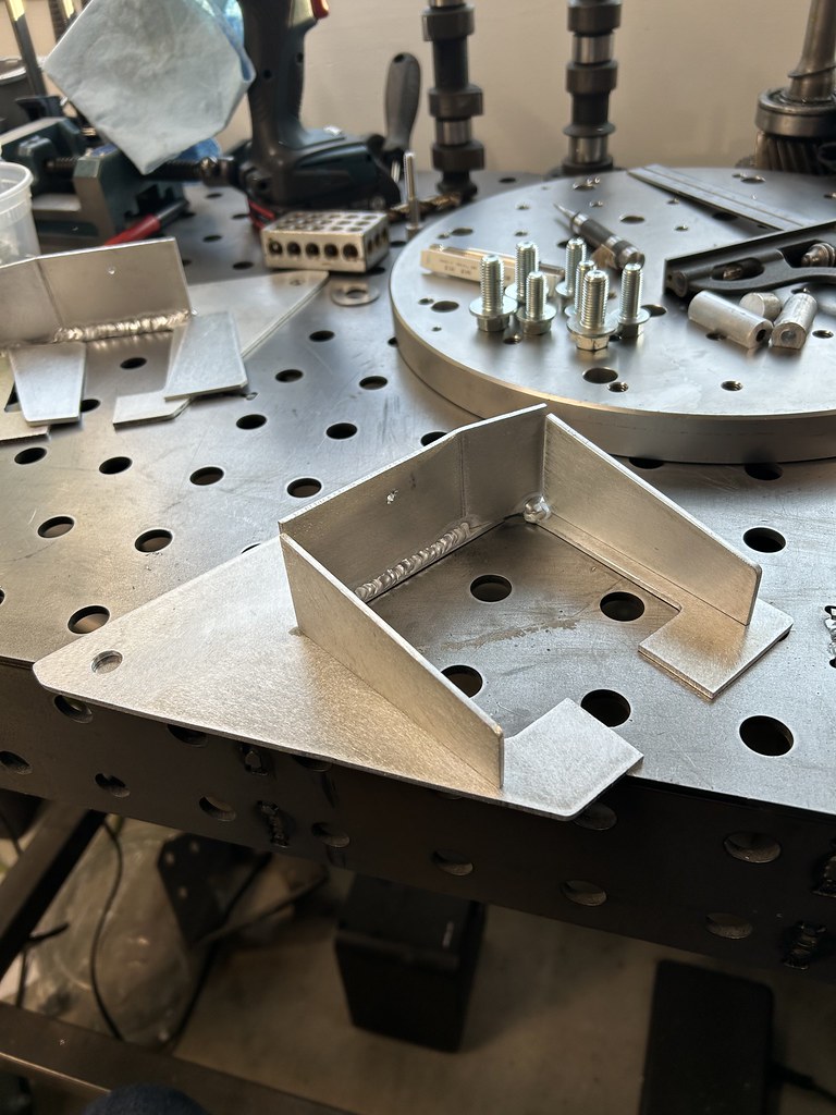

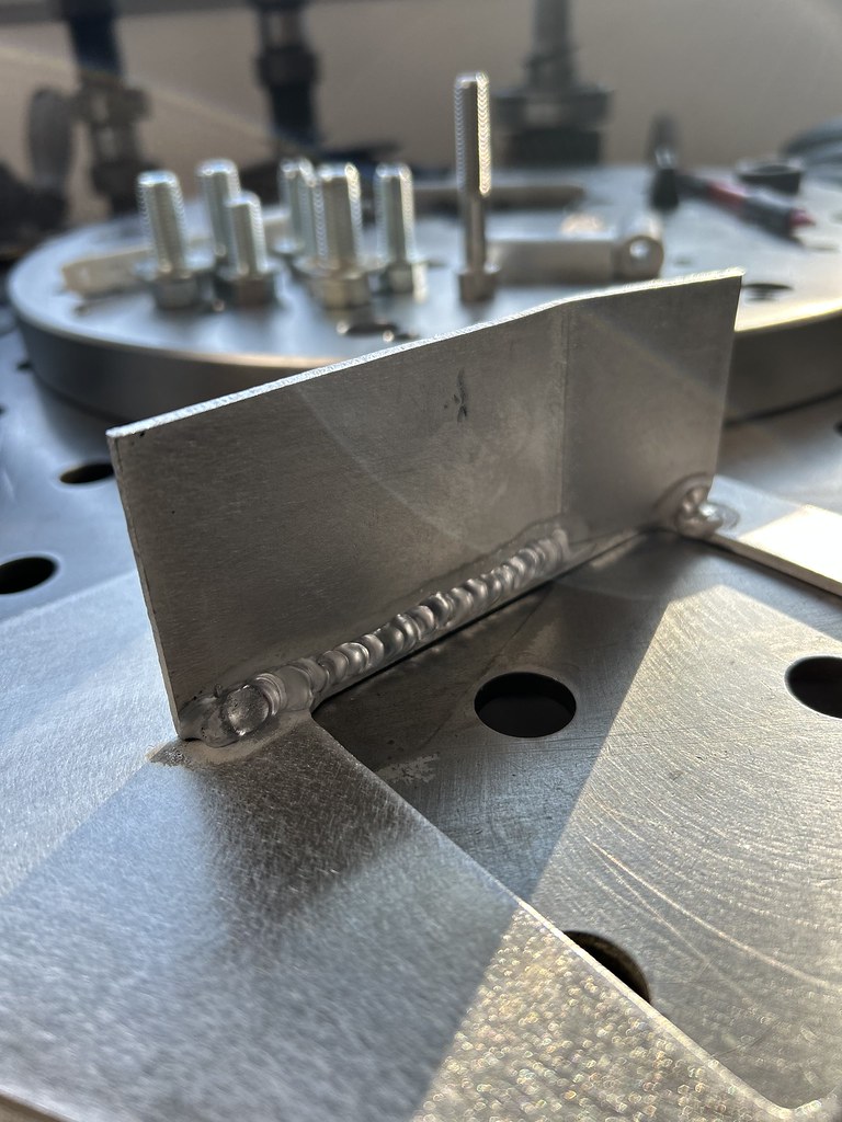

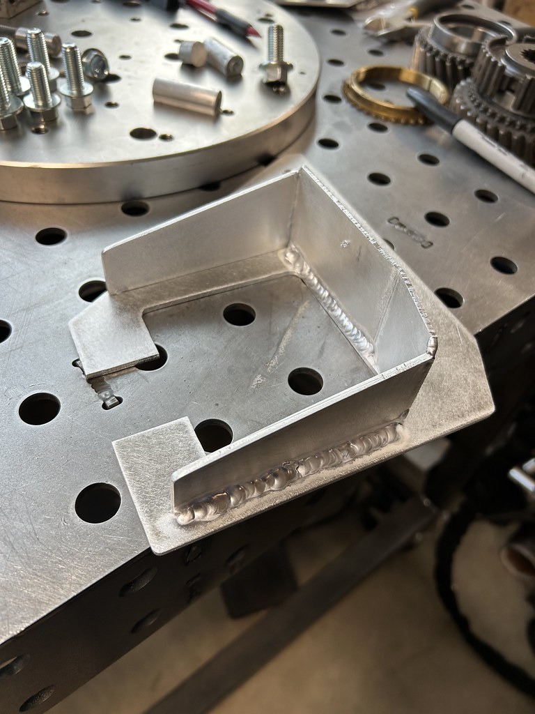

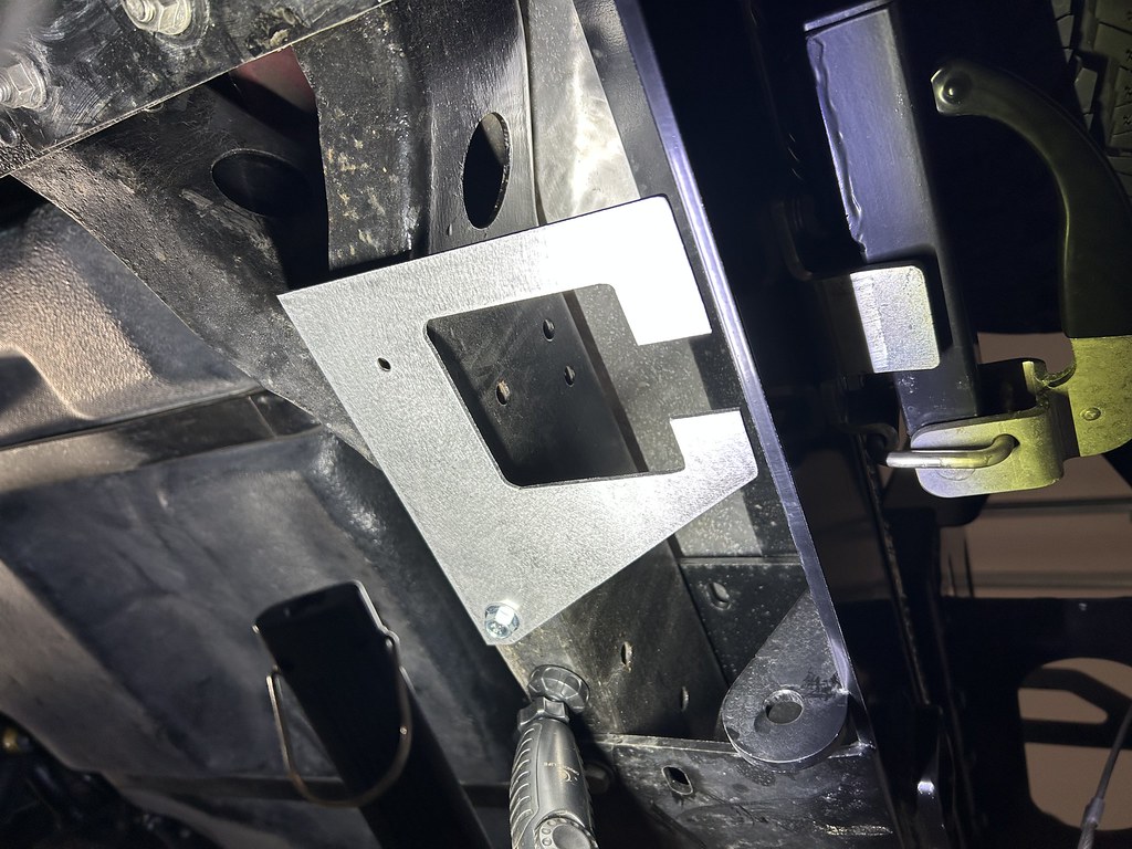

Basic idea is to tuck them up in this dead area between the rear bumper and the frame cross member. So I did some paper templates and started along this path with a simple plate. These threaded locations were extra, not sure if the stock bumper uses them for anything. You can imagine how crusty they were though. Had to get some taps to clean them out. Fine thread oddly enough.
My Aluminum TIG skills are a little soft lately.
Left and a right. The are basically mirror images of each other. The brackets bolt to the bottom of the frame in those threaded holes and also use one threaded location on the upright so they end up being pretty stiff. Pretty happy with the look. I didn't get a good picture but I machined a pivot point that is blind one side and threaded on the other. Then one socket head cap screw basically pinches the fog light and keeps it from rotating. I've driven the truck a few times and they haven't come loose so I consider that a win.
Pretty subdued little lights. Should be cool. They look fine if I had them down all the time, but tucking them up is such a nice option. I promise to get some new lighting shots in the dark.

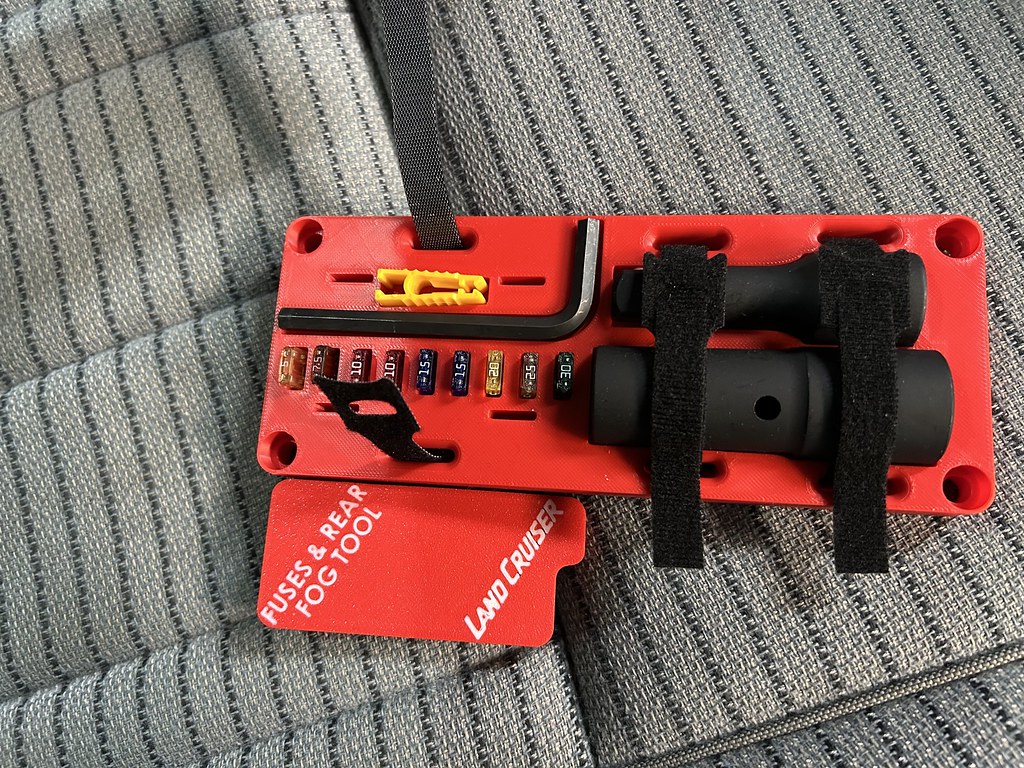

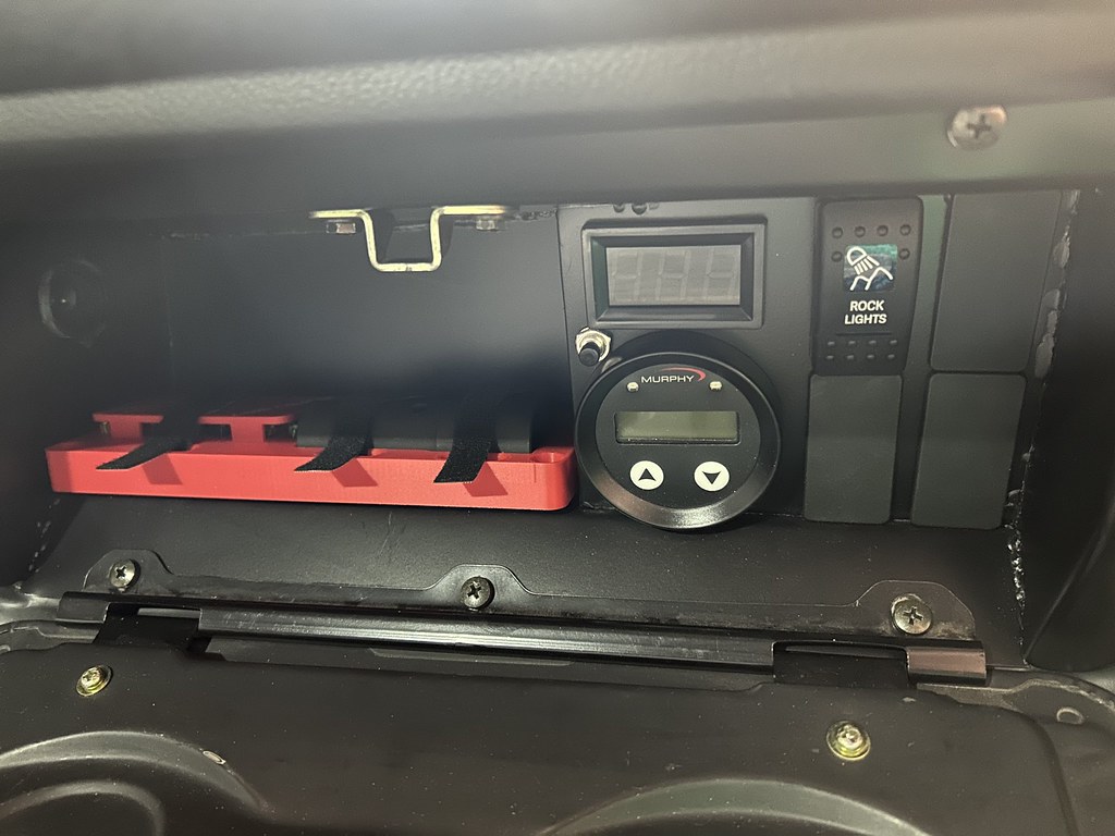

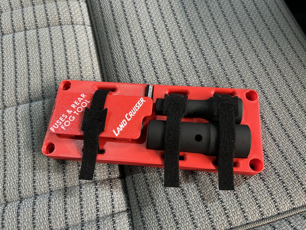

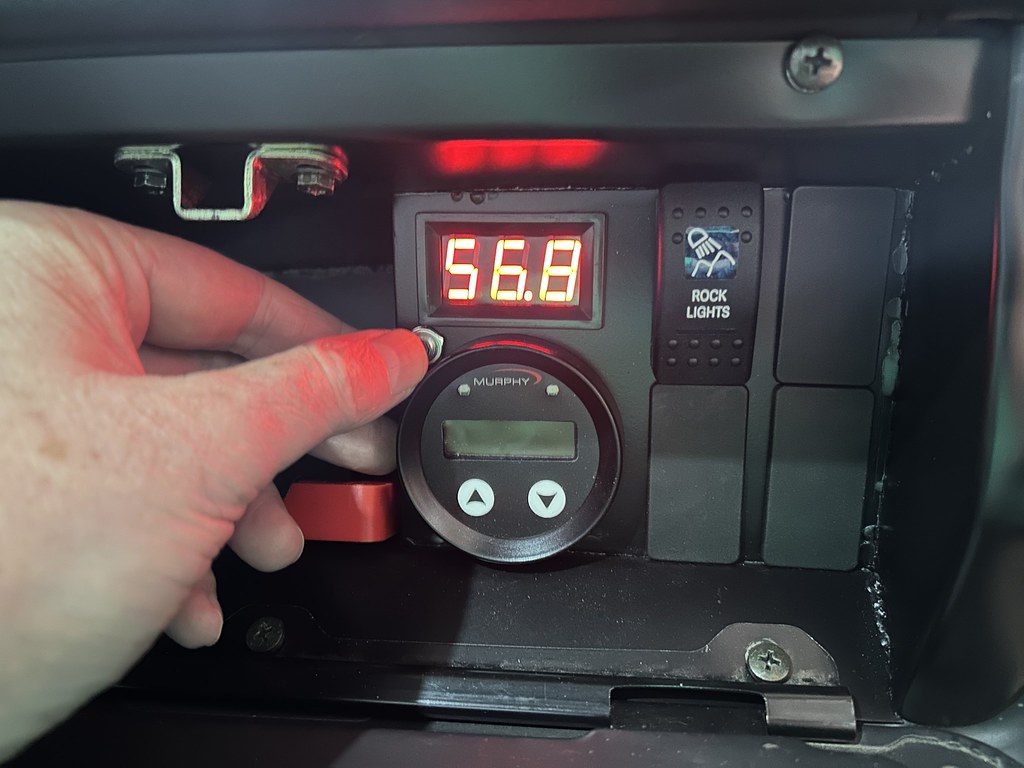

I was goofing around with the glovebox again and got it all buttoned up. Also put together a spare tire lug socket, fuse and rear fog tool holder. The allen key is the size needed to loosen the rear fogs and flop them down. The keen eye will see the "rock light" switch in the glove box which I also did. Two pods on each step side, one on each side of front bumper mount, and those X ambient lights for the rear fogs are the last little bit to give an almost 360° rock / camp / puddle lighting function. Again, I promise to get new lighting photos soon. I also found a pretty slick spot for a front facing camera that I prewired for ages ago. This will be a bit of photo potpourri.

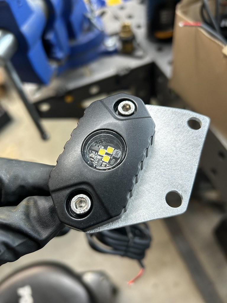

Finished glovebox. 3 spots for additional loads on the house battery. "Rock lights"?

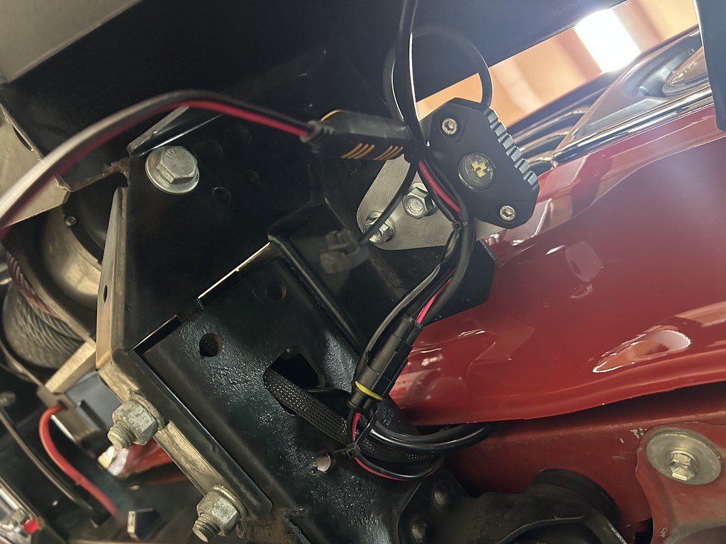

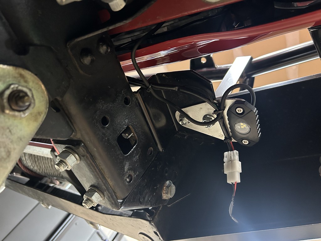

This spot on the passenger side front bumper mount has a light pod for the rock lights, the ARB turn signal indicator harness and in there is also the outdoor temperature sensor.
Similar thing on the passenger side but this one has the C-Tek battery tender location and no outdoor temp sensor.
The temp sensor panel is in the glovebox and is turned on with the push button.
56.8 degrees today. I guess I'll keep my phone in my pocket for a few more minutes instead of checking the weather :moon: Such a stupid thing to put in a truck but stupidity has never stopped me before.
This little guy fits nice and snug in the glove box and has a double sided socket and extension. One fits the spare tire lugs on the Kaymar and the other side fits the actual lug nuts. Just got to remember to take an impact. It also has spare fuses for the two Eaton fuse panels, the fuse puller and the allen key for those rear fogs.
Simple bracket for the step side puddle light mounts. The same one was used in all four locations.

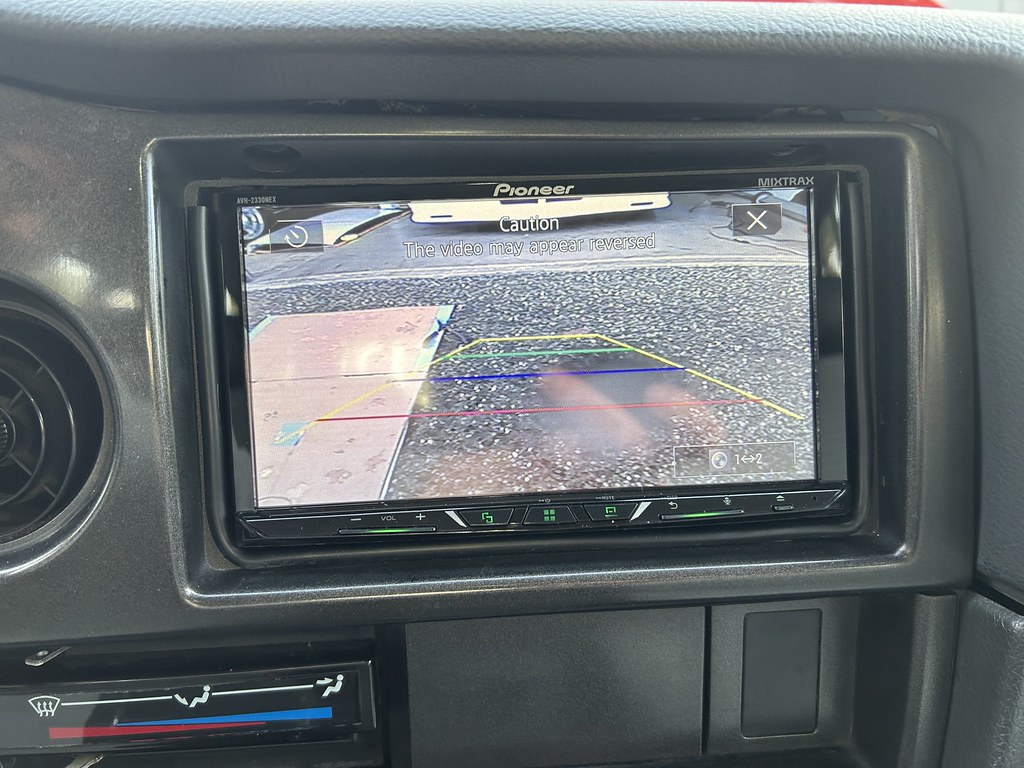

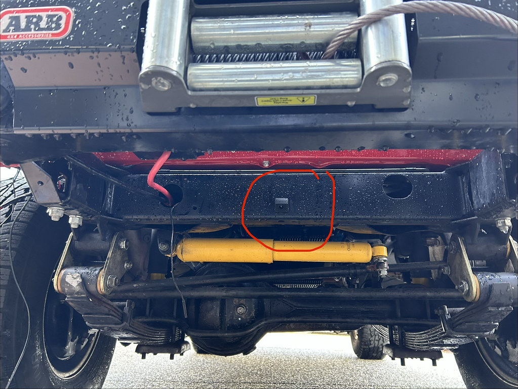

Front facing camera in the front cross member. Give me a real good look at those pesky parking blocks.:rofl:
