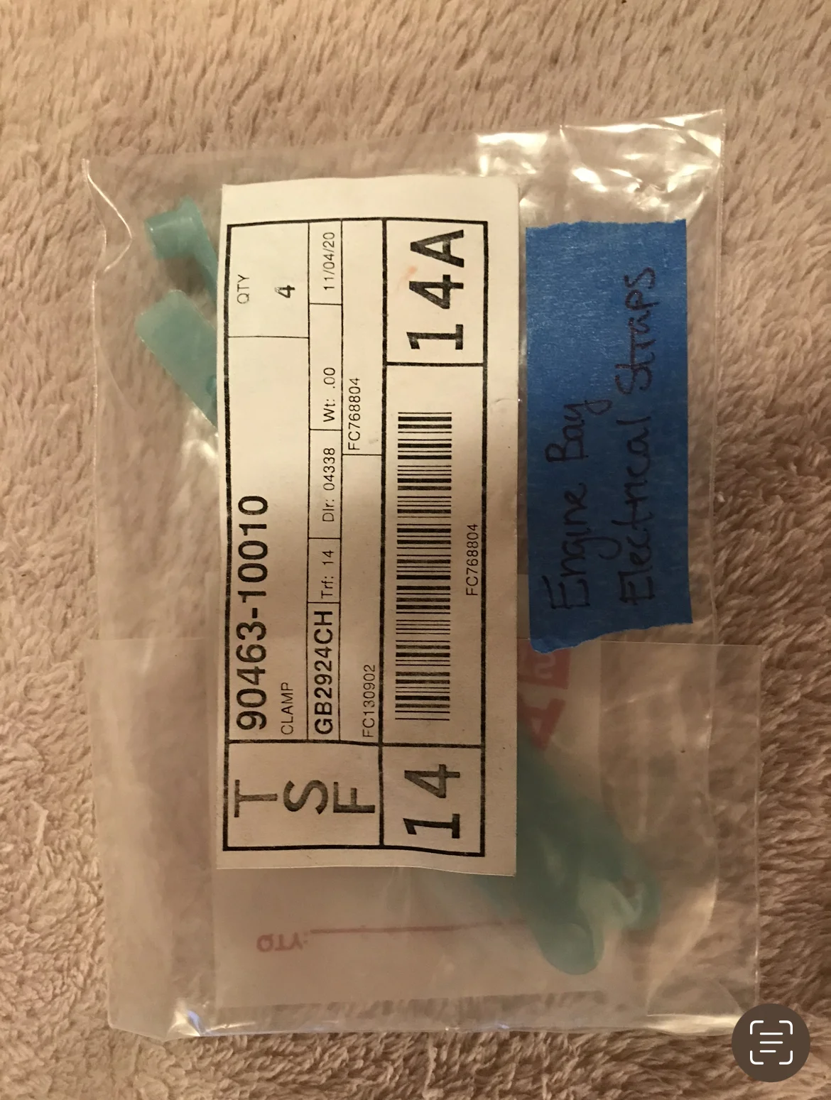

For whatever it’s worth (and you probably already know this) those straps are still available from Toyota.
Part Number: 90463-10010
Everything looks crazy awesome - I still can’t wait to see this in person!
I figured they were. I was ordering some other fasteners for the OBS ford and saw these. It was a “Spider-Man pointing” moment.
