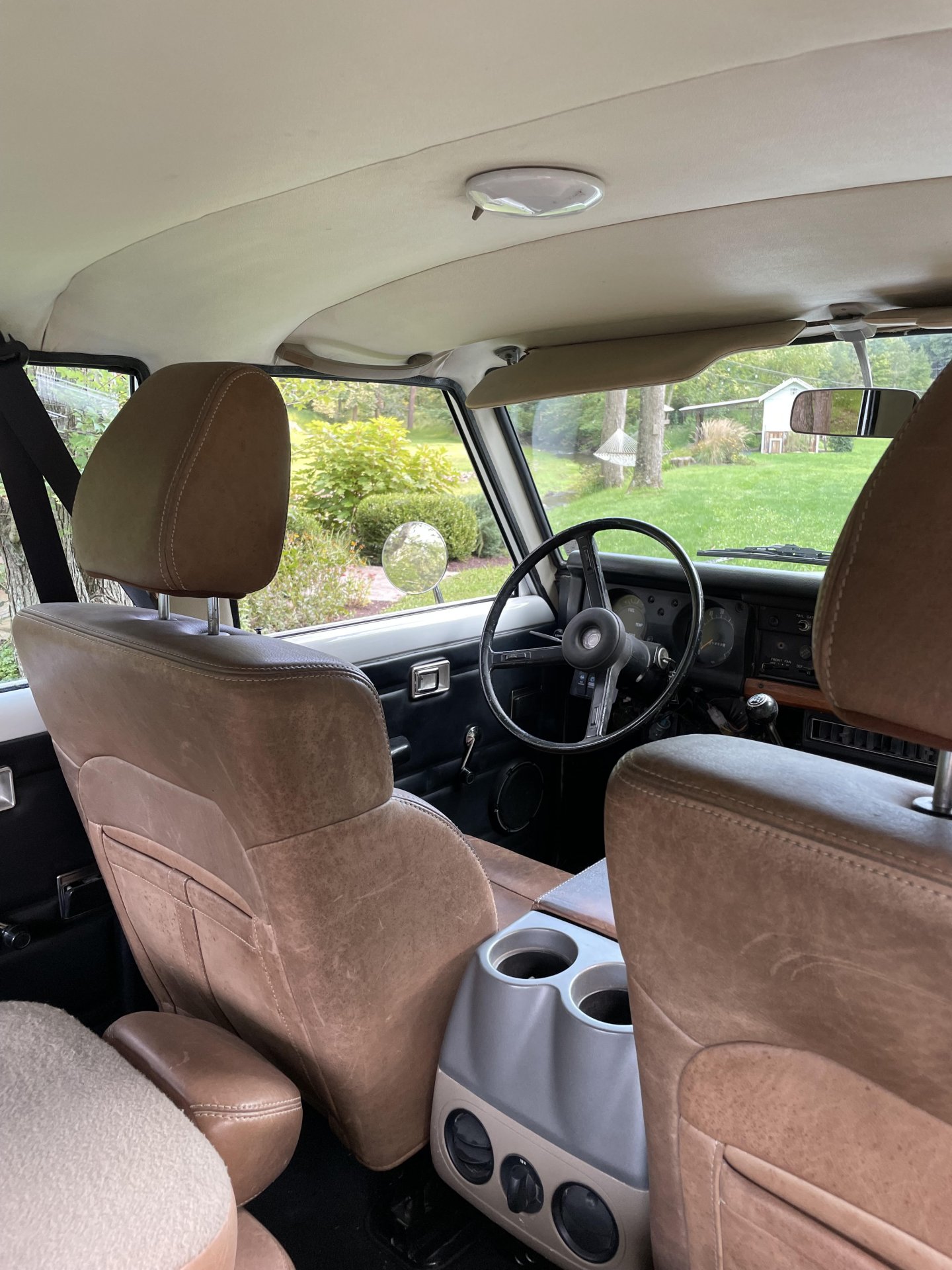

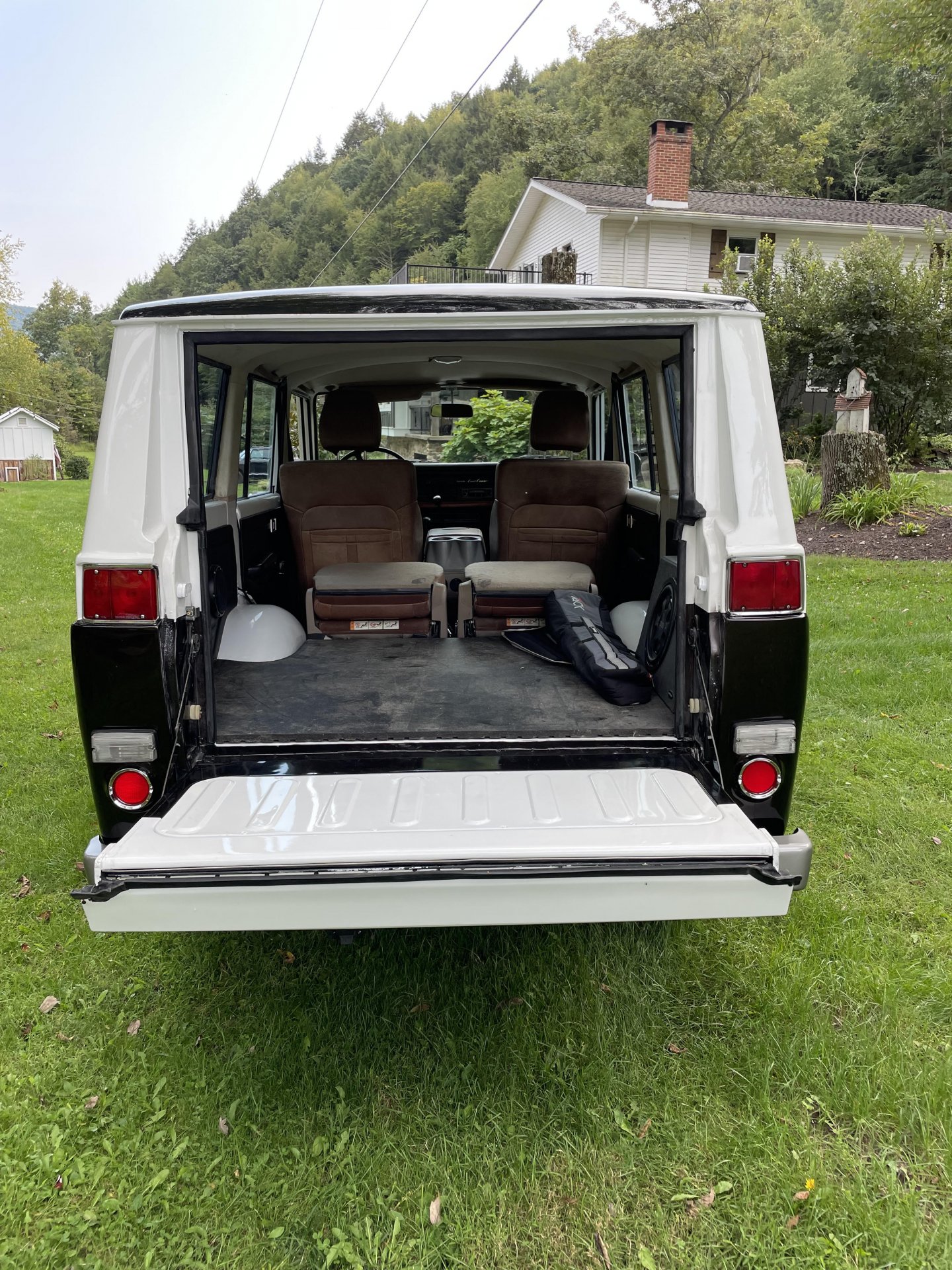

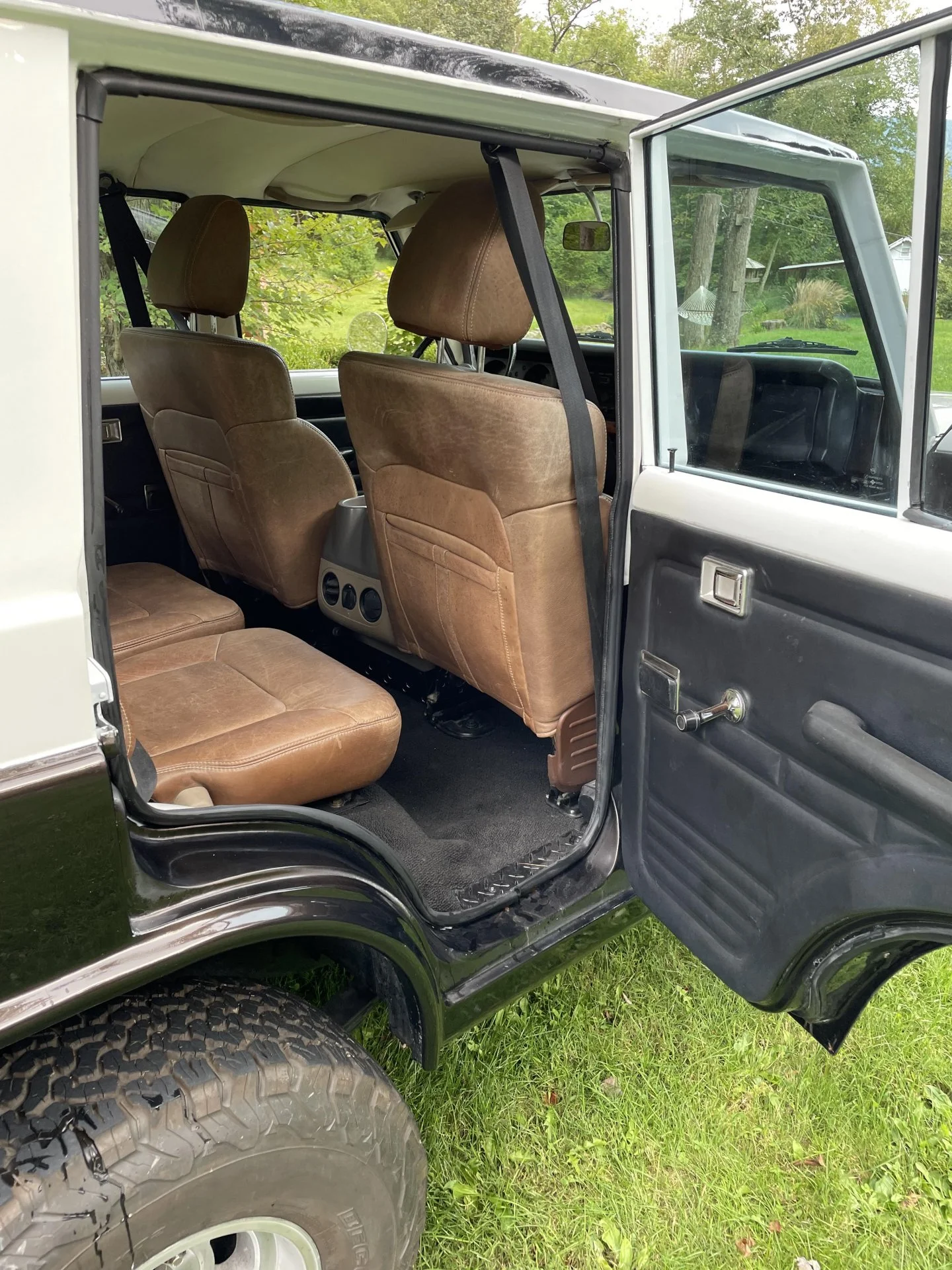

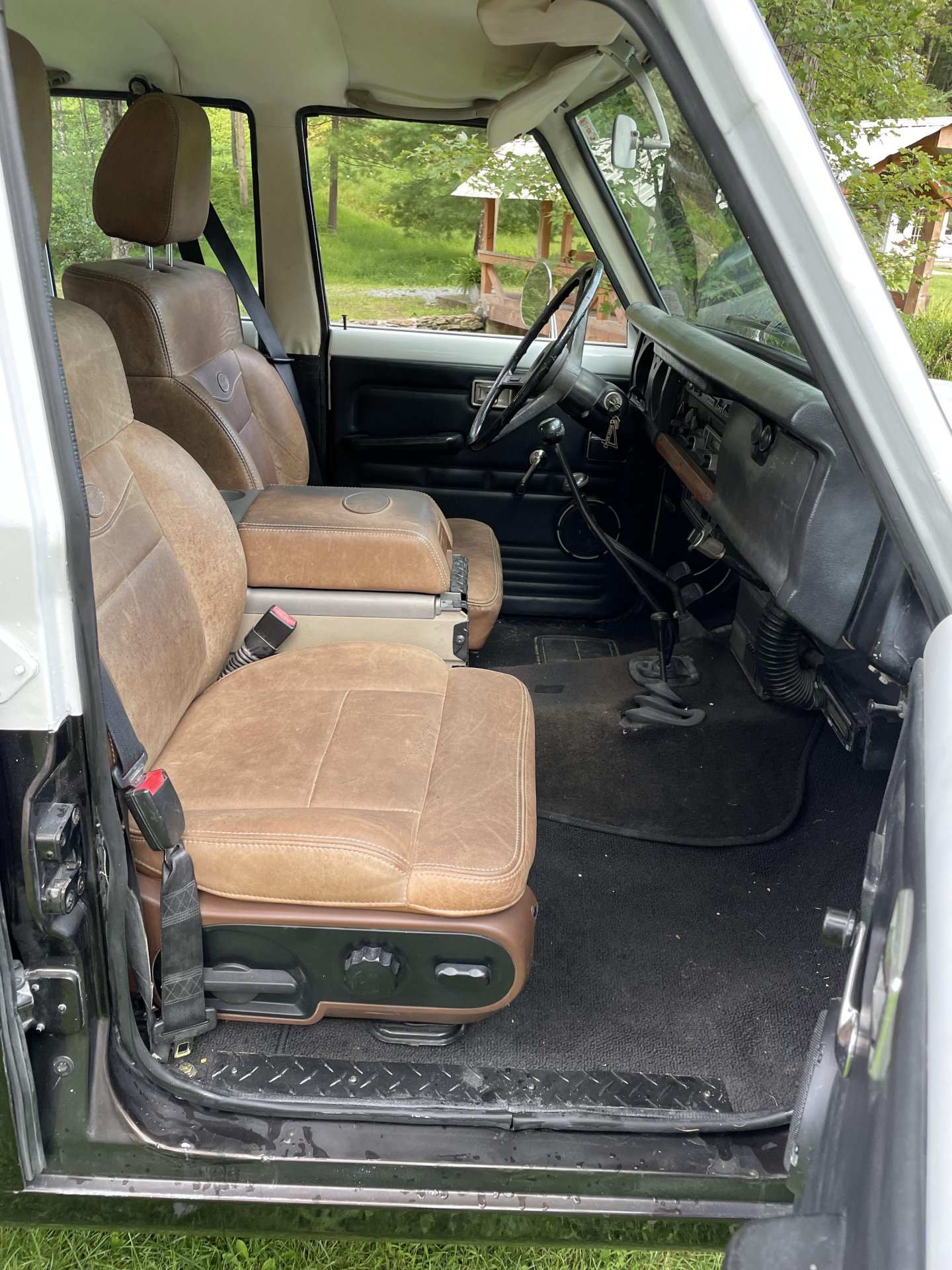

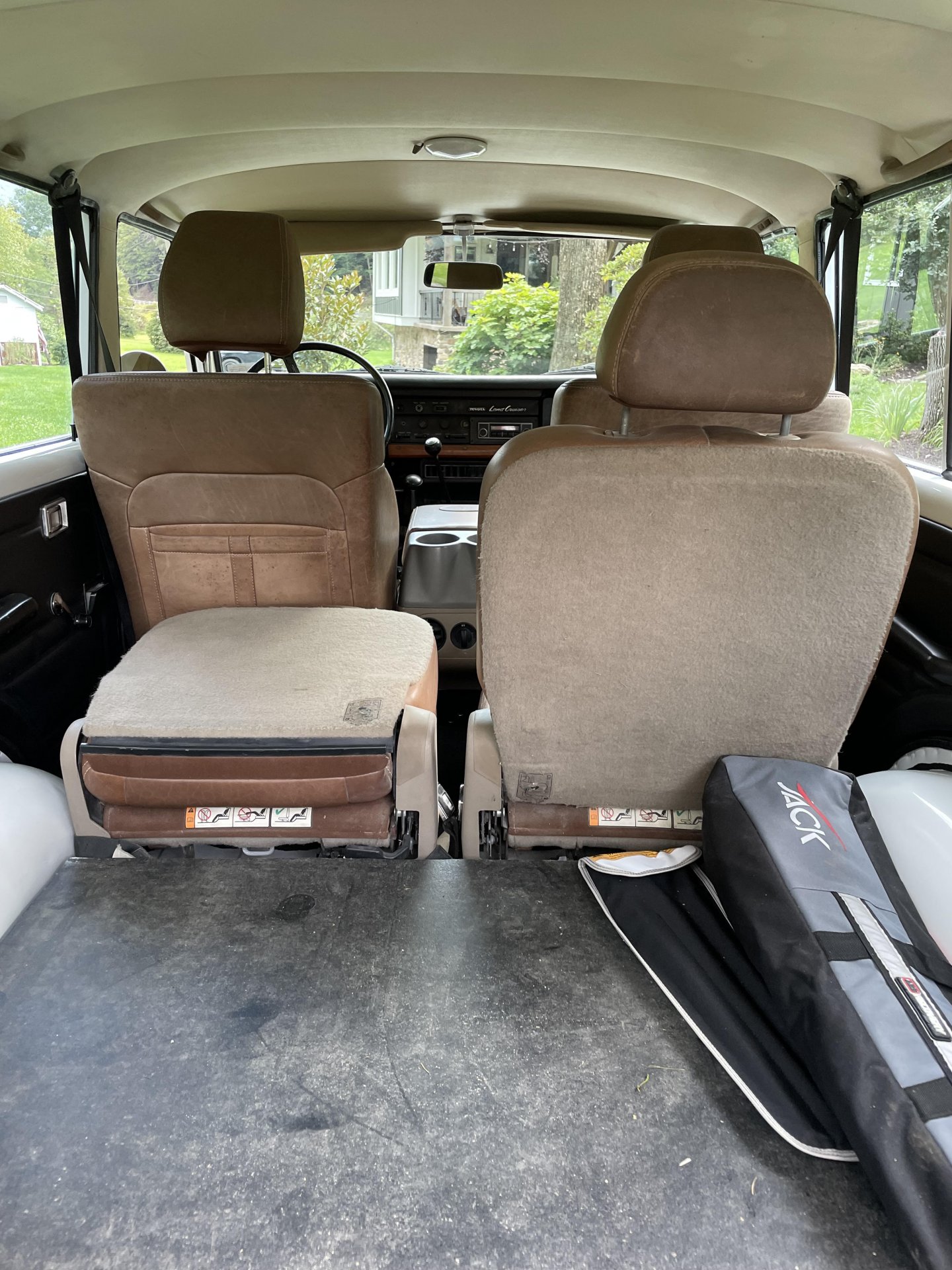

@smooth swapped in some Ford King Ranch seats front and rear. One of the best looking seat swaps out there
100% agree - those look awesome.
Since you have a fab shop doing the work, you can pick what you want as long as it fits the width. I have used seats in the front with integrated belts in the past - like chebby seats through the last 20 years. I'd suggest browsing the FJ40 forum, litterally 100s of options explored there.
I didn't see any more photos of his rig, does anyone know of any angles from the front seats facing back to see how they look? It looks like 2 buckets to me and not a middle seat, other than that they look damn good!
That's how that thread got bumped!
You got what I have for photos. 3 seater rear bench with center section removed. Search King Raanch seats.
Ahhhh that answers my main question on if it is a 3 seater or not how it is installed! I thought it looked skinny.
