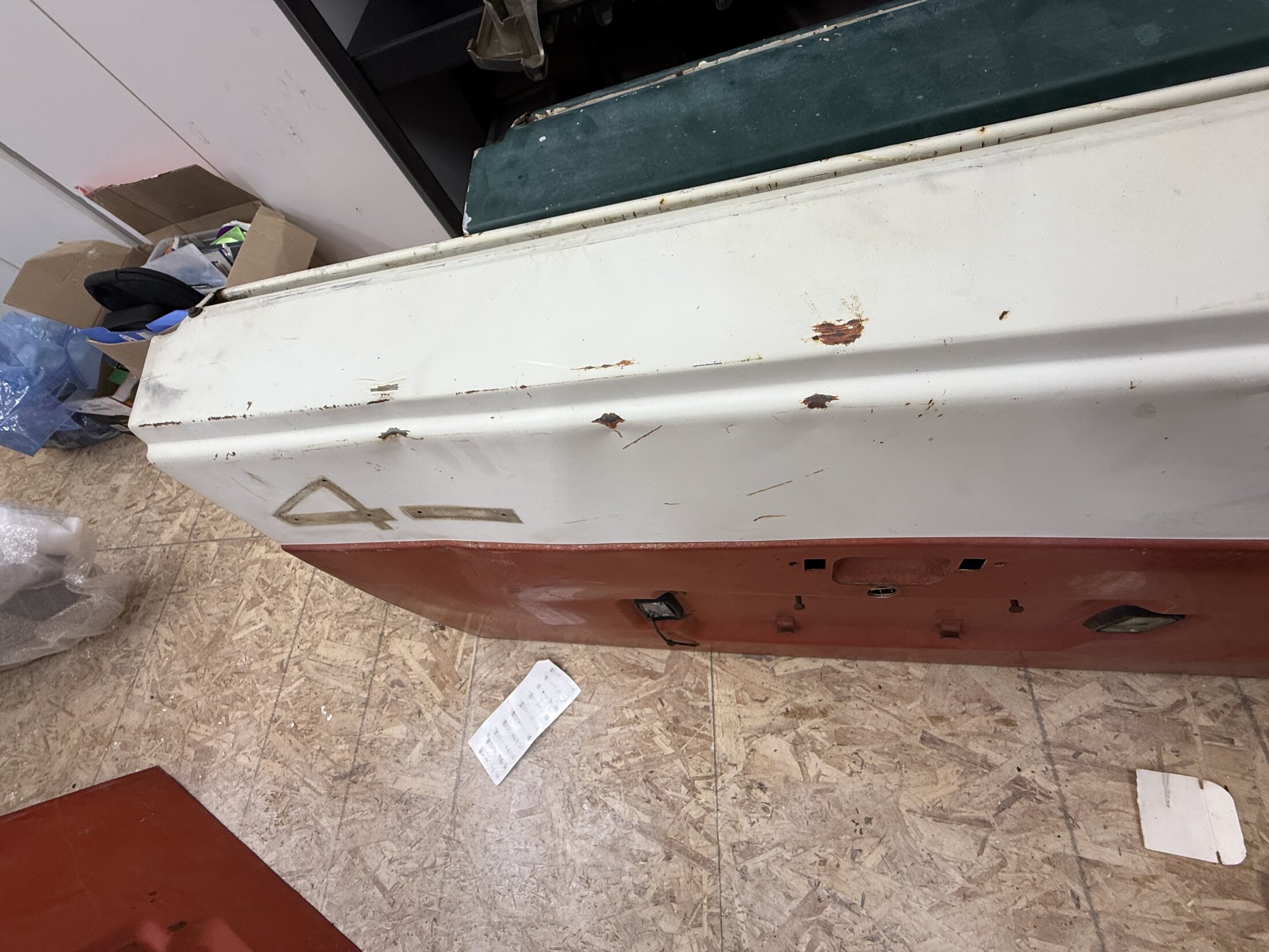

In 1977 some tailgates are not stamped with Toyota per the year-by-year thread. But I’m not sure what happened for 1978. Is this tailgate from 1977?
Thank you! I’m going to post it up for sale so helps to know for sure what year it is.
A 77 tailgate would look like the one on the left minus the "TOYOTA" stamp in it. 77 would have the indent but not the stamping
Not exactly. My 10/76 "77" model has the stampings......as do others of the same vintage. Based on the parts diagrams I would say that all "77" models have the stampings; assuming 09/77 started the "78" model year.

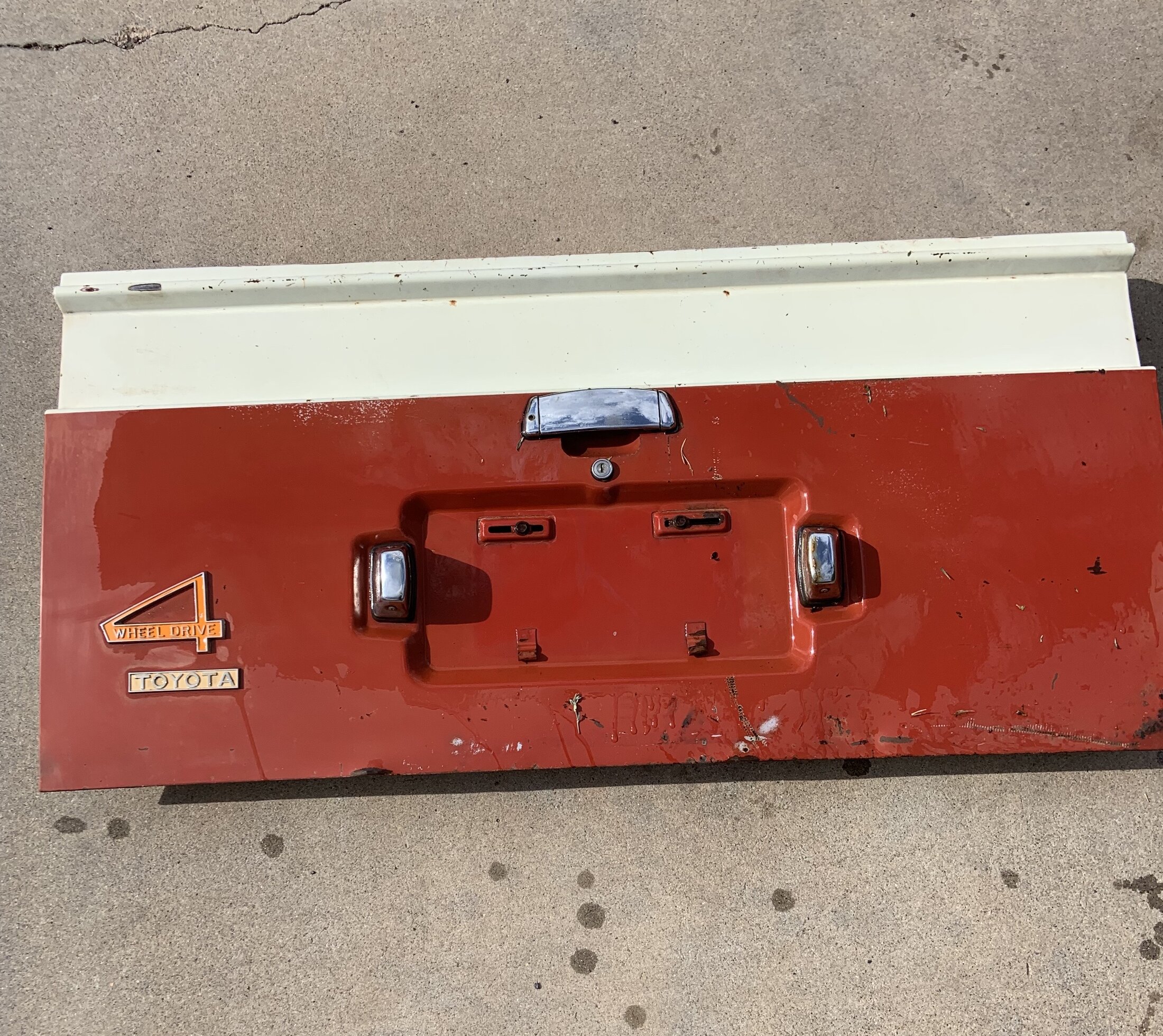

Found it - paid $300. I’ll take some more pics tomorrow.
So do you think there was one month where the stamping machine was broken?
Quite possibly.
Sometimes guys like to intentionally blank out the script on a tailgate on a custom build of domestic trucks.
The opposite seems to be true for the FJ55 crowd. Everybody WANTS the script.

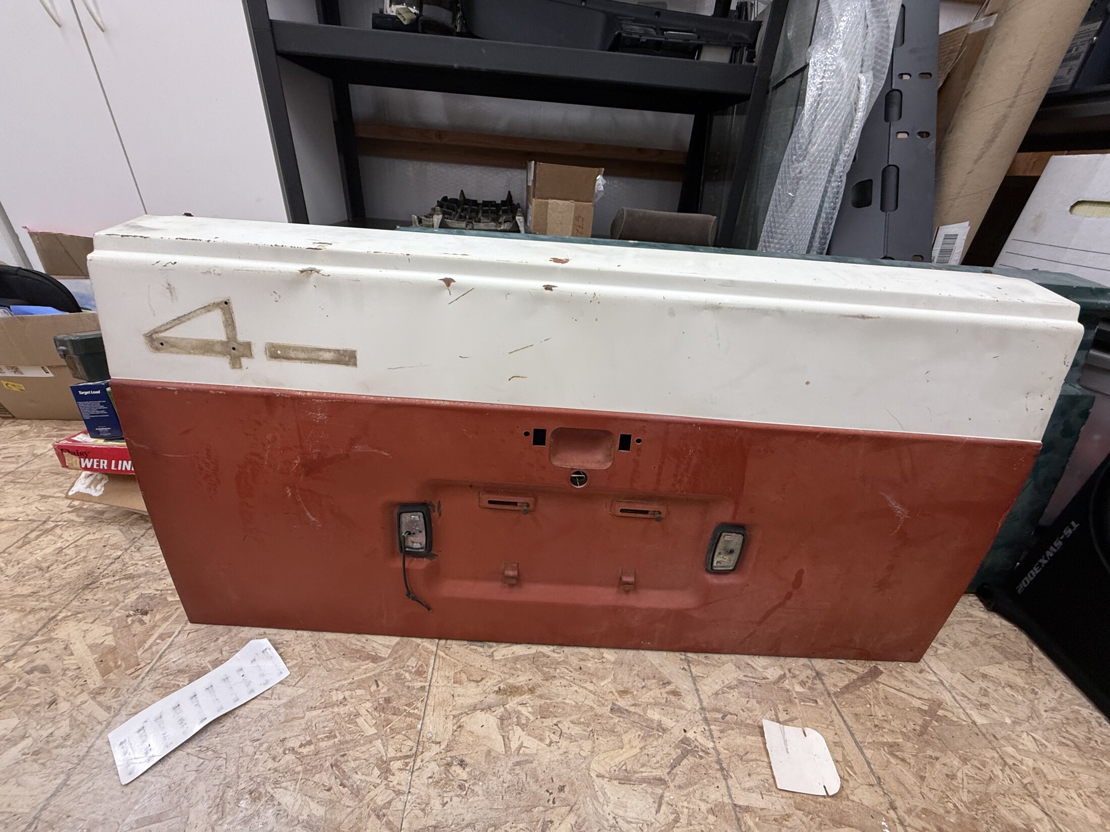

More pics of this one.
Yes, it was just the one I posted about where wasn’t sure of the year. Probably going to sell all 3 of them.
