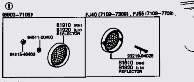

Do the rear bottom reflectors bolt on or are they glued on? I hate to pry on it if they are bolted on.
Don't hold me to this, but the backing plate bolts to the body and you have the reflector, chrome ring and a round spring retainer, at least on a 71. I think they did change in the newer years.
They either bolt on with studs or screw on around the chrome ring, depending on year. They do not glue on.

Edit: I see in your taillight thread that you said it's a '72. Looks like there should be two screws through the chrome trim ring.

Thank you that’s what I was thinking unfortunately, getting that backing plate off is a mofo

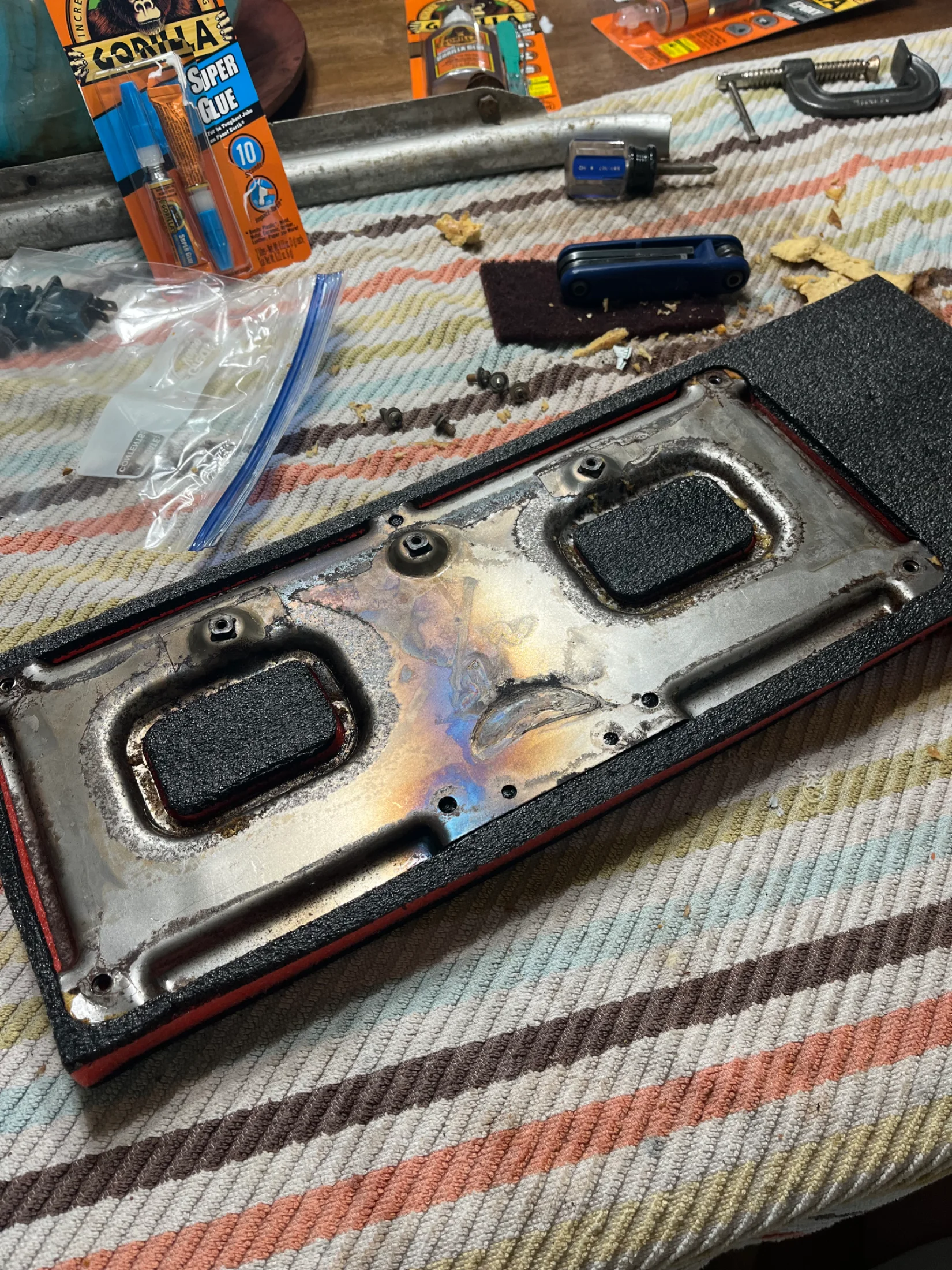

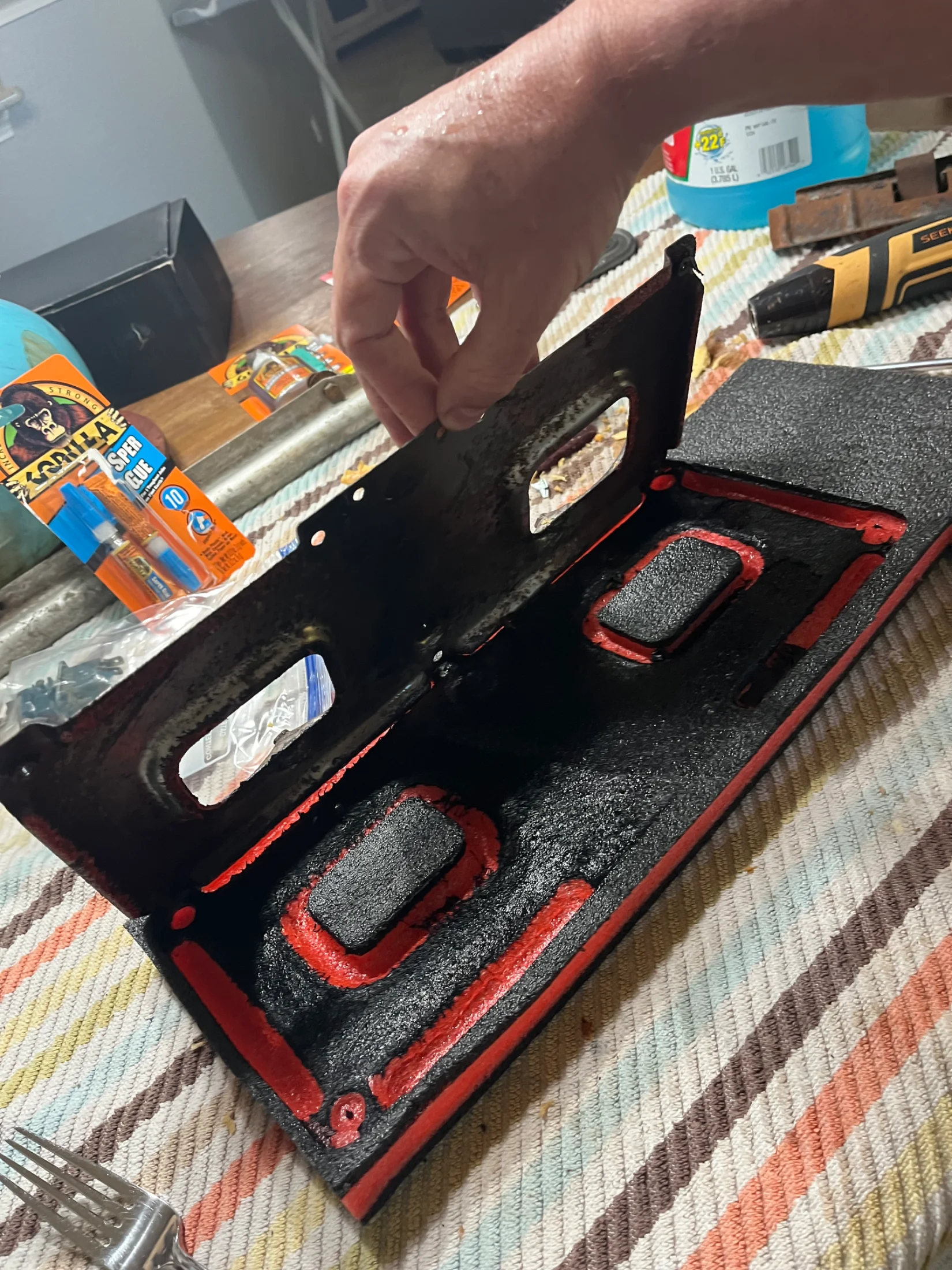

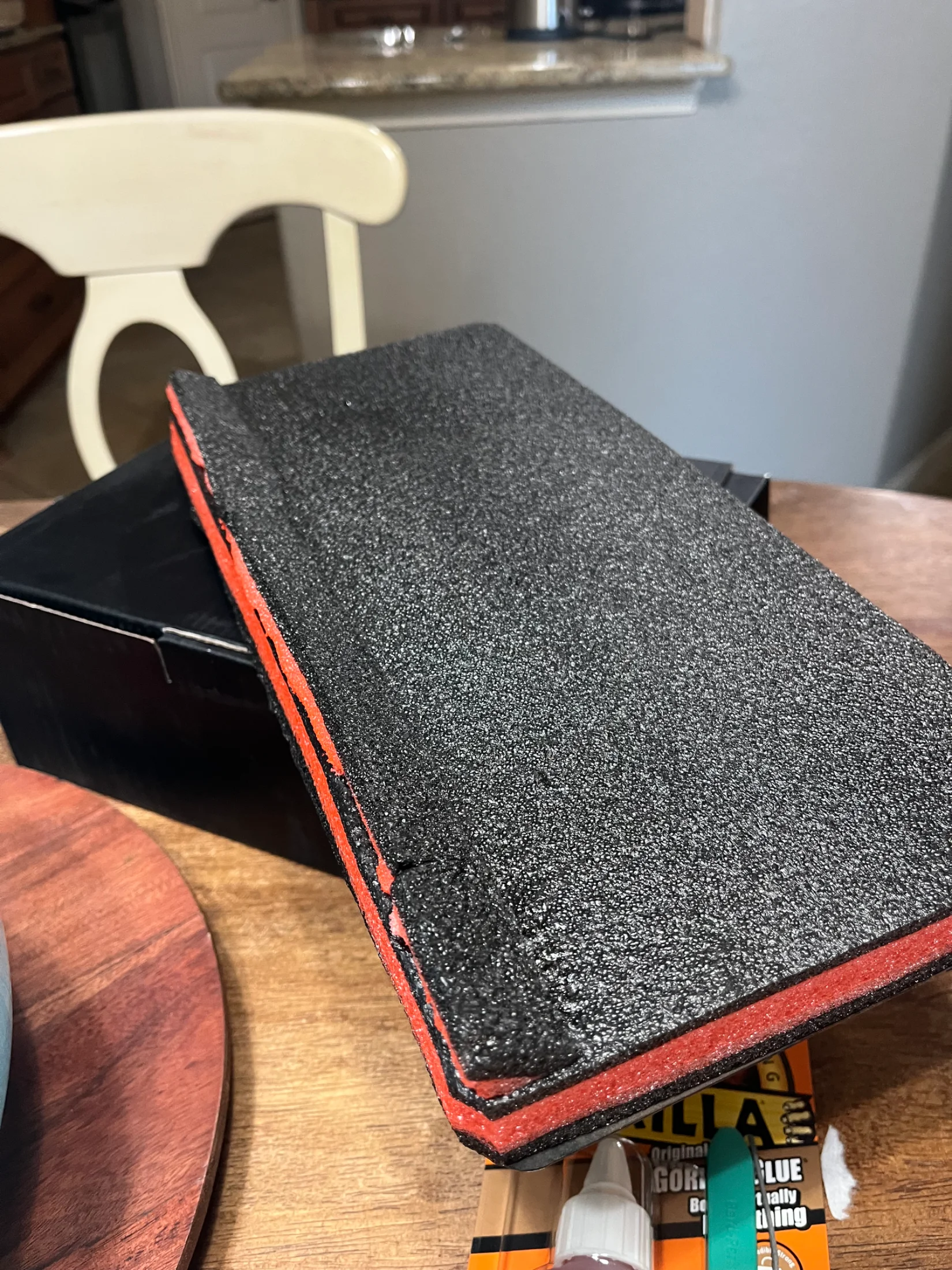

I also wanted to post some photos of my glove box restore. As we all know, they go to s*** really fast and start warping terribly so what I did was buy some toolbox foam since it was the same density and thickness and stripped the old foam off of the metal plating, heated it up to a consistent temperature and gently set it on the new foam. Took me two times to get the heat just right, but it turned out great.

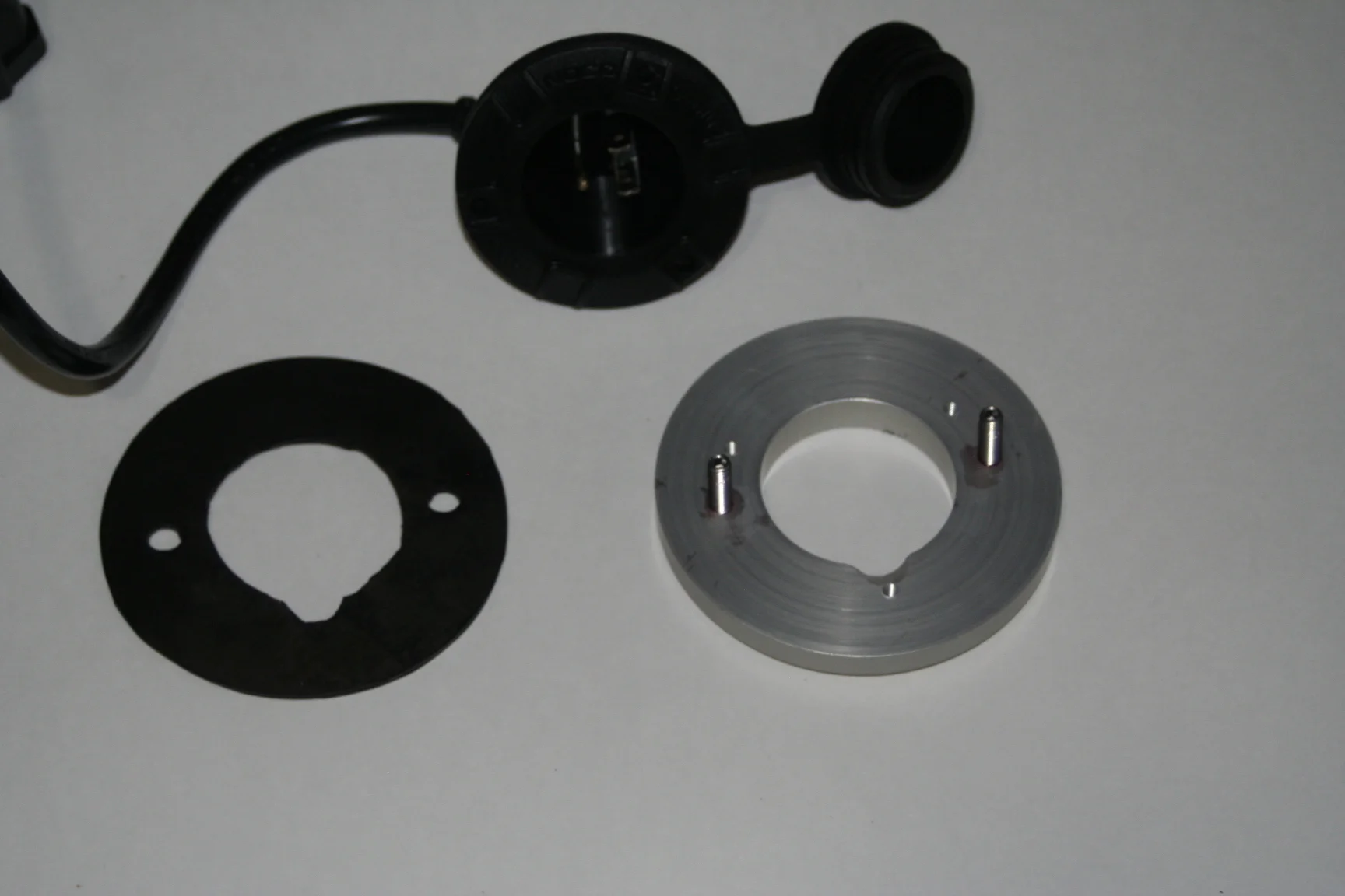

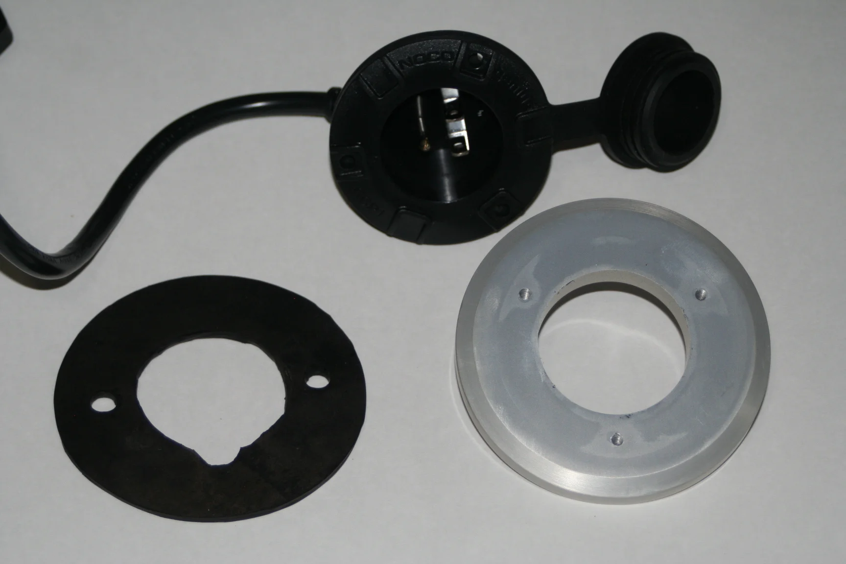

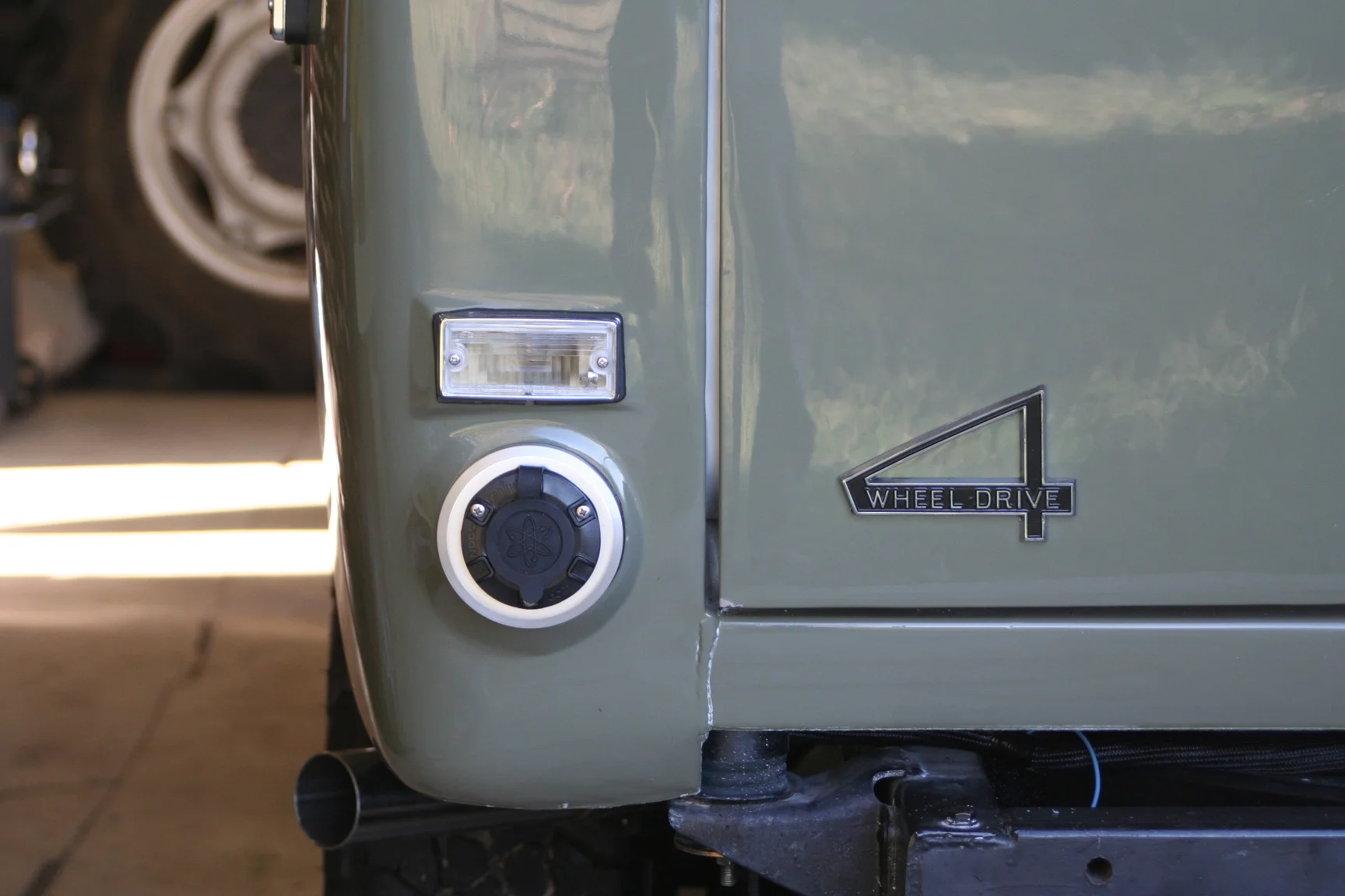

They are Noco power ports and I had a buddy machine the alum. backing plate.
That’s what I love about these trucks. They’re like open canvas for unique ideas and ingenuity.

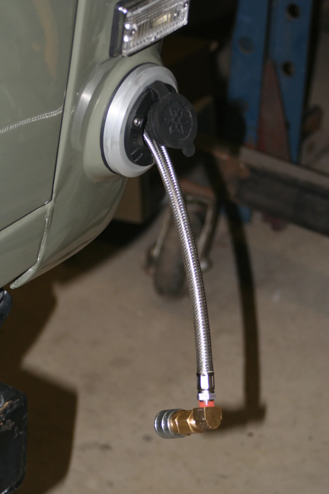

And I suppose you also have hot and cold water quick disconnects for a camp shower set up at the front your truck too
